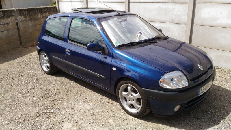

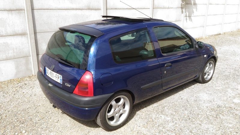

My name is Alaric, and as mentioned i'm from France, near Le Mans.
I have a Ph1 172 since 2012 and now she have 225 000 Kms on the odo (approx 140 000 miles)

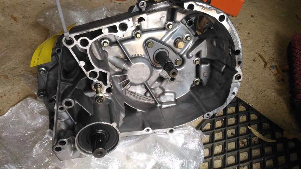

The car is actualy disasembled for a gearbox rebuild and i hope drive it very soon!
I have also a 1.6 16V Ph1 "Sport" for everyday drive!

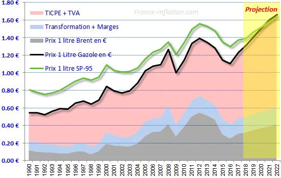

There are some but unfortunately, here peoples are more concern about economy than pleasure when it's come to cars...

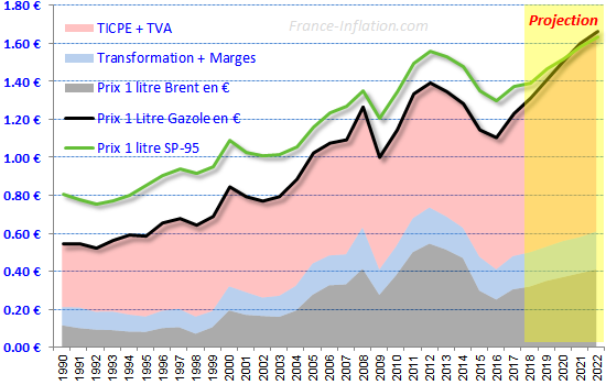

This is why 70-80% are diesel and borings cars... But this is about to change because taxes on diesel are increasing a lot... Since 30 years, diesel was fiscally advantaged but this is the end of this era.
People are now buying gasoline or hybrid cars (but still boring ! :D ) and i'm happy with that, i can't support anymore the black smoke and nasty odor of diesel engine...

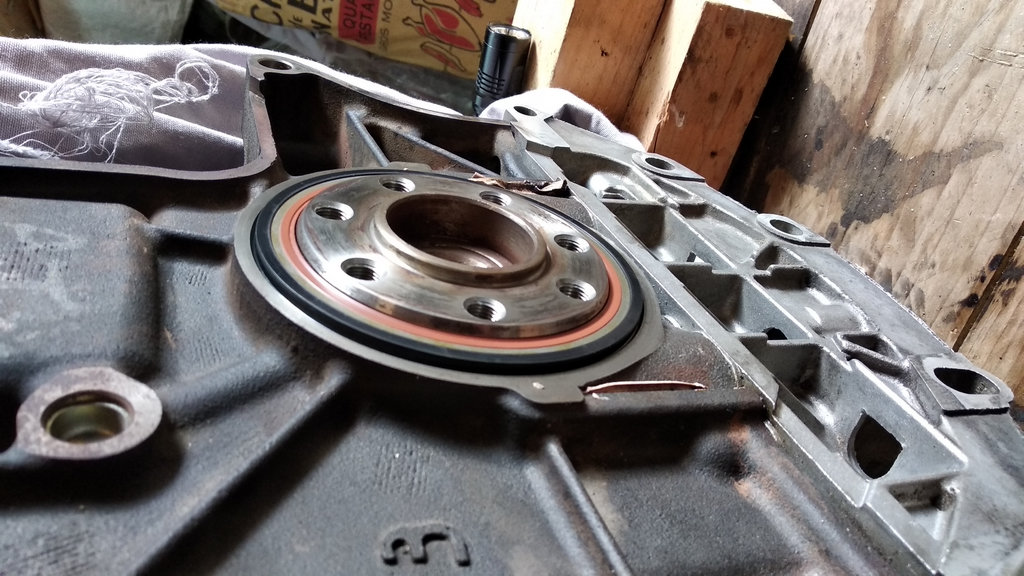

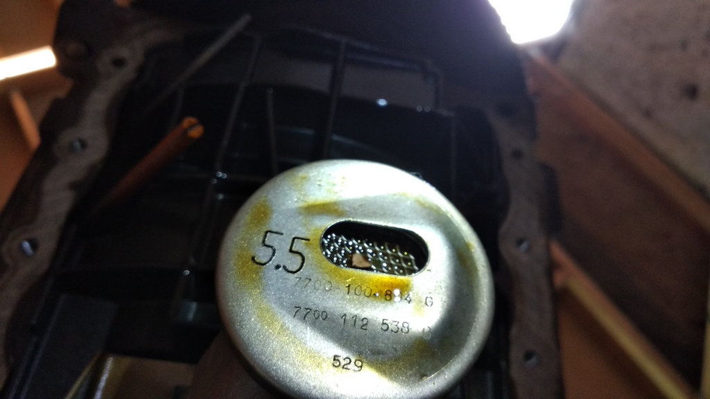

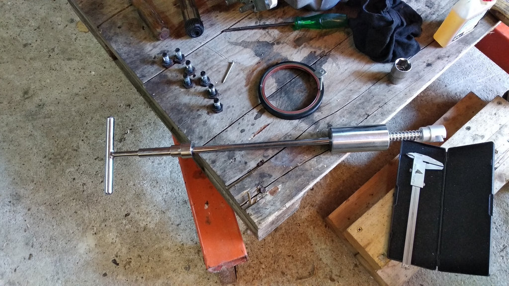

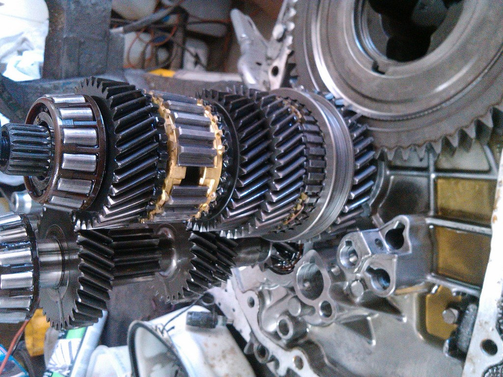

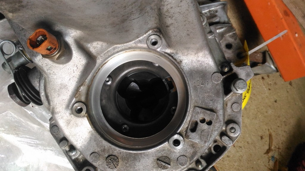

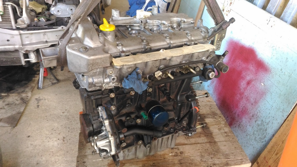

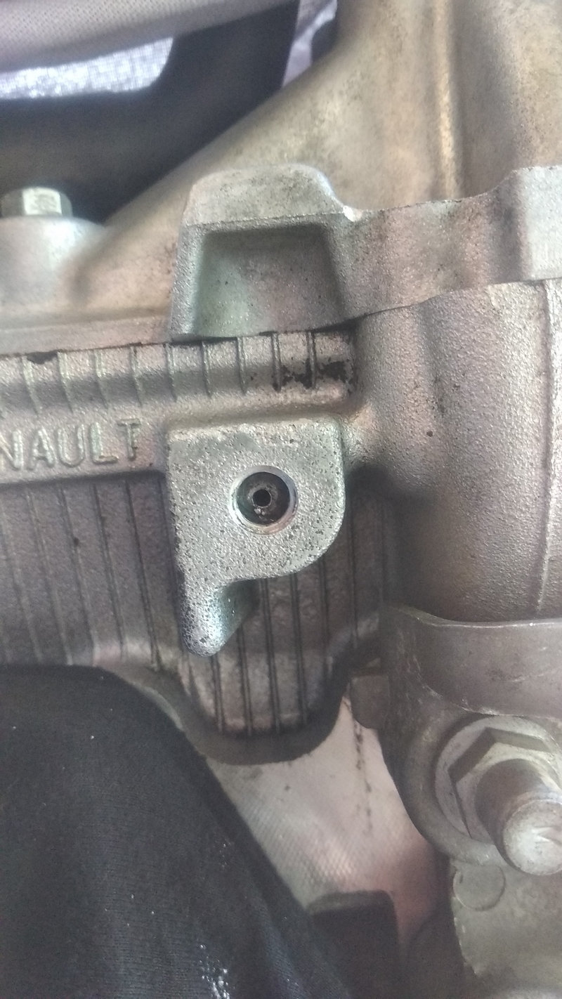

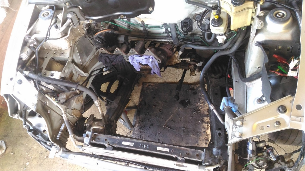

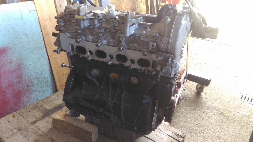

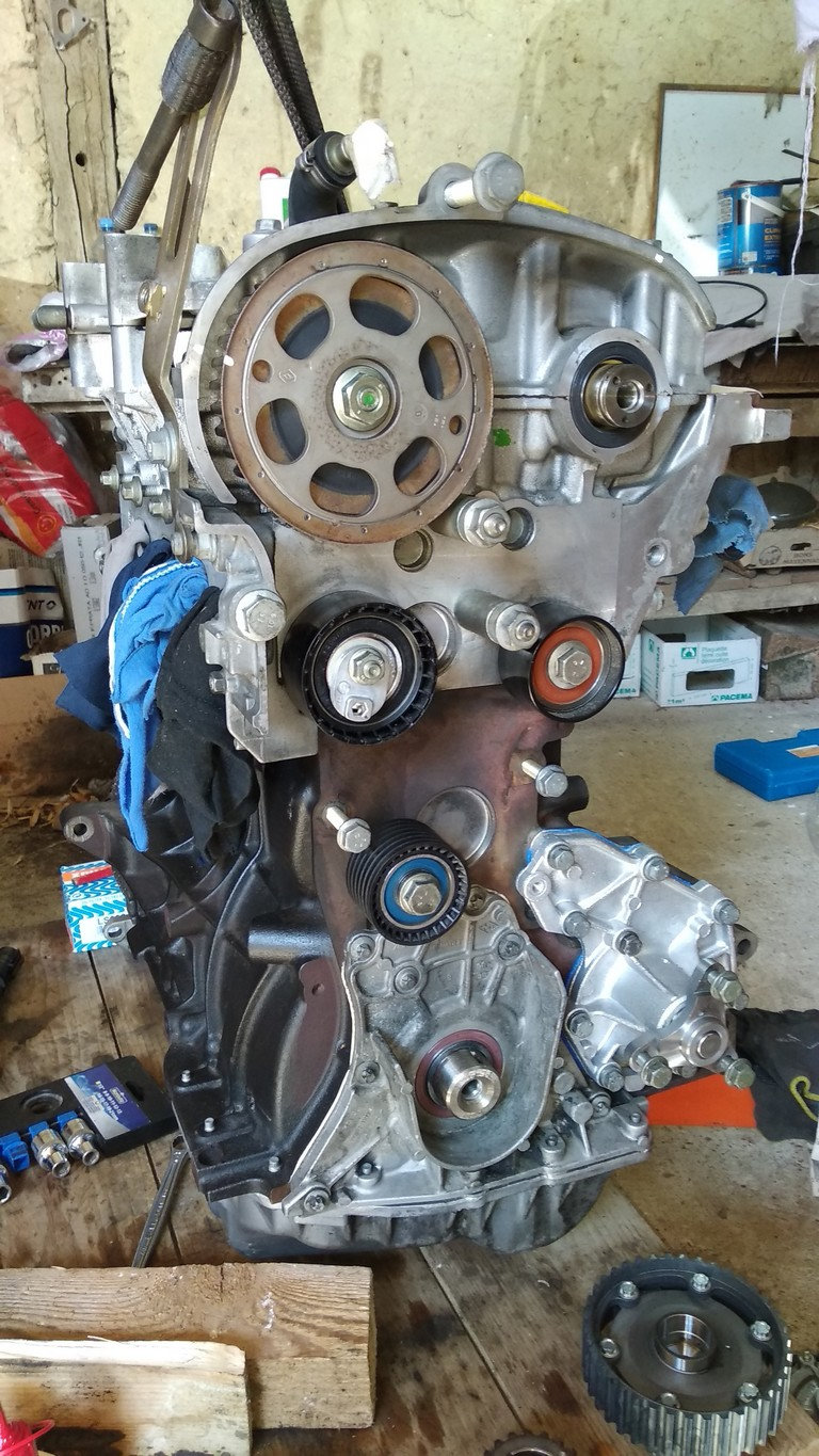

The Clio 'll be back on the road this afternoon if everything is allright after two month of repairs!

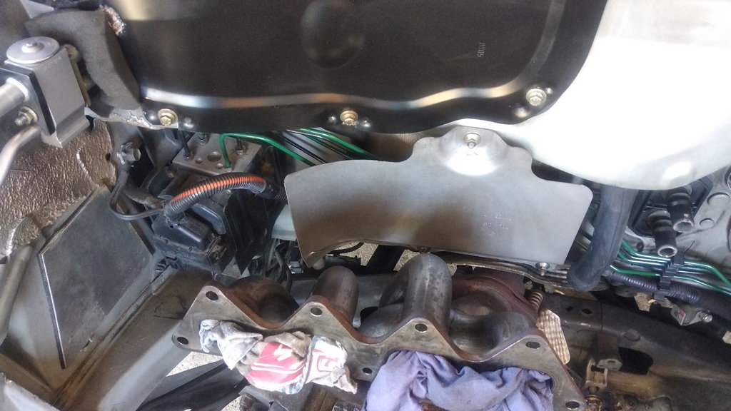

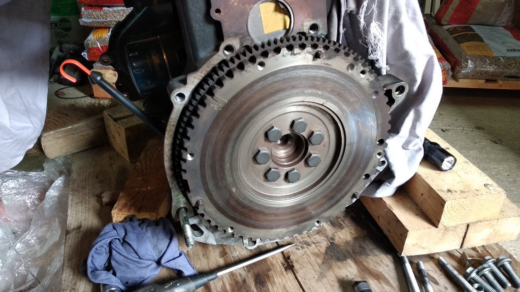

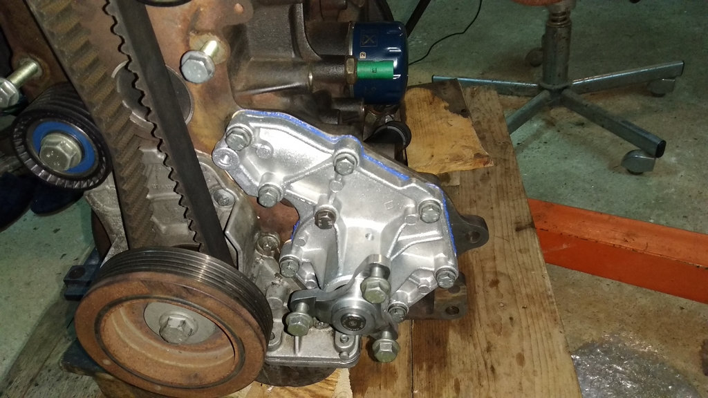

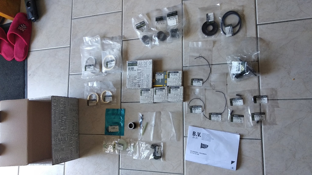

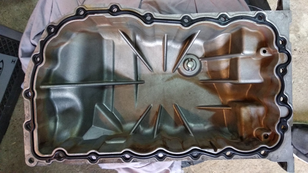

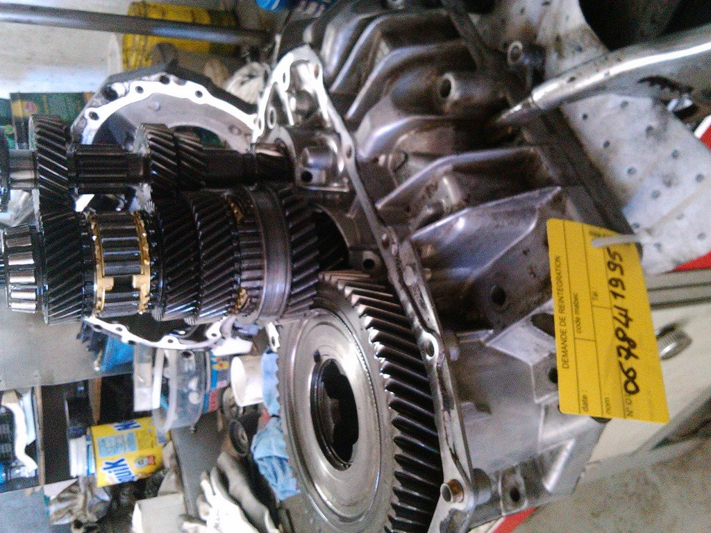

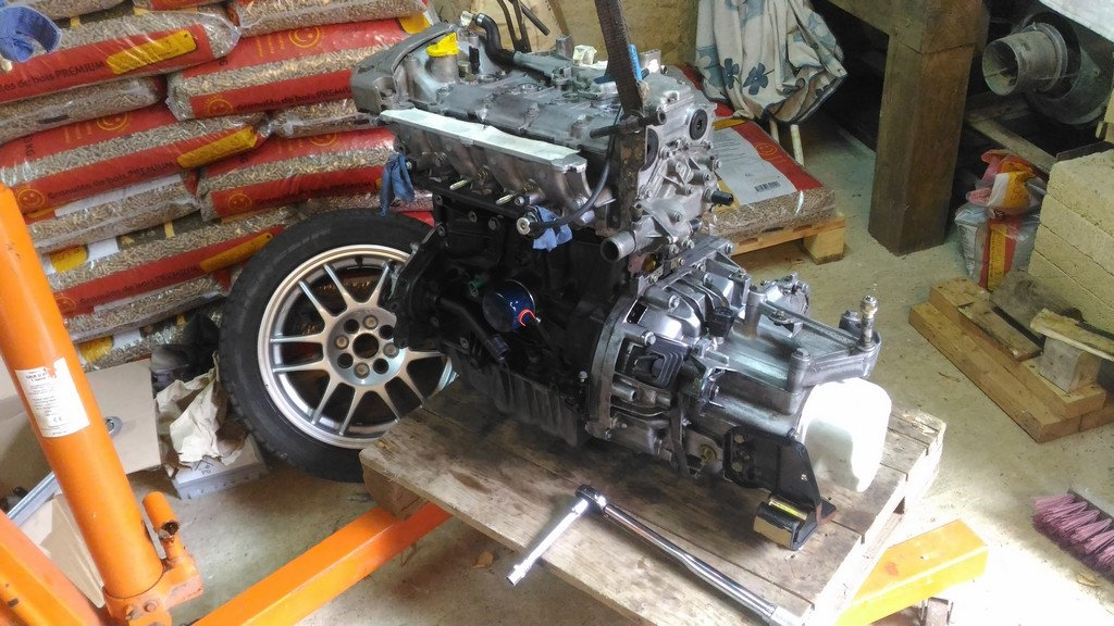

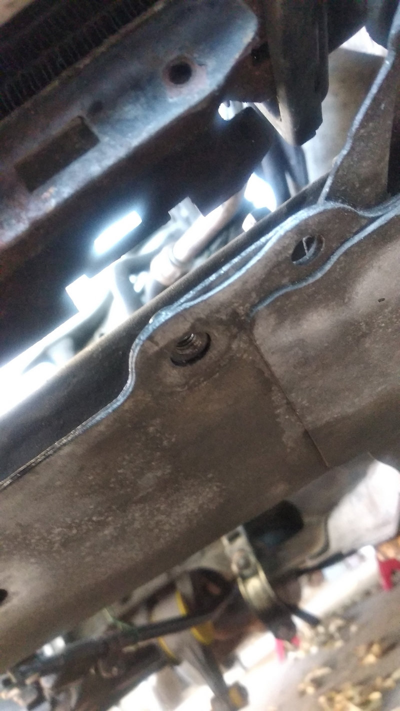

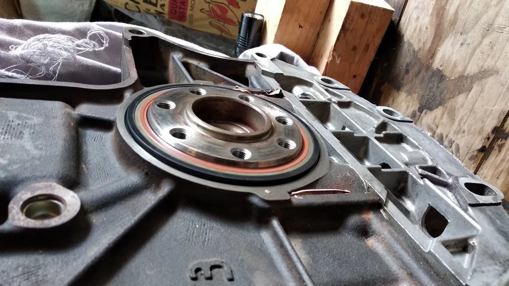

in summary:
Gearbox rebuild with Ph3 diff reinforcement
Clutch Kit
Timing Kit
Dephaser Pulley
All oil seals
Seal of the oil pan
Accessory kit
Water pump

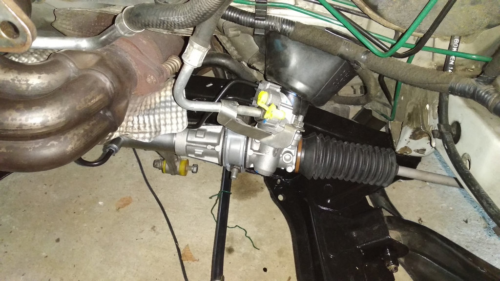

New steering pump support
Steering rack standard exchange
Powerflex black steering rack hard bush mount
Top suspention bushs and bearing
Clio 1.2l exhaust thermal screen
All the fluids and filters
The most tricky thing to do is the aux belt, what a crappy design... Must be ingenious to put in place...
I'm so exited to drive it again!

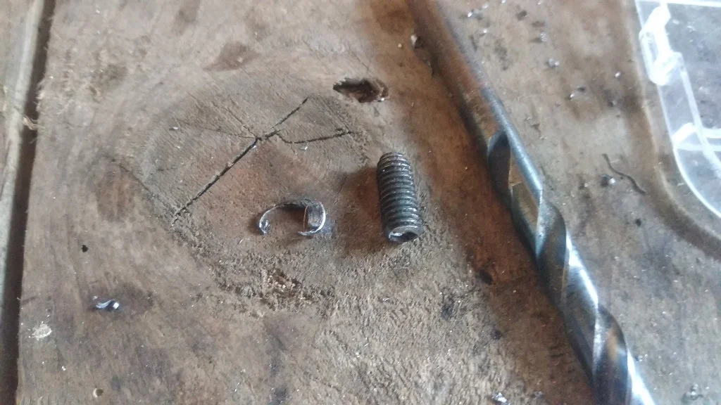

All right, so i drove it maybe 700 Kms and everything is ok except one thing.
The second gear is very hard to pass when gearbox is cold... i mean, very hard. Shifting from first to second is always ok, but third to second this is another story...
After 15mn or so and getting hoter, the problem dissapear and it's ok. This is a very strange problem...I've never seen this before...
Anoying for a fresh rebuild gearbox...
