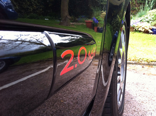

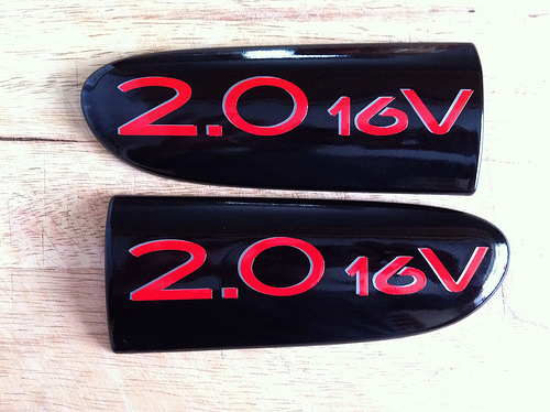

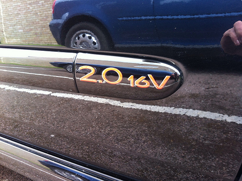

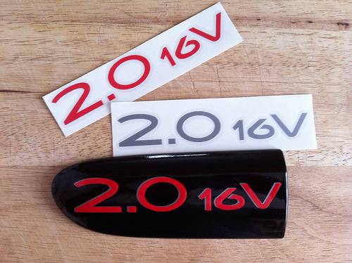

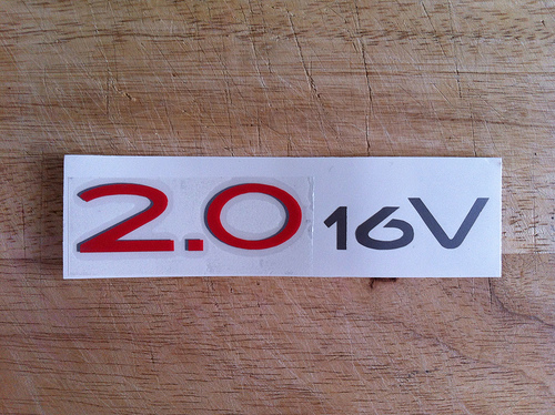

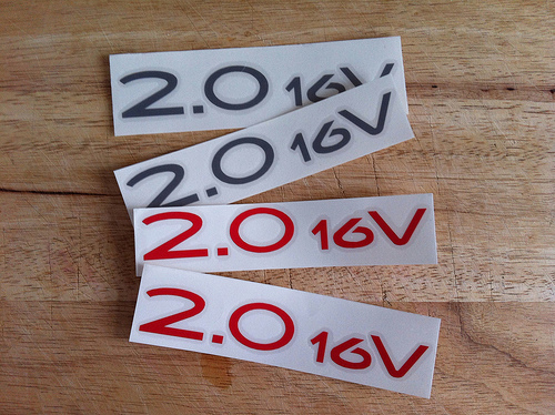

Got Ady@n2grafix to knock me up a set of bullet stickers so i could have some smooth bullets. Got him to do a set in red and silver so i could have a silver shadow over the red like my rev counter stickers. Anyway what ya reckon CS?

Thanks Jamie. They actually turned out better than I thought. The lacquer is on so ill let them dry overnight then pop them on tomorrow after work. Quick question: how do I remove the old bullets?

They look better than I thought they would too.
You need to remove the sidestrip and then remove the old bullet by the big clip in the middle. The other two smaller clips at either end should just pop off.

I just taped up a flathead screwdriver and levered them off,
starting at the front and worked my way back top and bottom,
comes of easily once you get it started.
Same as above, infact It can be done with your fingers quite easily I find now. Slightly easier if you can get the door strip off, but if you've not had them off before I'd probably leave it as they'll be on stiff covered in dirt over the years inside.

Yes managed to get them off and back on. Bullets were lacquered once last night and again this morning as I finished early :)
There not perfect as the stickers started to rise but I waited for the lacquer to dry then used some 2500 grit and soapy water to wet and dry them off. Used t-cut :)o) to buff out the wet and dry marks then polished up with blackhole. The old bullets I found out were bonded on :( Must have been like it from when I had them painted before as I've never taken them off.
