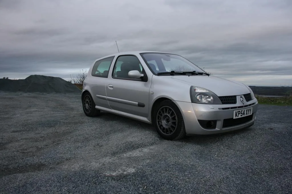

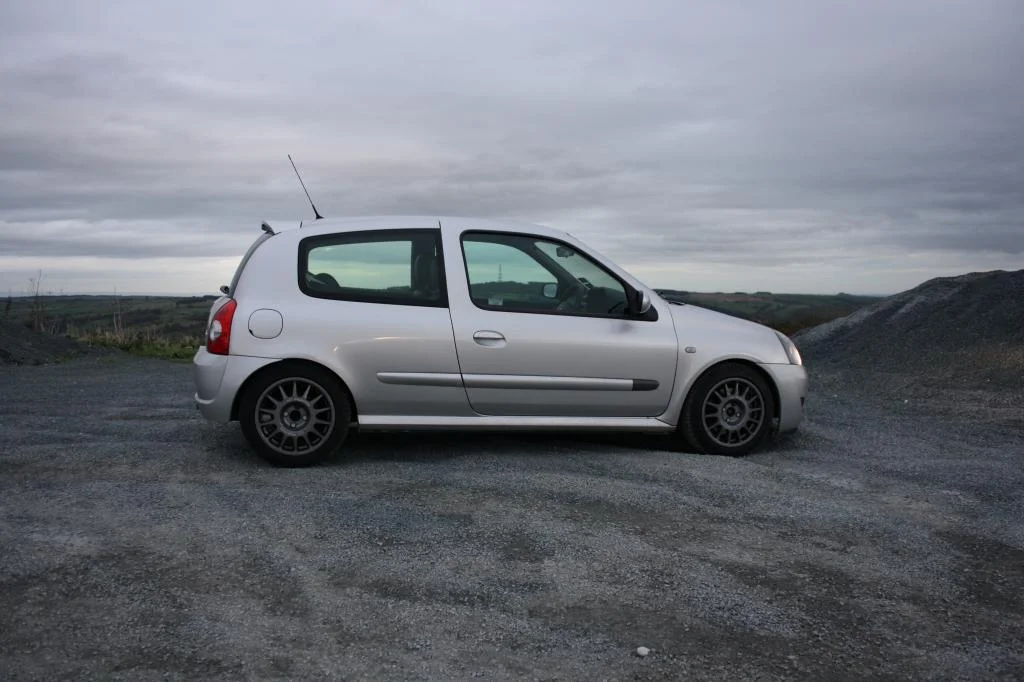

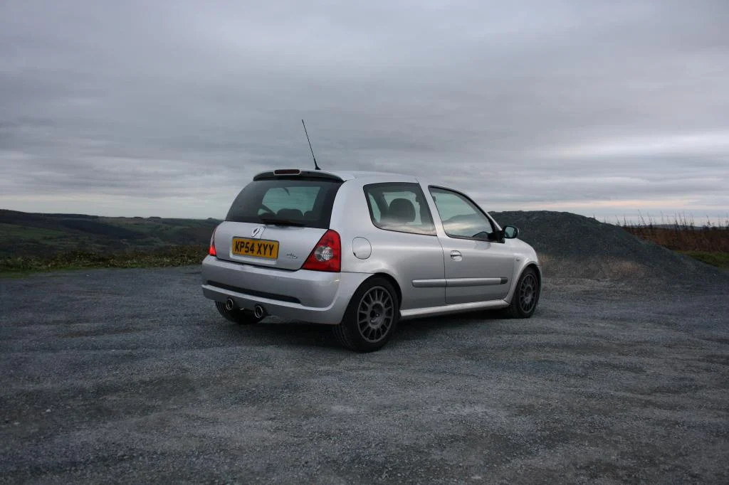

This is how the car looks at the minute (sorry for the duplication of the pictures from the media thread)

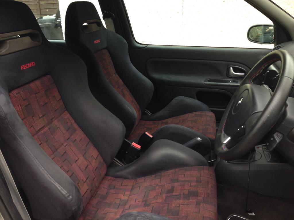

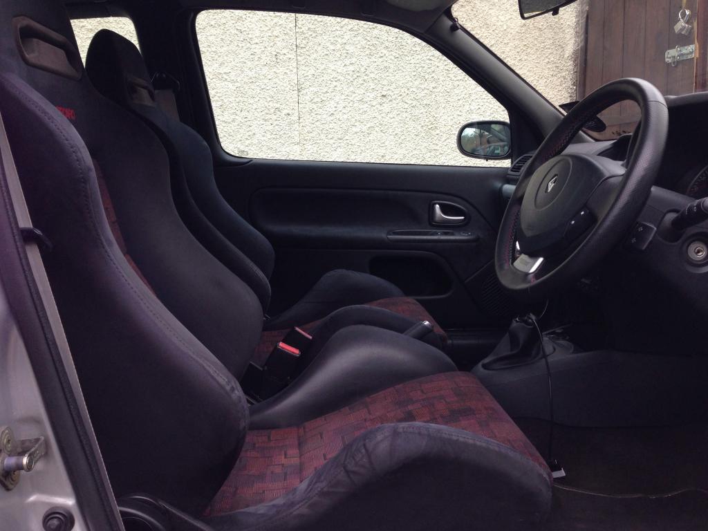

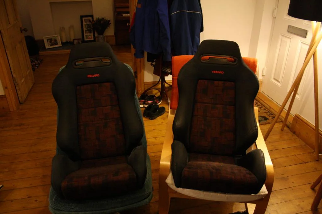

A rethink was in order and I spotted some Recaro's on ebay that were local and well priced. They are out of an Evo 4 and are the Recaro 'Speed' seats the same design as the ones found in Honda Intergra/Civic Type R. The fabric of the middle section of the seat is so 90's it's offensive, but there from a car which production ran from 1996-1998 so I can't really complain and they look 100% better in the flesh than in picture in which they look, well, you can make your own mind up.
Here they are:
Good news is they are clean, the tilt and recline work perfectly all plastics/handles are present and the bolsters have been replaced on the drivers side and are only have slight wear on the passenger side. There is the expected wear on the alcantara but all in all they are in excellent condition seeing as they are 16 years old. Glad Mitsubishi spec'd decent fabric, they'd be in a skip if they had Renault spec fabric on them lol.

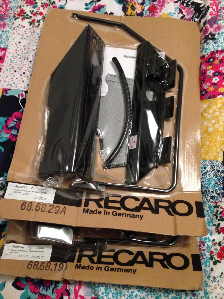

  • Recaro subframes from GSM or Capital which are quiet frankly obscenely expensive, but I can't weld or fabricate so I'll just have to be prepared to pay over the odds

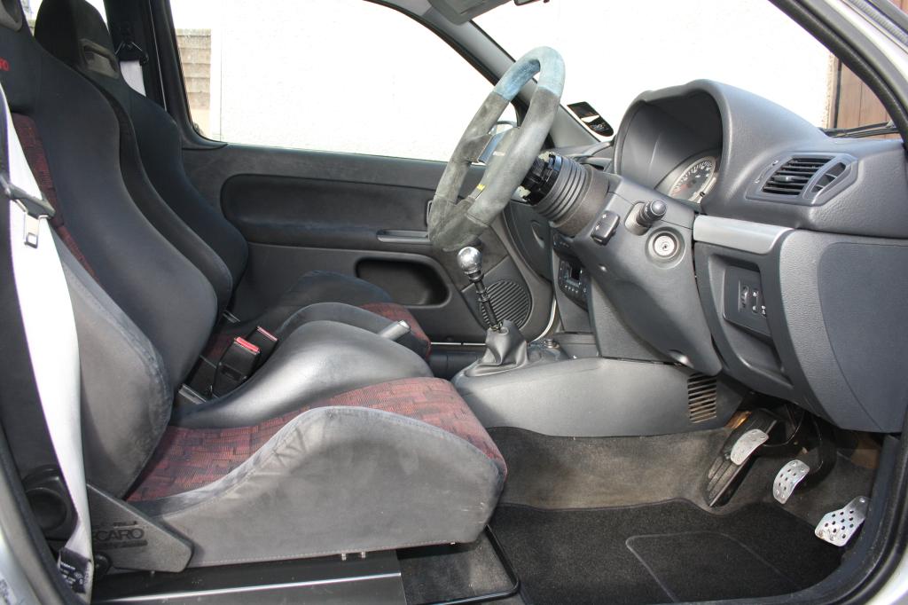

Between Christmas and New Year @dann2707 and his Dad helped me to fit the Recaros. The fitting went without too much drama but it took longer than I think myself or Dan anticipated, some additional trips to the motor factors for some bolts, slight modification to the slider mechanism and riveting on some bit of french nonsense I snapped off! Big thanks to Dan and his Dad.
Initially I thought they were a mistake, the seating position is great up top great support for my shoulders etc but 14 stone wasn't liking the narrow seat/bolsters. I also had to have the seat pushed all the way back meaning I was in a different post code to the steering wheel. It made for a even worse driving position than it had when it came out of the factory an achievement indeed seeing as it was garbage to start with.

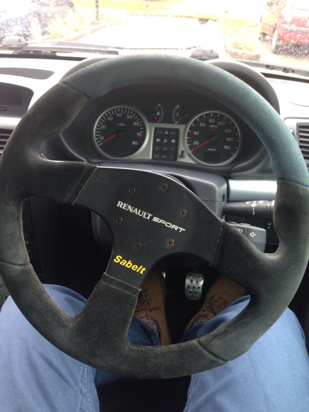

Last weekend I fitted the Sabelt I got from @BIGASH

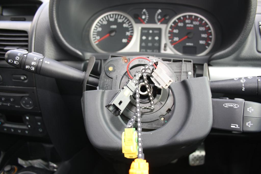

Unfortunately I messed up the steering angle sensor and had the ESP and ABS lights on so today I took it all apart and tried to sort it.
Made sure the steering angle sensor was in the right position this time round with the yellow indicator showing:

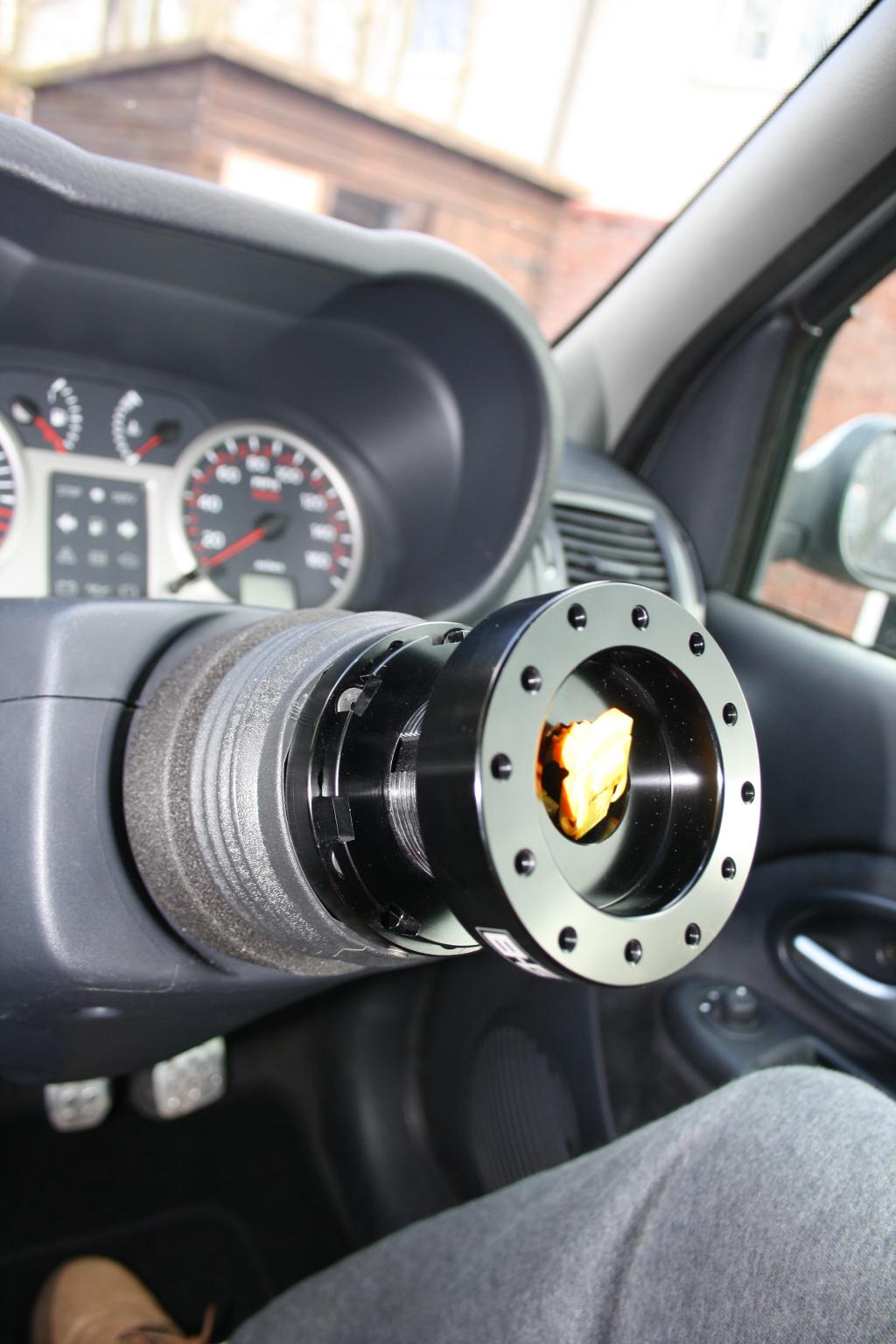

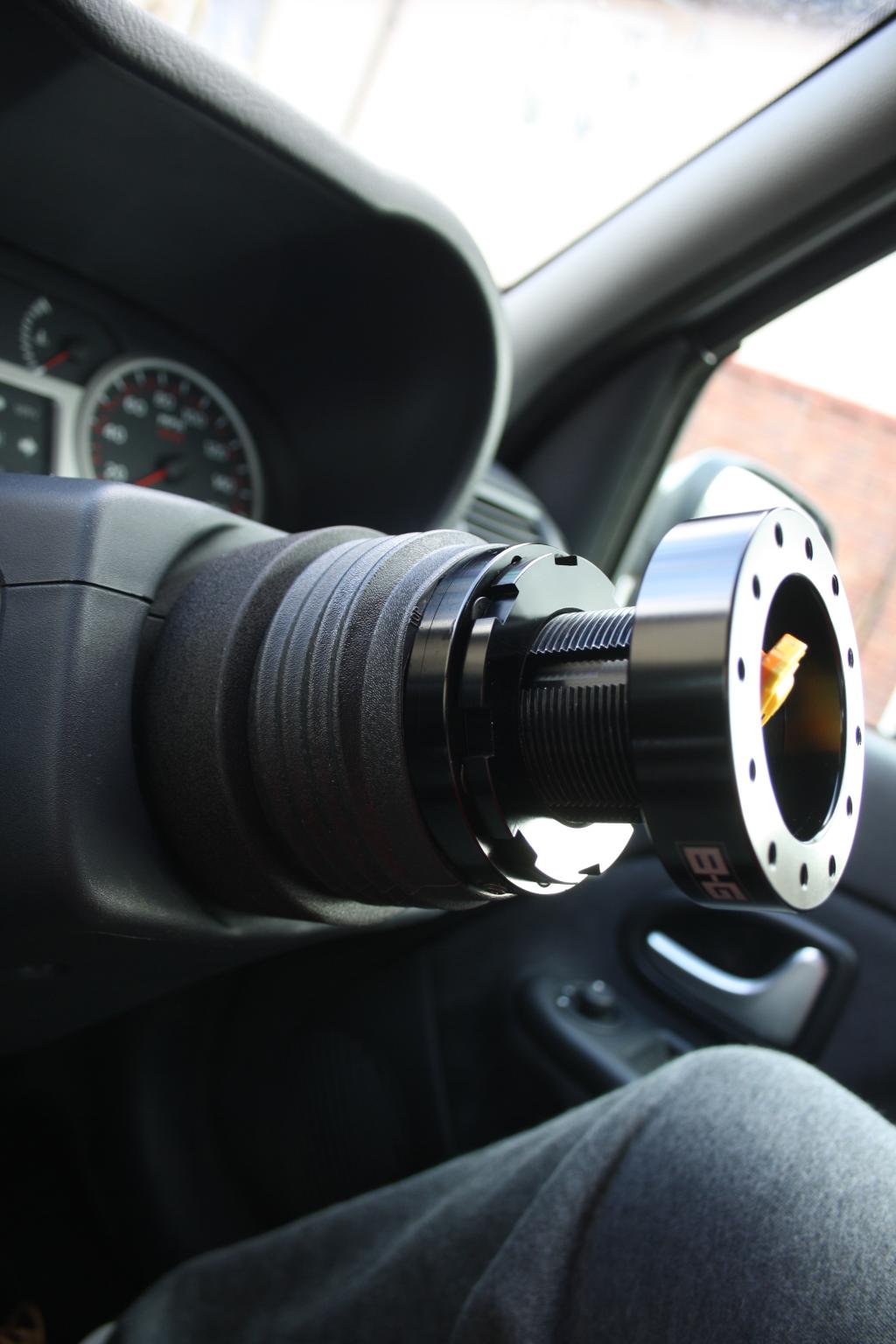

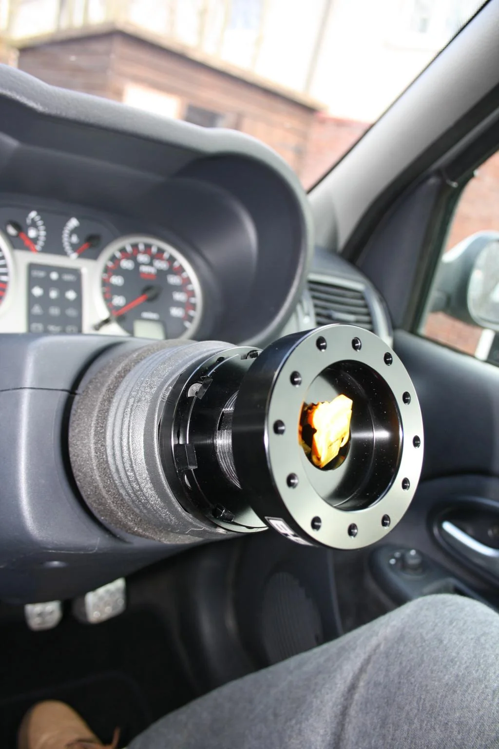

I also got a BG adjustable spacer to bring the wheel closer to me:

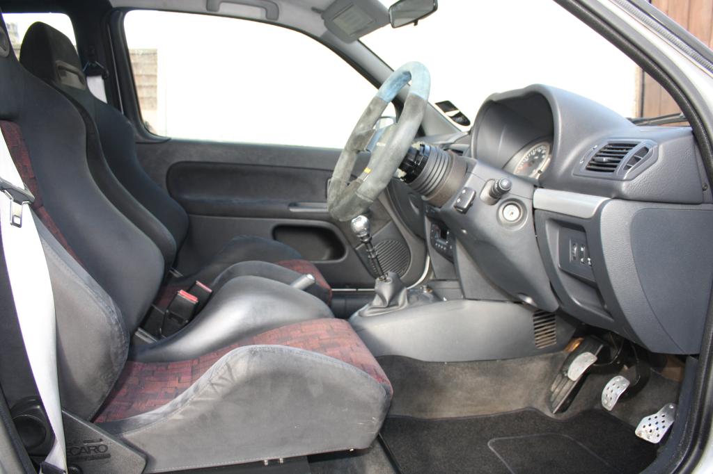

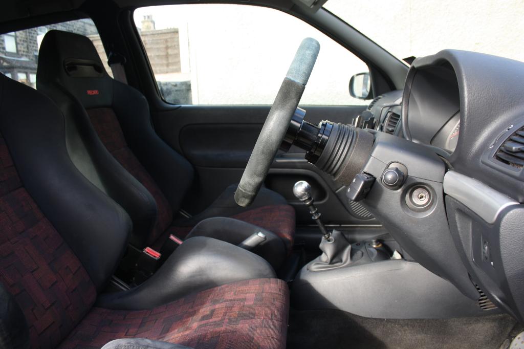

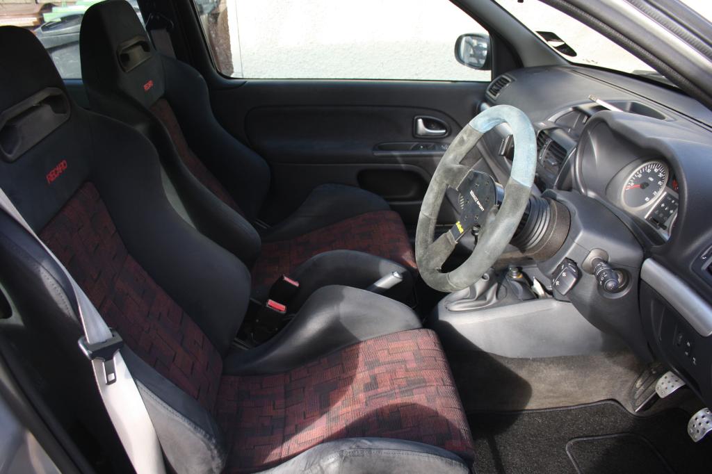

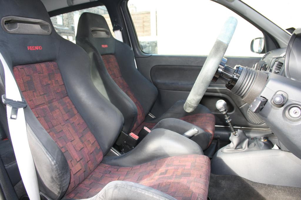

Some pics of the finished interior, I got some £20 mats from ebay as I couldn't bring myself to fork out £50 for the RS ones. True Yorkshireman.
With the wheel closer to me the seats have been transformed, dunno what it is but I feel much more connected to the car now. The Recaro base mounts could possibly be modified to reduce the seat height, something which I might look into but I'm very happy with it now as a package. One thing that is on the list is to bring the neutral position of the shifter back a little more.

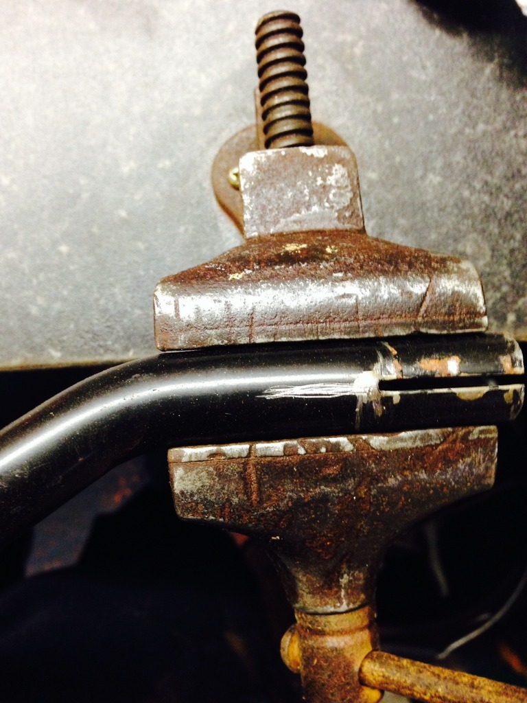

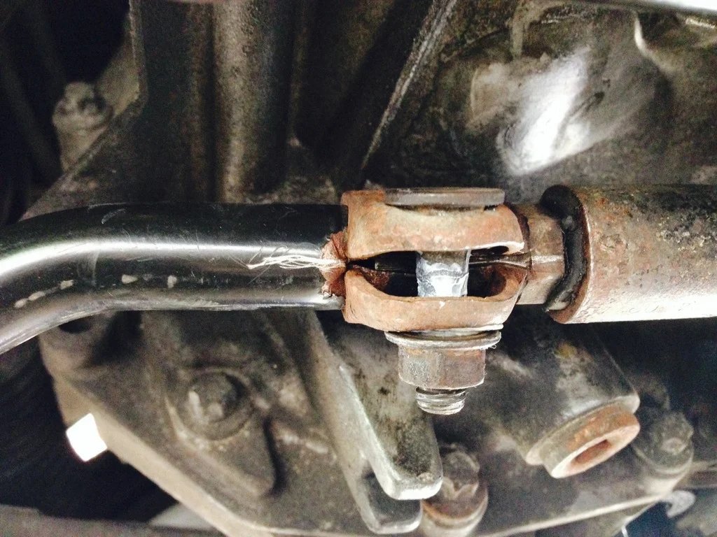

After months of not having much time to spend on the car I pulled my finger out Sunday and had a look at trying to bring the gear shifter nearer to me:

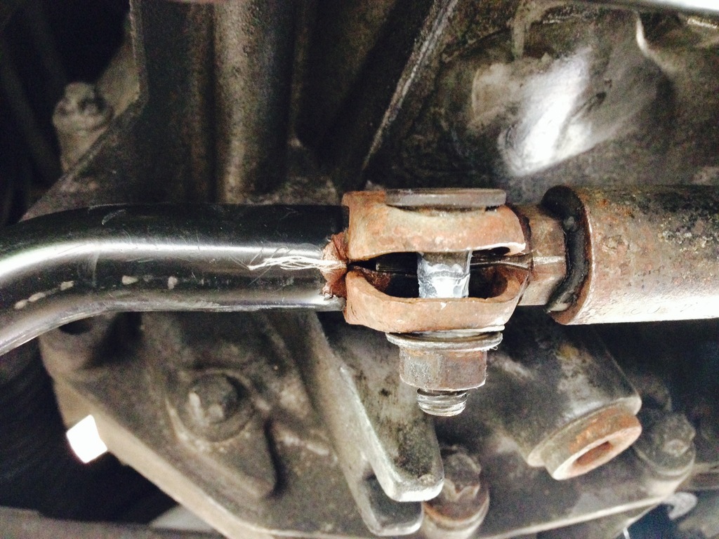

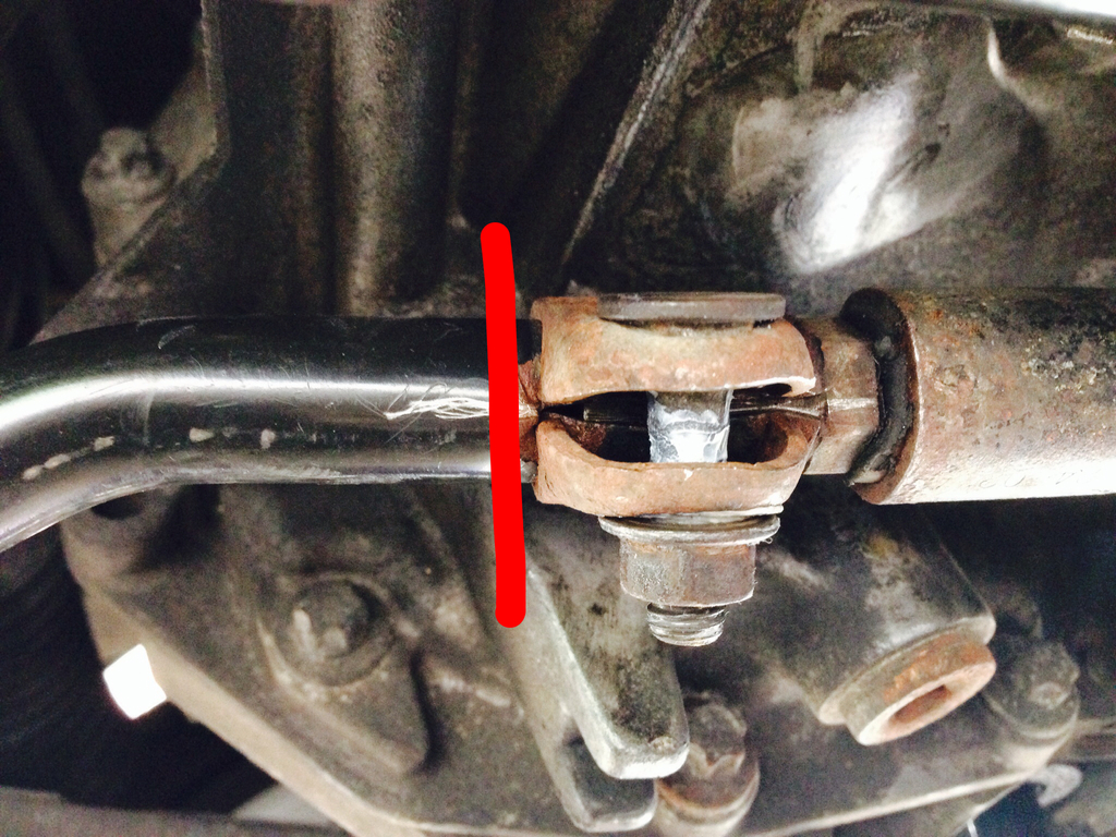

Currently this is how the linkage looks at the gearbox end:
As you can see the male linkage end has already been shortened and pushed as far as possible into the long black linkage arm. Not the nearest job by whoever did it and it is now completely jammed together :rage:

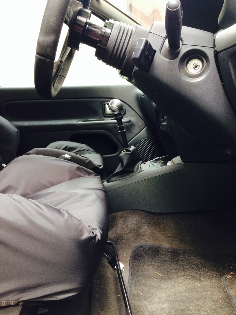

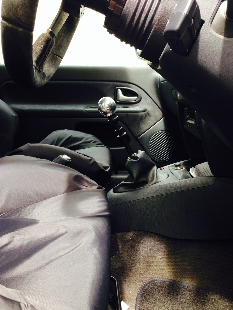

This leaves neutral looking like this...
Which with the Recaro's all the way back leaves me reaching miles away for first and fifth which is fine for general driving but anything more involved it isn't up to the task.
I'd ideally like to have neutral here (where 4th is)
Which would leave 1st, 3rd and 5th level with where neutral currently sits (in the first pic of gear stick)

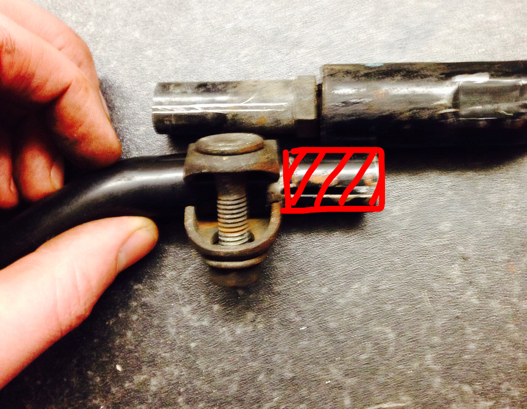

Plan is to cut the black linkage here:
Then cut some new grooves (shown roughly marked the second pic below) and refit the clamp and linkage arm ... Like this (bit in red will be cut):
Wonder if you chaps had any thoughts highlight any potential issues with the plan @Tony Hunter @Jay Payne , sorry to tag you out of the blue but you know about the original linkage mod so might have some thoughts.
Making the new grooves will be a pita under the car but doable, only other thing i can think of would be the shifters ability to go that far back for 2nd and 4th (towards the driver) but i'll check that before i start cutting! Any thoughts. @dann2707 ?
Apologies for the massive/blurry iphone photos.

I think i'm with you it's kinda hard to get though, are the grooves so that you can squeeze them together to slide in the clamp? But aren't you going to have the original linkage stuck in there afterall that's your issues with it being stuck in?
Yeah sort of the clamp will fit over the new section of linkage without cutting new groves but the grooves are to allow it to literally clamp the linkage as on the original.
Once the old seezed linkage is cut off i'll cut the grooves and use the male linkage end from another linkage kit ( that's the one shown in the clamp and on the bench).
@dann2707
@Tony Hunter yeah i know it might be that the linkage is from a scenic and is a little longer? Even though it looks like a faff it's easier than the other option of dropping the exhaust and removing the linkage from the shifter end (been there on stands and it is a PITA)

Ah, different shifter.
I think we only cut about 1/2 inch off, and it pulled the lever quite a way back.
I was having trouble with 3rd and 5th.
