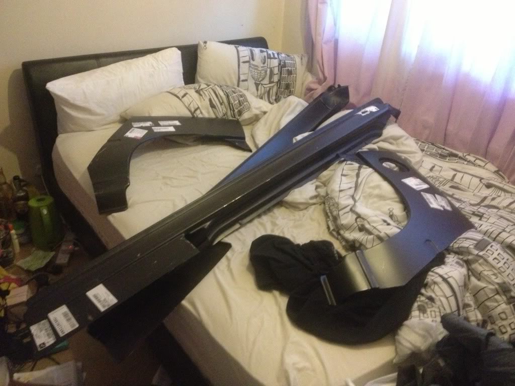

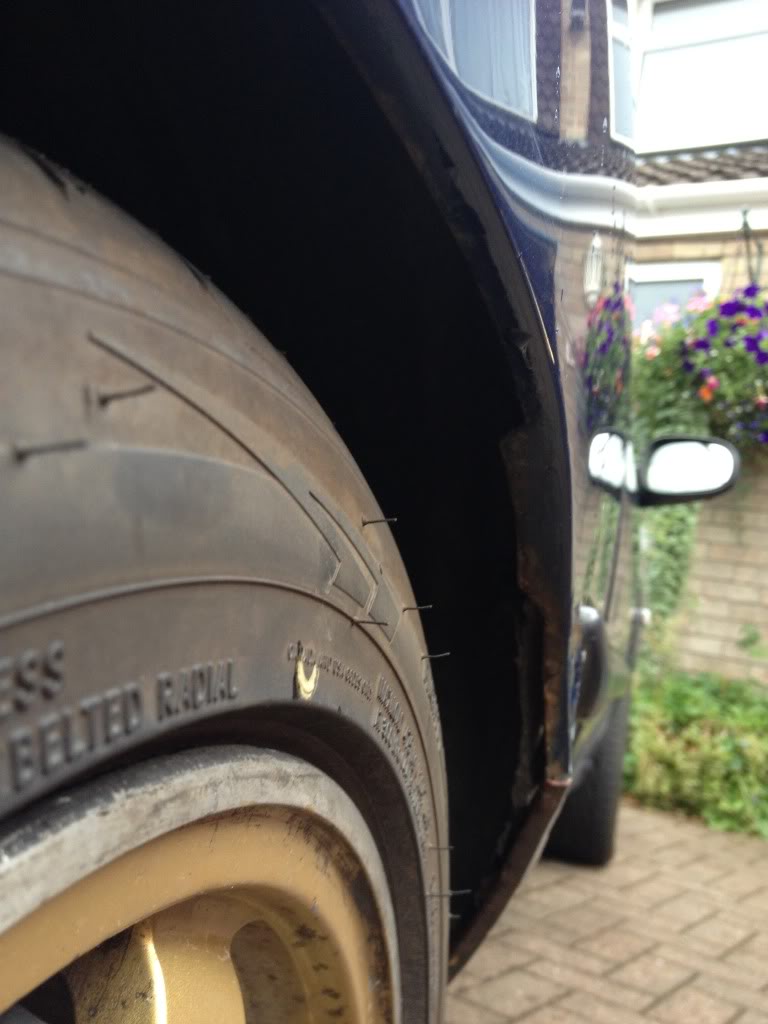

So as you guys know my rear arches arnt really there so I bought some pov spec panels for my magician of a father to make fit the valver, this will be done around september:

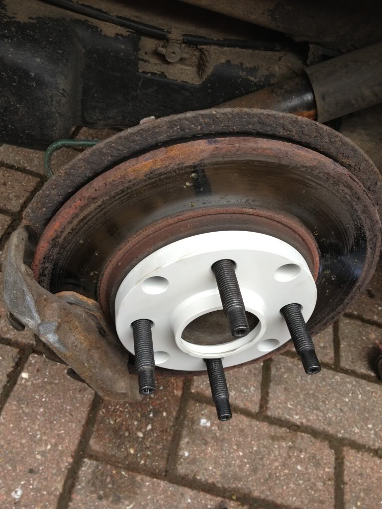

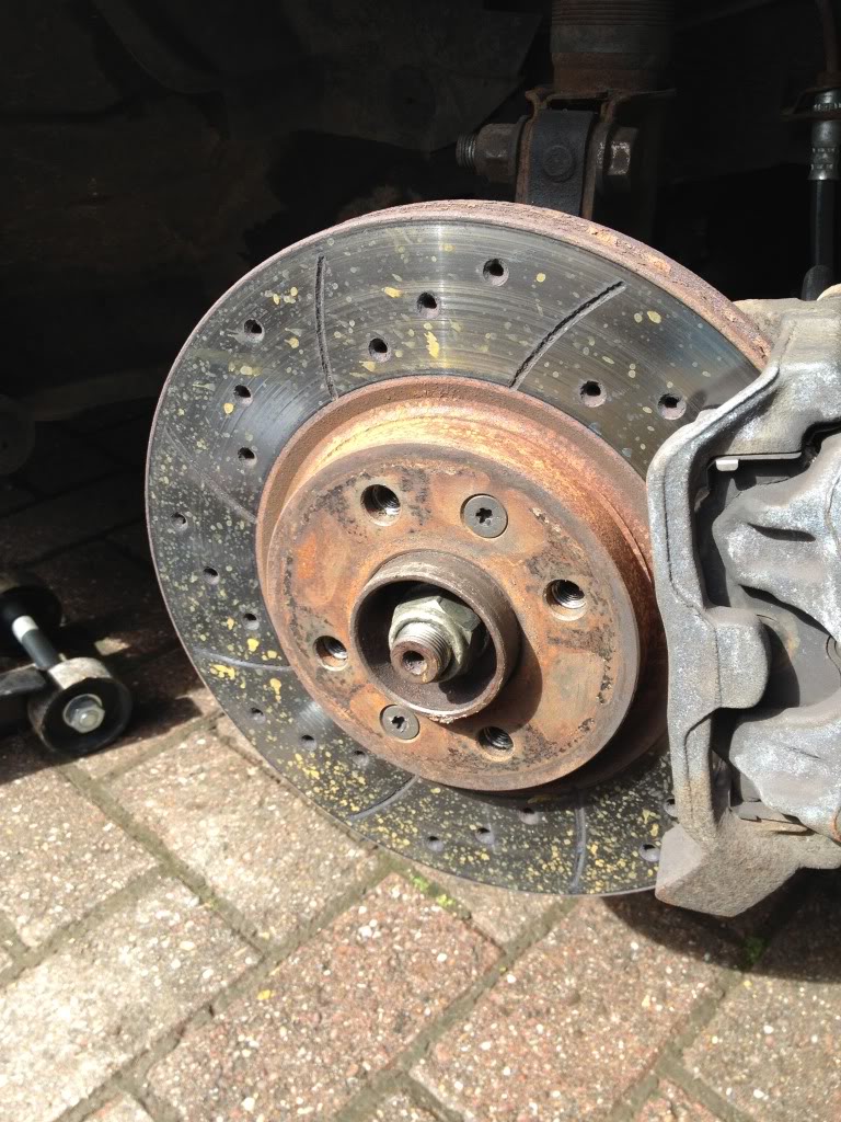

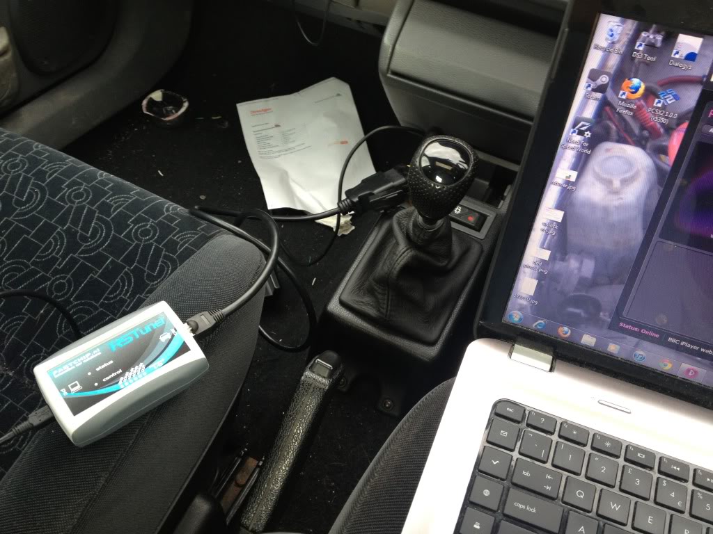

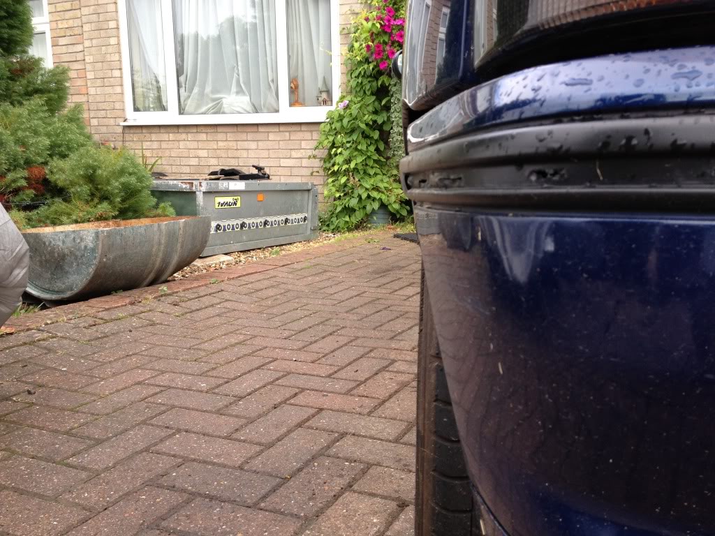

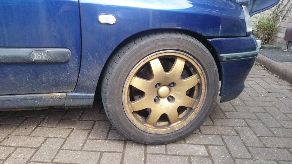

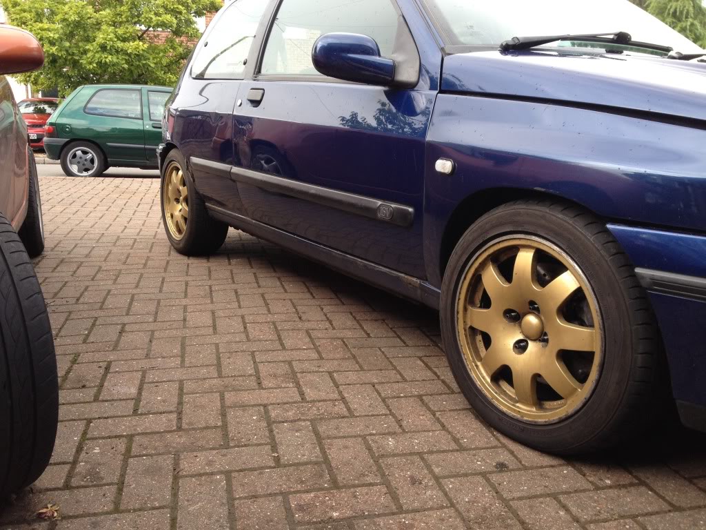

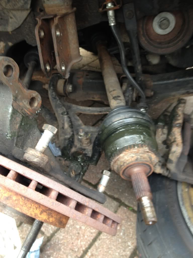

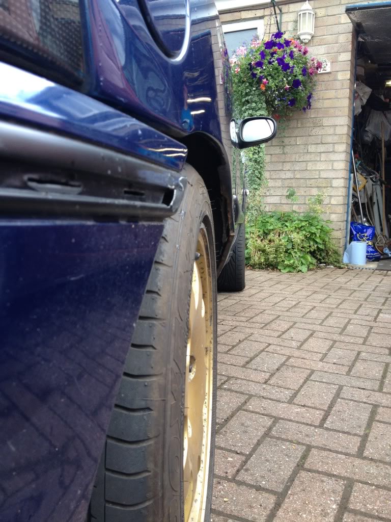

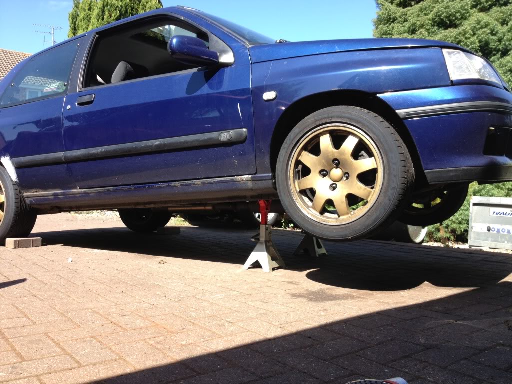

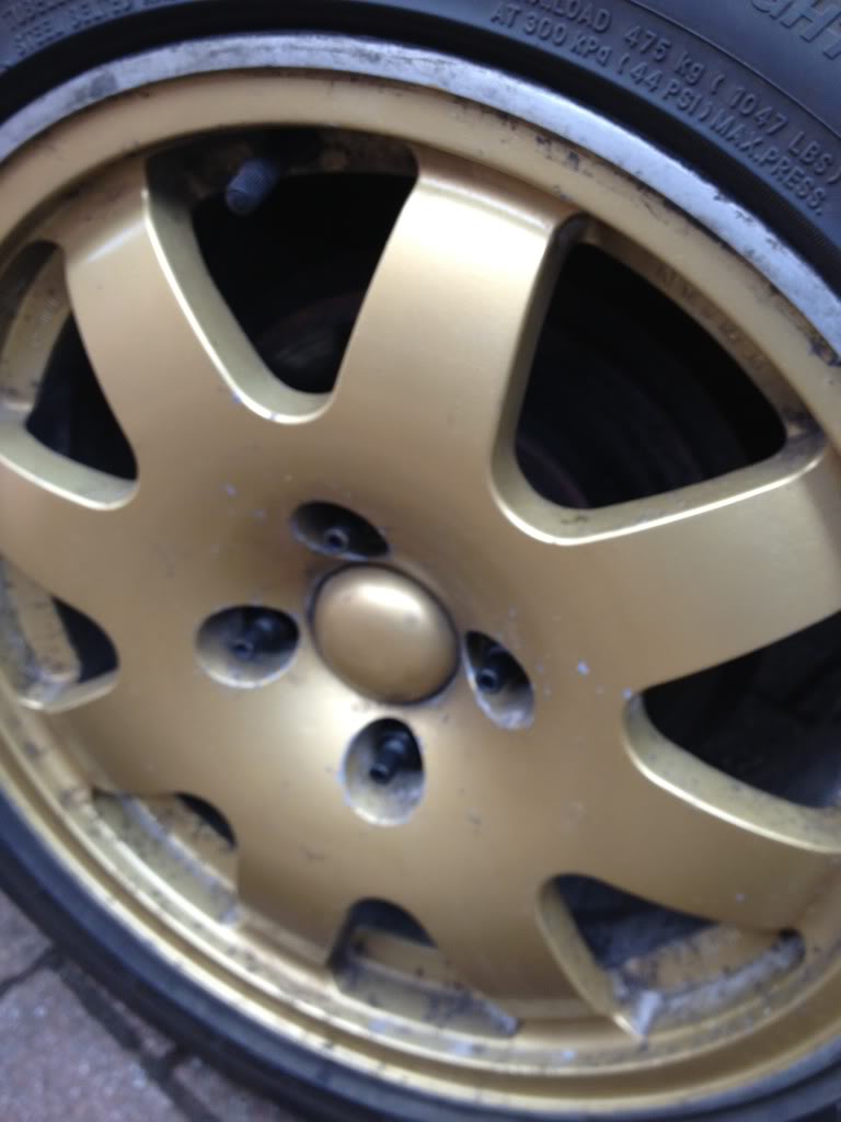

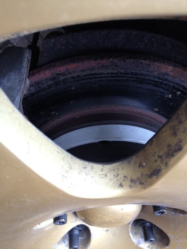

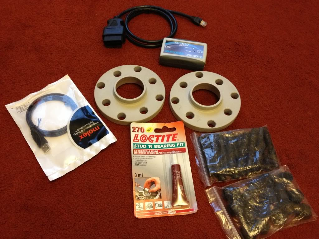

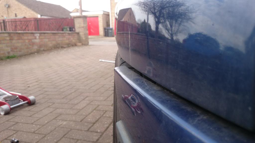

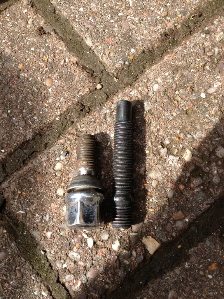

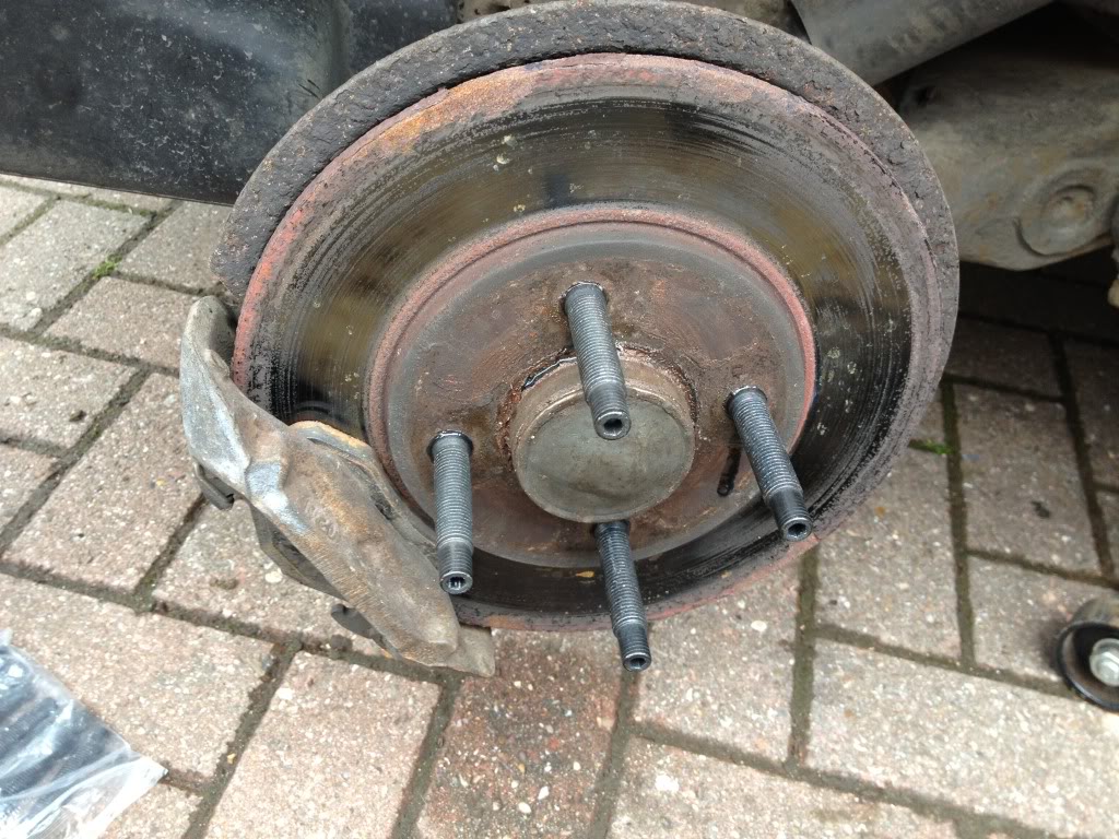

I wanted to put some 15mm rear spacers on the back so that the track difference between the front and back was the same as williams widetrack thus improving the handling. I also needed longer wheel bolts obv I didnt want to trust the dirty cheap bolts that come with the cheap spacers and so chip talked me into pure motorsports stud and nut kit as from his experiance cheap stud kits stretch alot, these purchases set me back about £230/£240 as I bought the decent alloy eibach spacers after seeing them at pvs was really impressed. Whilst I was in a spending mood I bought an RSTuner for the 98ron map and error code abilities:
Before:
Quite a big difference:
Doesnt look like a huge difference but it makes it handle so much better its crazy

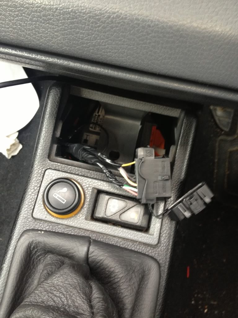

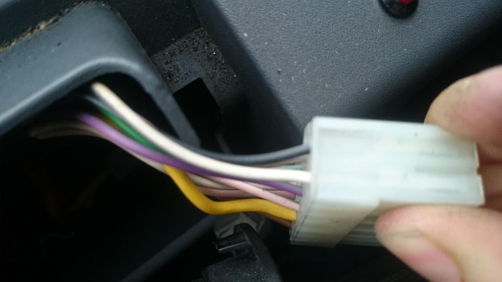

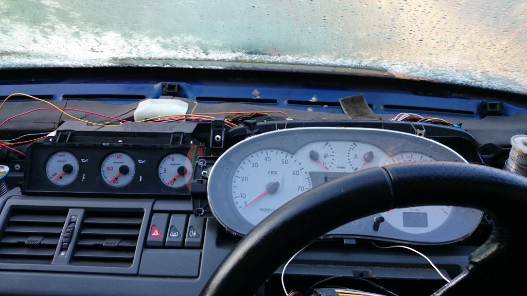

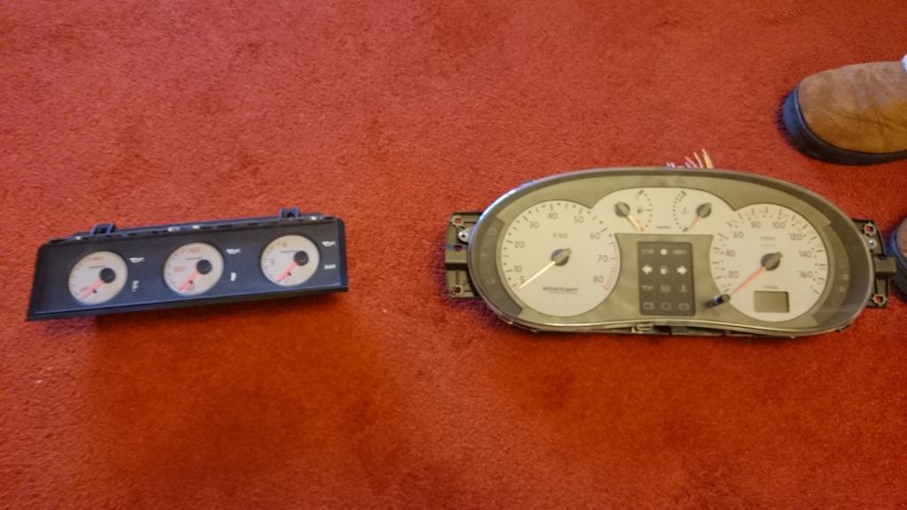

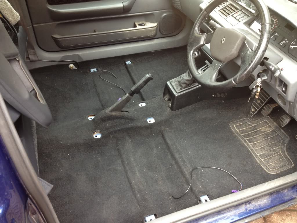

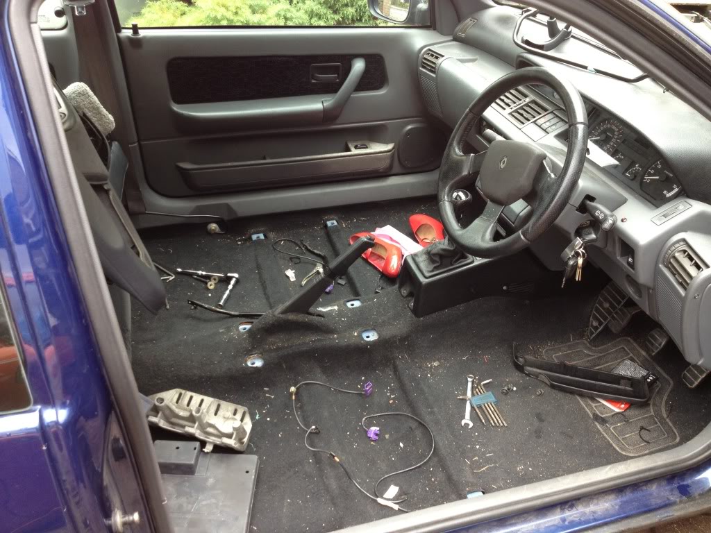

Then I set about wiring in the OBD port I lobbed out the 172 loom, put it under the ashtray like in a 172:
Mapped the 98 ron map with the rstuner:

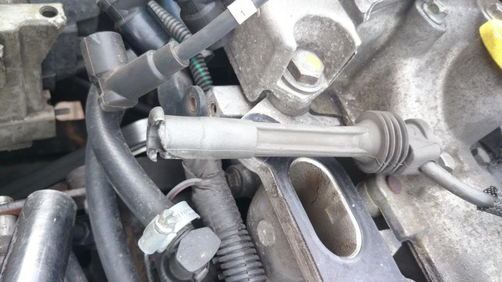

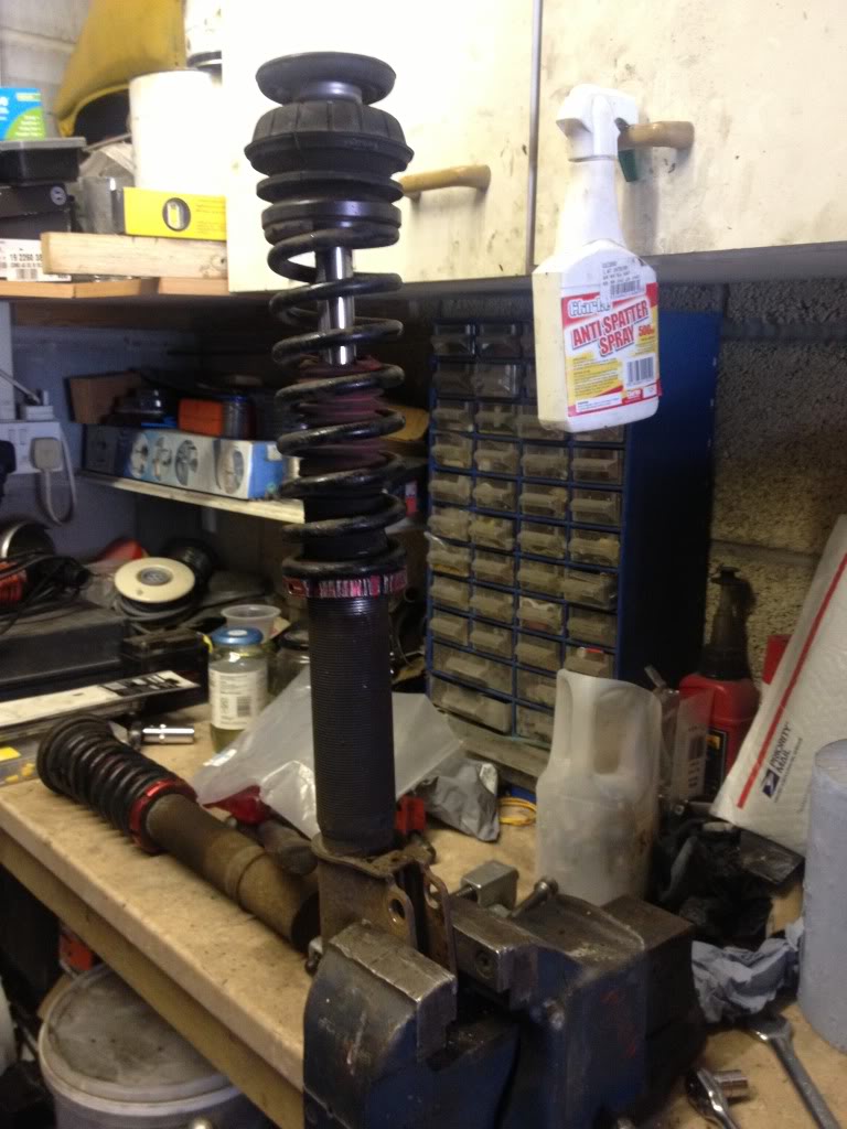

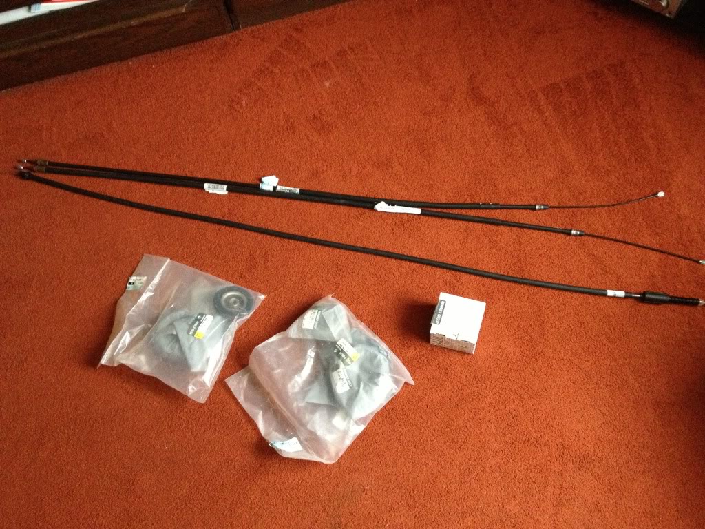

Noticed my spring was making spring noises on turning and so bought new top mounts, the h brake was crap as i was sold drum brake cables and my throttle cable frayed so a phonecall to adam at renault later and it was christmas for the second time this month:
New top mounts fitted:

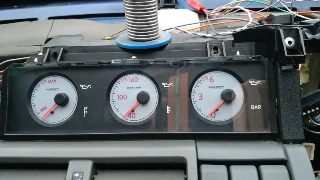

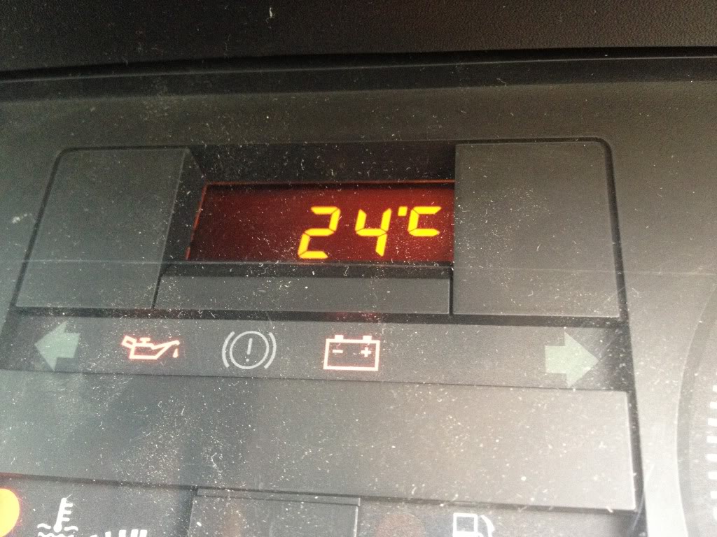

And I finally got this working so thanks to peter on c16v for giving me some bulbs:

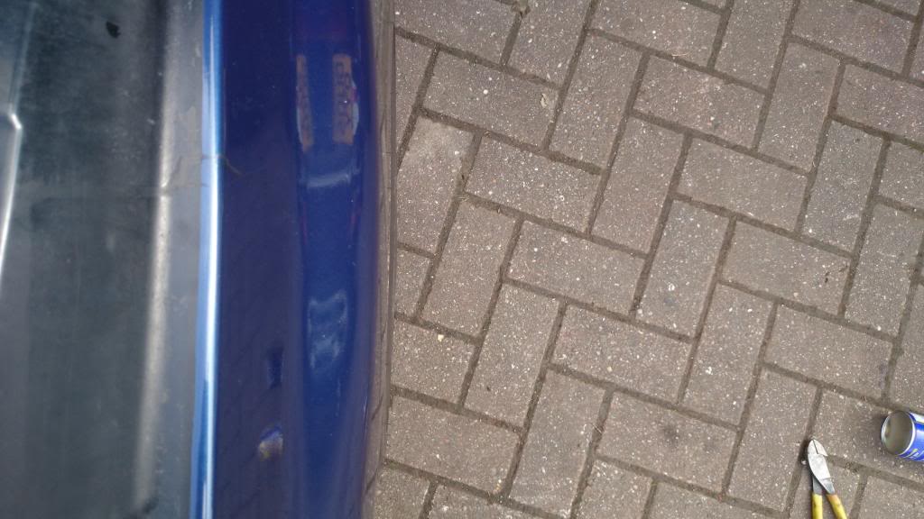

MOT tomorrow so have bodged the arches to make do till new ones go in!
