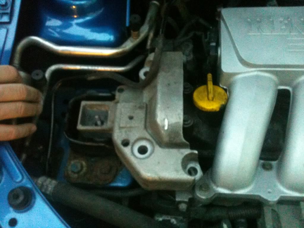

Taken engine cover and inlet off to clean. Was just putting it back together and when i turn the engine over i have service lights and it idles at 2000rpm but if you press the pedal nothing happens. what have i done wrong? I thought i'd reconnected everything properly. The only thing i couldnt put back on was this, couldnt line it up but its only a cover so doubt its causing those problems:

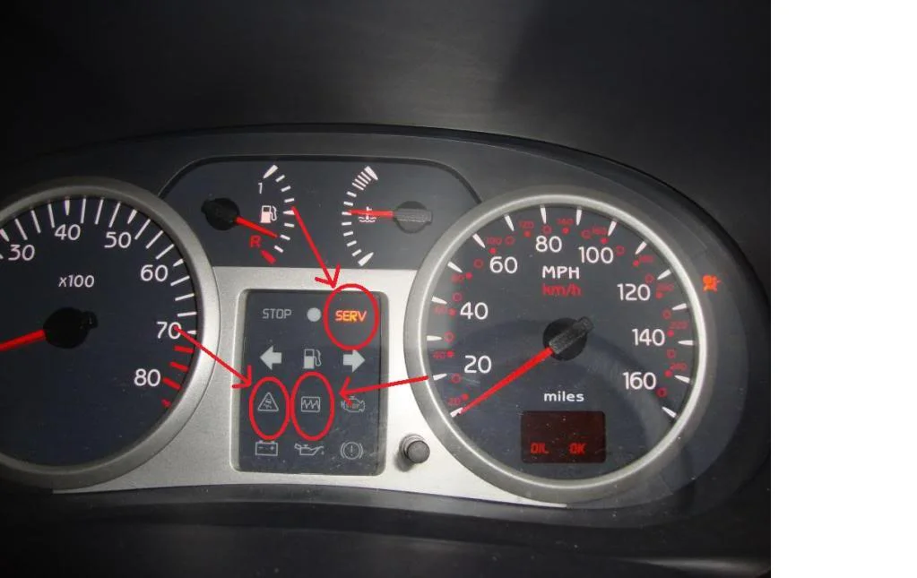

The service lights i had were these:

Yea undo the mount again and jack the engine up and get that right. The throttle cable is just behind/below the intake pipe
jenic
You need to jack the engine up
This, jack the engine up to line up the mount and then put the bolts in.

and fwiw the 2000rpm idle plus lights on is limp mode , in case you didn't know .

Thing is if the op just thought that was a cover, will he be able to fix that mistake properly?

Don't take this the wrong way, but please seek help before you touch the car again.
  2003 Clio 172
What the actual f?
That is your bucking mount, seriously..........scares the s**t out of me to see this.
If you dont know stuff like this, please.....PLEASE get someone to work on your car. Dont take offense, its nothing to be ashamed of but if you thought all was well there you could have seriously jeopardized peoples lives, notably your own fella.

That engine mount holds the engine up, without it you are resting the sump on the subframe, do NOT drive it.
The high idle and total lack of response to the throttle are almost certainly either a duff throttle body or you havent plugged the throttle body back in.

I can only imagine the threads are shagged on the mount bolts now too. Bet they were really hard to get out without the engine being supported
will have only damaged the very end couple of threads of the last bolt undone at worse as it will have been supported till then , tap and die should clean it up ok if that is the case but realistically the bolt will probably just retap it ok when it goes back in anyway if the housing is a little damaged.
