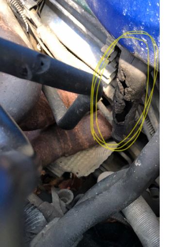

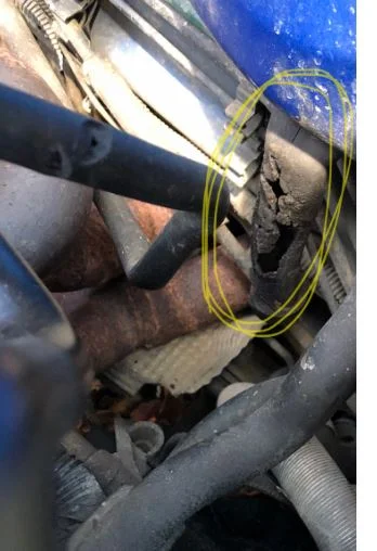

Hi, I've recently got a new Clio 182 which I bought as a blind gamble off ebay and as expected it has faults (it was cheap so knew there would be issues).
whilst checking it over today down the back of the engine I've found a damaged pipe (brake servo vacuum I've found out) and a well and truly melted one as per the picture. Can someone tell me what this one is for please? heater drain vent, cabin vent ???
Thanks in advance.

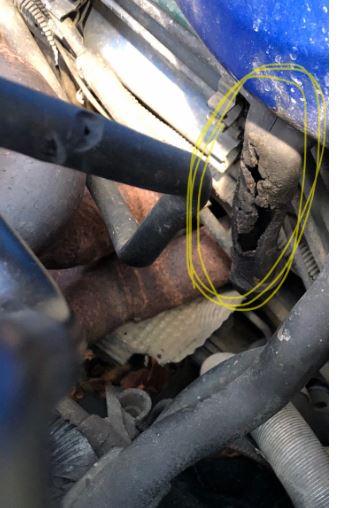

Thanks in advance.

scuttle panel drain hole

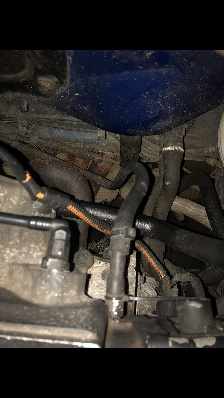

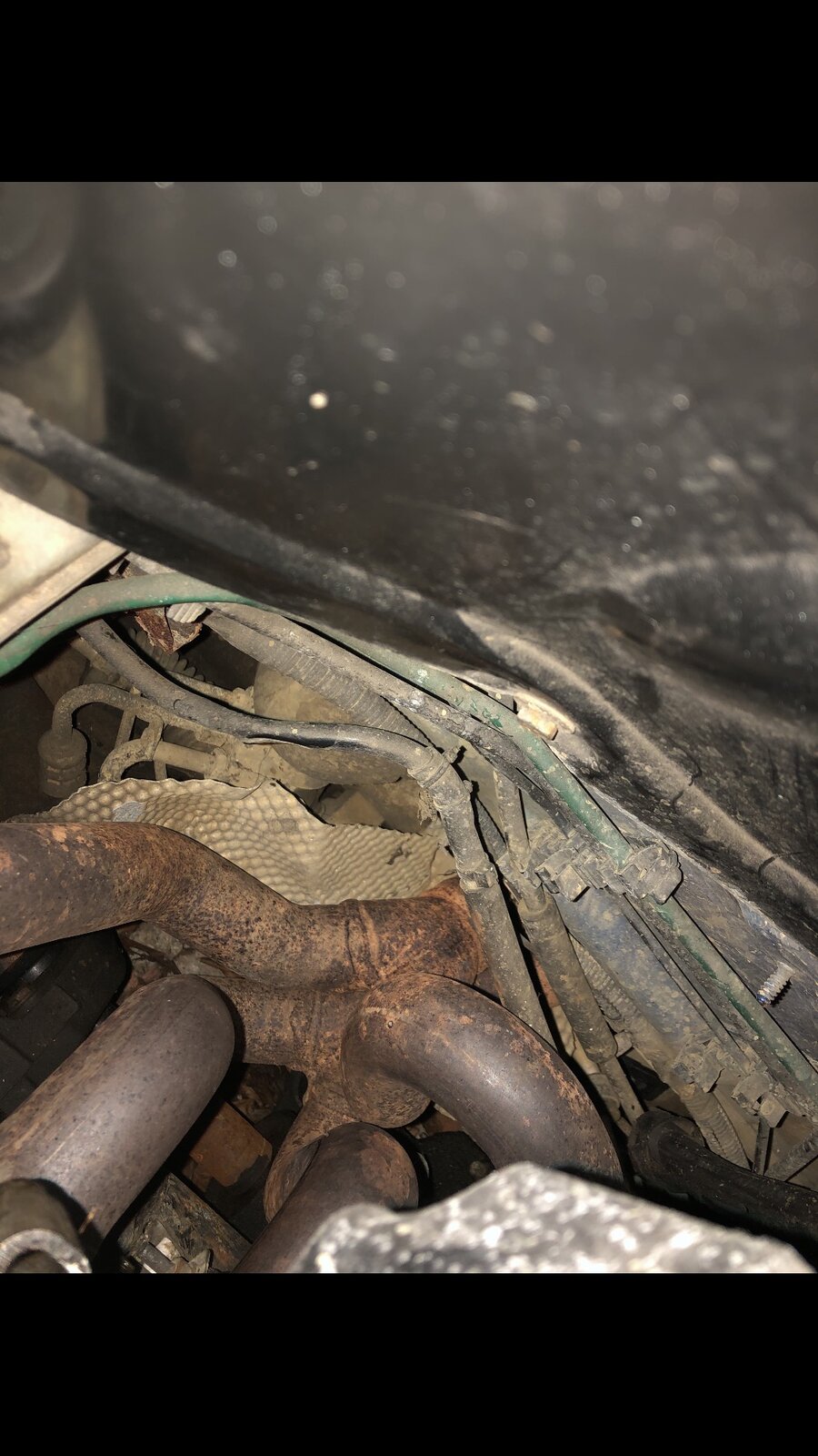

follow up question. Does anyone know where i can get a replacement brake servo vacuum hose/pipe from please? The one on mine, apart from having holes in seems to be a right bodge job at the manifold end and 3 bits and a dent half way down towards the mc.
Yep that's a right bodge, get an ad up in the wanted section someone on here will help you out. @Mbeau is/was breaking a 182 recently
I did sell the servo and vacuum pipe to @MRBILLYUK, but his brake issues have been resolved and I don't think he used them in the end. Cheers @DomP182

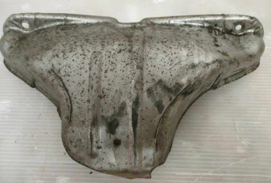

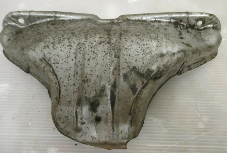

Thanks for all the replies guys. All greatly appreciated. The more bits i fond on this one the more i'm tempted to sell it and buy a different one lol. For the heat shield, do you mean the main black one against the bulk head or one over the exhaust manifold like the one in picture. Apologies for all the question but hard to work out whats missing. Is the heat shield like this one?
I have just been in contact with @midge, and he has one, and is prepared to post it.
I will send you a PM with his phone number.
For reference, the std PH2 172 & 182 share the same vacuum hose 6000073687.
