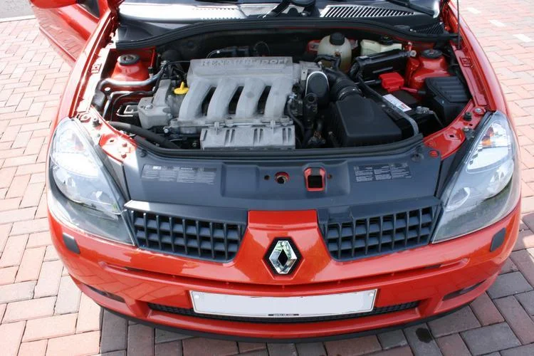

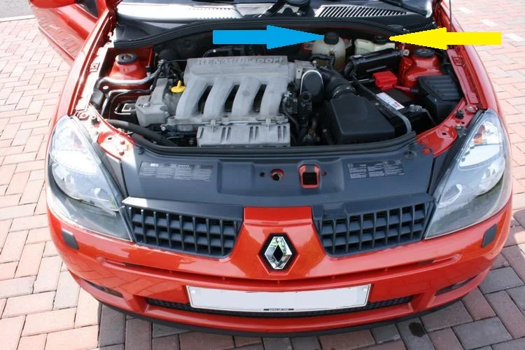

Just topped my water for the windscreen & noticed the yellow arrow was quite low, just below the min mark. And while I'm at it, I might aswell ask what goes in the blue arrow. :rolleyes:

ps. above is a random pic I found on the net, my car is a 182

Suppose I should be helpful :)
(Although the Blue one EVERYONE should know)
Blue is where you put coolant/water
Yellow is the pas fluid reservoir

PAS fluid should not be randomly low and could be the sign of a leak. Get they looked at, or mark where it currently is and check it weekly for a few months. If it doesn't move, don't worry as long as its above min.
