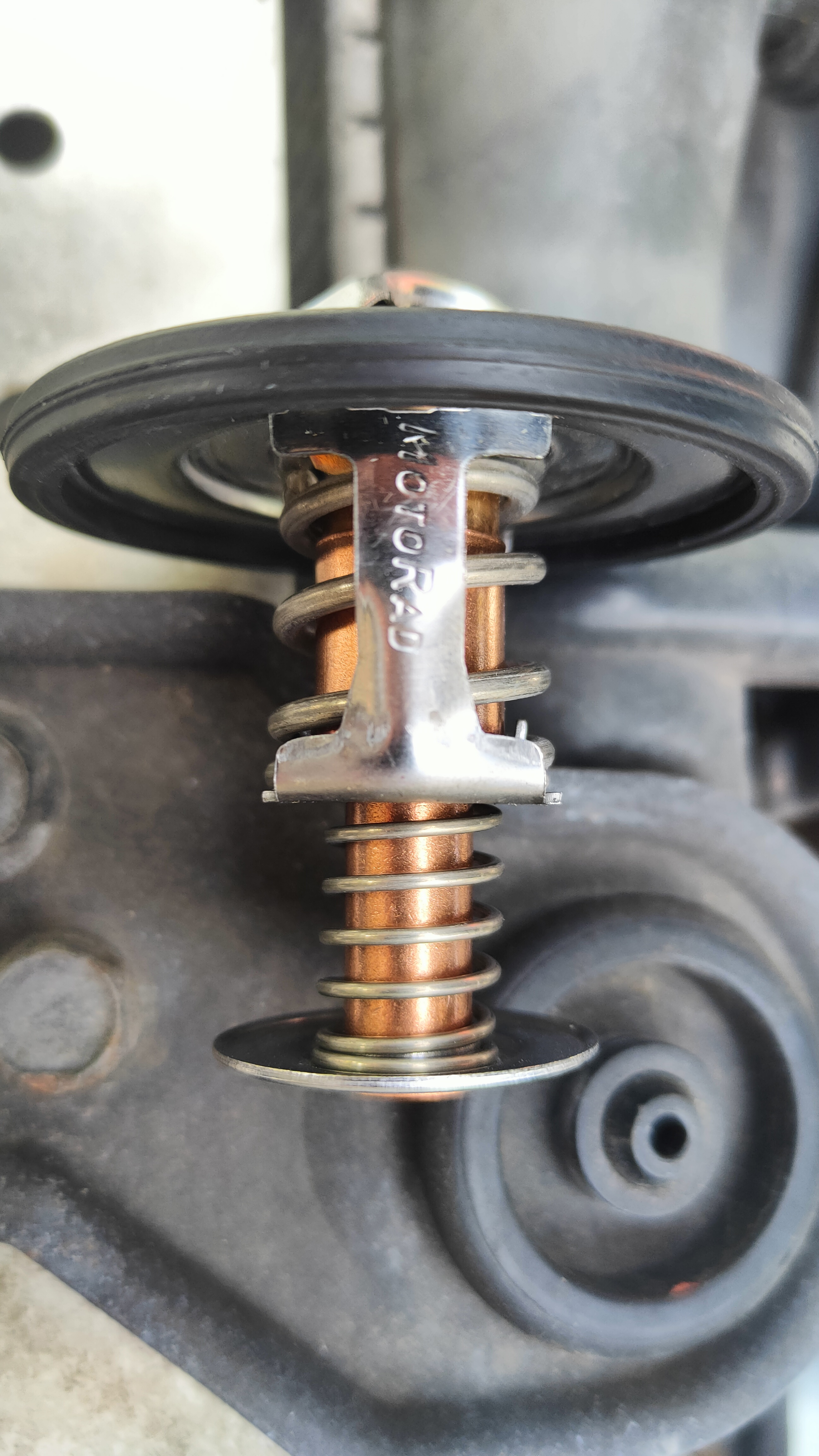

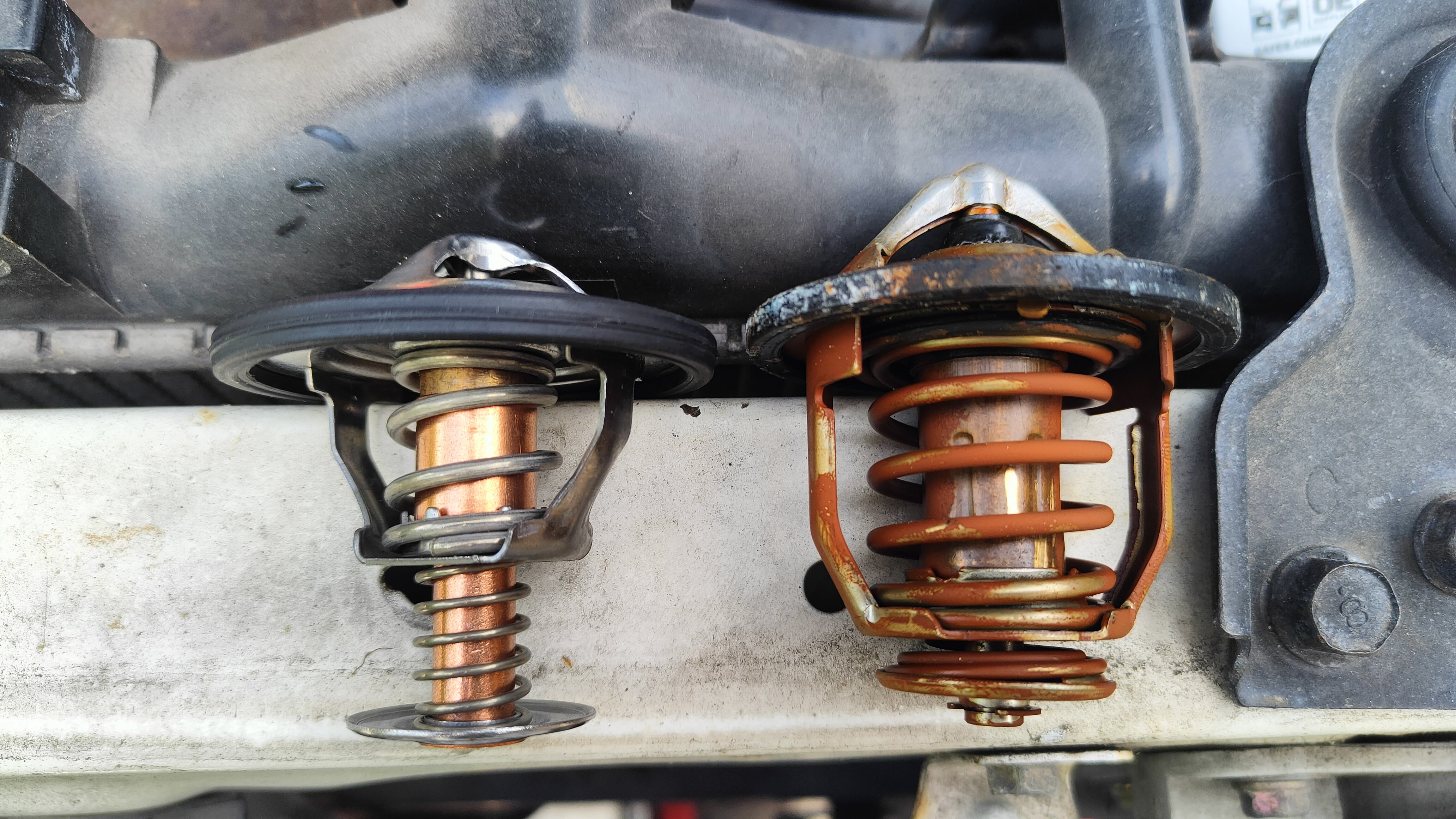

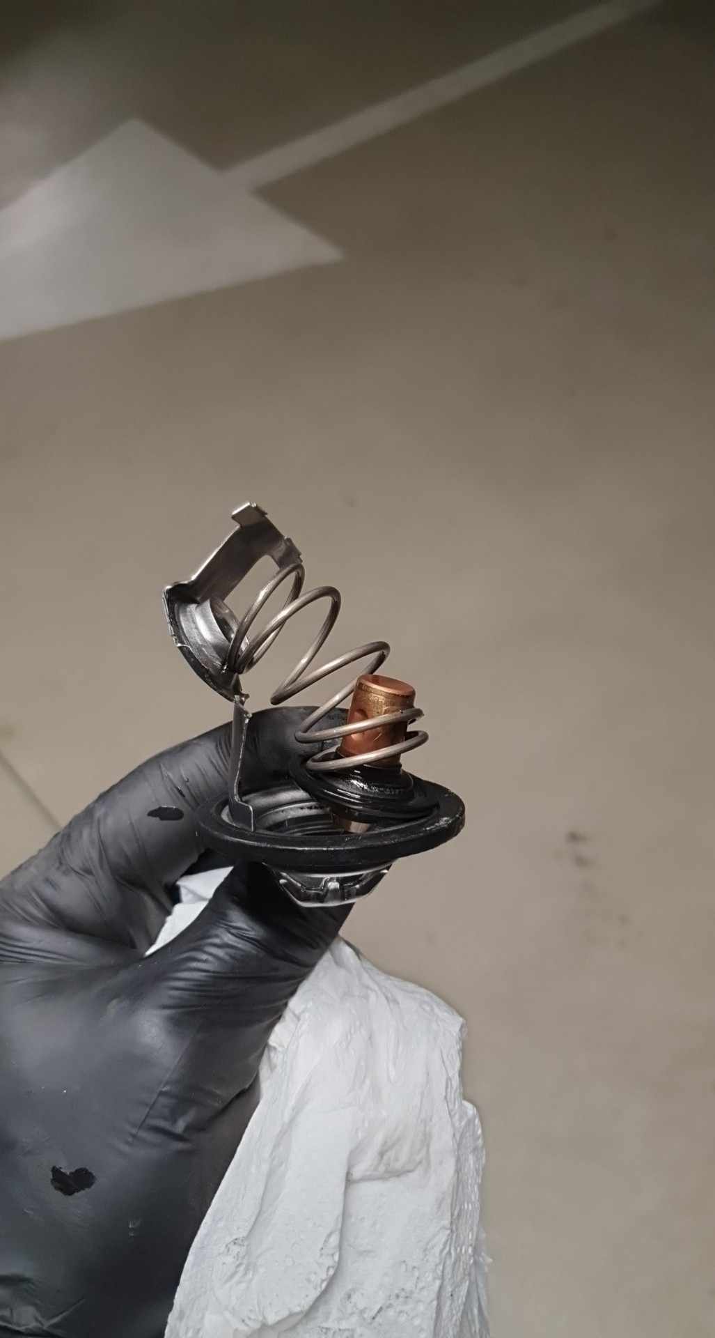

Just replaced my thermostat the other day. Question is- why do these fail SO BADLY? It basically shredded apart wtf. This is the second one in the last 3 years, the original one lasted 15 years or so
Any ideas? are there some stronger units out there? 367387414_360215903123561_9060464989000280390_n.jpg
MLB
Wow, I've seen a couple of bad ones but this is another level of bad😳

O.e or aftermarket?
All made of finest chinesium thin steel now i guess.
On the older cars they used to stick closed which was bad so id say breaking or sticking open is the better out of the two, but still sh*te.

the guys that installed it said it was original. Anyway, the one I instlled now is 100% original as I did the job :). Let's see now
