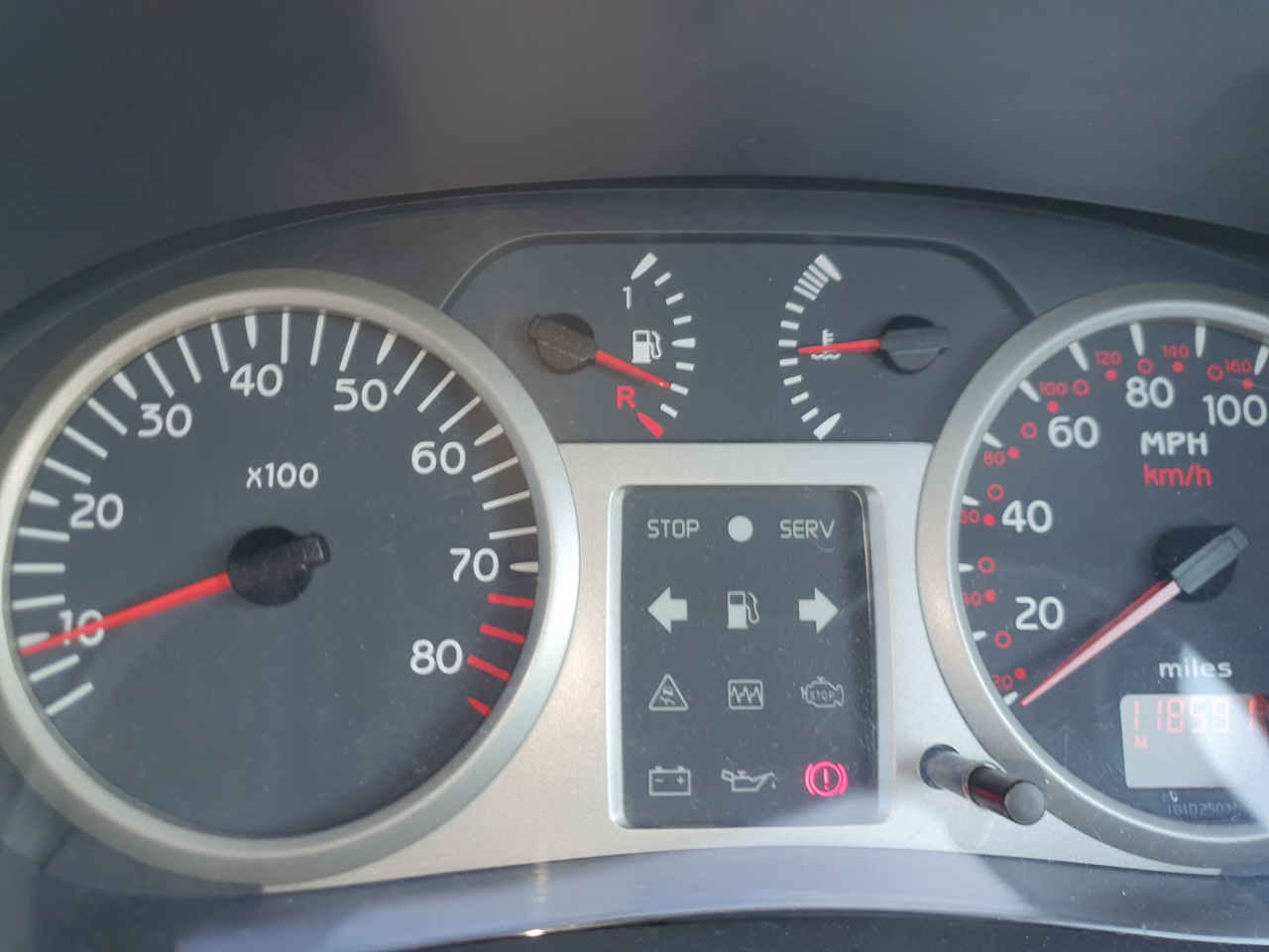

I drove the 182 6 miles to work this morning. I had the a.c. on to demist the windows to begin with, but it stayed on all the way to work in auto climate mode set to 26 degrees. It said the temperature outside was 5 degrees when I got to work, so not too cold and plenty of driving under load. Sat idling for 10 minutes and it still didn't get to temp. I've been noticing this a lot recently where it doesn't seem to get up to running temp very quickly and even after reaching half way will sometimes drop down a little again.
This was sitting at work
Is this most likely to be the coolant temp sensor at fault? Or the thermostat itself?
Thanks for any help

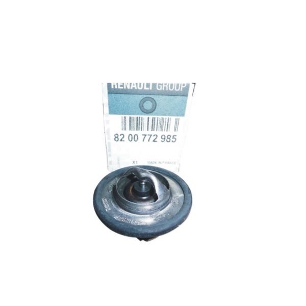

I've bought a genuine Renault thermostat & coolant temp sensor and will be replacing both as well as new coolant.
I think if you do the same it will fix your issue.

I replaced the thermostat and temp sensor and this morning it was fully up to temp after 2.5 miles with the heating on. That was driving in 30mph traffic and 6 degrees. Before I could drive 6+ miles with the heating off and it wouldn't hit the middle.
So I think that has definitely fixed the issue 😁👍
Do you have a link to the parts you bought? Glad its sorted!
