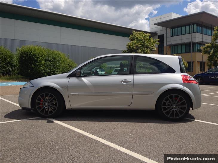

Few pics from the advert
So a deposit was placed down and I returned a couple of days to collect the car, cracking drive back and instantly fell in love with the extra wave of torque produced by the boosted f4r and it really made progress on the way home and even averaged 33mpg sat at 80 ;)

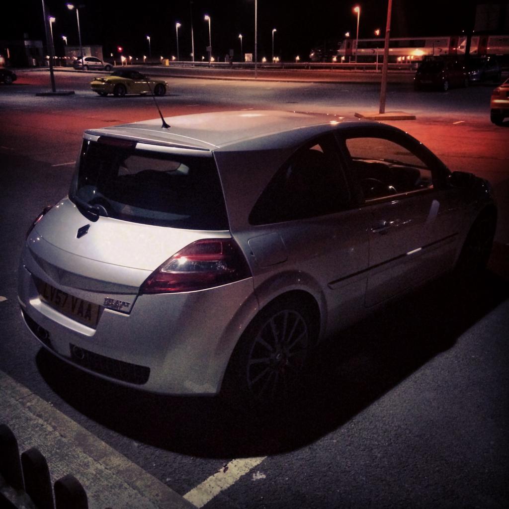

Day I fetched it
and night after parked up at work

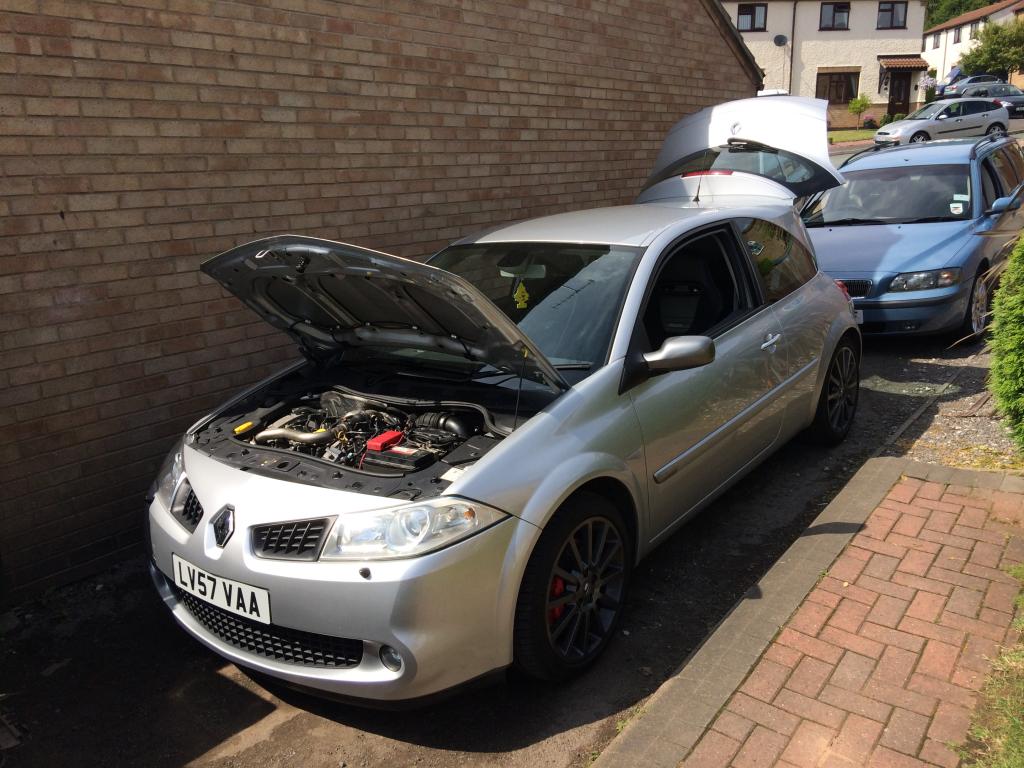

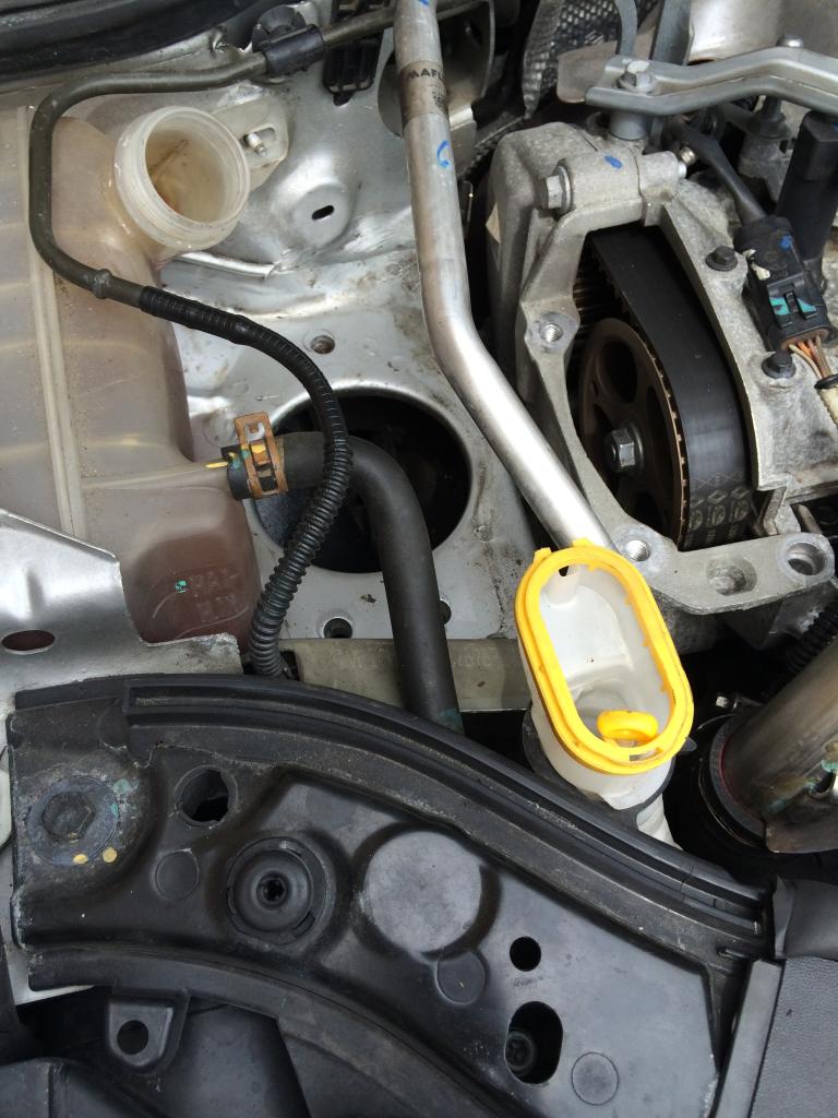

So after mentioning the injectors I got on the phone to Ads at Wolverhampton Renault and ordered a new set. They promptly arrived and I set to work

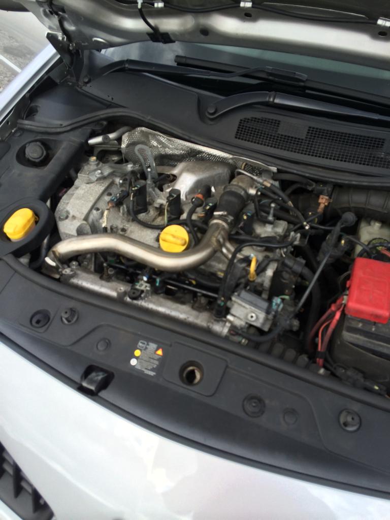

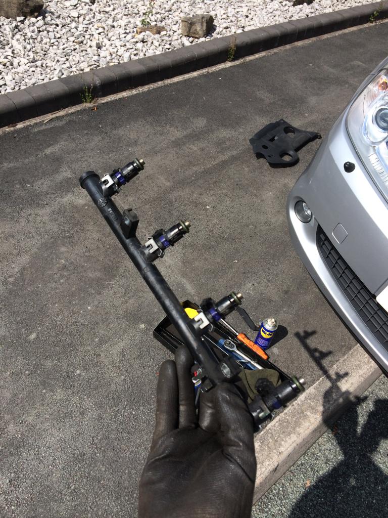

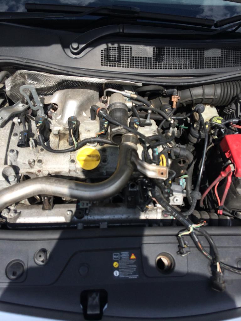

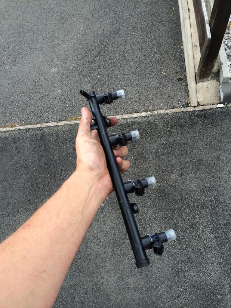

So I stripped off the boost pipe and the injector loom off and removed the fuel rail and injectors
Old injectors
New injectors
[FONT=Verdana, Arial, Tahoma, Calibri, Geneva, sans-serif]
[/FONT]
All done and back together and fault resolved, seems injectors are fairly common for clogging on these so I've kept hold of the old ones to get cleaned and keep as spares

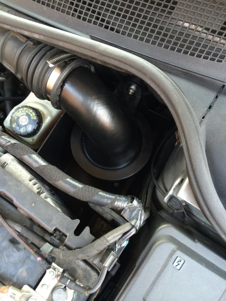

Well thought I'd post a few pictures of the ktec induction kit I fitted last week.
In terms of quality of the kit it's a nice fit and comes with a nice looking heat shield and a couple of mounts

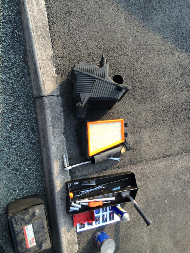

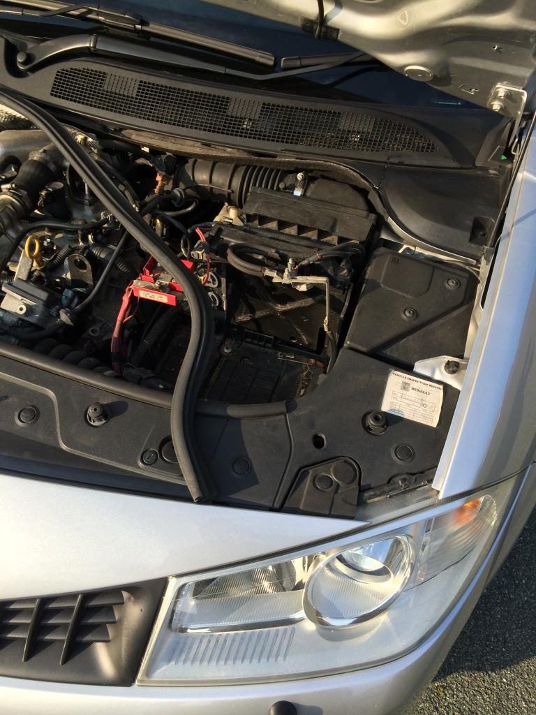

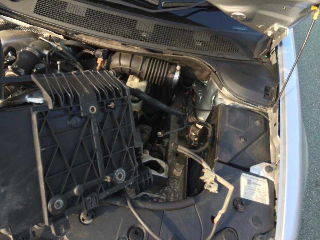

Recovering the old airbox involved removing the battery and battery tray and swinging the ecu over to one side, then I had to cut down the intake pipe a few inches to accommodate
Battery out
Old airbox out
Battery tray and ecu out the way
And the kit fitted

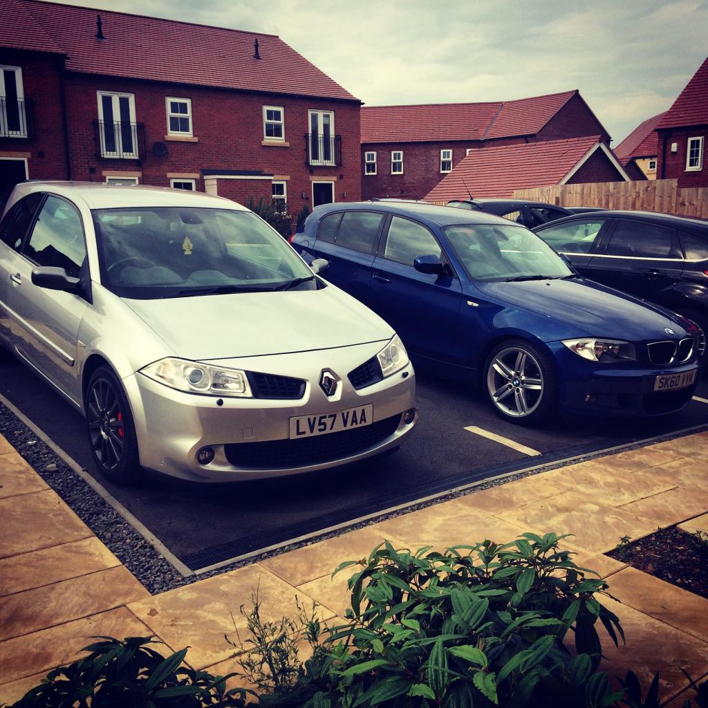

Another pic with the sensible 1 series ;)

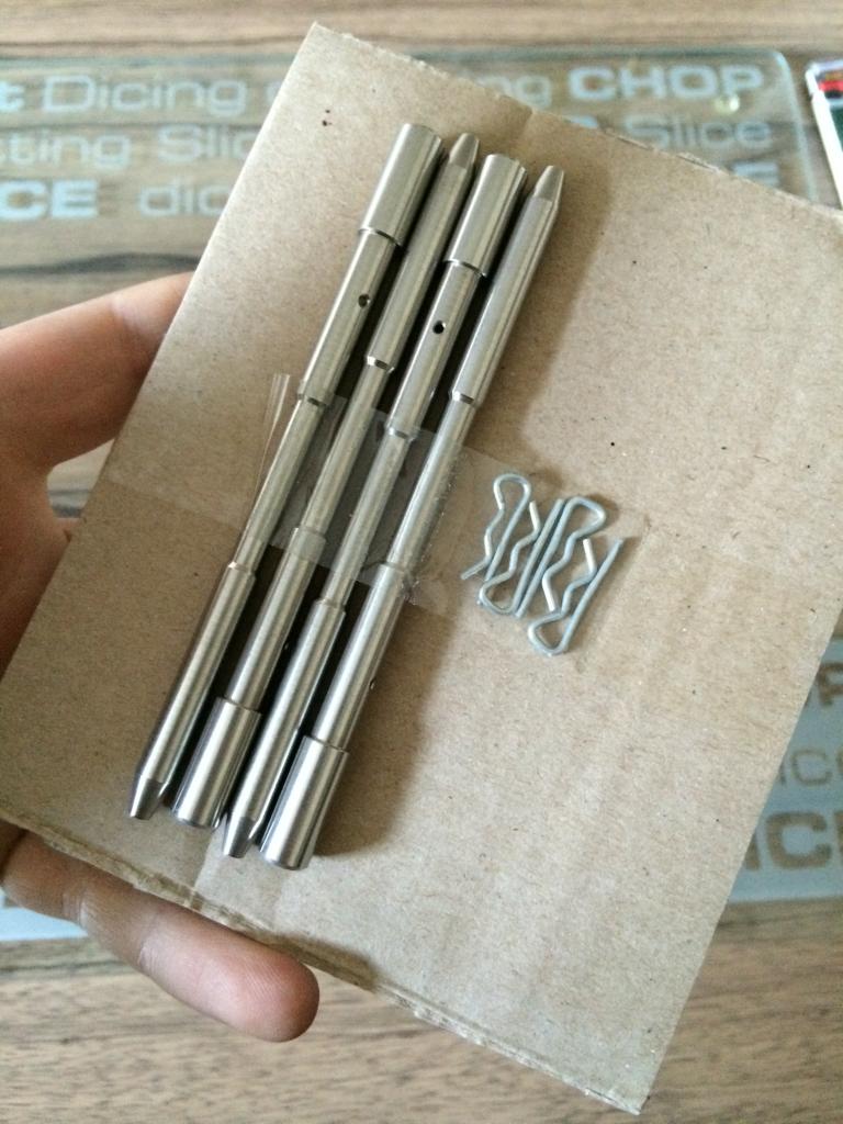

So I missed the post man the other day so just popped into the sorting office just on me way home from work.
I had a suspicion it would be these
The redesigned Mr Pink brake pins, I had these on my old 197 and the design is much better and makes brake maintenance pretty much hassle free

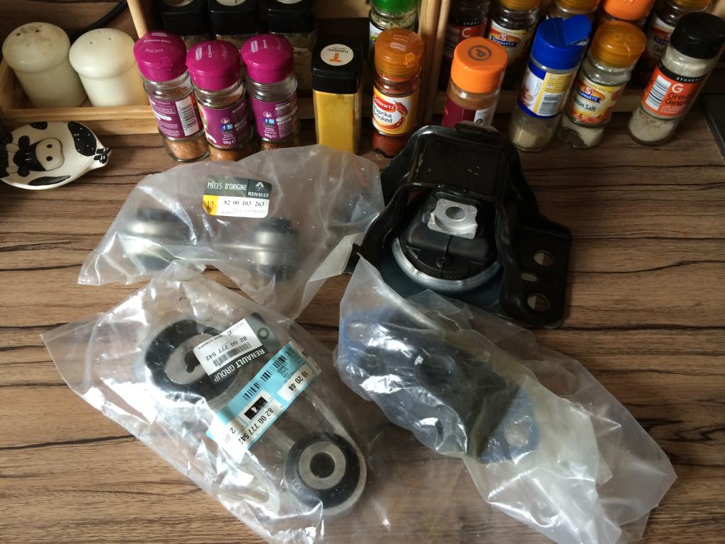

Well he's done it again, Adam @WolverhamptonRenault has done a sterling job.
Ordered the mounts yesterday and here this morning
Can't rate this guy enough, knows his onions and very competitively priced and a top bloke

What were the symptoms of the failing/gunked up injectors? Lack of performance?
Cheers mate
I got a slightly irregular idle but more noticeable was the "coughing" from the exhaust.
Eventually I think they bring a light on and can cause fuel cut but mine weren't quite that bad but I don't do things by half so I just stuck a set in it.
I'm having the old ones cleaned and flow tested and keeping them as spares, the actual injector coils resistance tested bang on

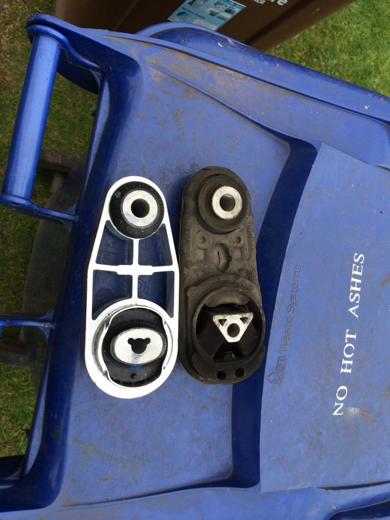

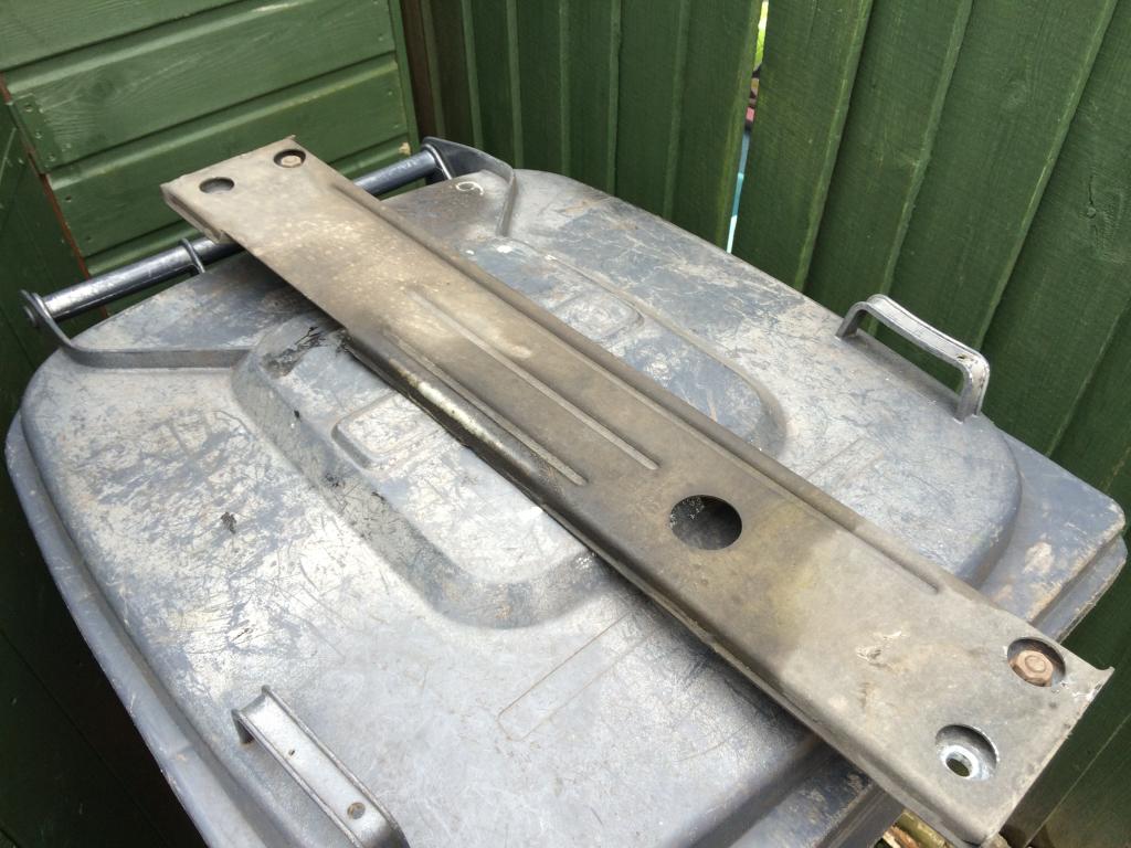

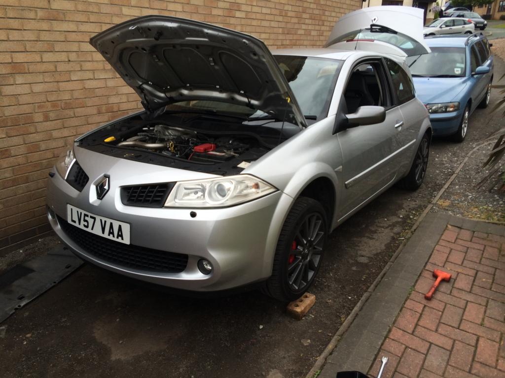

Well today I woke up after me last night shift and thought I'd crack on and get these mounts changed before I head up the pub this afternoon.
Started with the lower stabiliser, nice to say I found no nasty surprises underneath too which is always a bonus.
Anyway I removed the reinforcement plate to gain better access so here's a few pics

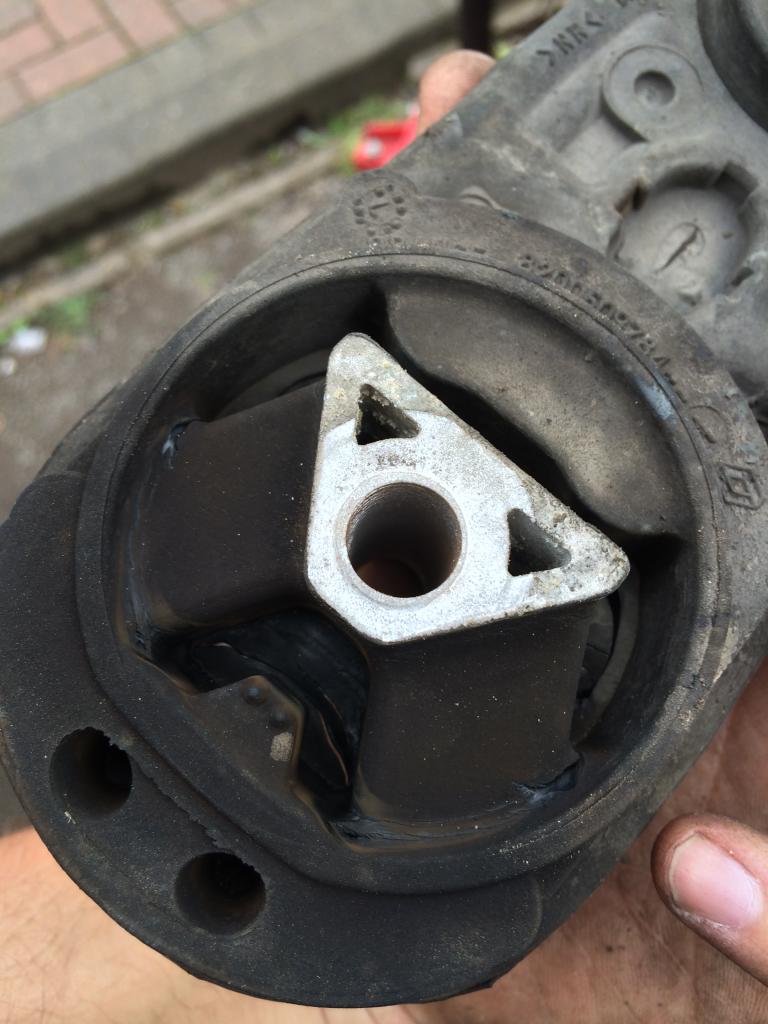

Old mounts showing signs of cracking and delaminating
Renault have clearly changed the design slightly
I then went ahead and changed the drivers side mount and the small link there, this was a little more awkward due to the aircon pipe being in the way but it came out in the end

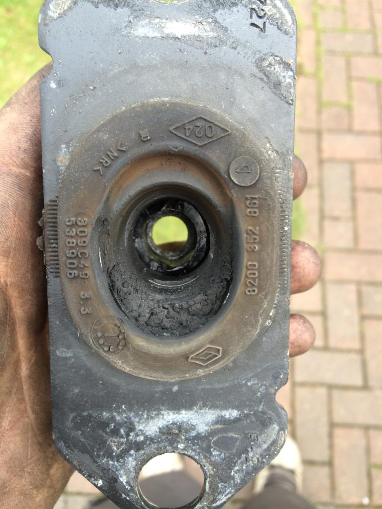

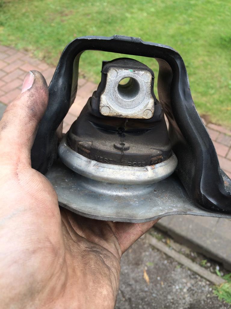

This was one of the mounts i suspected to be causing the problem due to common issues owners have, here's a picture of it showing the crack formed and sagging caused by this

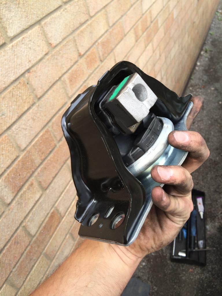

And here's the new mount

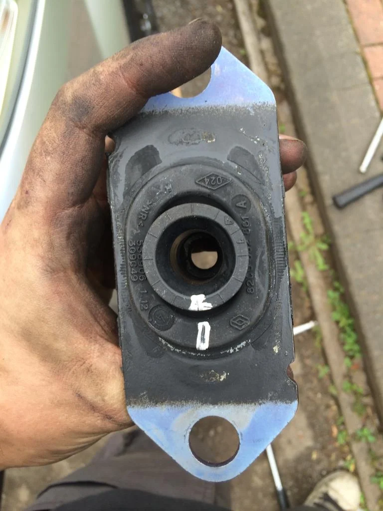

Next up was the gearbox mount which also had a lot of movement in it whilst the car was idling, this involved removing battery and battery tray and moving the ecu, also had to remove the ktec induction kit
Old mount showing extensive wear
New mount

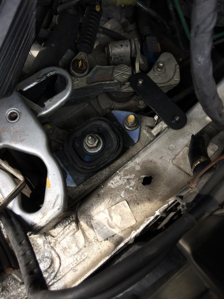

And the new mount fitted

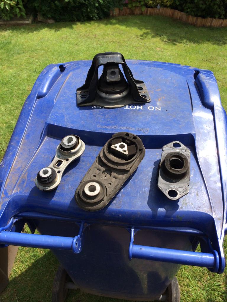

Another picture of the old mounts
And the car all done
Must say it's transformed the car and the annoying vibration on idle has now gone and the gear change is a lot more positive.

Those new mounts look a big improvement over the originals/what you took out
Yeah it really has transformed the drive, I'll be keeping the stabilisers as spares but the rest will be in the bin.
Looks like Renault may have changed the design/materials too
