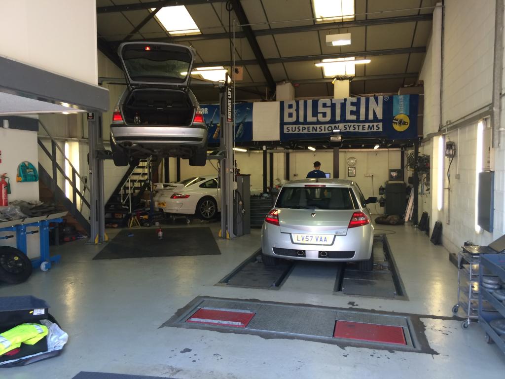

Well today I was working down at centre of gravity in atherstone changing a clutch and duel mass flywheel on a 330d for a friend who happens to work there and his farther in law owns the business.
There very well known and well regarded within the Porsche circles when it comes to geometry and chassis and suspension tuning although they work on all sorts of road going and race exotica

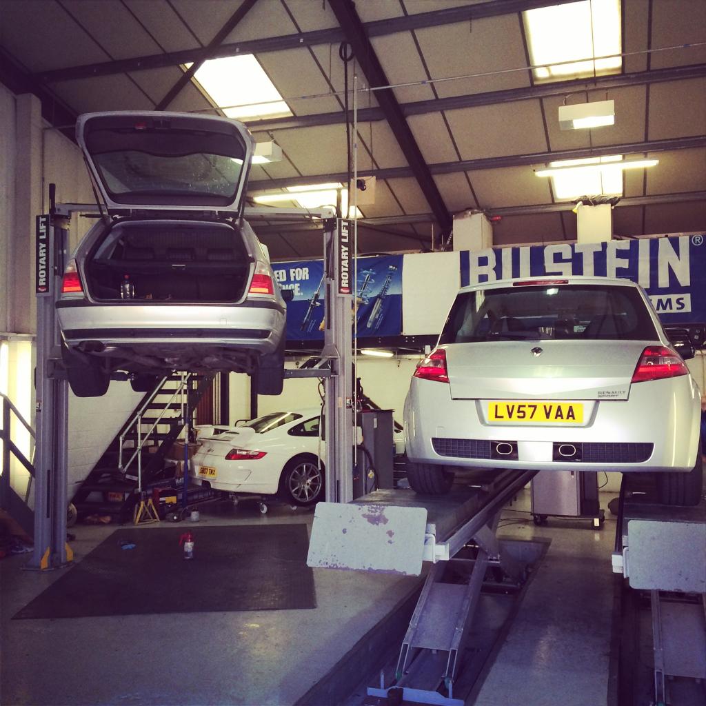

After finishing the bmw we stuck the meg on the ramp just to makesure things are pointing the right way before my ring trip. As expected the front needed a minor tweak but everything else was above board.
I was very surprised at the rear alignment and how well it was keeping track after experiencing the clio rear beams.
For now it's all been set as standard but once back from Germany I'll be going down the coilover route and full corner weight and geo setup for specific needs

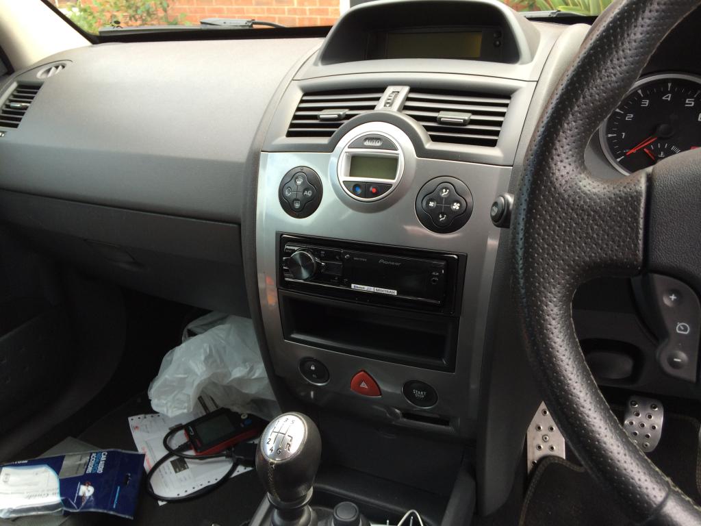

So I couldn't resist, sick of the standard Renault head unit and lack of connectivity so I bit the bullet and got myself a nice new pioneer unit from bass junkies in nearby Derby.
Main features I wanted out of the new unit.
Bluetooth connectivity
Aux/USB/iPod/sd card
Connectivity with car controls
And a non calculator style display
So I went for this unit
Came in at 285 with all the required looms and facias. Also the display illumination colour is changeable which is a nice feature so it blends in with dash.

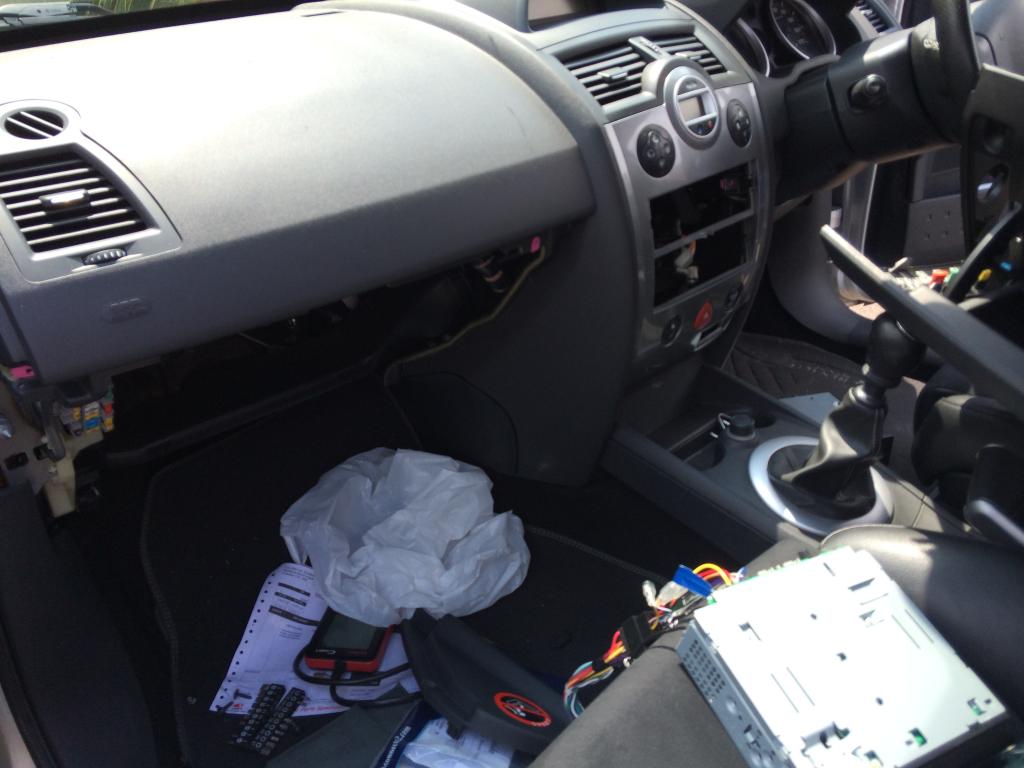

So here's a few pictures of the fitting.

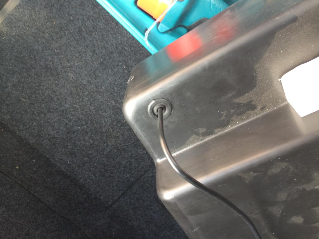

First off I removed the standard unit and the glovebox
Then drilled a nice hole and fitted a grommet in the glovebox for the routing of the USB cable and to keep things neat.
Then I connected all the connects2 loom and installed the cage, facia and head unit
Then tested it all and I must say I'm really happy with the improvements

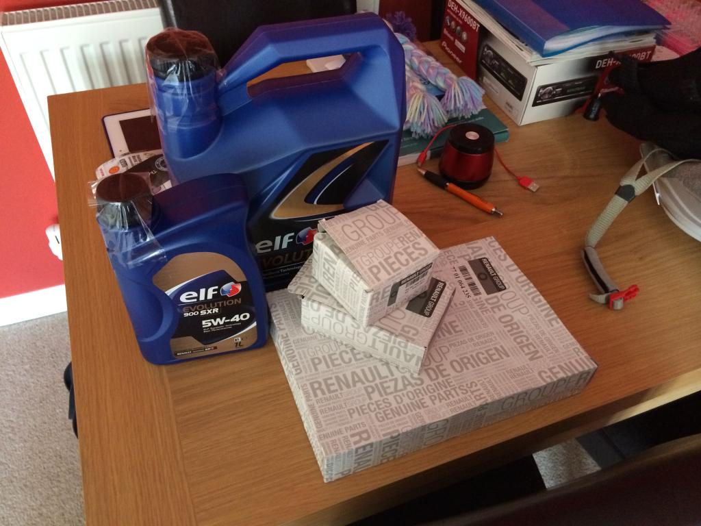

So had a parcel today, nothing overly exciting just some service bits from Adam at Renault Wolverhampton
Spark Plugs
Oil
Oil filter
Pollen Filter
Also ordered some ferodo DS1.11 front pads from G172

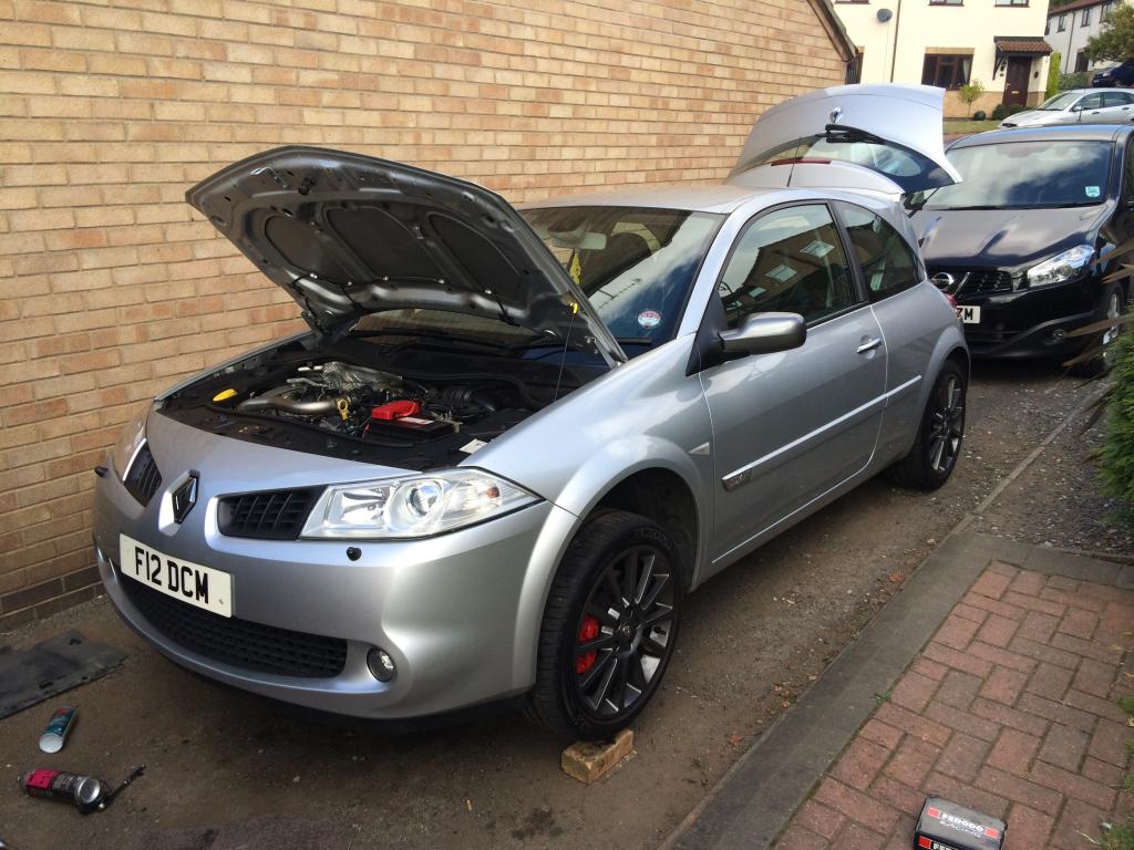

So today I decided seeing as I finally had a bit of spare time I'd fit the bits that were gathering dust behind the sofa.
These were
Ferodo DS1.11 race front pads
Me Pink brake pins
And oil and filter

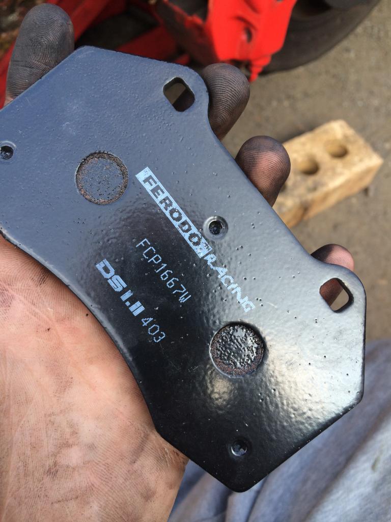

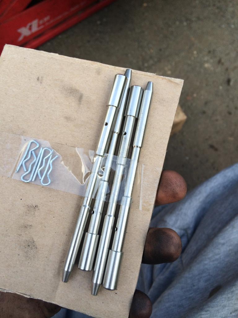

First things first I thought I'd crack on with the brakes. Now I've fell victim to these w**k pins before on a few 197's which resulting in me angle grinder coming out but I knew these hadn't been done that long before I bought the car.
So I did the passenger side first and a good whack on each pin and they shot out! Then I removed the pads and gave the calipers a good clean
Old pads and pins out
New pads :)
New pins that use an R clip to secure instead of a w**k piece of what looks like lead
I fitted these and then moved onto changing the oil in prep for it's first trackday next month.
Genuine oil and filter was used supplied from Adam. Just been following the bedding in procedure on way home so hopefully I'll be able to give the brakes some stick soon but they already feel great over standard
