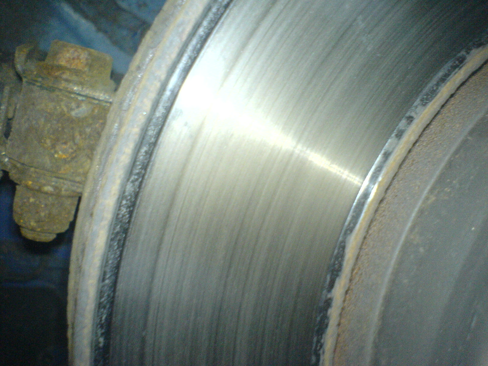

The brake discs have quite a biggish lip on them and they seem to of had a good life but I am no mechanic so haven't a clue if they need replacing. The ticking noise comes on when the brakes warm up and gets louder/more noticable the hotter they get. So if they aren't used for a while then you don't hear the sound as they have cooled down. They don't appear to fade and the pads look fine to me.
Could it be that I need some new front brake discs? I'm going to try and get them looked at before FCS but I doubt very much this will be sorted before it. If I can't get it sorted I'm not really prepared to risk my car, my life and others for a 500 mile trip on dodgy brakes :dapprove: But there is always next year.
if theres a lip on the disc, then 9 times out of 10, they need replacing. Have a look through your spokesat your pads, and see how much meat is left on them too
you can take the discs off and file the ridge down until its even, and just clean the discs and pads with a good quality brake cleaner. wont do them any harm

heres some pics just taken on the old phone:
