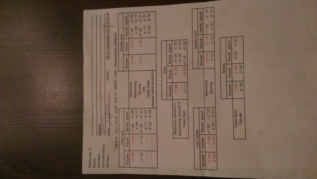

I had my ph1 sent for wheel alignment today and after getting back from work I noticed that the base settings they used were for a 2005 Clio 3 rs! I'm guessing that there is a difference between how the two should be setup given the different chassis and all. How far off are they? I have a printout but I can't make head nor tail of it as its dutch.
I'm hoping they will do it properly for free, however it actually feels pretty good so if its not a huge difference in settings I may just leave it?

Upload your sheet! It'll be fine though as you can only adjust toe and camber (with coilovers). Both cars are FWD and the MK3 Clio won't run silly amounts of toe or camber from factory.
Crappy pic sorry.
Front camber around -2° and 6 minutes of toe out. Is the camber adjustable on your car/coilovers? Right side got a bit more (0.5°). Setup looks fine though.
