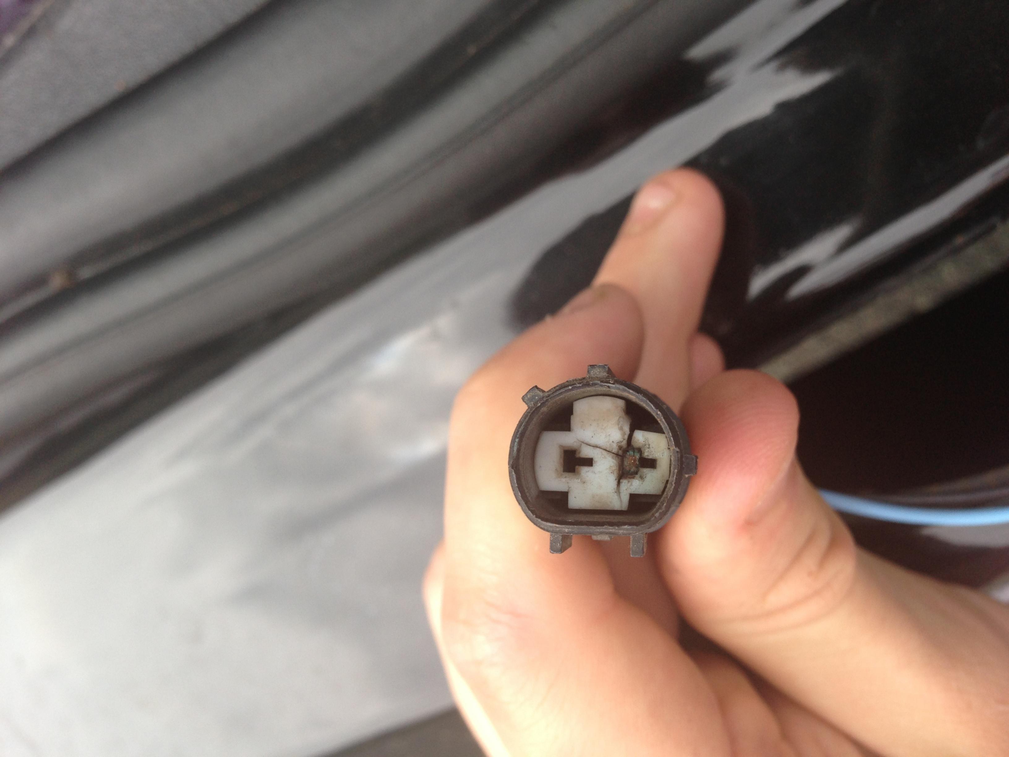

Come across this problem, my number plate light wasnt working so i brought a new housing and bulb, taking the old one out and the 2 teeth which clips onto it have corroded and snapped into the socket and now o carnt remove them :/ tryed pliers and still no budge, can i get a new part which the plugs go into? Ill get pics up as soon as i can due to bein on my phone -_-

You can buy a repair kit from Renault, Its not cheap though (Its the whole plug, plus lengh of wiring) Or go to a scrappy, Crank sensor plug is also the same.
HTH.
Depends if you want to do the job properly or not. If you want a cheap and easy repair, cut both connections off, bare back the end of each wire and use a heat shrinked crimp connector to join each wire together.
