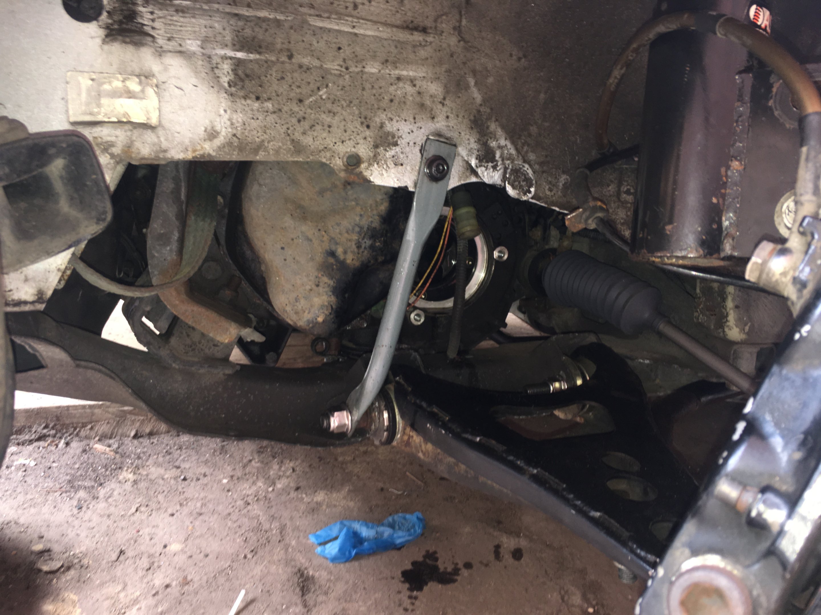

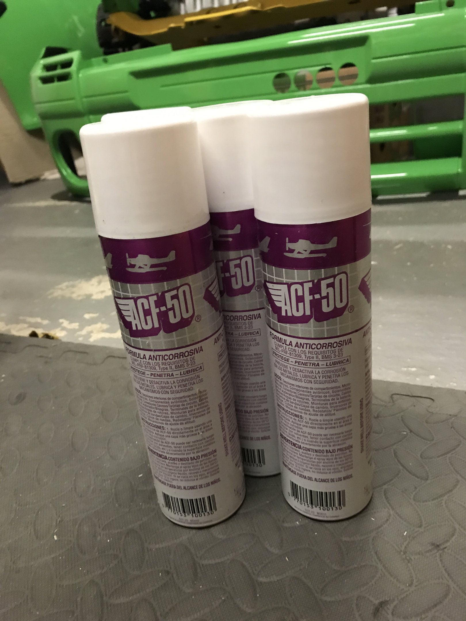

I put these bolts on the subframe support arm from this picture about 7 months ago, acf does wonders. I give the tres and shocks a coating every so often too.

Never heard of the stuff but researching now, best place to buy/bulk buy?

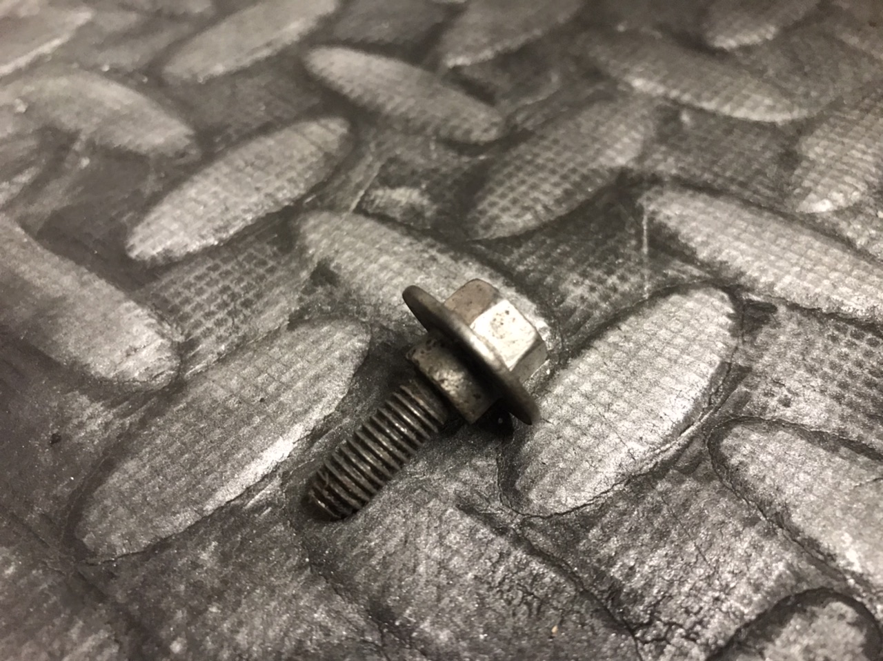

I used ACF-50 on the self coloured socket cap bolts on my bucket seat sidemounts, they had started to get surface rust after only a week into being fitted!
Just wiped a bit over the head and they still look like new.

My whole car has been sat in my garage for months and not had an issue.

ACF50 will soak into the black oxide because it's porous - part of the reason it's not recommended to use outdoors without regular maintainance as it holds water and corrodes - black oxided guns used to be strip and re-oiled every single time they were used outdoors for example as even your fingerprints are acidic enough to take the thin layer of oil off they retain (black oxide is incredibly thin which is why it's used for high precision parts where rust/weather is no issue).
Clear coat will do the same if it's thin enough, but you'd have to soak the bolts to remove the dewatering oil that's already added to a BO finish from the factory.
Having said that, both the oxide and the lacquer layer would be so thin it'd be easily damaged as soon as you touch it with tools anyway, which is why oil is normally used on oxide finishes instead because it can creep back over any scratches/damage.

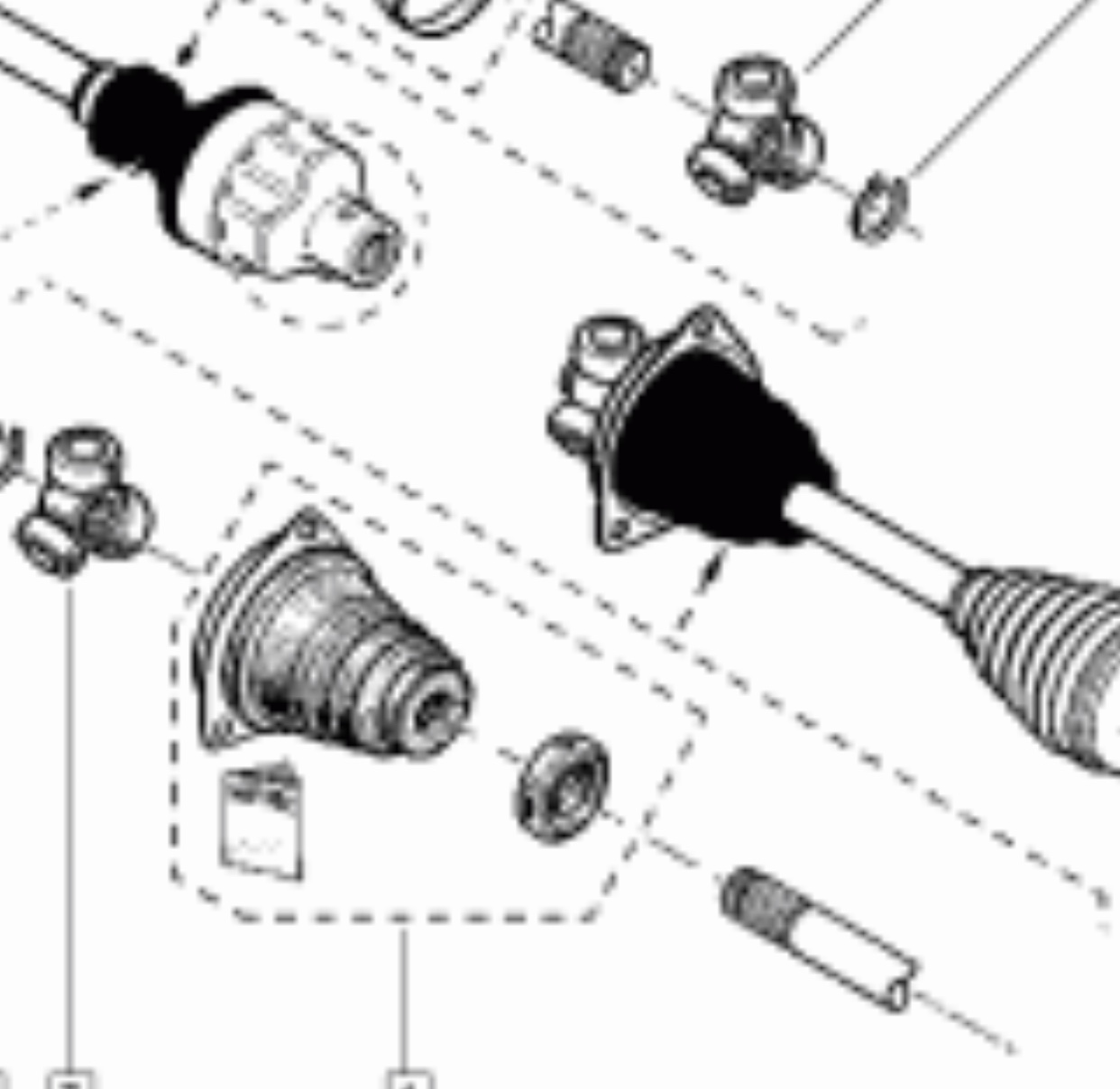

I know the bolts as I had to replace mine. I had a chew on locating them as they don’t list them on the parts catalog next to the shaft - see screenshot.
I’m sure they were an M8 1.25 x 25 mm flanged bolt - 7703602193, but see what Renault or Tomotek come back with.

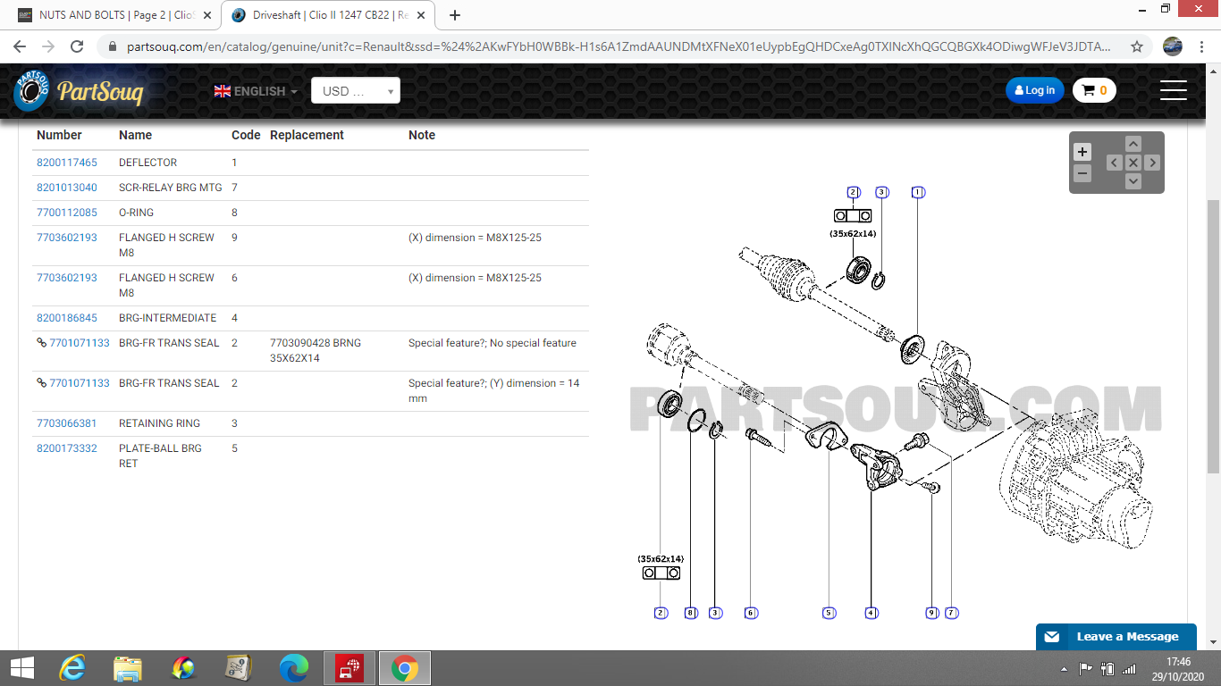

What a great site, many thanks for that.......although I'm still struggling!
The nearest thing I can find is this
The bolt I need looks like 7 (see photo below), but it has a very weird description 'SCR-RELAY-BRG MTG', and when you click on the part number it says nothing found!
The other bolts, 9 and 6, sound right M8 and 25mm long, but don't have the enlarged shoulder under the head which matches the holes in the driveshaft carrier.
If I use a straight M8 bolt it will be loose in the hole, as the 'shoulder' is 10mm diameter.

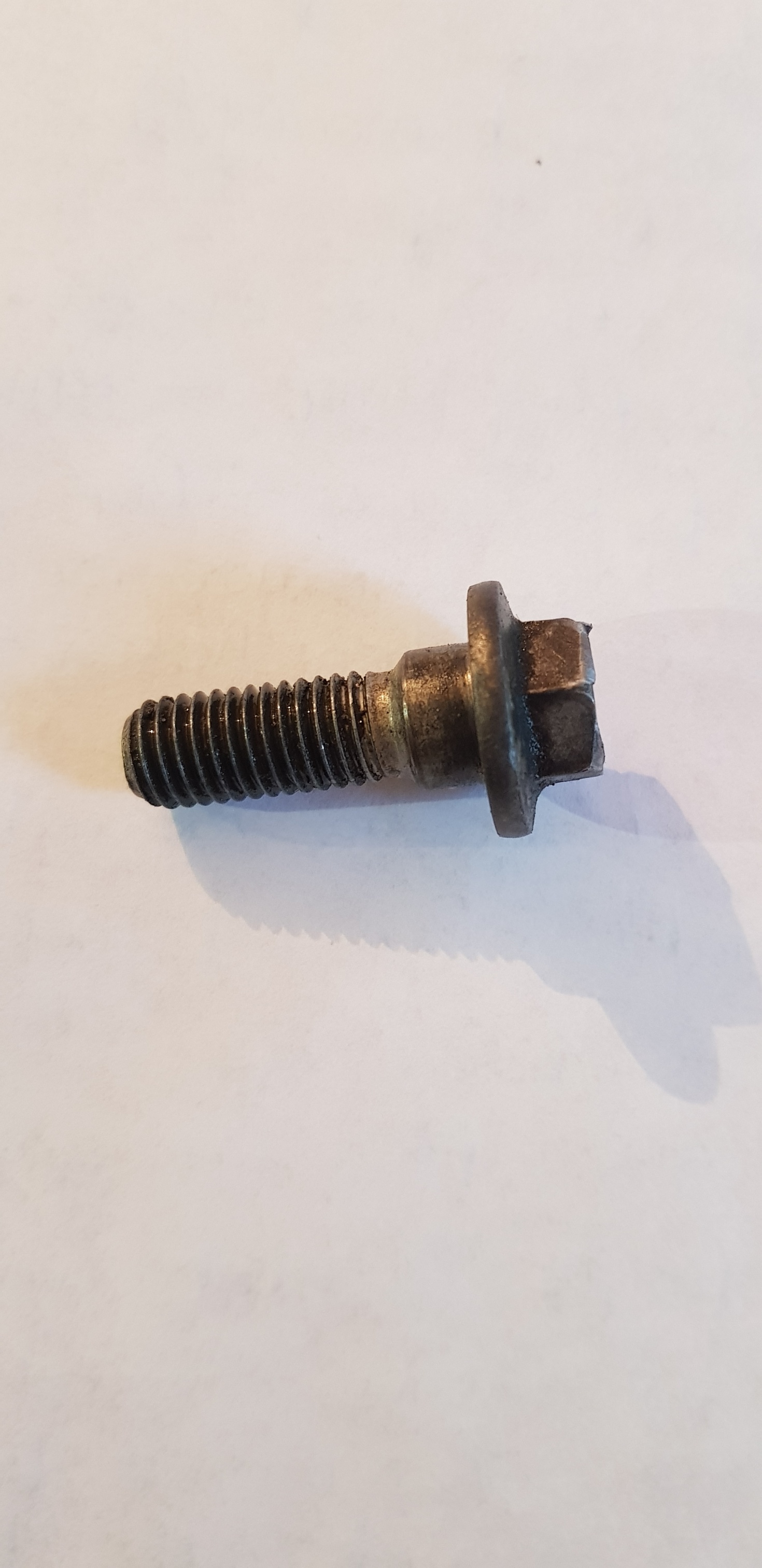

This is a picture of the bolt:
The thread is M8, not sure of the pitch, but probably 125
The overall shank length is 28mm
The threaded length is 20mm
The enlarged part of the shank is 10mm diameter and 8mm long.
Question is, where can I get one, or maybe ten just to be safe!
HELP PLEASE!!!!
I can post pics of the driveshaft, carrier and holes in the block if that's any help.

I’ve got some of those you can have. Drop me an email at jonwright@mac.com and I’ll send you some 👍

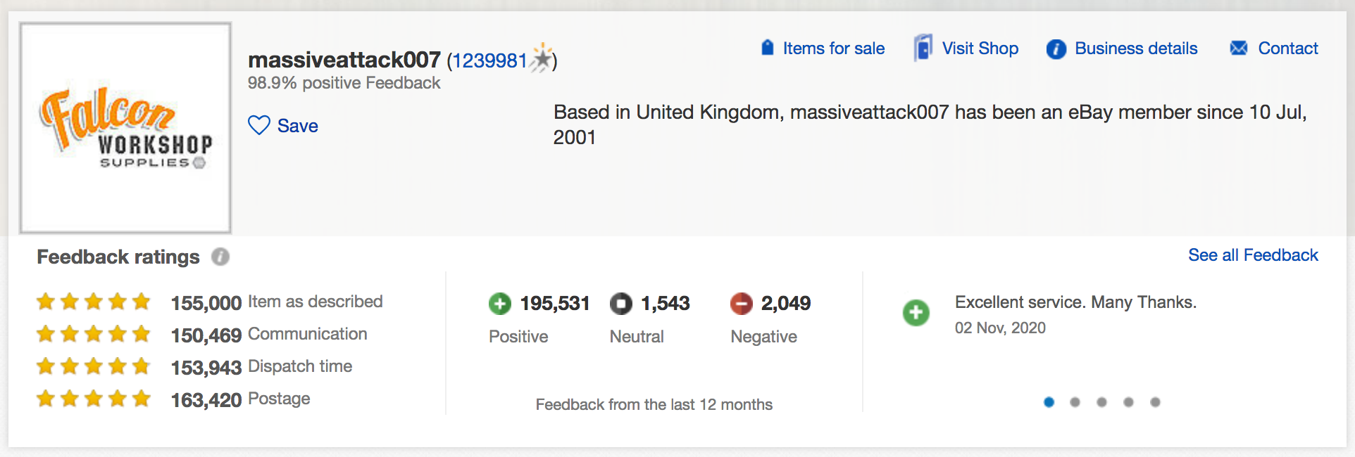

Falcon Workshop Supplies on Ebay for bolts. Worst company i've ever dealt with. Avoid like the plague. Cromwell are superb.
