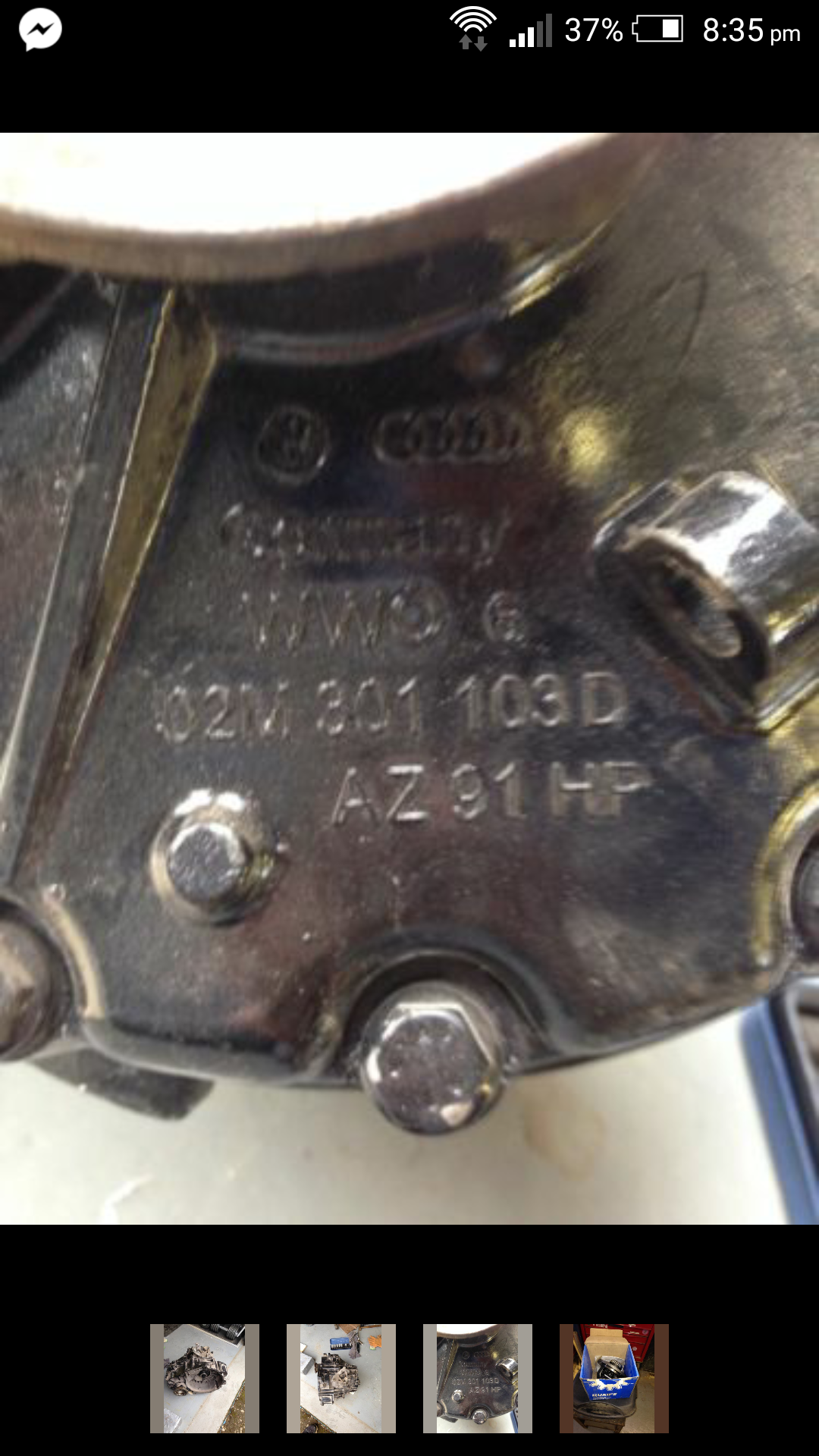

Reason i was asking is because i've been offered a 5 speed 4wd O2M cheap cheap so thought i'd look into it but could only find bits and pieces of info scattered here and there.

Correct .

Only from what I read .. could be wrong , this is the box Dan
