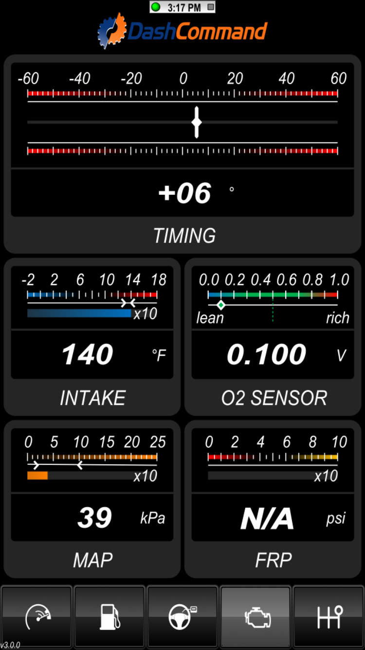

Went for the reader and the dash command app plugged it in and got it setup today and got the following readings whilst on a warm idle just wondering if anyone could confirm they're normal as I'm not 100% sure on what I'm looking for
Idle was sitting between 730-780 rpm with the engine vibrating heavily and shuddering the car (has always done this on idle)
Map sensor; 38/41 KPA
O2 sensor; 0.090/0.725 V
MAF; 0.4 lb/min

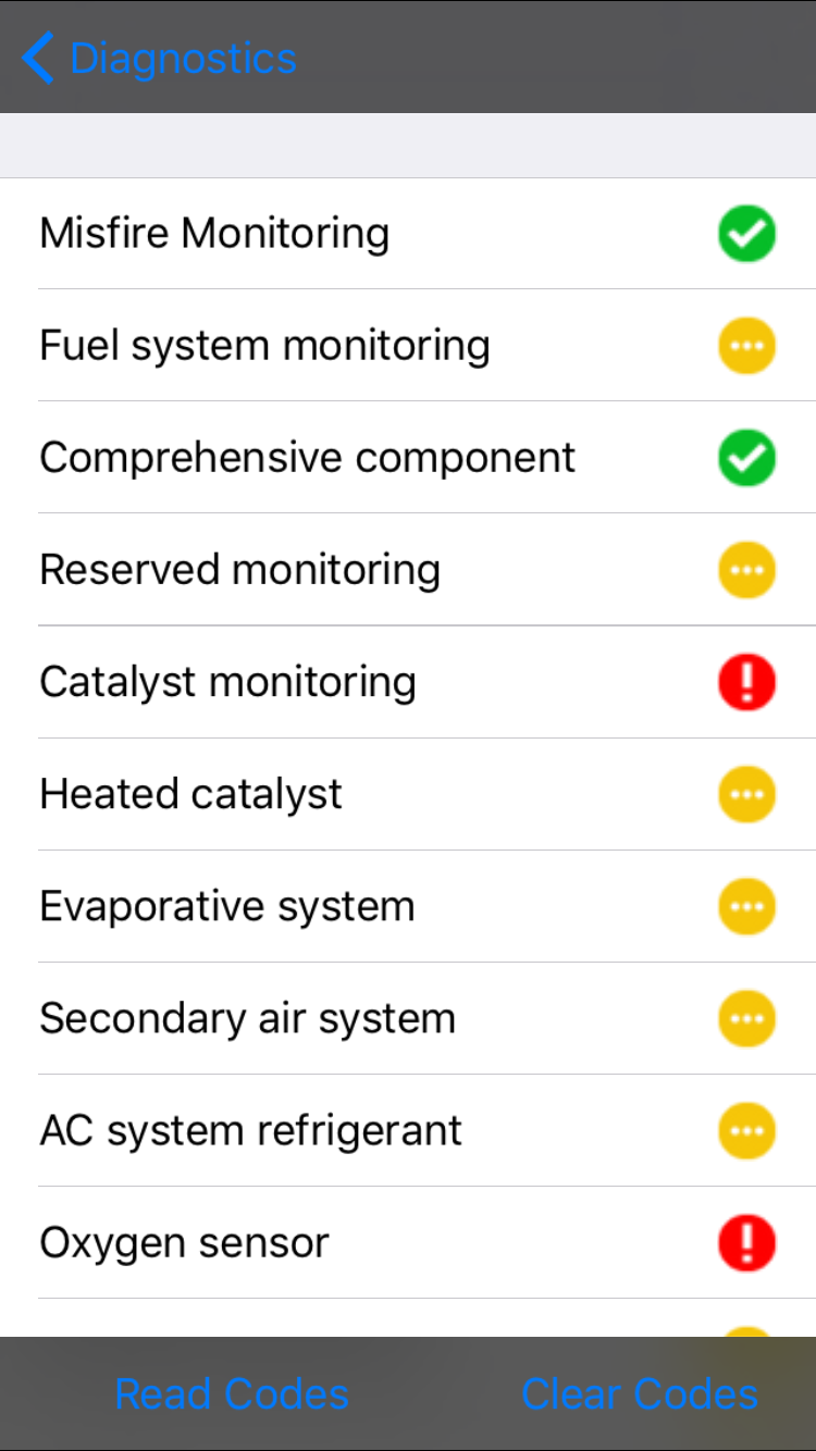

also it come up with this when i went into the diagnostics, both the catalyst monitoring and Oxygen Sensor come up as 'not complete' whilst the rest come up as either complete (green symbol) or not supported (orange symbol) What could this mean is it that the reader can't pick up a signal from the O2 Sensor and the sensor that monitors the catalyst??
Also another thing is the timing of the engine when on idle it gave a reading between -01 and +10 on the chart shown below what does this mean as I've got a feeling the timing is slightly out therefore result in the car feeling abit sluggish and the rough idle??

Ok, so from the top the idle at 750-800rpm (and a bit rough!) is consistent with a factory mapped car. Most maps up the idle to 900ish rpm because of the roughness.
The incomplete parts are nothing to worry about, it's to do with performing an OBD emissions test and needs the engine hot etc. Forget that bit.
Timing is ignition timing, not cam timing. Ignition timing is computer controlled whereas the cam timing is done by the belts, pulleys and dephaser.
Figures for the O2 sensor at least seem fine.
