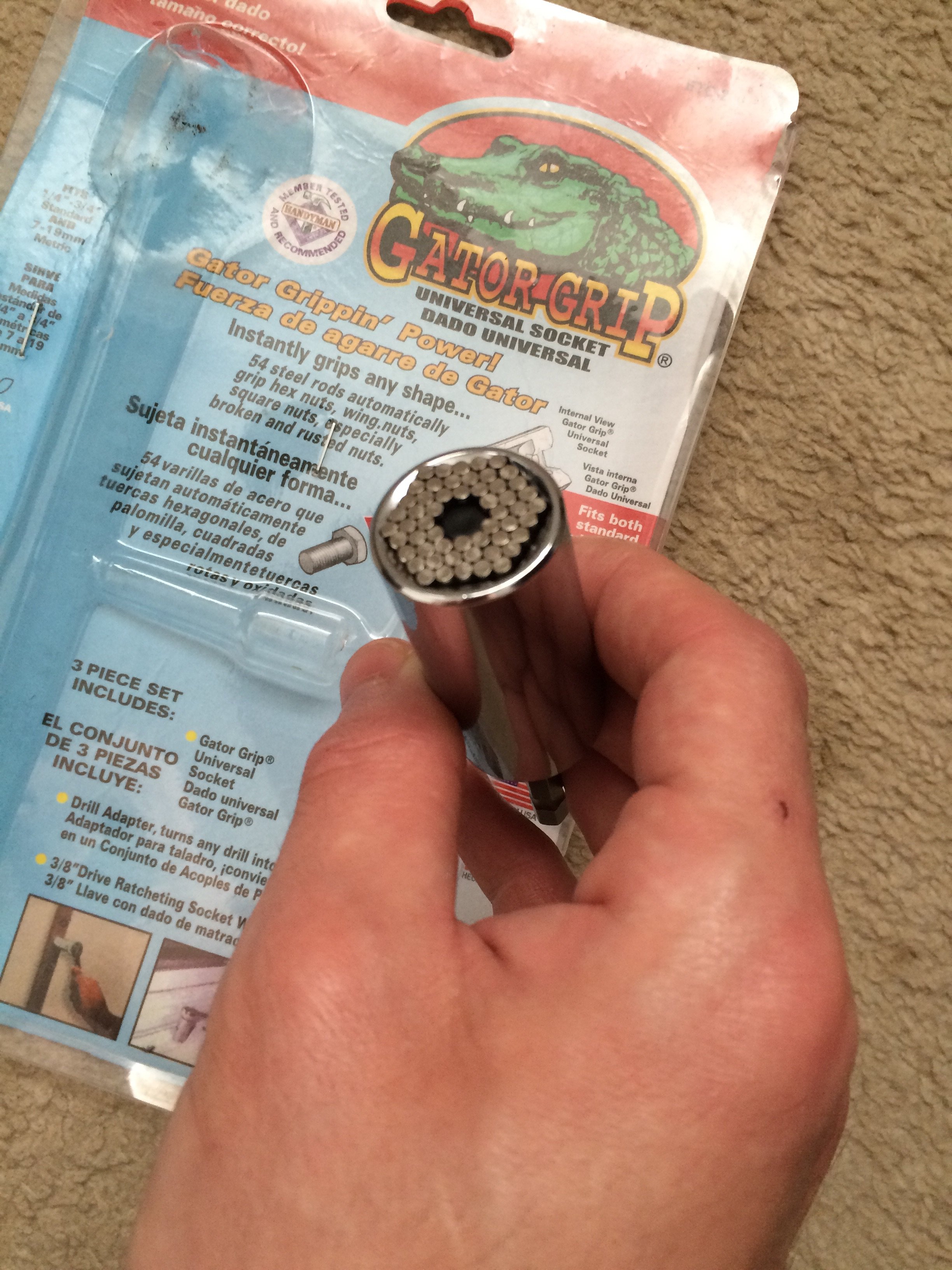

If the nut doesn't have a spinning collar you can get a gatorgrip universal socket.
Like above. Or if it has a spinning collar, the socket won't fit, you'll have to get somone to weld a spare bolt to the centre of the locking bolt and remove as normal.
