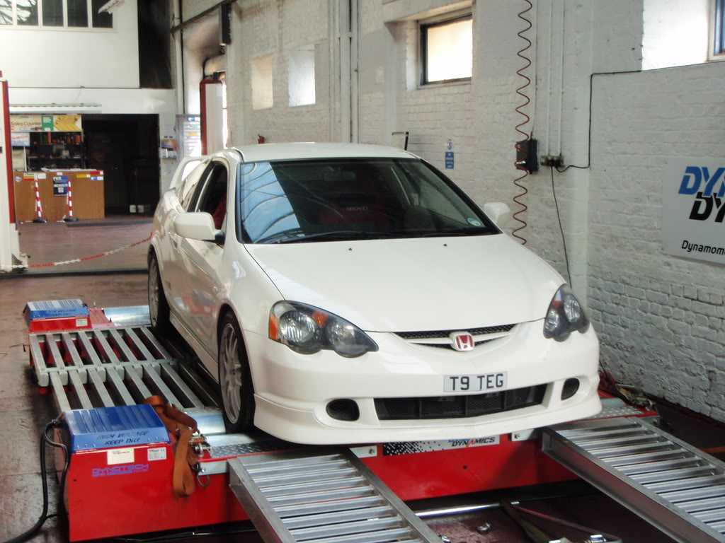

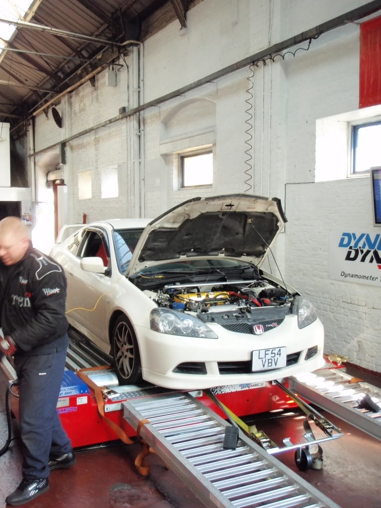

I went down to Hayes Engineering on saturday to put the Teg on the rollers. It's not something i was planning on doing (scared of the results) but a couple of lads from Itr-dc5 organised something just down the road from me, so.
The other Teg in the pictures was running the following mods:

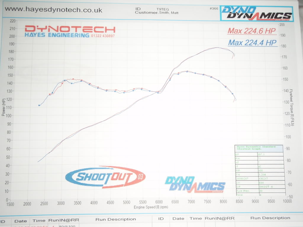

He ended up with 237 bhp at the fly over the 5 runs.
Heres my results
I was actually quite pleased with the results of a 9bhp-ish increase on the 216bhp stock figure. Apparently Honda are pretty generous on their figures too. When compared to the other Teg, we have the same mods apart from Ian has a full exhaust system, Spoon throttle body and Kpro and the difference was around 14bhp.
Worked it out that it would be over 150 pounds per extra horse, value for money eh!! :(

Malice - Dunno mate, they did 5 runs on all the cars. Thats up to 4th gear the redline it, 4 times over 15 minutes.

i been to loads of rr's they put it in 4th get it to 30mph to calibrate it, then slow down to a stop then drive to 4th, hold at 30 and then boot it, giving a power run with a coast down, and 25% loss is alot!! you should be getting 16-18% this is why i hate power runs! you shoul only be concentrating on wheel power as the rest is just made up by the guy doing the day!! i know wheel power isnt as good as fly power for pub talk, but atleast you know what your really making...
only time to take fly in to mind is when your running the engine out of the car on a dyno, but even still you never see that power cos of trans loss...
nice figure for wheel power though!
could technically be getting the gearbox upto temp
and making the engine have hardly any airflow around it?? rollers i use for mapping or power runs get people to take the car for a short drive to get up to temp and warm up gearboxes and diff's....
^hence why i hate the f**king things, you can't simulate real world conditions accurately unless the dyno cell is in a wind tunnel
agreed, im not a fan either... a couple of little fans pointed at the front of the car worrys me lol, and i would rather cold gearbox oil than hot spots in the engine bay causing det...
Yeah... power runs are pointless. Saying you 'gained' 9bhp is meaningless as you have nothing concrete to compare it to!
Its also typical to say something like "Honda are generous with figures" just so people feel better about spending their money.. lol.
