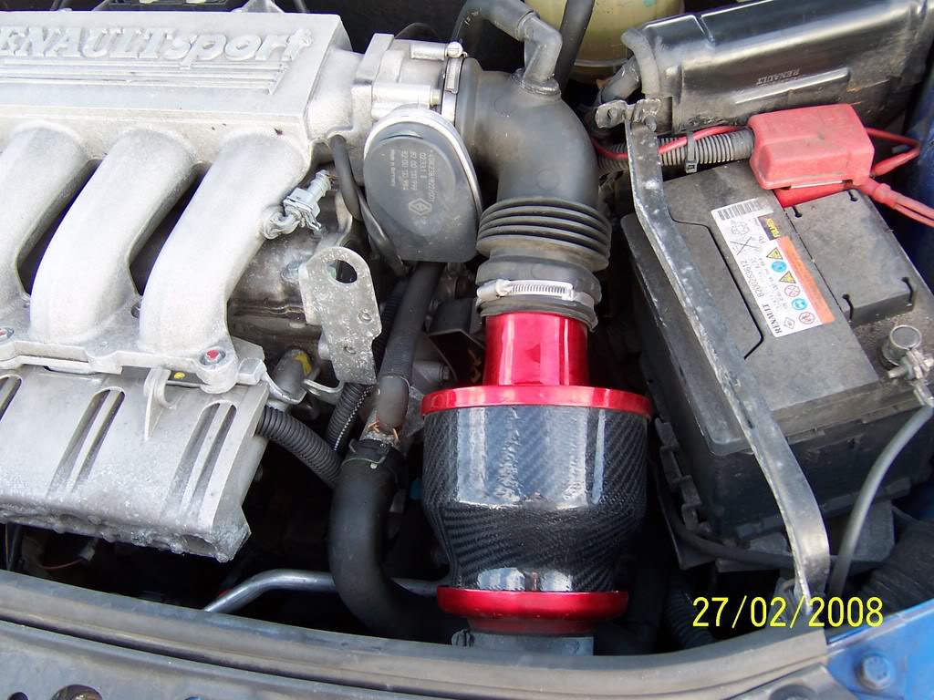

Right my Clio idels like s**t whilest having a look at it today I noticed a small bronze pipe just under the tb is this the oil breather out let if so some one has blanked it of is this why it's running like a ford
This ant my car but it would be the thin yellow pipe ?
Normally has a black pipe there that runs down to the acoustic valve, if the acoustic valve has been removed it needs that pipe blanking off other wise the car will idle very high. The breather is at the back of the rocker cover.
pipe is a vacuum hose. if it's not actuating a valve it's just blanked.
Get plugged in to proper diagnostics to get to the route of your problem
