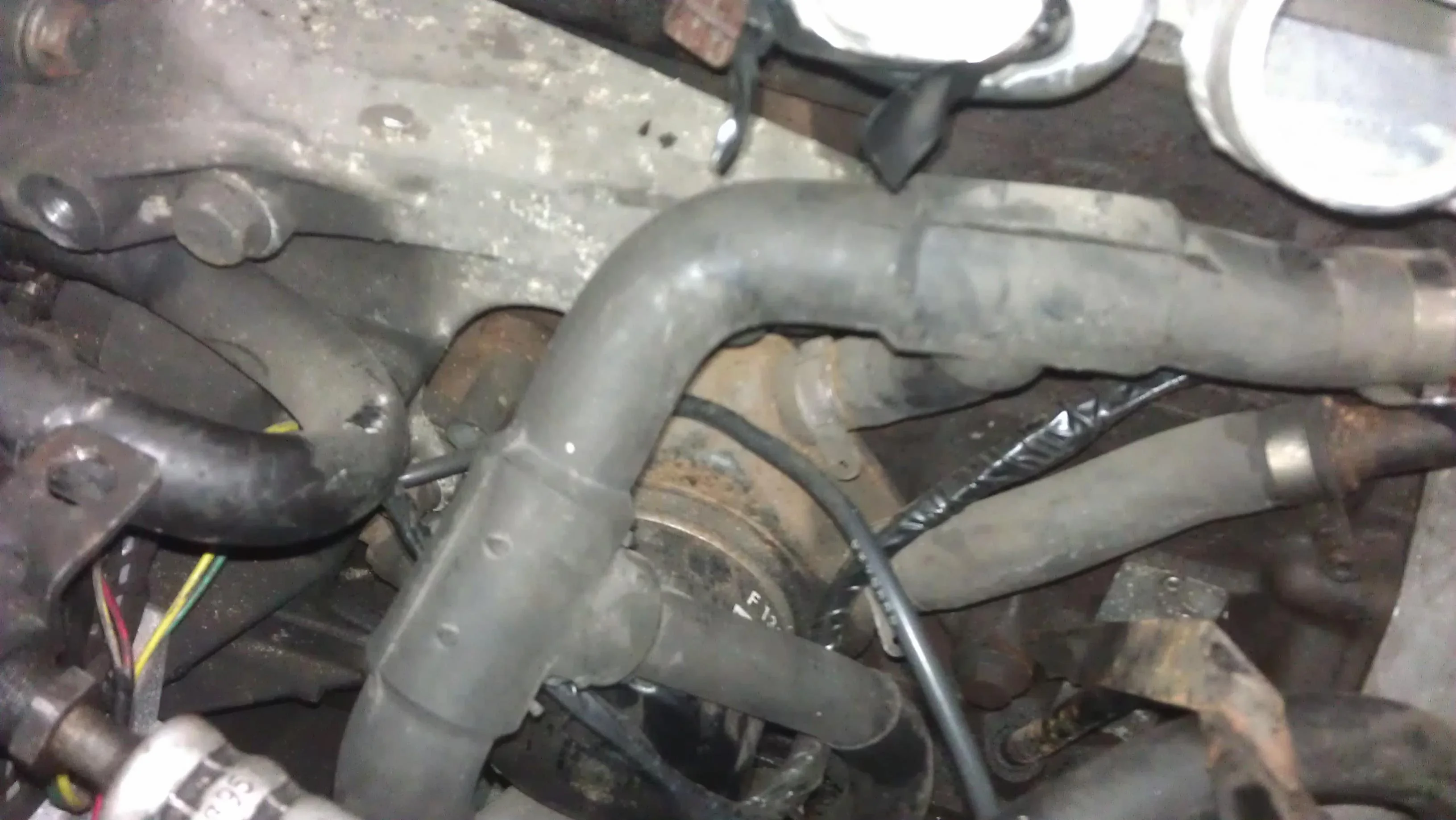

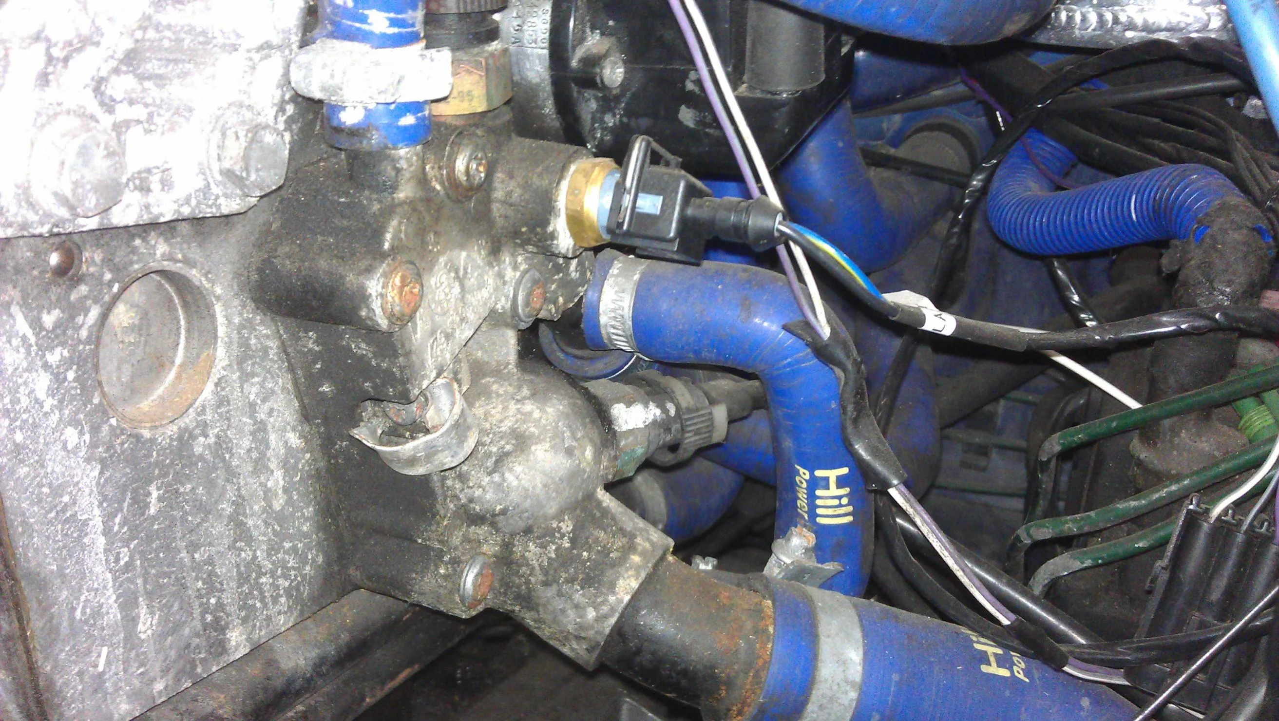

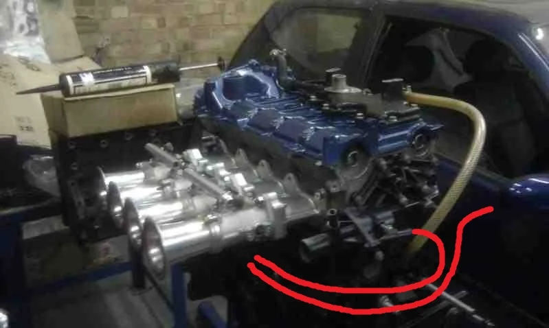

Williams:
easiest thing to do would be interupt/extend the heater matrix hose that connects behind the thermostat and just loop it round so it goes onto the exchanger, then off again and onto the stat housing.
