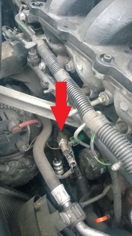

Spotted a patch on the floor at work, popped my head under the bonnet and saw a nice greasy mess. Seem to be stemming from around the sensor (image below)
This a common problem that others have?
Any help on possible solutions?
Power steering pressure switch. Mines was leaking aswell. Think it was reasonably cheap from renault for a new one.
Limited access, but i used a quality stubby adjustable and it took a couple of minutes!
