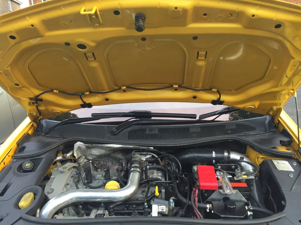

Here's a photo of the setup on my R26. It goes into Mocal catch can and then to ITG breather filter down behind the headlight.
It shouldn't collect that much as mine barely has enough oil to line the bottom after 8k miles.
