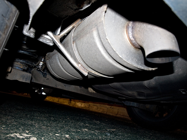

De-cat is now on and I'm very impressed by it. It's something that I've been meaning/wanting to do since I bought the exhaust months ago, but just never got around to it until now.
Instantly the car feels so much smoother; it also seems to pull better. It's made a bigger difference than I imagined and expected it would.

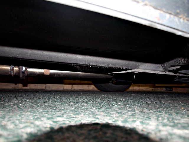

Have a couple of under car photos of exhaust and de-cat and a short video; love the noise and rasp :evil:
And the obligatory short video of the exhaust sound; it's quite a bit louder with the decat but I love the sound it makes!
You can probably see from the first photo from the backbox end of the system, the rear hanger is truly and utterly f**ked! That was bought new along with the stealth exhaust, so it's less than a year old; the rubber section is close to completely ripping apart. :dapprove:

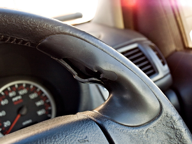

This morning, however, a bit more of the steering wheel thumb grip decided to come away, leaving it looking even more of a mess! This seems like as good a time as any to start looking at aftermarket replacements; I like to keep the car looking tidy and the current wheel really lets it down. :dead:
I do quite like the chunkiness of the wheel, but ideally want something a bit smaller; I don't think there's any aftermarket wheels like that, without straying into tasteless s**t.
So, that leaves me with a few popular choices :o
The Sabelt RenaultSport wheel, which seems an even better option given the price Wests Renault are selling them for as part of the ongoing group buy.
A 300-330mm Omp flat wheel; I've always liked these and people never seem to have any issues with them.
And finally, a newer 197/200 RS wheel. I've had a little read up on them and it seems they can go on with little to no additional work. It's just the size of them (the same as my current wheel, I believe?) that puts me off.

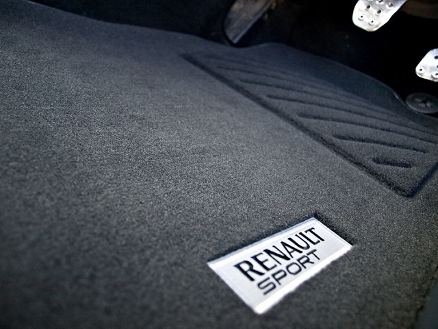

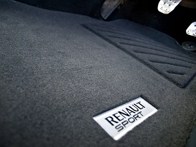

Royal Mail just delivered my new RenaultSport mats, which I bought as part of the Wests Renault group buy.
Fantastic service, I ordered/paid yesterday and they arrived today! :D

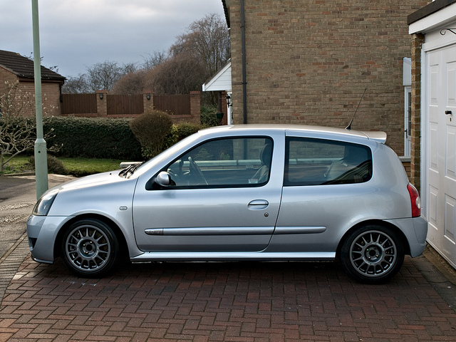

Just a quick photo from on the way back home today, thought it looked pretty good in this shot, so throwing it up;
