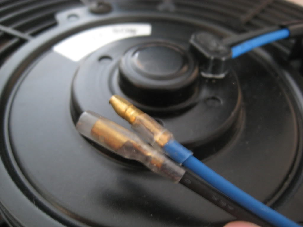

Correct me if i am getting this wrong, but if i connect pin 6C from the ECU to one of the wires on the fan, and then earth the other wire then after i have set the fan to come on at a particular temp then it should work.
The fan

Is your omex already spliced into the standard loom, and already running the old fan setup? (like mine is) If yes then just cut the connector off the old fan wiring and wire to the new one?
That means the relay and that is already done?
