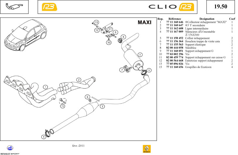

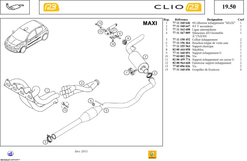

I'm still looking for a Competition exhaust manifold for my Rally clio 172, the only one I like the look of is the R3 rally car one, I know the bulkhead and tunnel would need altering but it looks like what I've been looking for and plus Renault will of spent some time developing it. so how do I get a price and part number?
This one?
7711160646 is ~£832.95
7711160647 is ~£666.40
