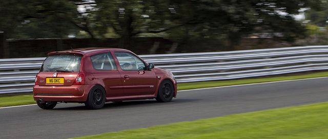

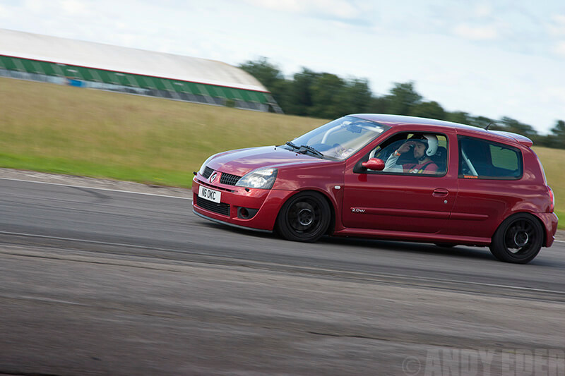

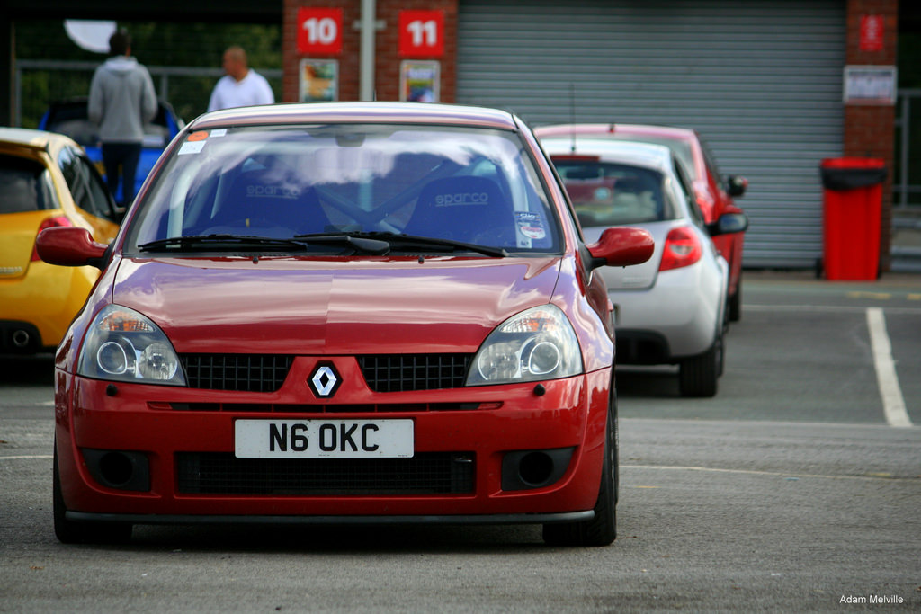

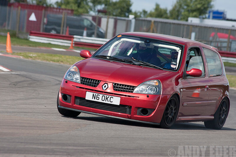

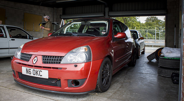

Getting the tracking done by a company thats been recommended on Thursady. The car seems to handle very well but want to get it checked over properly. They dont do height only camber etc so looking for opinions on how the car sits. I can take better pics if needed.

Mine is on b14s and looks like it sits at a similiar height to yours (albeit on 15s and with spacers). Camber wise -2.5 at the front and parallel at the back I believe. I basically asked @NorthloopCup for his recommended settings, wrote them down and handed them to the Geo guys :) , see photos here;
Note how low at the front this is cornering at Llandow;
On the 15's it rubs at speed on all four corners very, very slightly on track when cornering hard. Have a look in my project thread and you'll see where it rubs as I took a few photos. I am fitting the roll centre kit this winter, and rolling the rear arches which I am hoping means I don't need to raise it. If I did need to raise it, probably 5mm all round would be enough to not have it rubbing bud. Hope that helps.

If you want it to handle you'll need to lift the front end up. 5-10mm minimum I'd say. It's too low how it currently stands imo. Your roll centres and bump steer will be truly awful as well unfortunately. The chassis on the Clio is good at masking it though, and it's only when you drive one that's corrected/sorted you realise you've been driving an oiled up pig on acid.
I'd expect the front bumper brackets to rub the tyres as well unless the car isn't on cup spec increased castor wishbones.
Car looks tidy though.
