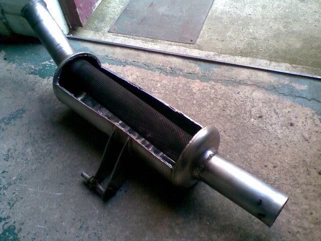

It originaly came off a clio cup racer run by TCR think it did 2 seasons so when i got it it was pretty loud as the packing had been blown out. The box is not designed to be re-packed but didnt fancy paying big money for new one so i cut a section from the box and removed what was left inside

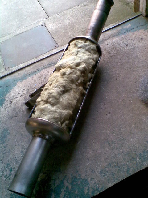

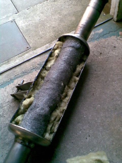

I then purchased some exhaust packing from merlin motorsport (steel wire wool and basalt) Just had to wrap the perferated tube with the wire wool then surround it with the basalt, the wire wool just helps keep the basalt inside the box stop it from blowing out.

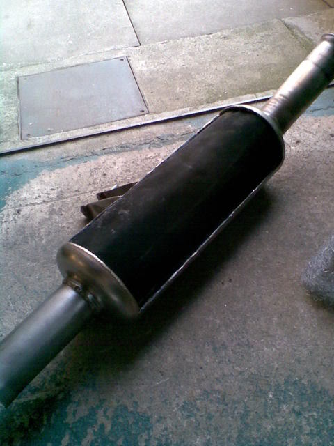

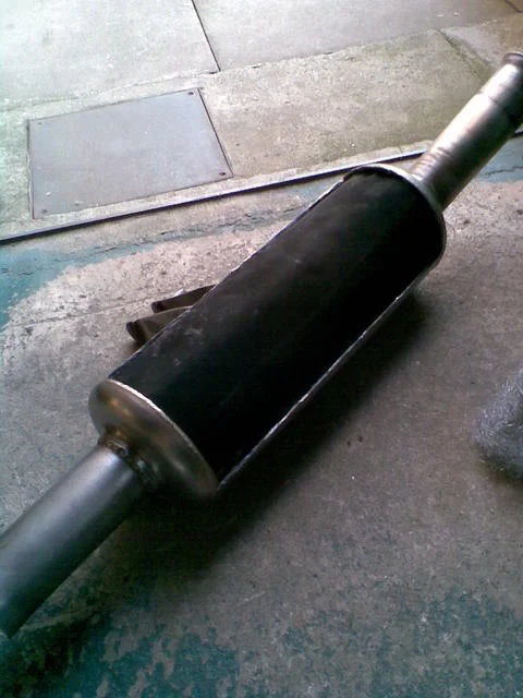

then i just packed the basalt in around the rest of the perferated tube and used some of the original mesh removed from the box to cover just the section i had removed to help the protect the packing from when it is welded back up

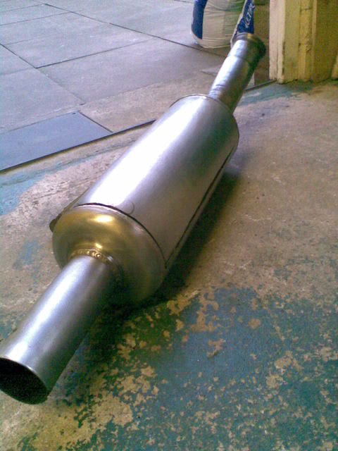

and now ready to be welded
wasnt that hard really, took about 20mins with grinder and then bout 20mins getting the packing in making sure it was in properly, saved me alot of money though they aint cheap, im just interested now how its going to sound compaired to how it was
