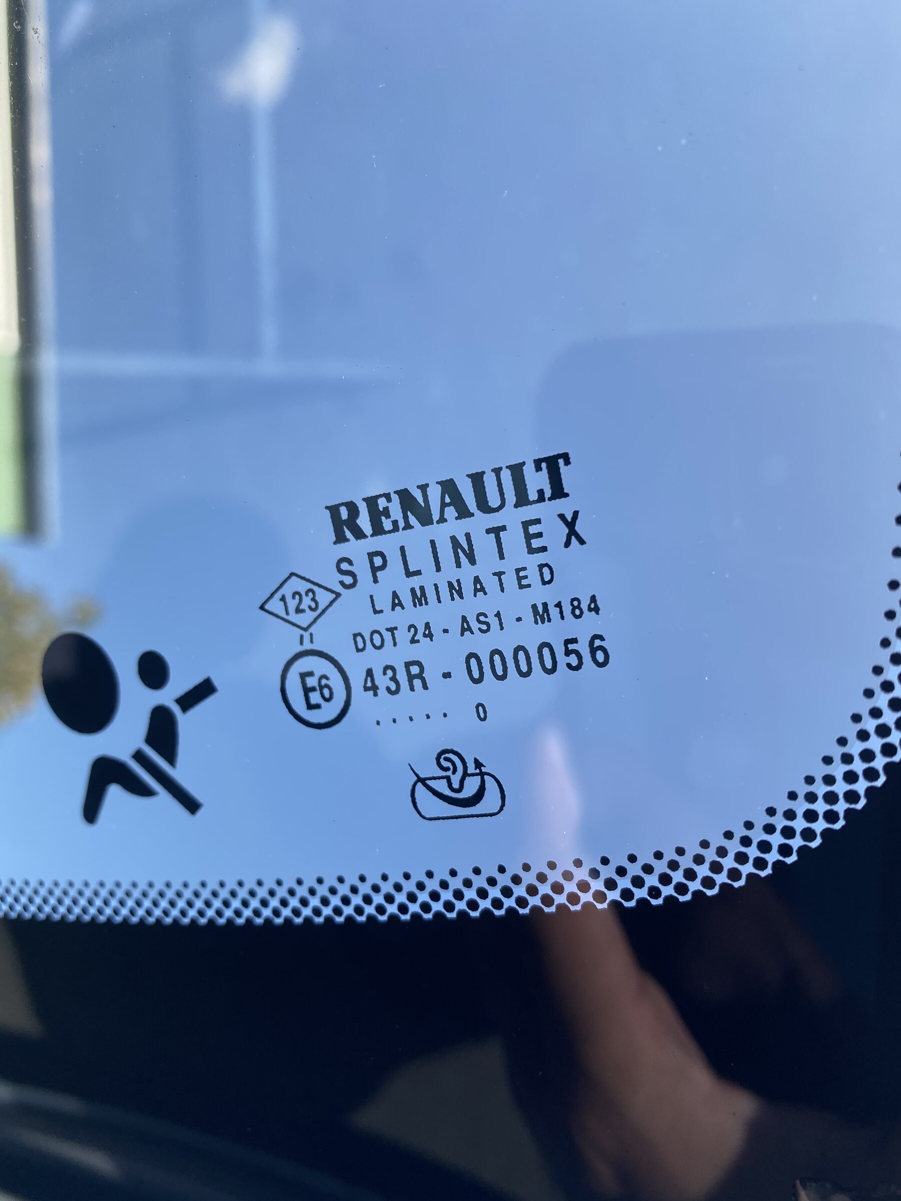

Today the screen arrived and it had a slight blue tint but not as blue as my previously fitted screen

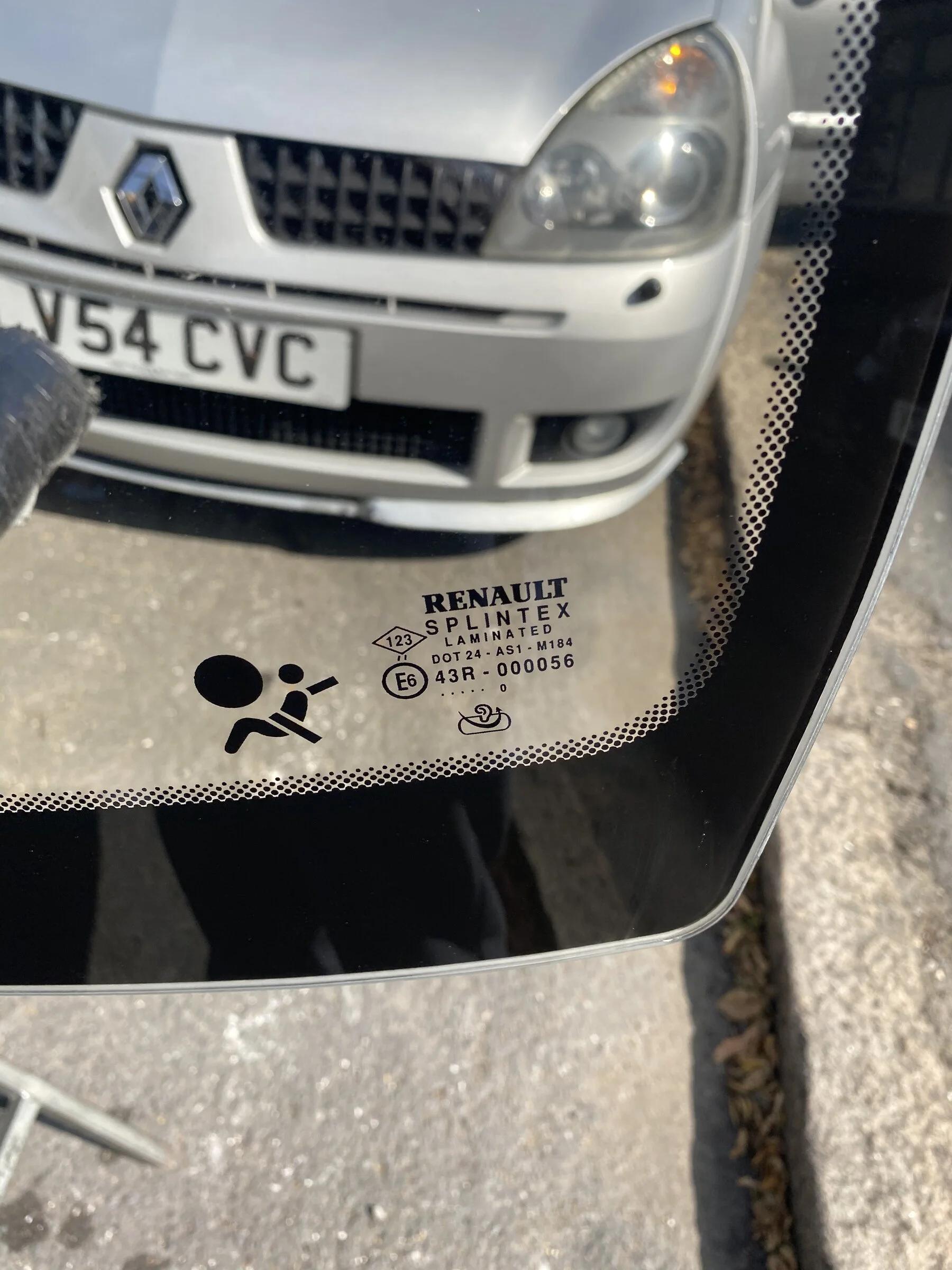

I need to know if this picture is thecorrect item for my 182 2004 plate clio

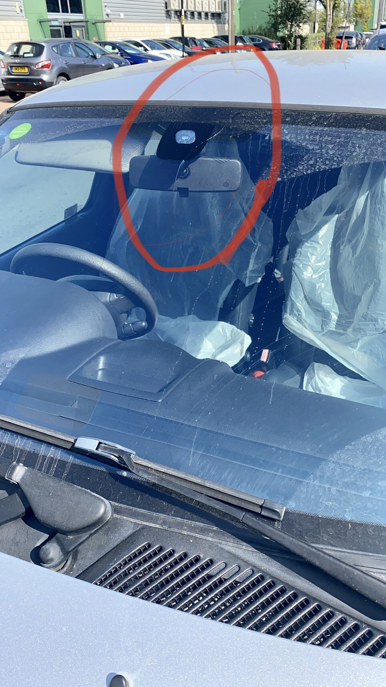

It doesn’t even look as blue as my one on the car currently the last image is the damaged one as I refused the windscreen
I need to know if them pictures with the codes are correct
this is the glass they came with but the blue is not obvious

Correct.....

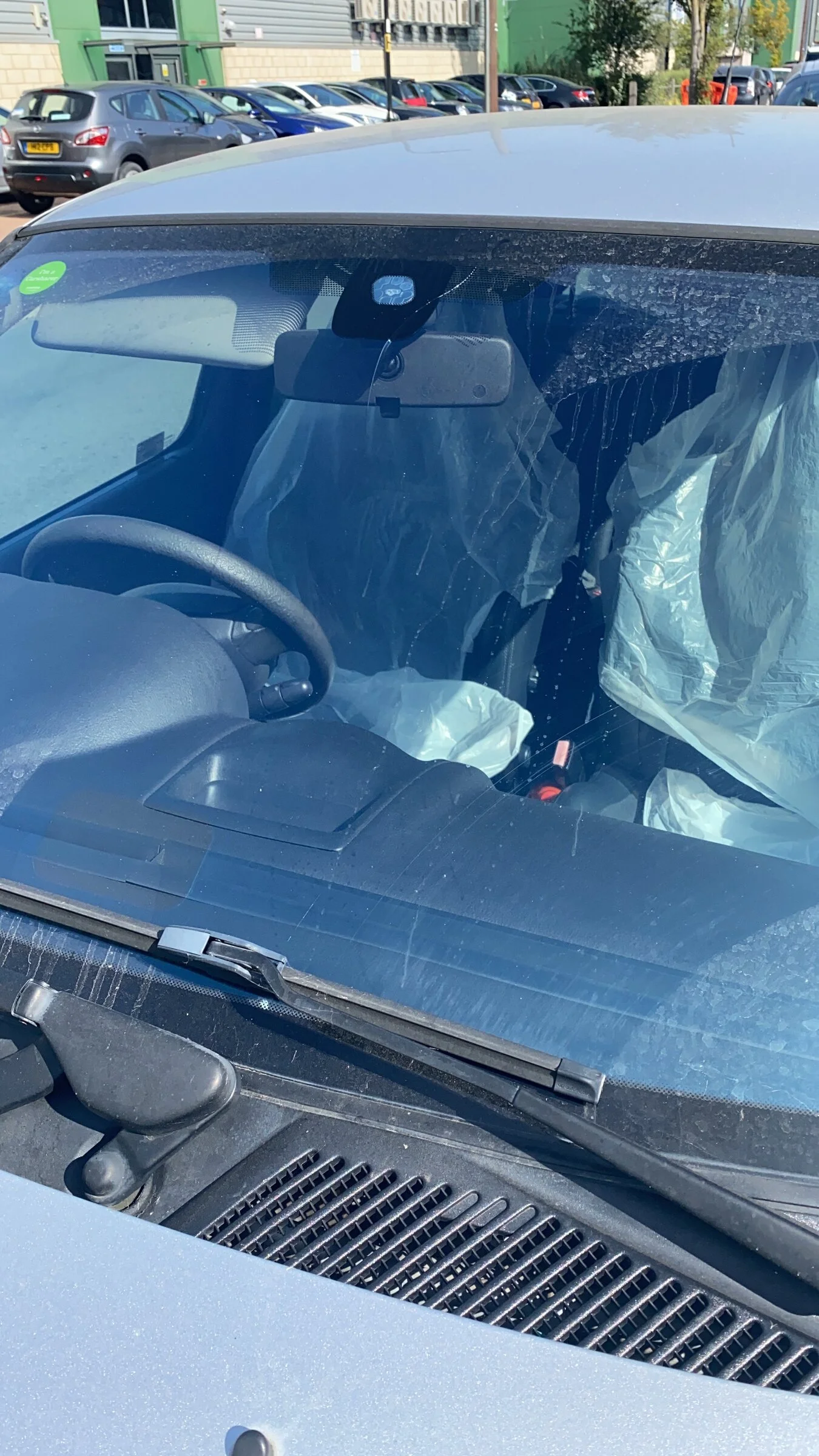

the new windscreen they turned up with is no where as blue as the cracked one on the car at the moment so I turned it down thinking it is not original

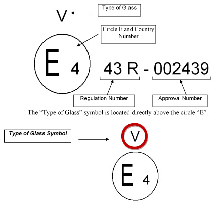

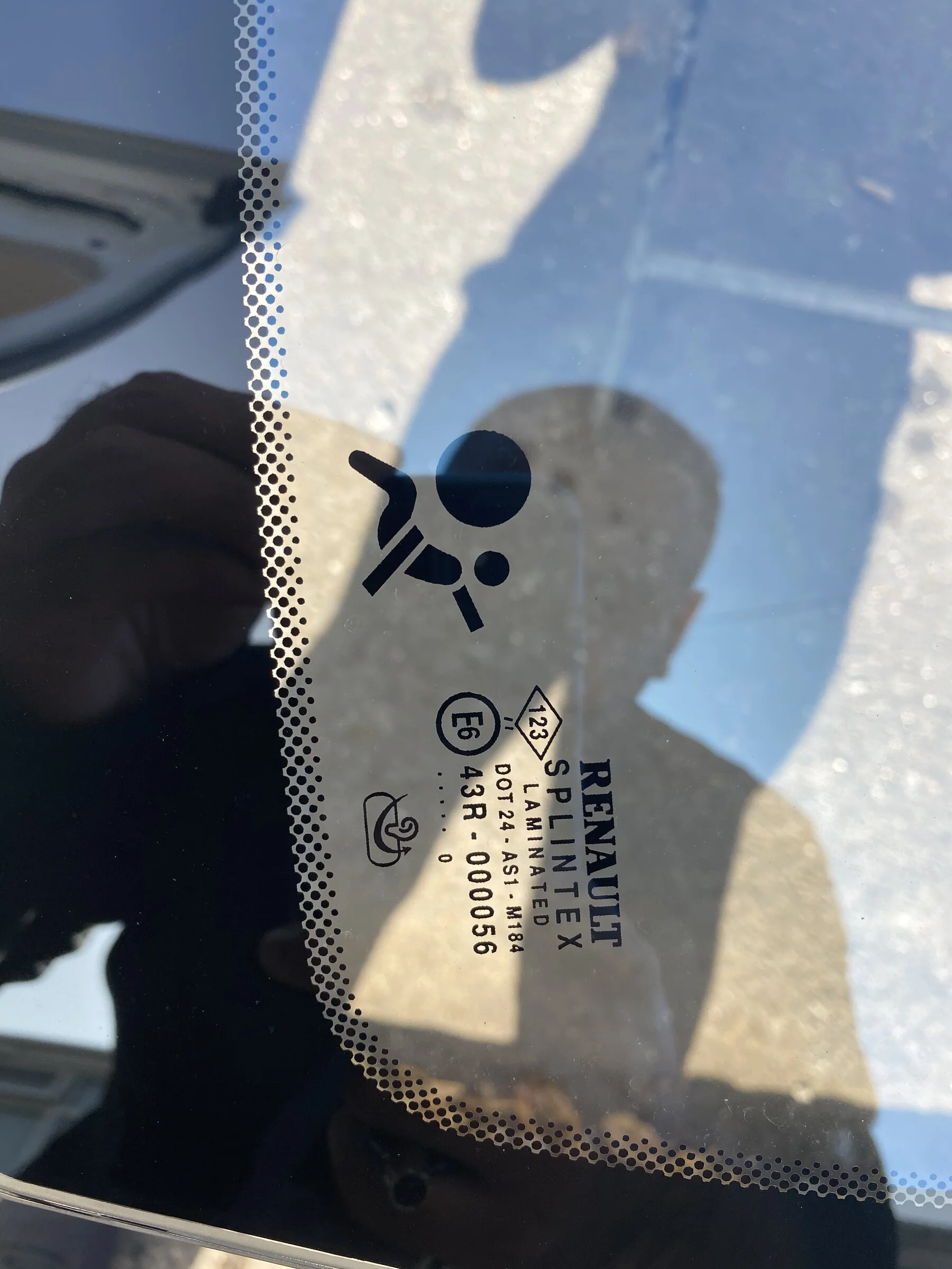

What does the 43R-000056 mean ???
The one I have on the car right now is so much more blue- er than this replacement they want to fit on
Just realised the damaged one I currently have on the car was a rac windscreen so maybe that’s why it’s more blue than the original they came with today

I’m guessing this is a splintex one based on the badge
Are they original or they pulling my leg

The windscreen supplied is correct, it may not be the same manufacturer as the original when the car was made but it will be the correct part manufactured by whoever was doing Renaults glass at the time it was ordered by them

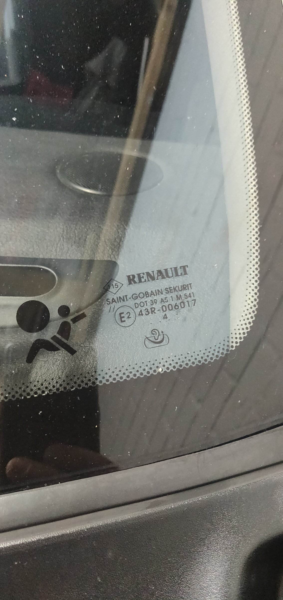

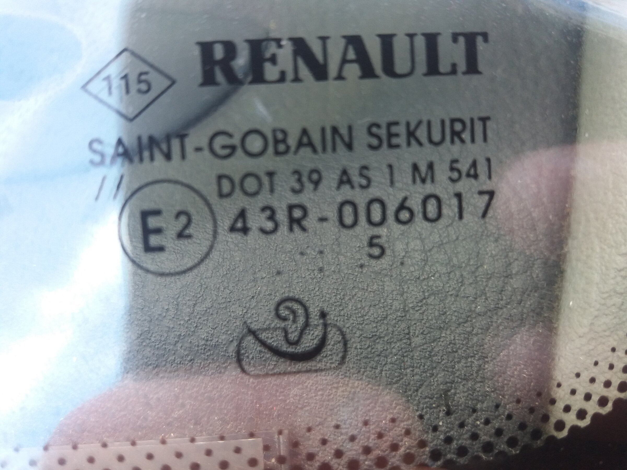

This is my original windscreen. Almost the same numbers as Amos except mine has a 5 he has a 4?

The windscreen is correct for your 182 in the fact it will fit the hole and take the sensor. The tint your seeing on your factory screen is a solar tint, these aren't avaliable anymore as a genuine Renault screen, or at least not through our suppliers.
