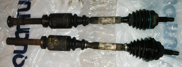

Is there any reason why there would a difference in size between a 03 reg (mine) and 02 reg MK2 172 offside drive shafts?
See below!
Mine is the top one here:
And the left one here:
Any thoughts?

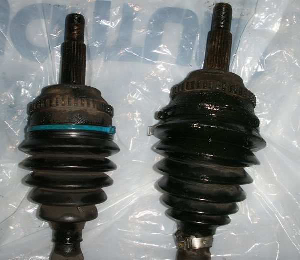

the bottom one i the first pic is longer and gaiter is bigger?
Its about a inch longer?
  alien green rs133
tried the movement on it, as every driveshaft i have seen slides and ajusts length, this one might of had a replacement gaitor and this is holding it at a different length

Is it not different to the far left of it aswell, top one has like a ring around it?
  Renault Sport clio 1
That ring is from where the bearing casing as broken and why i need a new one! :-(
It looks the same yes but the one i was supplied is a inch longer????
You can see it in the bottom pic????

are they both genuine Renault? I had an aftermarket shaft on my valver and when i put a genuine Renault one on i found the genuine one was an inch longer
They could have come out of a different gearbox. They switched to having speedo output from ABS rather than the diff around that time. Yours being an 03 I wouldn't expect to have the speedo output. But the 02 172 may have had one and this may mean a different diff/gearbox and hence different length driveshaft.

all ph2s (exept the cup) had the ABS driven speedo's mate, all ph1s had the diff driven speedo, so maybe its a cup shaft?
but would the cups have the ABS ring?
Or was the ABS ring used on the cups for the speedo?
So the longer on i was sent can't be the cup one then as its got a ABS ring?
