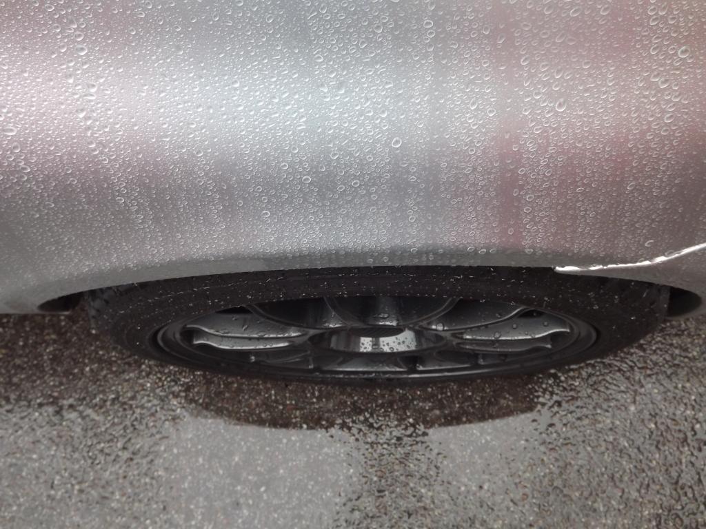

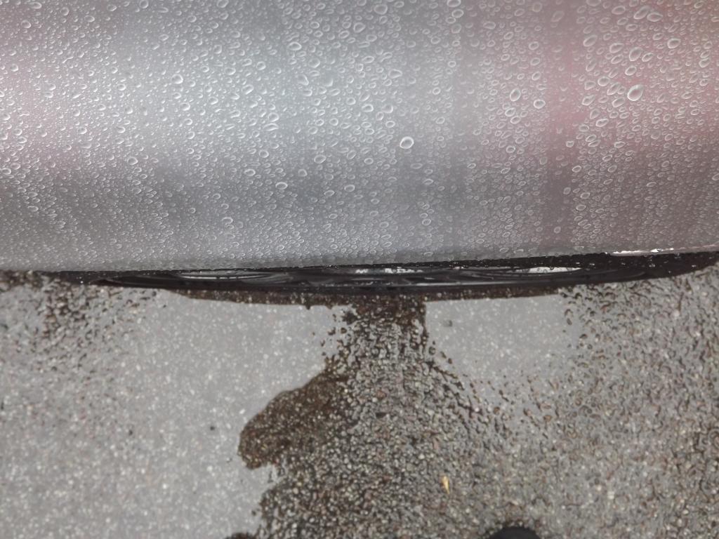

On the rear i found that with 5mm spacers and 205 wide tyres i had slight scrubbing when i had rear passengers, dropped down to 195's and all good.

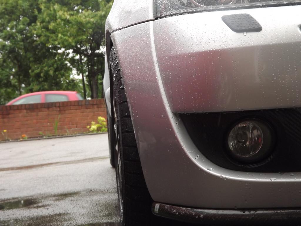

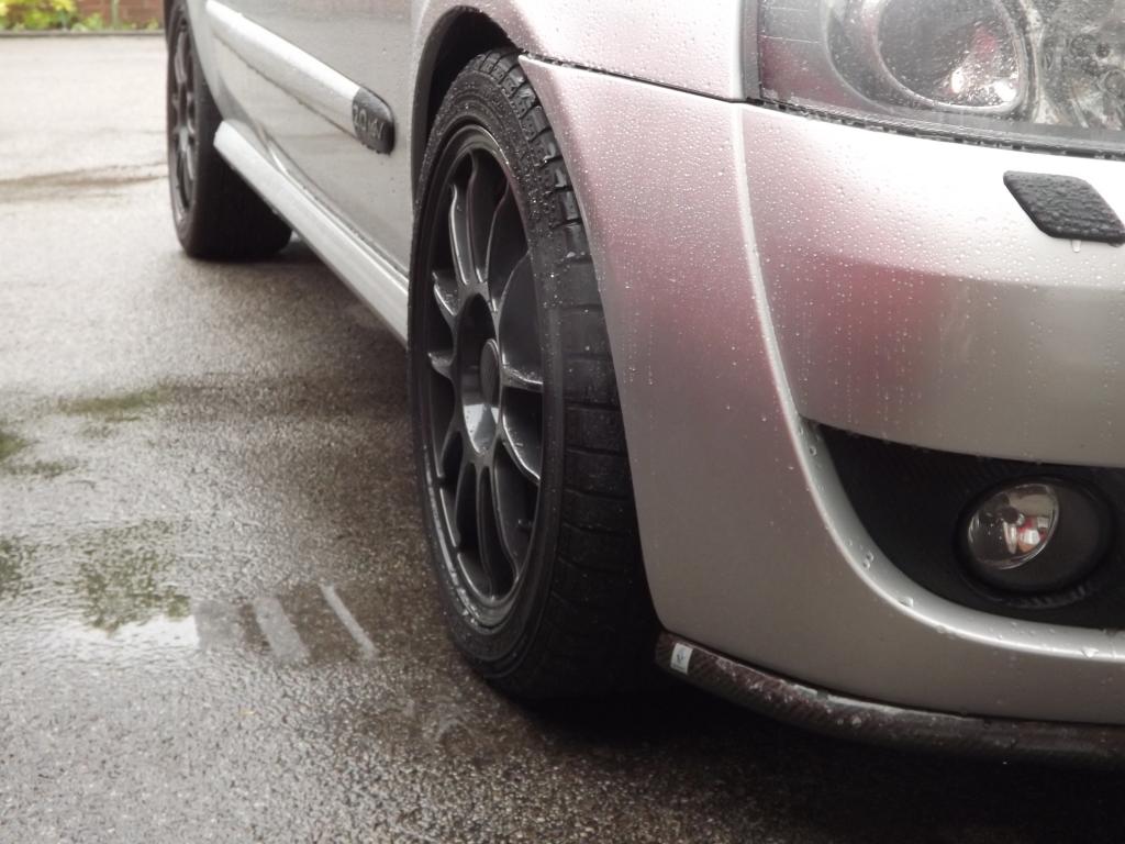

Shall try and find some pics of the distance mine stick out with spacers.
Rear
Front
thanks MartinR its good to see the difference on the front especially! any recommendations on where to get the spacers from?
