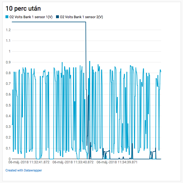

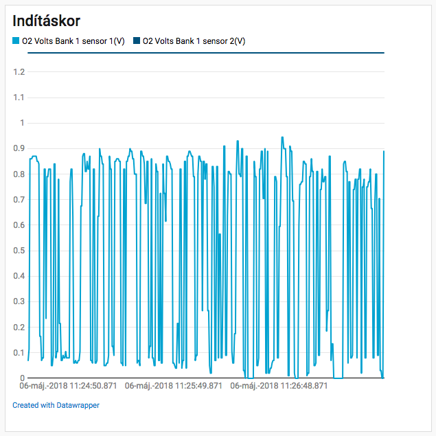

The downstream sensor provides uninterpretable signals (the upstream sensor seems to be fine), see attached graphs. After cold start, it sends constant 1.275 Volts, after about 10-12 minutes of driving it suddenly falls down to 0 Volts, stays there with little bounces below 0.2 Volts. When I clear DTC’s then the Check Engine light comes back at the second full operating cycle (with cold start and reaching operating temperature) at the exact moment when the downstream graph falls dows to 0 Volts.
If I disconnect the sensor, it immediately switches to 0.45 Volts fallback value, if I plug it back, it returns to the previous behaviour - so I assume the ECU perceives the signal wires and open circuits fine.
