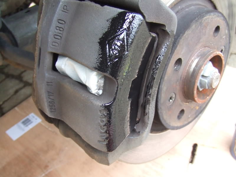

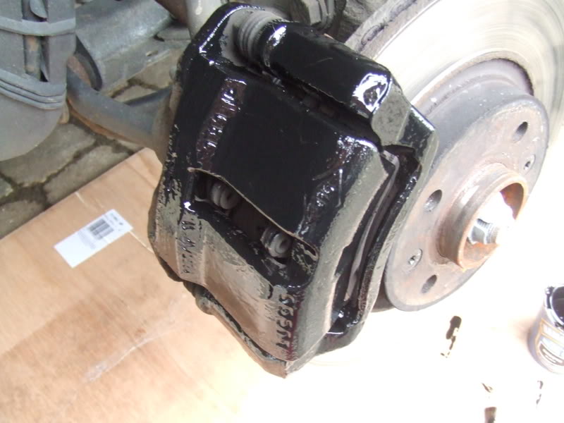

its just the front ones dont look straight forward to paint meaning theres lots of different bits of the caliper and just seems a bit confusing.
Half painted:
Painted:
You can see ive masked the middle bit where the pads can be seen, Also dont paint the rubber bushes at the back.
