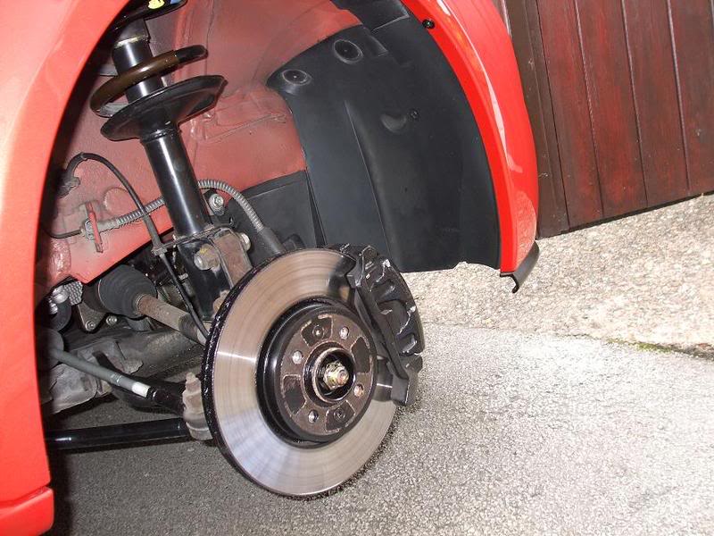

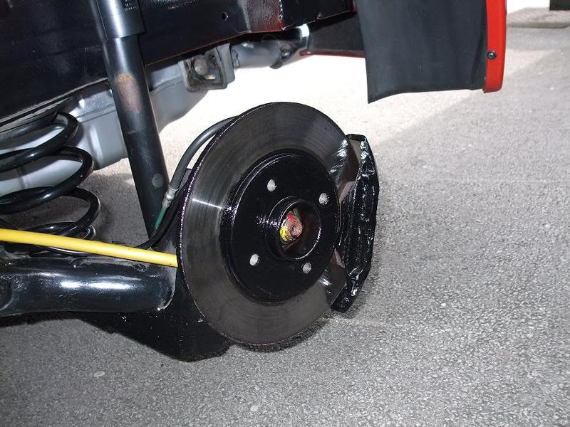

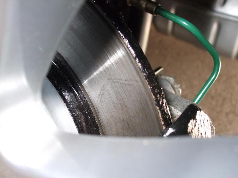

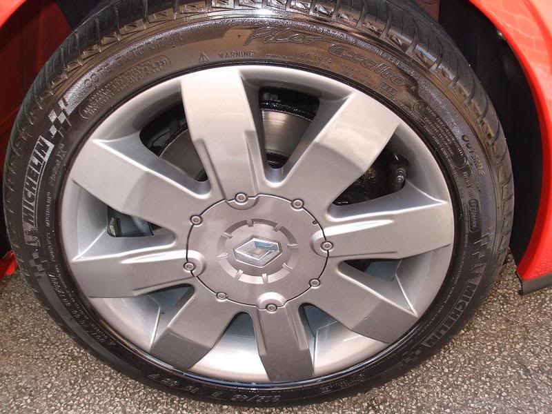

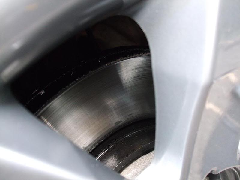

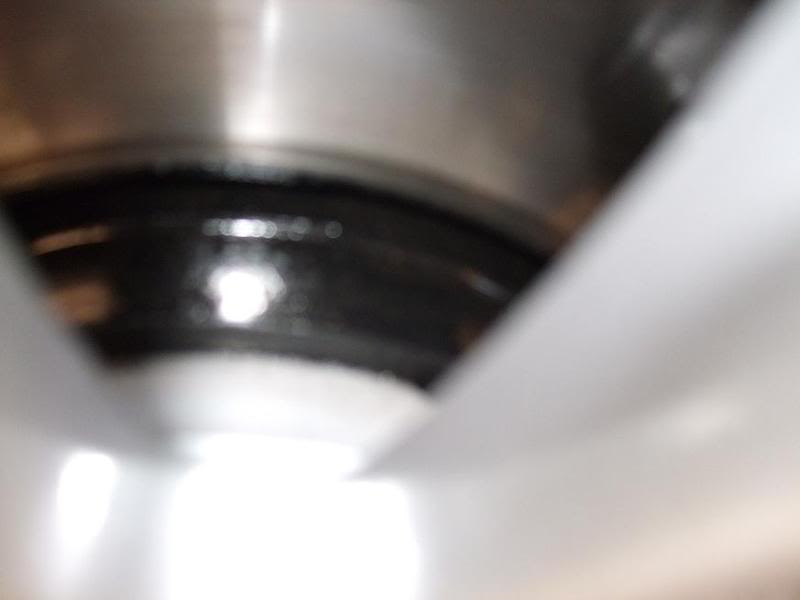

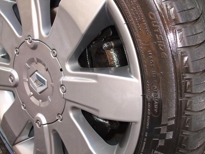

I used HammerRite smooth, for mine, came up a treat and still looks good, however i done them Black, and now a want a change, any suggestions to what colour i should do my calipers, my car is black you see. I done them black just to smarten them up a bit, now i am in the mood for something more daring! Ohhh Get me! lol

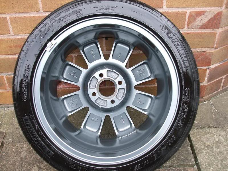

Inner wheel painting is the real future! :rasp:
