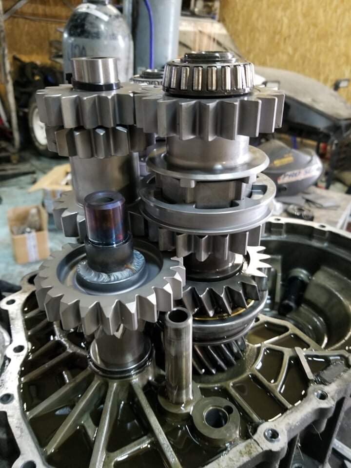

Had an amazing time! Unfortunately around 4pm 5th gear decided it had enough and pooped itself. Back home now. Had a look and it’s confirmed. Full rebuilt needed.

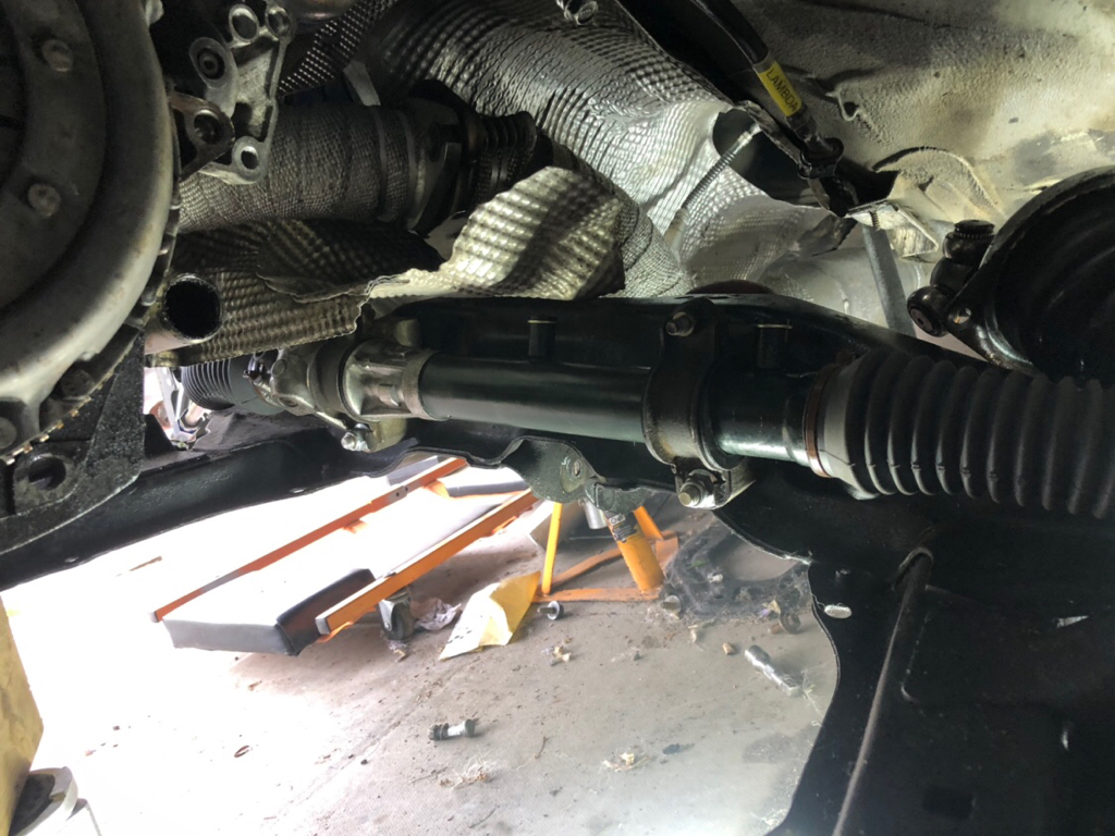

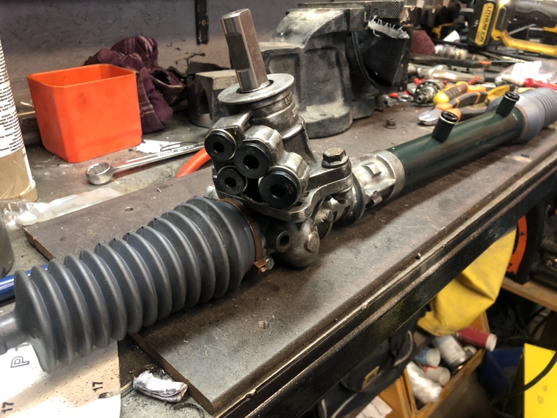

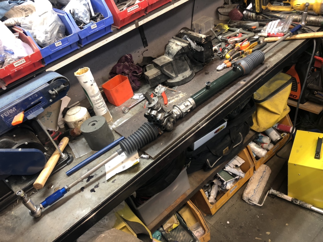

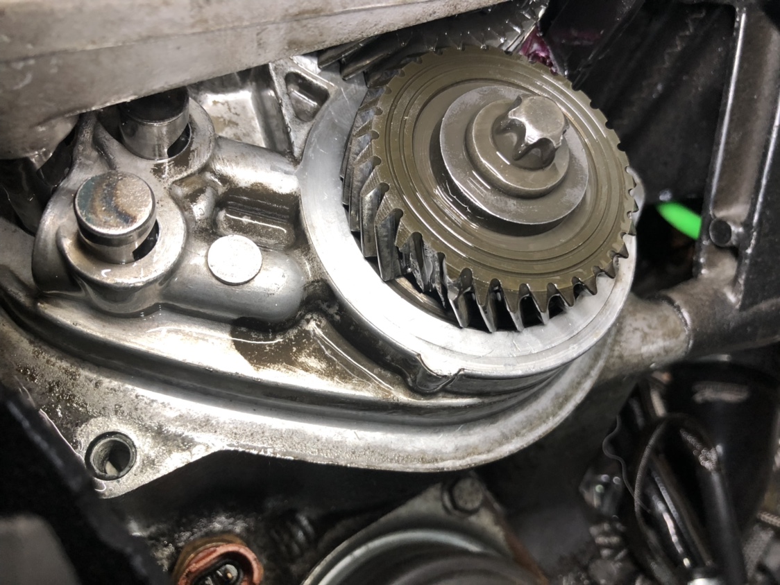

While the gearbox is out and sent to @NorthloopCup for a rebuild. Decided to look in to my steering. Still not 100% happy with the way it feels.

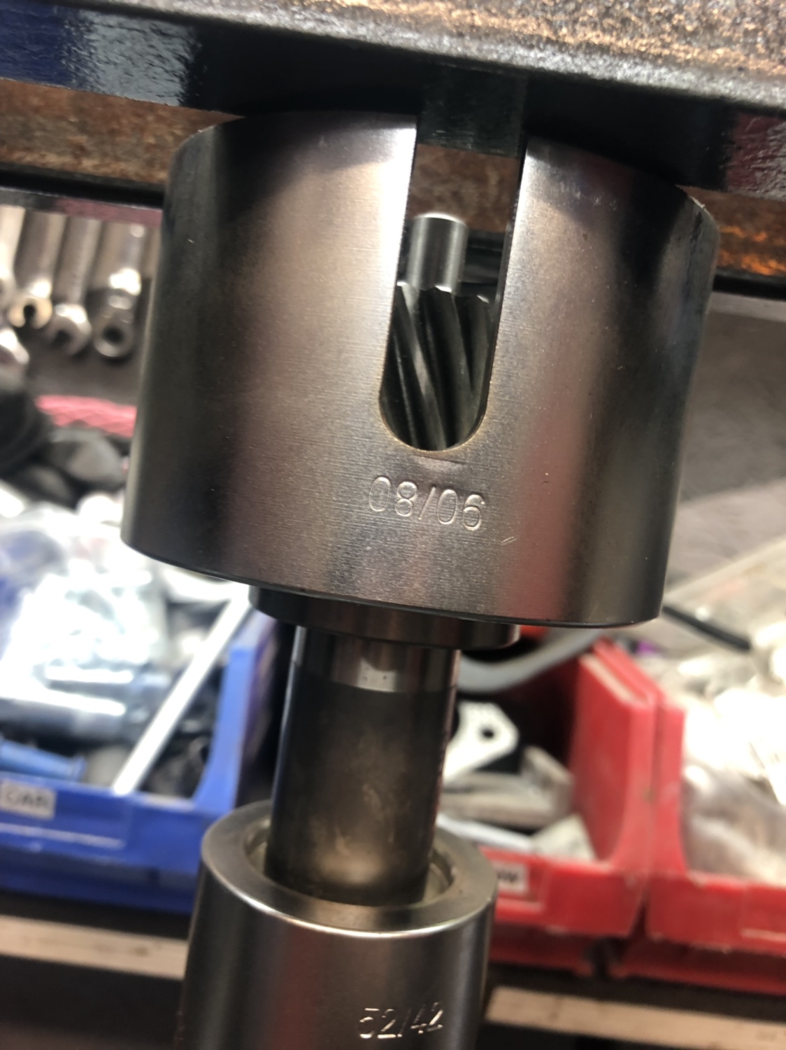

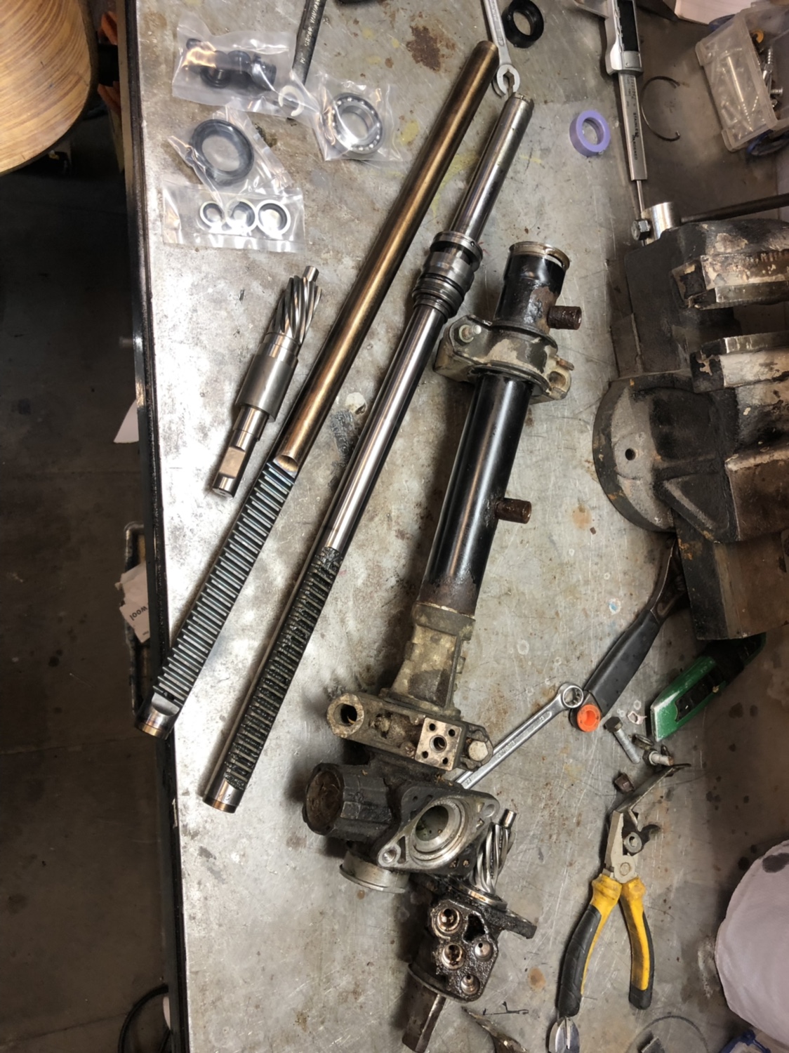

Decided I want a quicker rack in the original SMI casing.

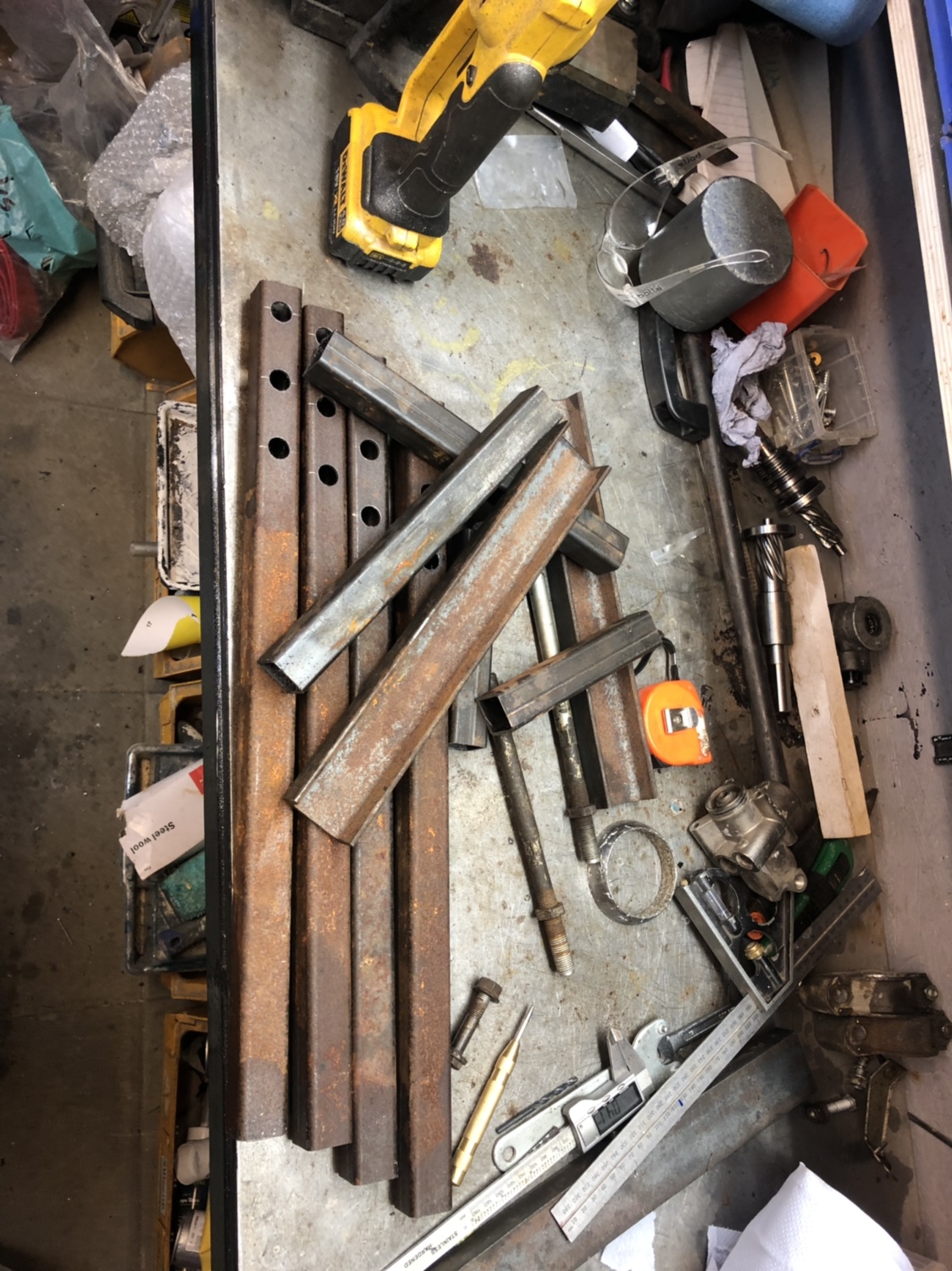

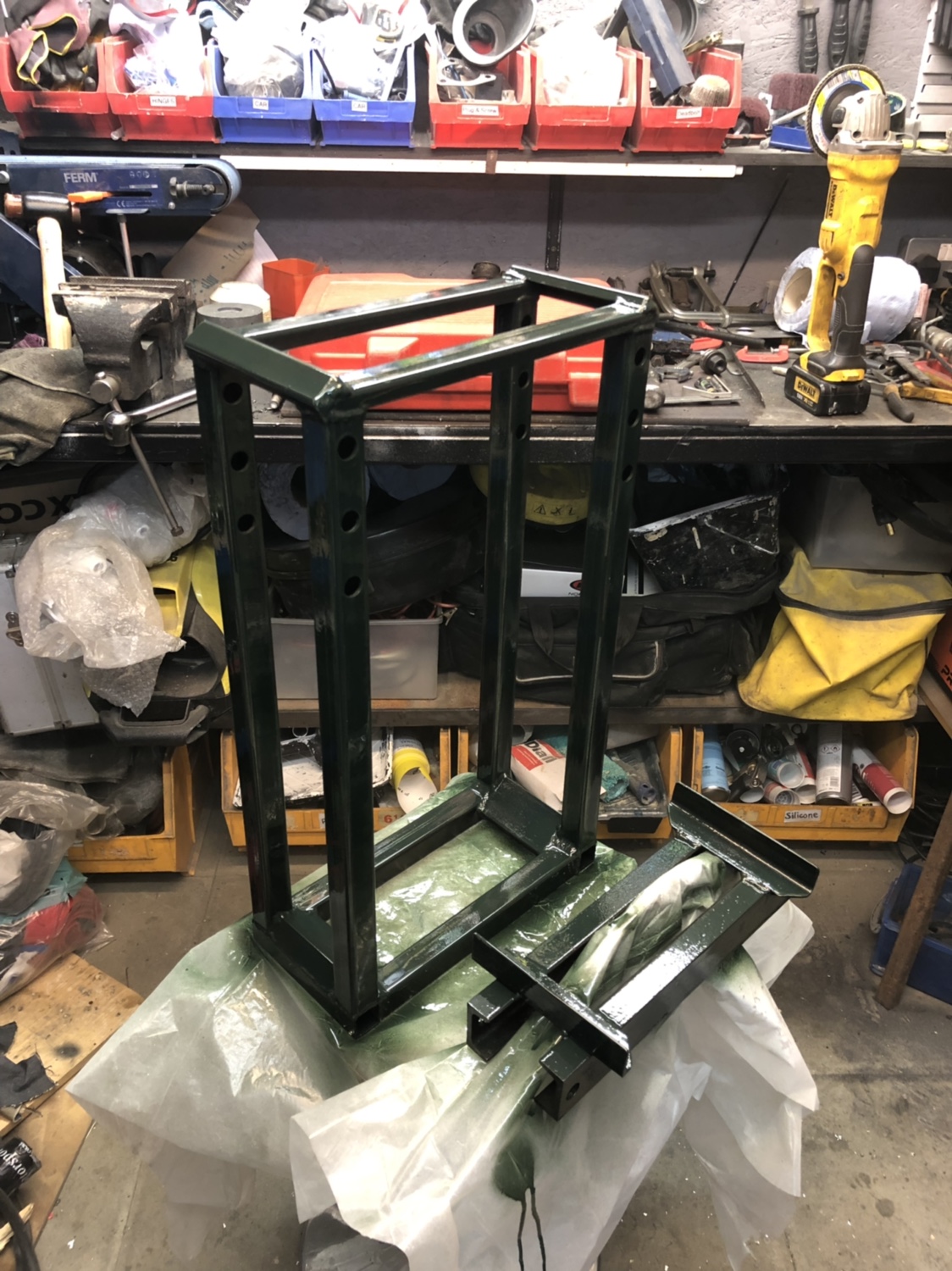

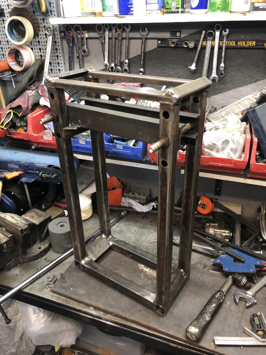

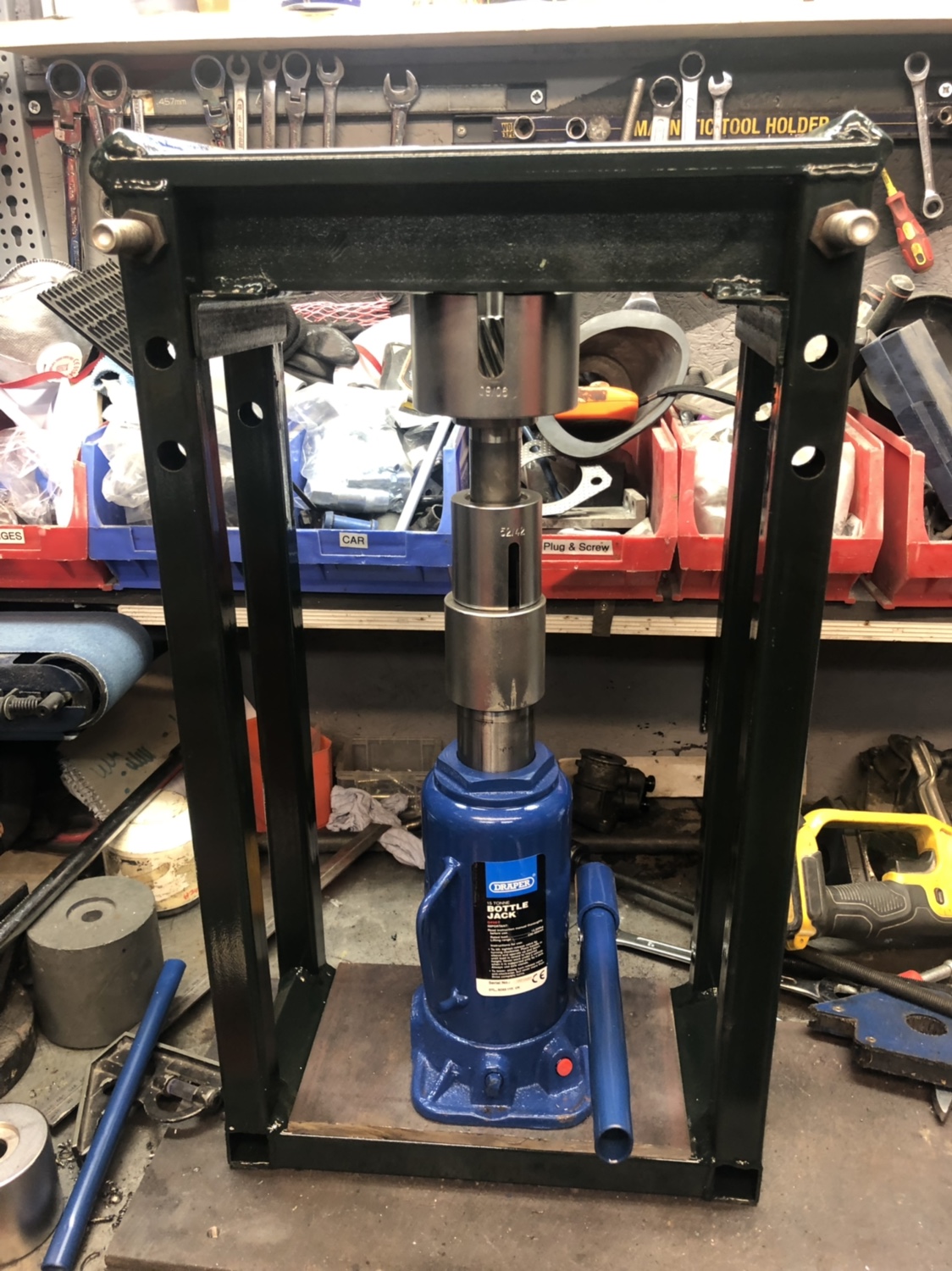

The main pinion needed a bearing pressed in. Didn’t want to go to a local garage looking for a press, decided to make my own lol.
Worked a treat :) I am sure I will find more use for it. Especially with 15ton capacity.
Will try this with my epas set up first. If still not happy will try with out.
Great job on the press! You will not be disappointed with the quicker ratio.
I have around 5.3deg of castor and the front end is very stable although 100+ things are a little twitchy, though you can really feel the front end grip and just gives you more confidence. Maybe you should see how things are with more as that that might be whats missing with your setup?
Gearbox back in. THANK You Mark @NorthloopCup for a quick turnaround!
Shorter rack is in as well. Went for a test drive. Love it!!!
less than 2 turns lock to lock. Will see how it behaves on track.

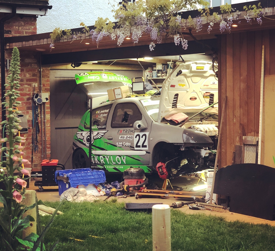

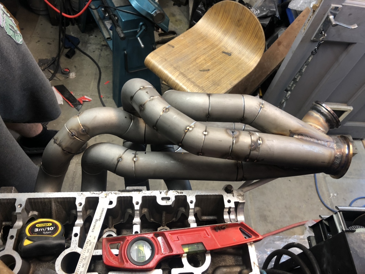

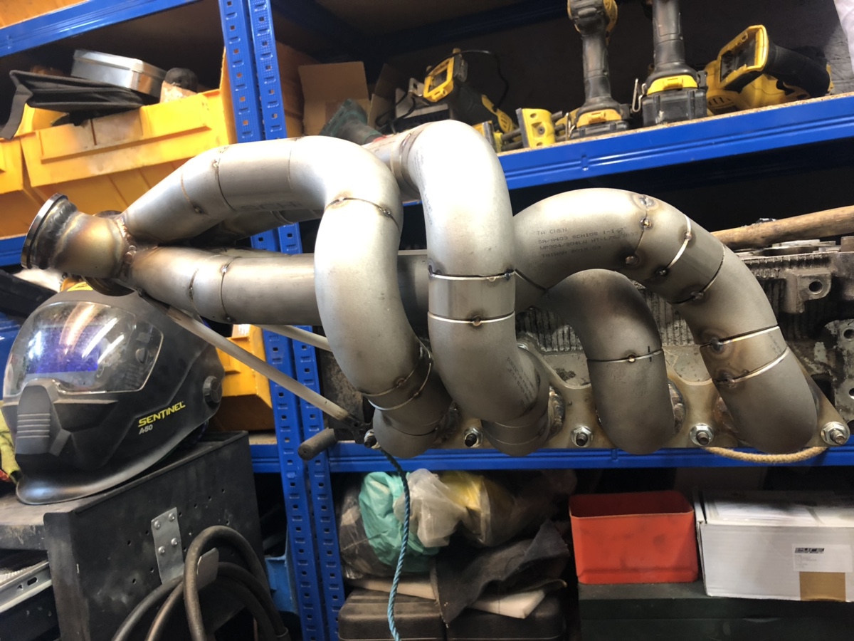

Time to start building new engine. Some parts are here. Some on Order. Can’t bloody wait.

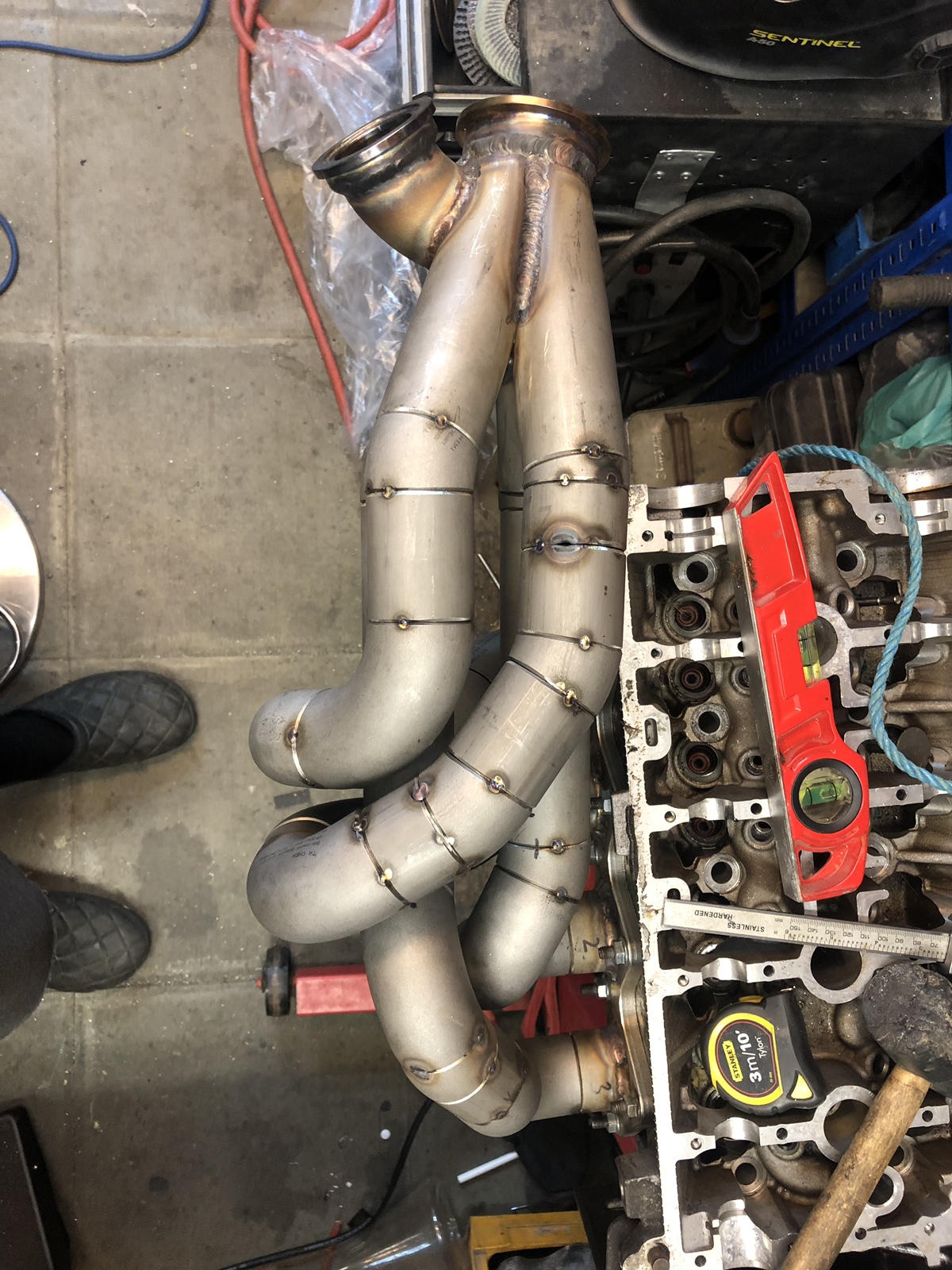

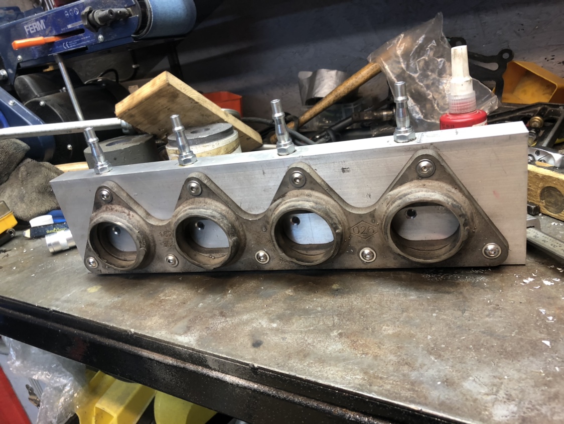

Will be welding my own manifold. So needed a purge block. So made that today
forgot to send your bloody flange though sorry!!!!! will try and get it off to you tomorrow.
Called you today regarding turbo flanges. Ofcourse they a Garrett specific [emoji1787]. If only someone told me [emoji23][emoji23][emoji23]. If you heard back from your guy regarding replicas, I am all ears but since I want them yesterday lol might as well order at full retail :( and also a speed sensor. Ofcourse how can i not have a speed sensor lol

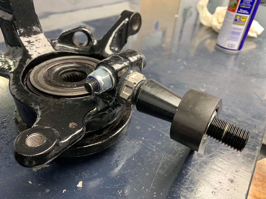

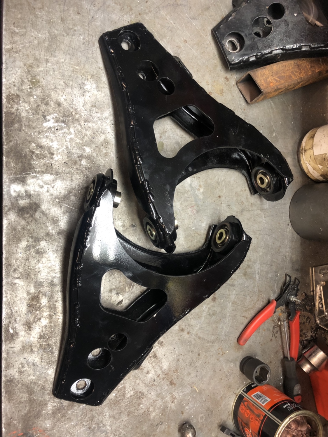

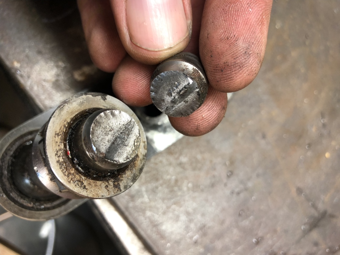

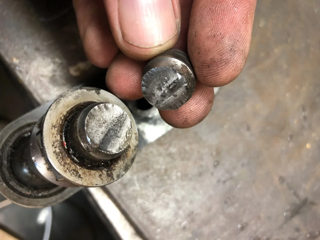

Had a small mechanical failure towards the end. One of my roll Center correction ball joint pins have snapped. Snapped where it wasn’t meant to snap. Resulting in a short track closure lol. Full vid is on my Channel.
Could be my fitting error. Over-tightening or actualy not enough. Or could have been a bad batch of metal with internal weak point. Luckily as a replacement was supplied much stronger carbon steel version. Mechanicaly bonded to the new hubs with F1 bonding adhesive [emoji41]. F1 Clio 172 now haha.

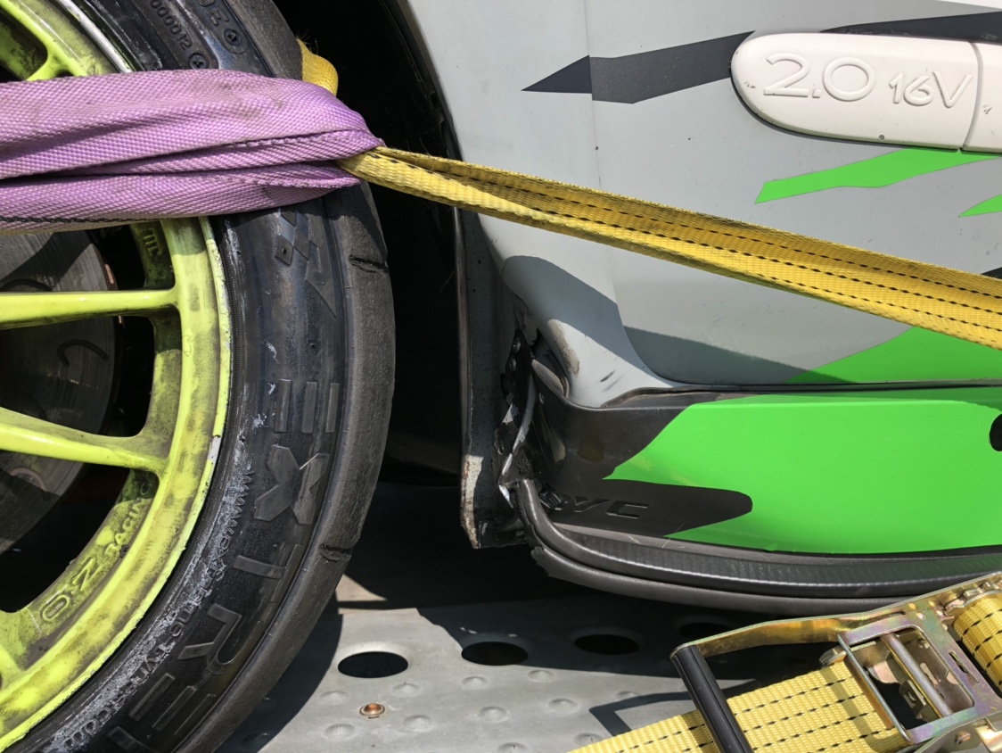

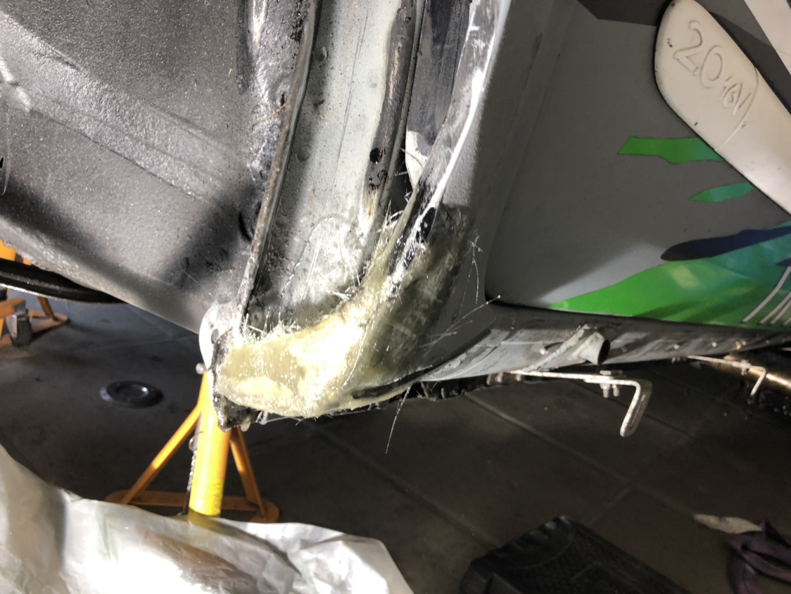

One of the wishbones was damaged from recovery track so needed to replace those. Decided to upgrade to PMS bearing kit at same time.

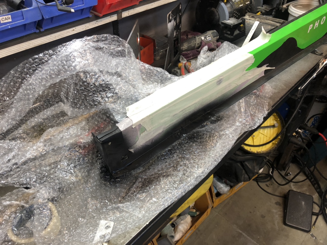

body panels were straightened, welded, fibreglassed and refited.
good as new! Car was assembled in time for snetterton and successfully passing a test.

This is my worry with this style roll center kit (i have the same kit fitted) over the one that Northloop does, Im sure they decided to go with a pressed fit into the hub for this very reason.
Was there any play on the ball joint taper on the old hub that could of caused stress at the pinch bolt groove.
It’s hard so say. Like I said it could have been a number of reasons. I simply don’t remember how well it fitted inside the hub before. They were used hubs. So very good chance the hole was not with in tolerance. The thing is, high stress components do fail on race cars. No way of predicting anything when pushing to it’s limits.

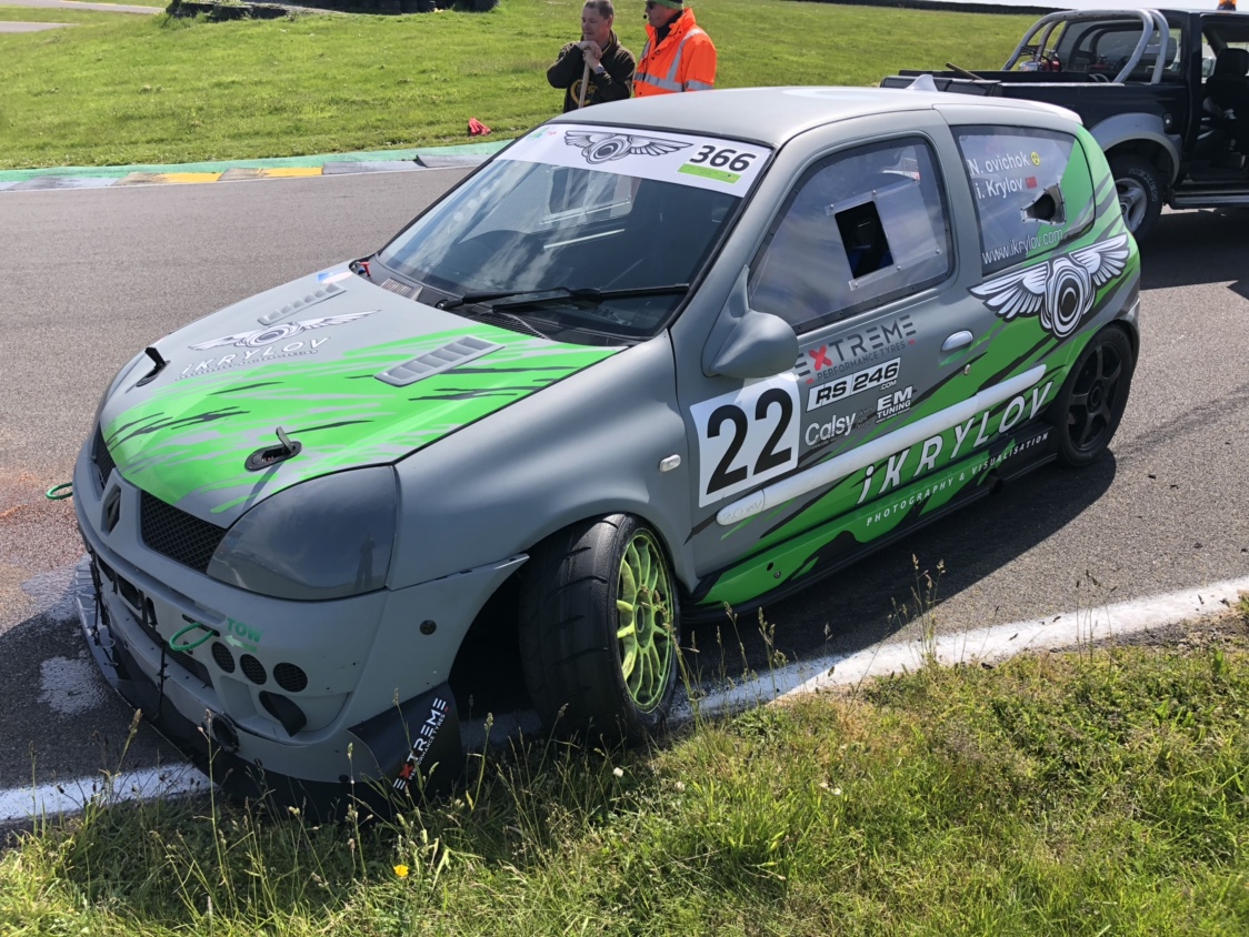

Did my First competitive even at Blyton park with Javelin sprit series.
Being a turbo this put me in J07 class. Among mini Gp2s and other more exotic machines.
But nevertheless I managed 5th in class out of 12 cars and 20th overall out of 76 cars. (But I think only 56 rank up in normal classes. But 76 sounds way better.)
My best time was 1:12.39
Overall great day! Will do a few again next season.

With the roll center kit thats the 4th one i know of thats sheared in the same position , a friend is looking into getting some new pins machined out of higher quality steel and also with out the lock nut.
He had an engineering company look at them that machines some F1 parts and they picked up a number of design flaws in them that could cause dangerous shear points.
