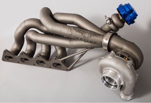

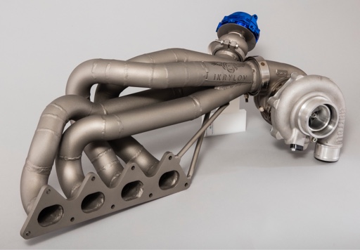

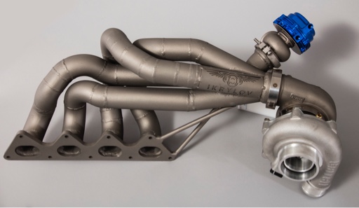

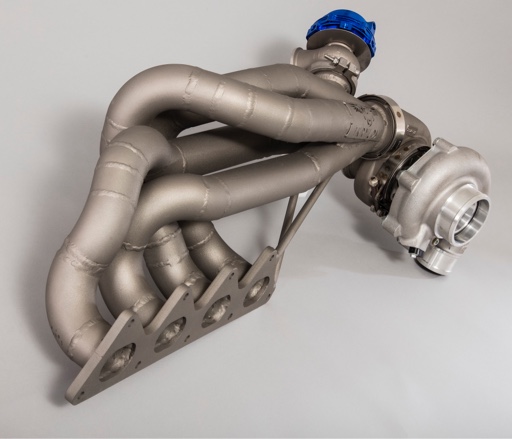

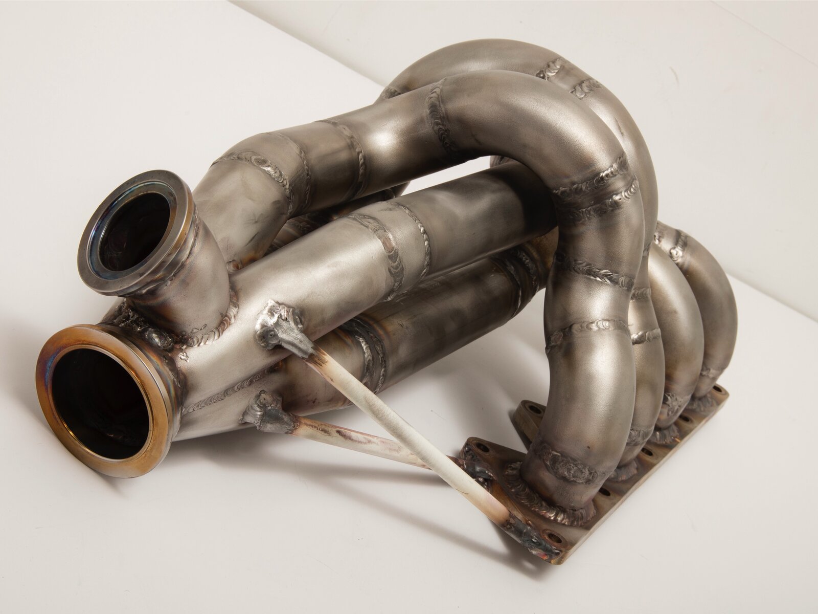

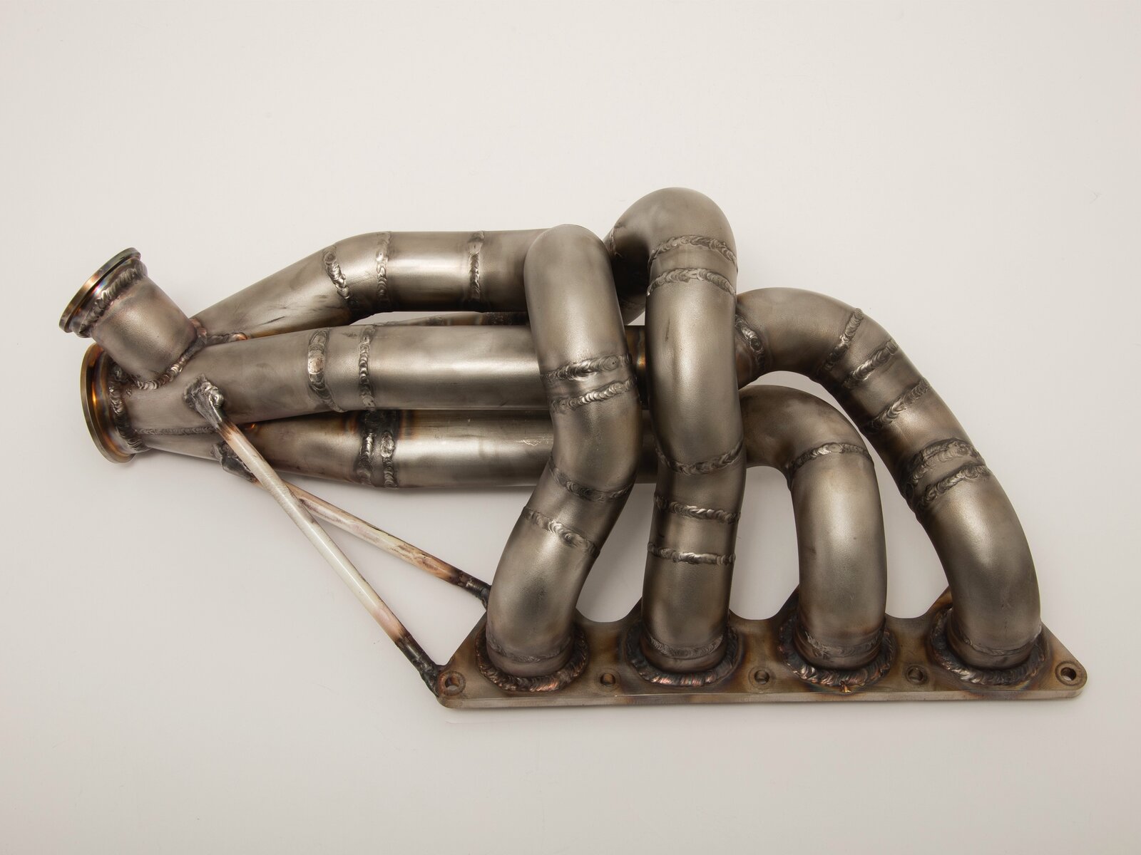

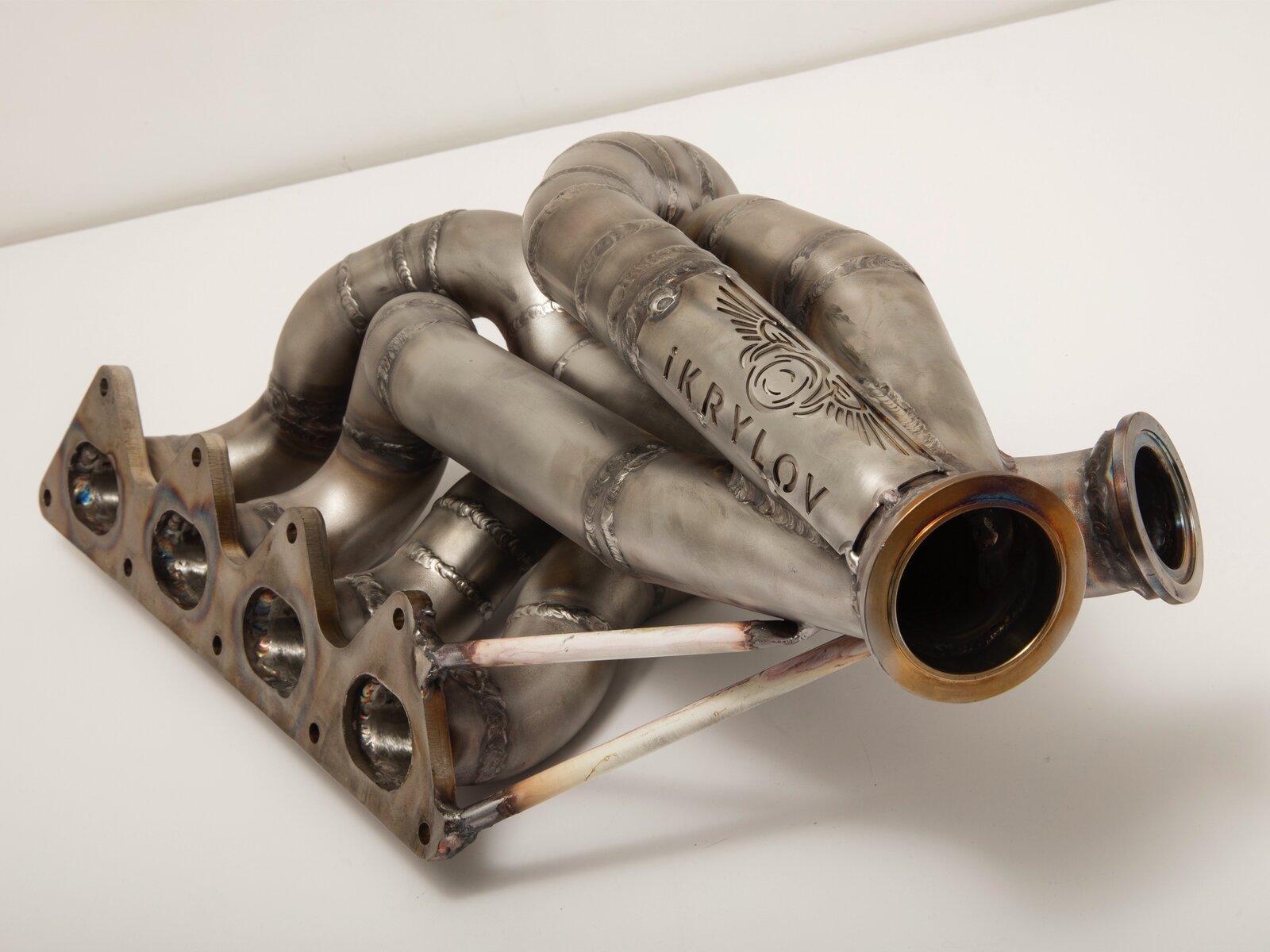

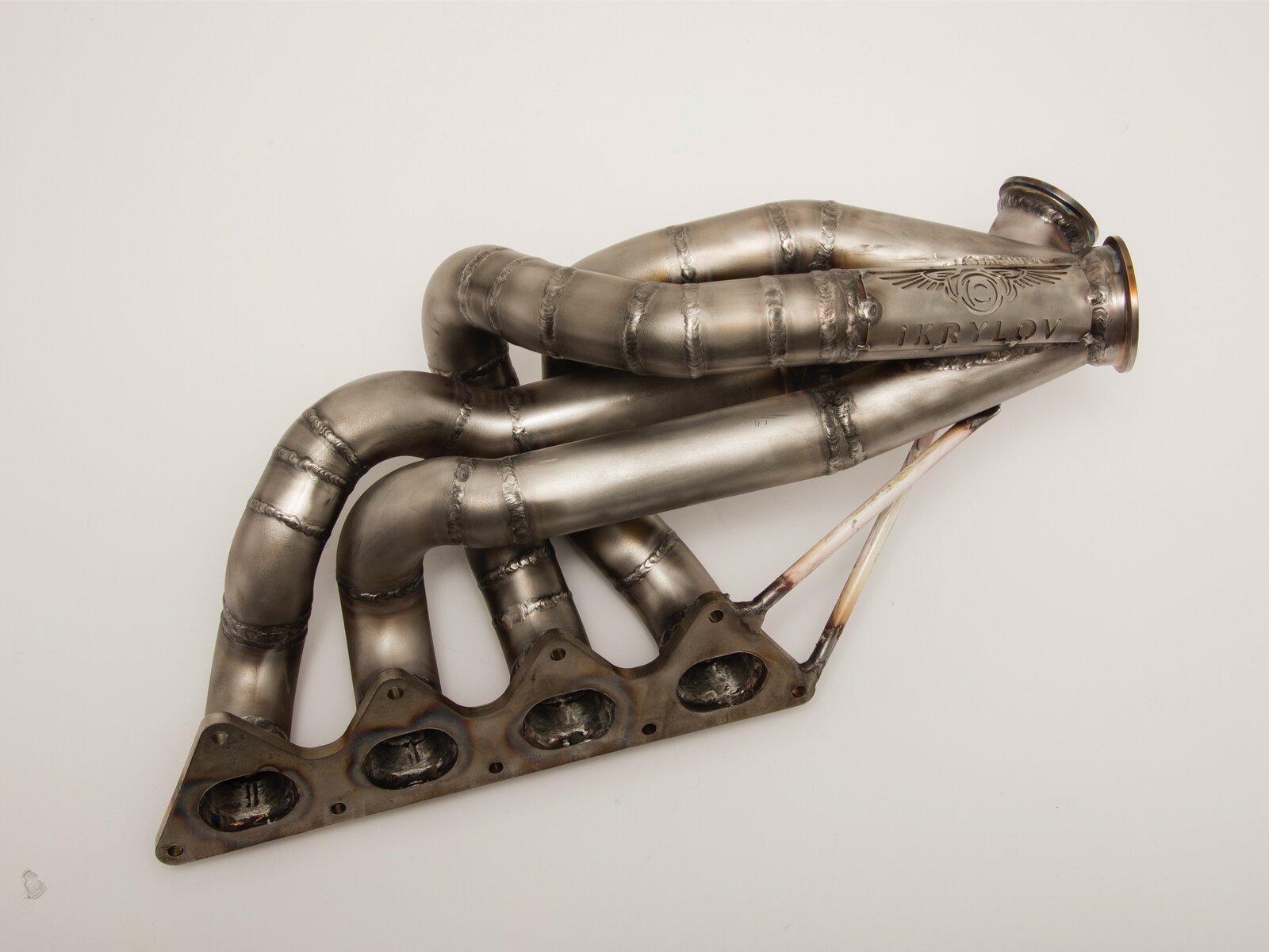

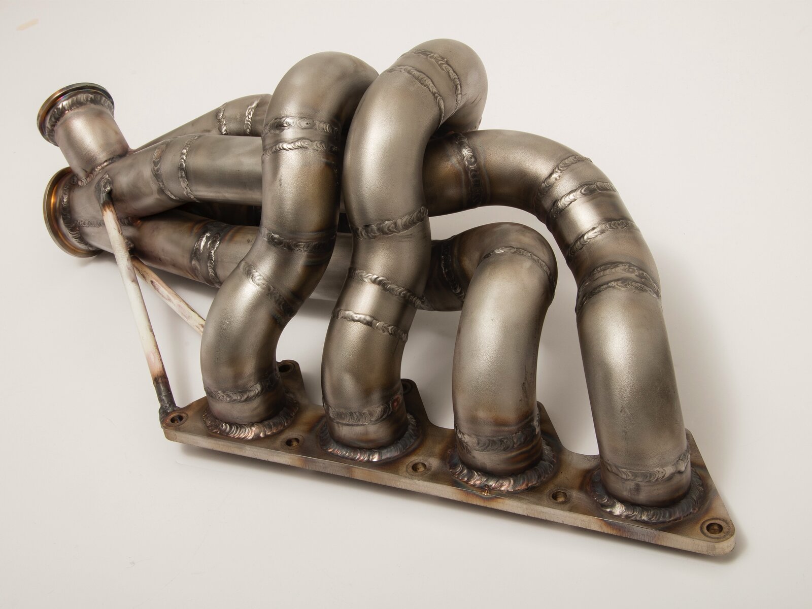

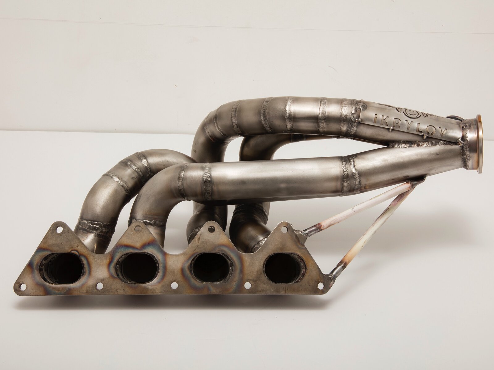

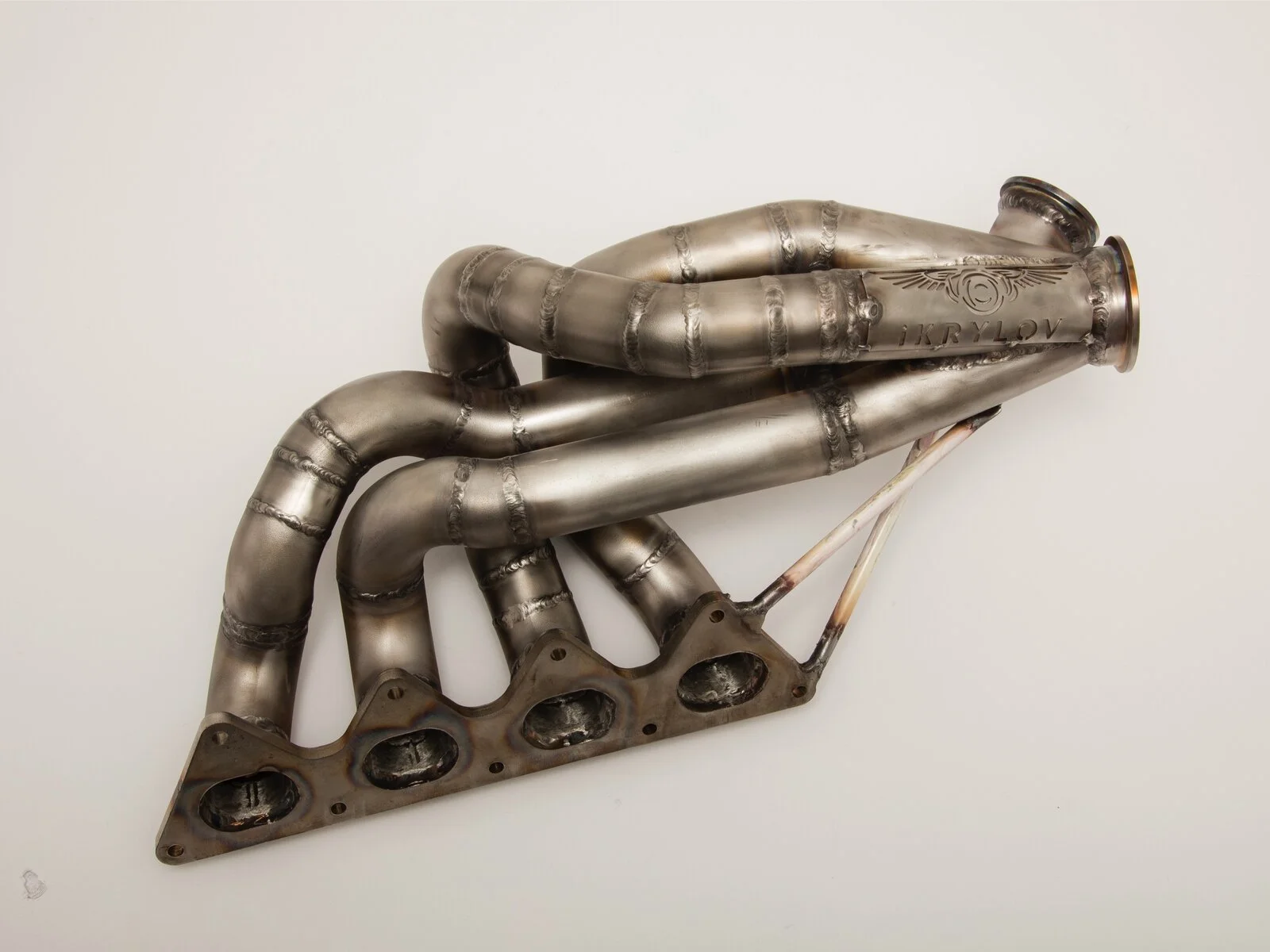

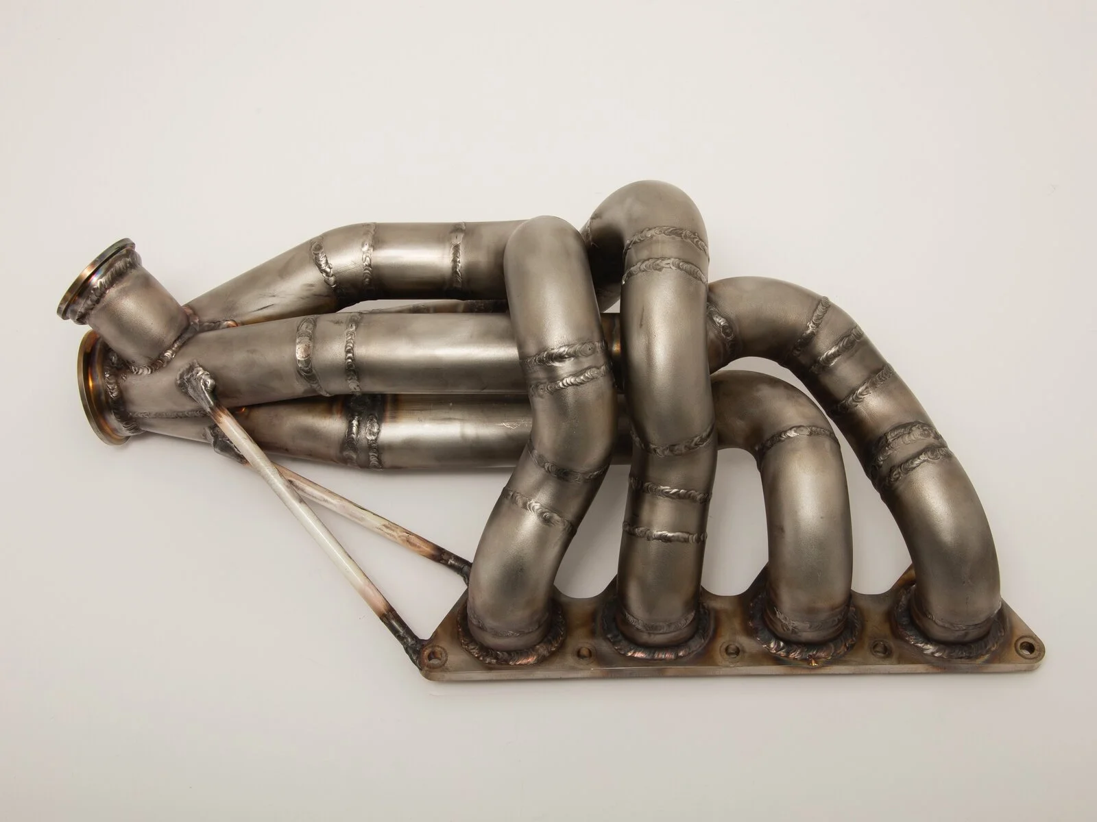

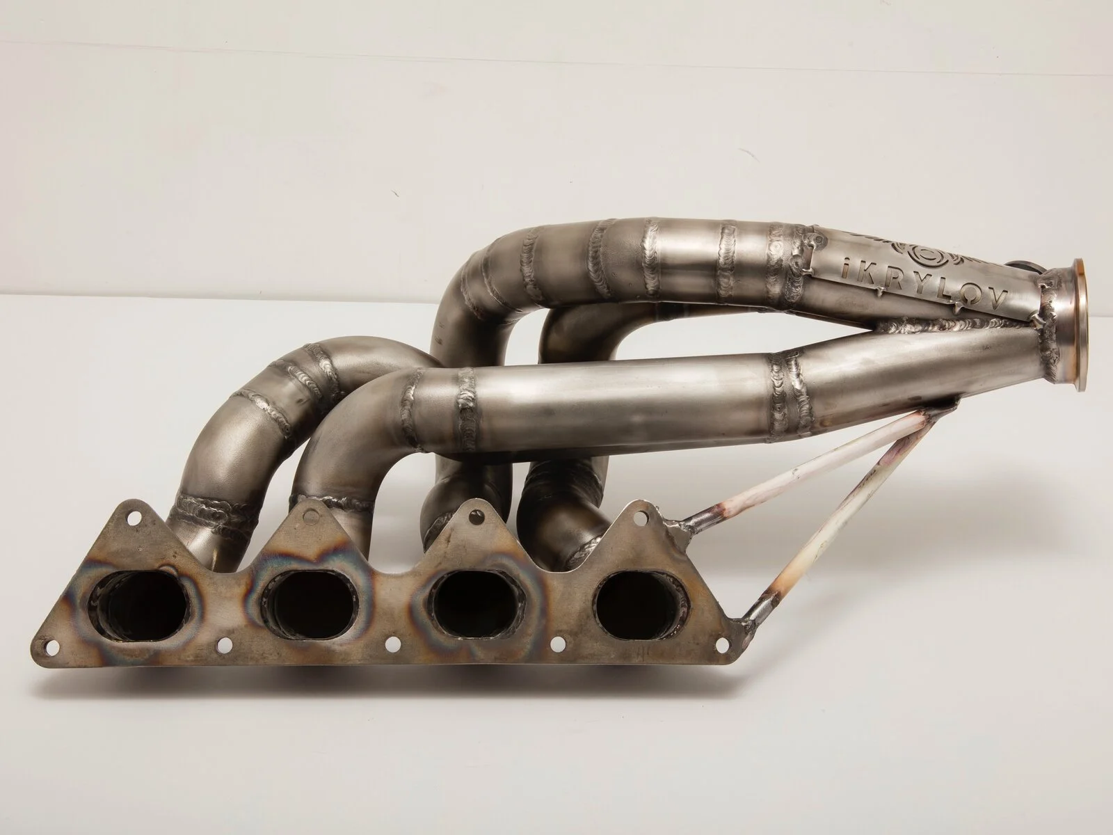

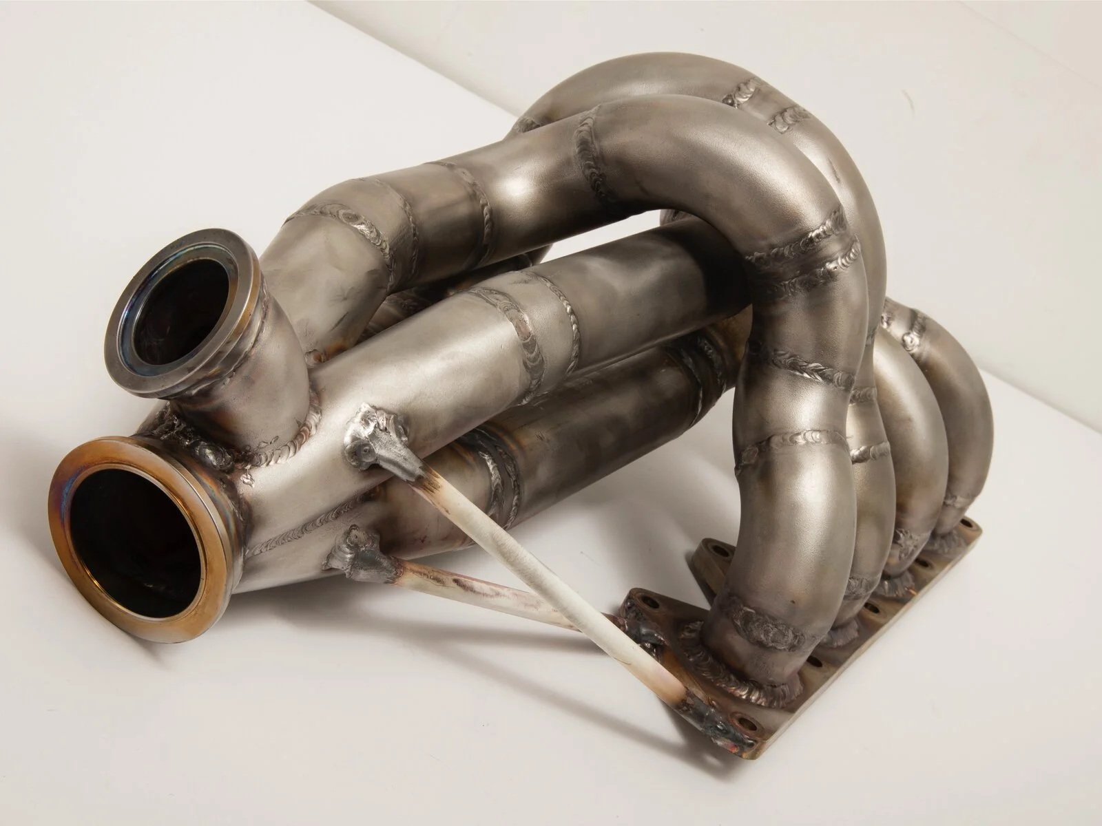

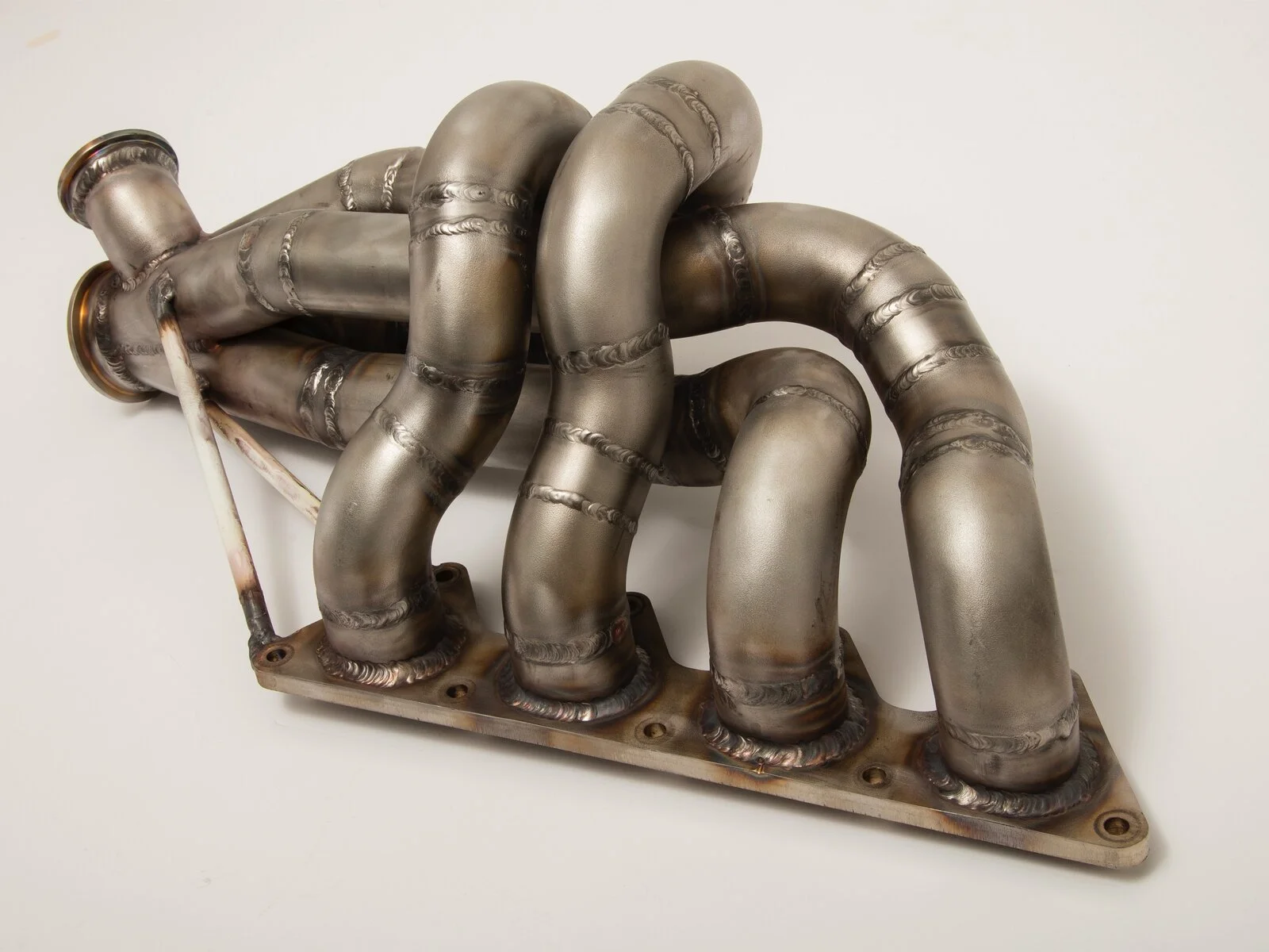

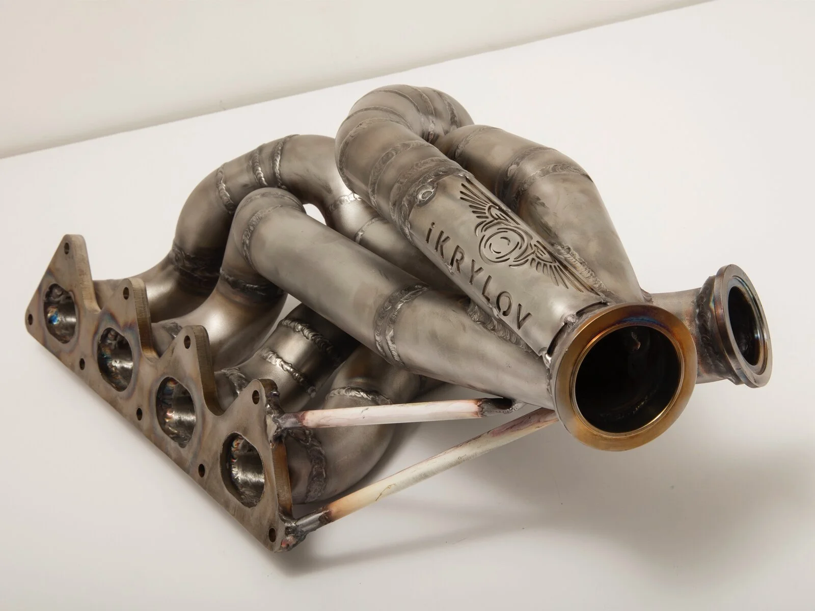

biggest update is that i have finally finished my manifold!! i know its not a work of art. considering it's my first ever manifold. I think I have done well enough.
built using schedule 10 elbows and pipe. tig welded. (yes I know crappy in places. i am only learning) and back purged.
i have dropped it of a few days ago at ceramic coaters. will look 10 times better when it's back.
and here is a part1 video of the process. Yes, i am really pushing my Youtube venture now. Show your support by watching a few videos and dont forget to subscribe and/or leave a comment. liking a video goes a long way as well. :)

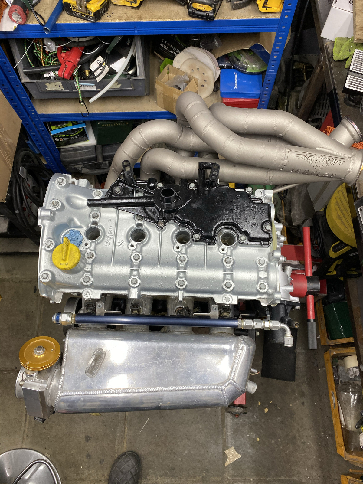

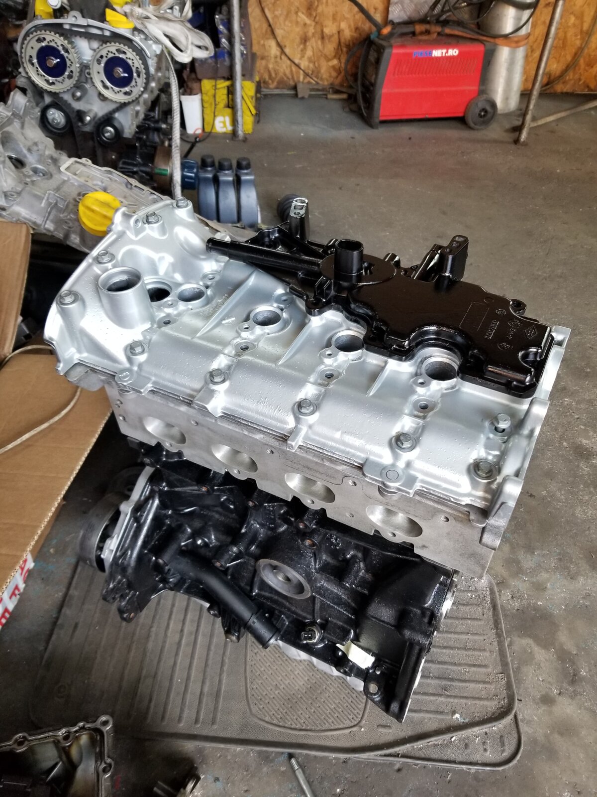

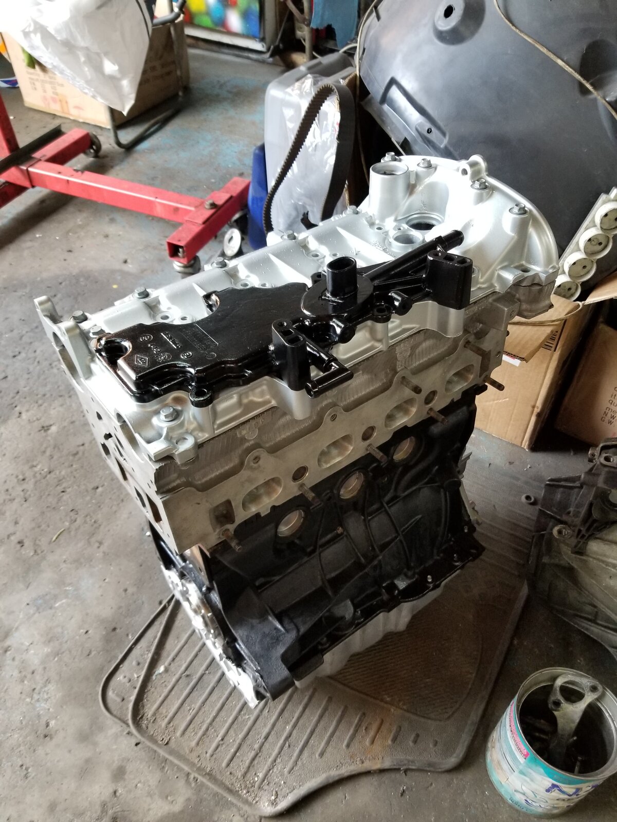

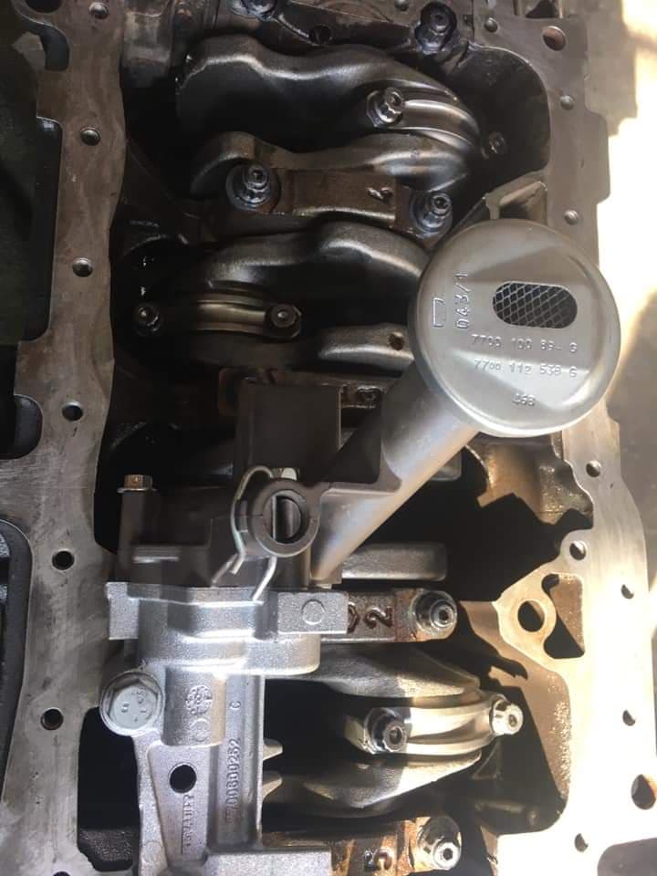

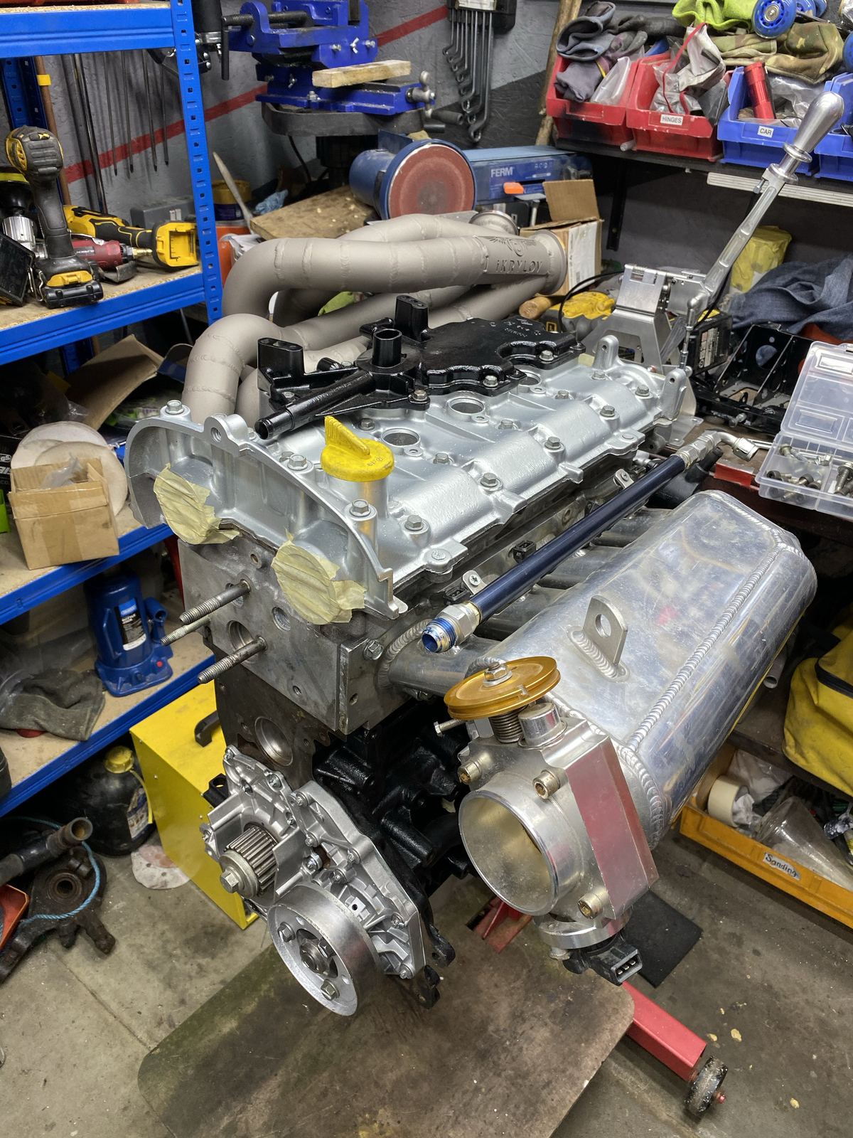

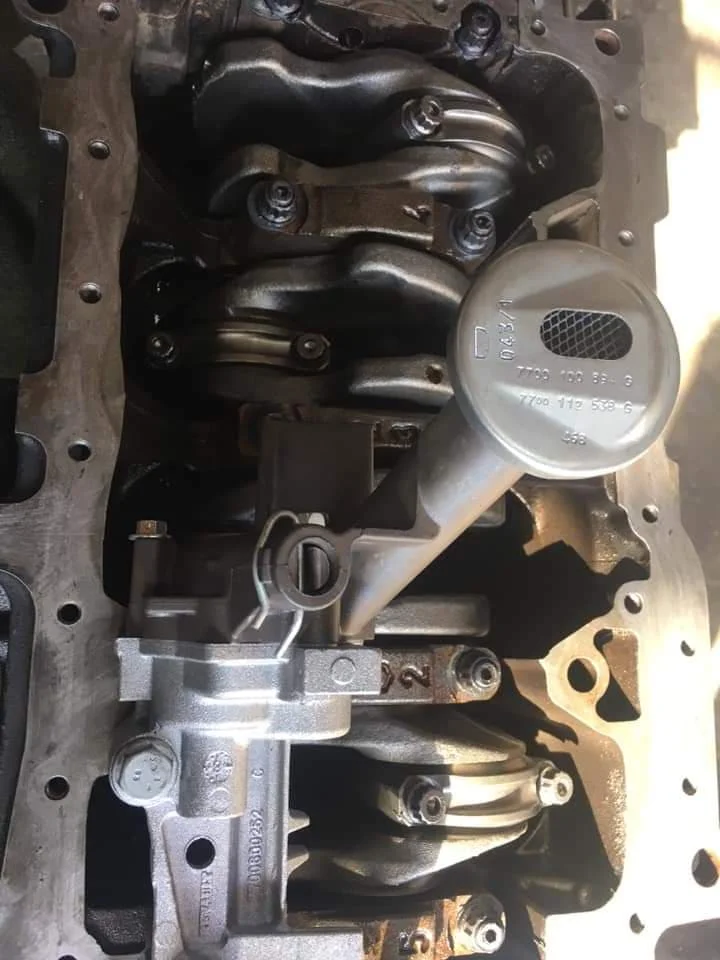

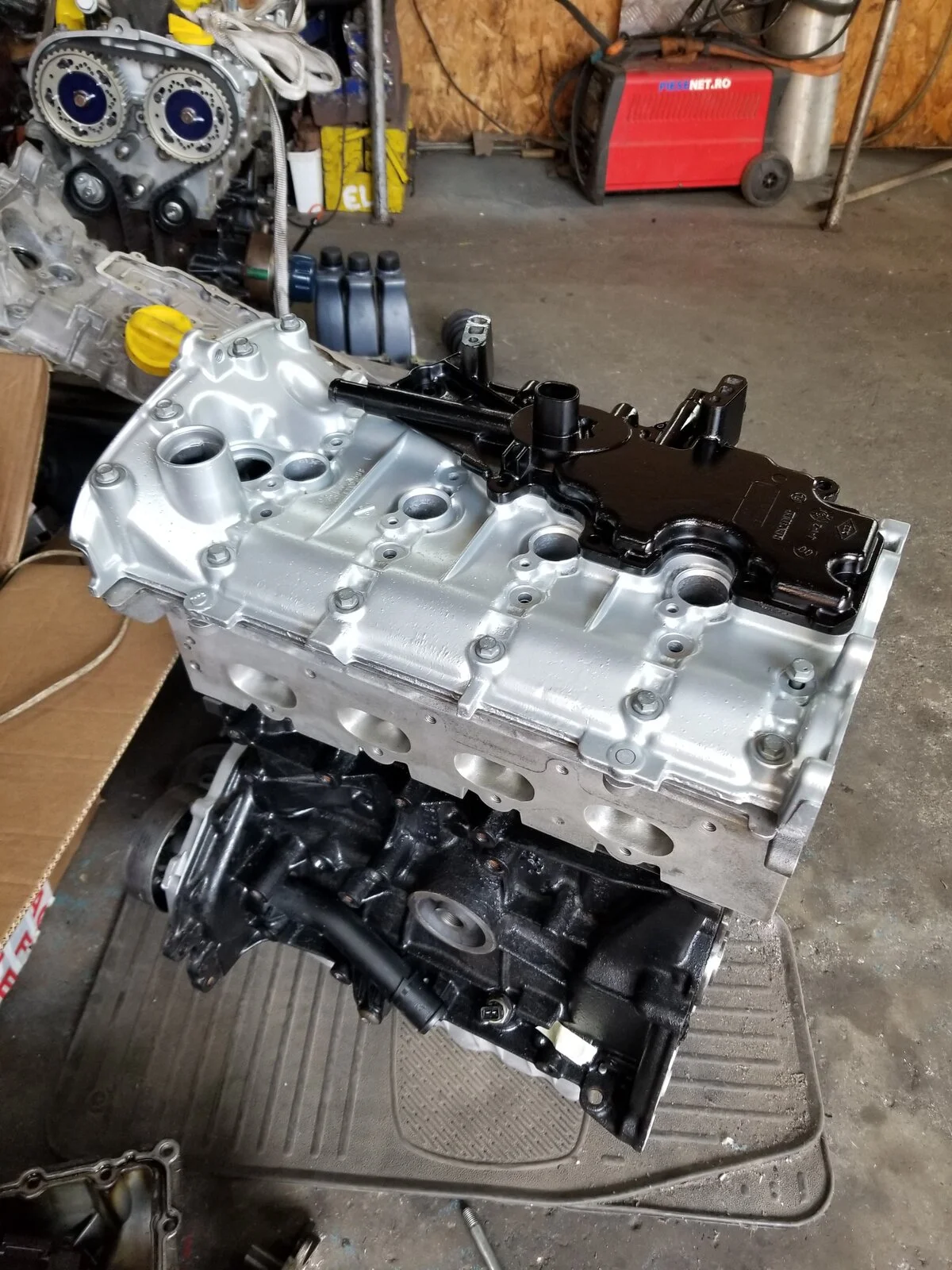

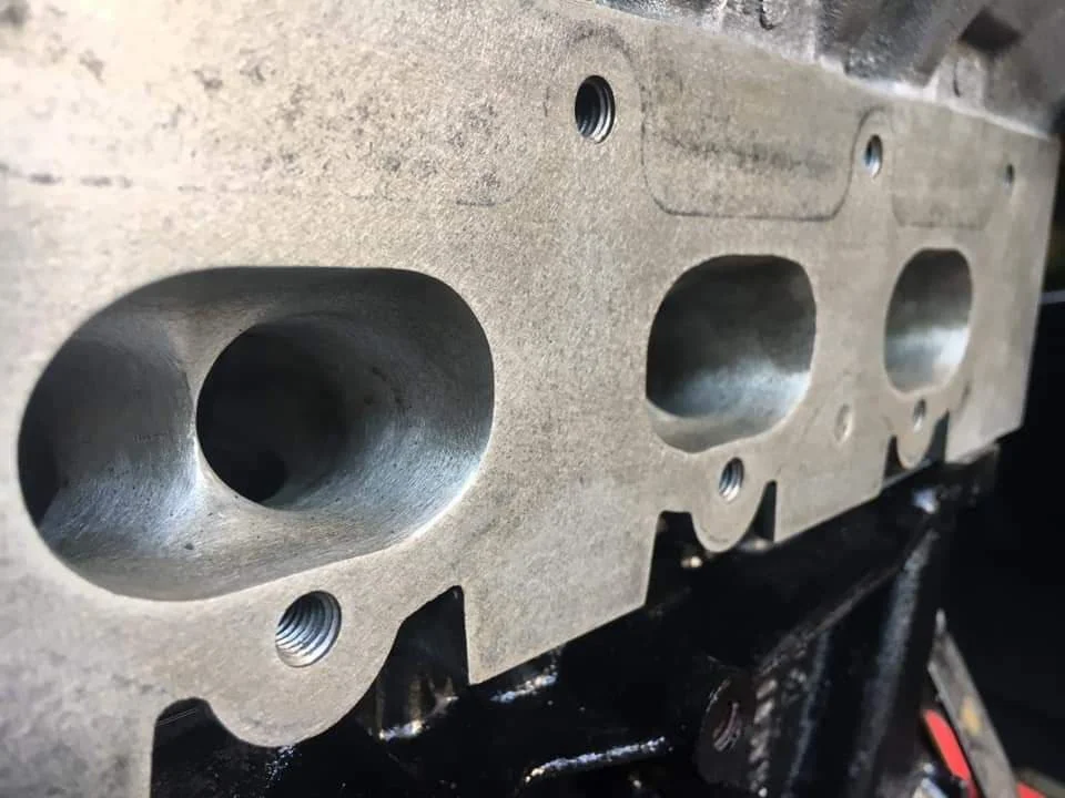

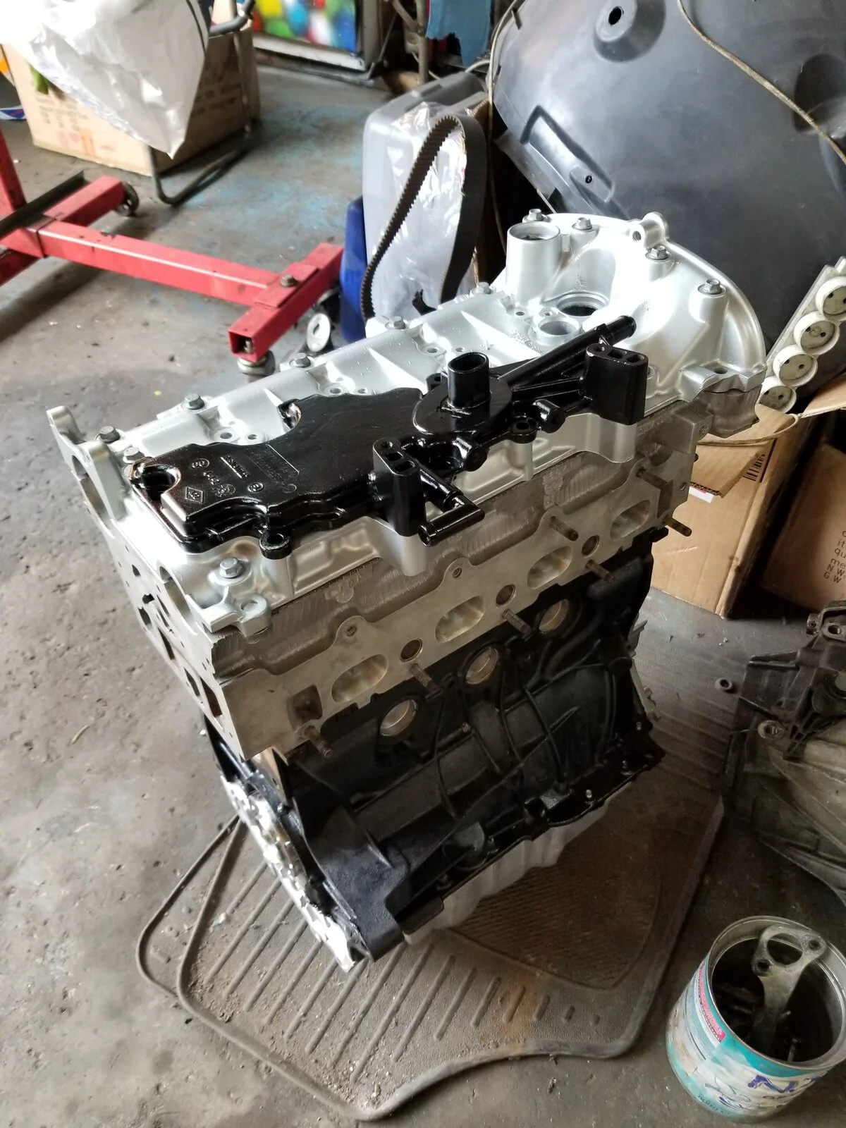

another update is that my engine is almost done and should be here in October. plan is to build this all up over winter months.
quick spec:
wossner 8.5
FCP H-beam
king Race bearings
ARP, studs etc
Supertech, valves
Catcams springs
197 new machined crank
ported polished head.
everything else new.
+ custom inlet
+custom manifold
+G25-550
etc etc.
should be good fun!

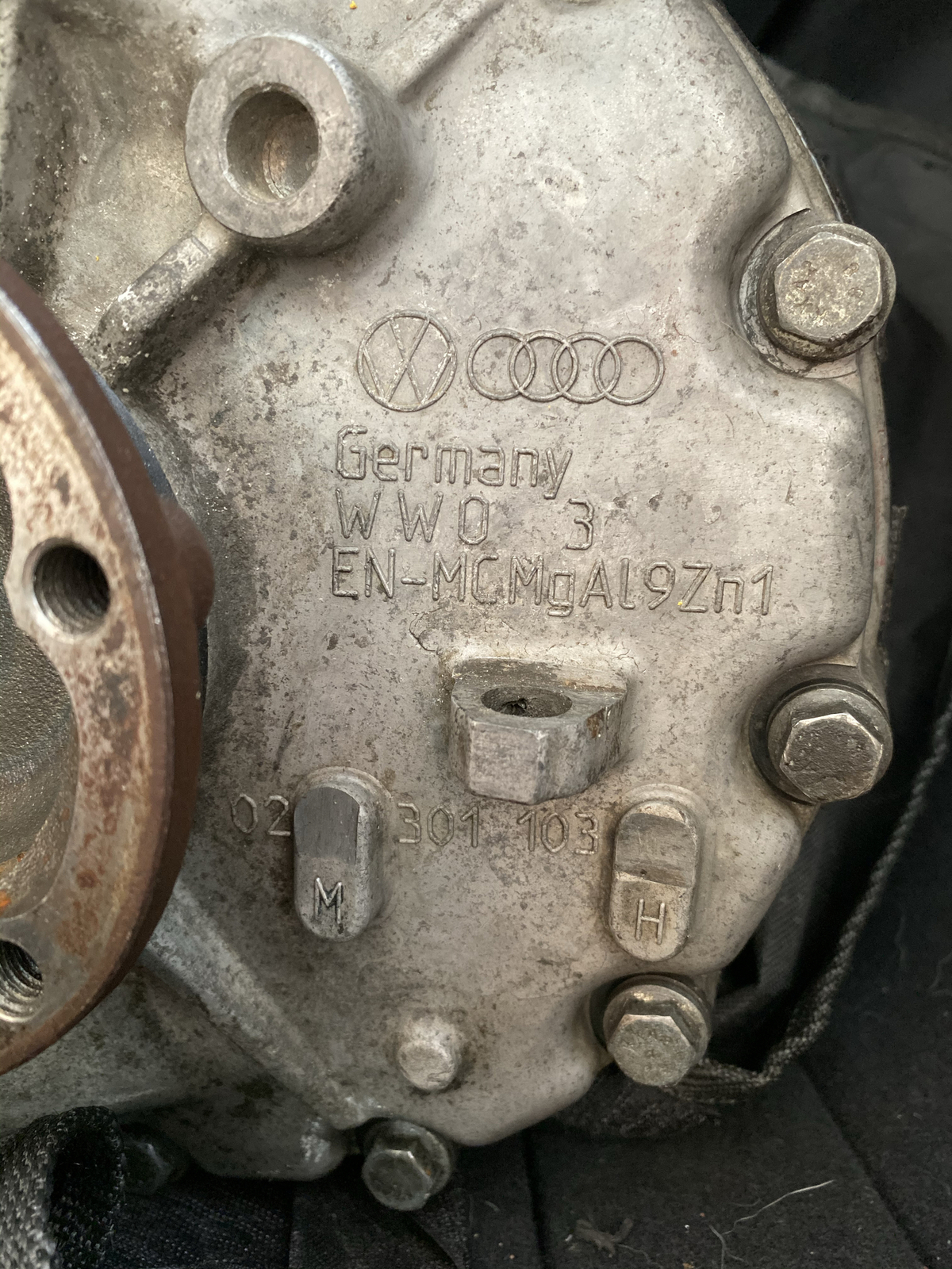

Well, the adapter plate and modified flywheel from EFI are more than the price difference between the LSD's.
For handling the power, offcourse, it makes sense. But so does using a 20VT for big power instead of an F4R I suppose?
20VT will do up to 300 on standard rods but you have to then design and engineer the OSF mounting.
02M is a tried and tested upgrade whereas it's mainly been backyard mechanics that have dropped a 20VT into a Clio and most conversions look like they leave a lot to be desired😂 Plus @pule333 has already got a forged engine and everything else so it would be taking a step backwards dropping the VAG lump in
I got a good deal on complete conversion kit. Inc drive shafts, clutch, fly, box, adapter.. so was rude not to.
