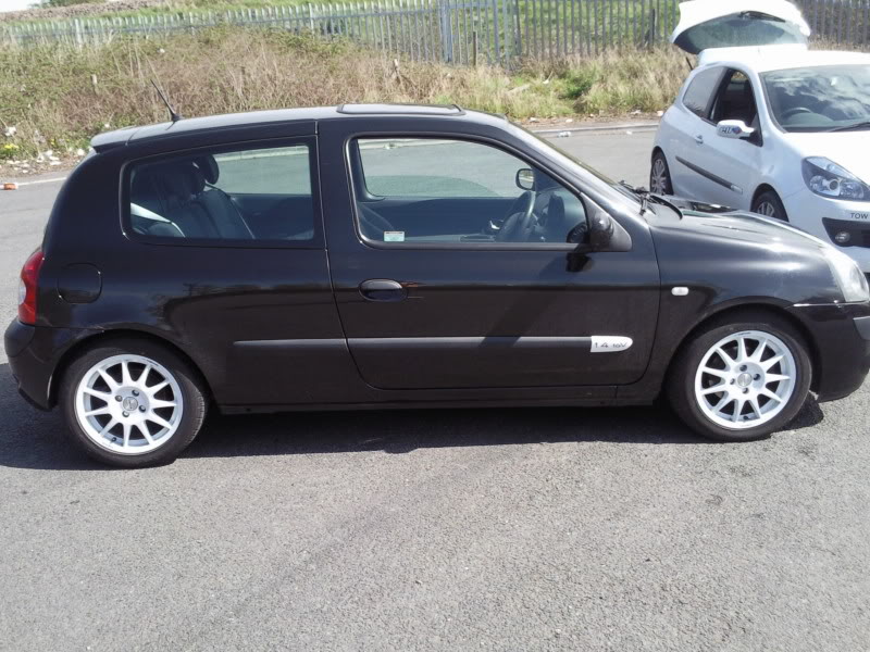

I want to paint the calipers on my car. Not sure what colour to go with. Ideas?
Also how do you do it and how long does it take? I need my car everday to get to college and work a few nights a week.

I was thinking that. Taking off the wheels is a must, have to be not with it to do it with them on. Im not liking the idea of black. I want them to stand out a little bit. What would silver look like?
Oh and, my 15s are perfect ;) not getting your hands on them haha

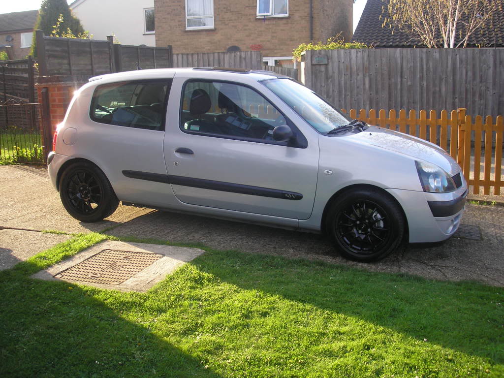

Hmm looks good on your car because its a light colour next to black wheels. cant see it looking good next to mine though. Would just look like brake dust covered calipers lol.
