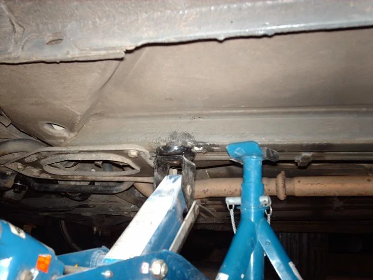

Just bought a Dynamique and looking to paint my calipers, but wanted to check where the jacking points are? I've looked on a couple of sites and apparently Clio jacking points can be quite weak, so just wanted to check first!
Thanks in advance
Just behind the thin sill you can see from the outside of the car, There is a solid jacking point behind seen in the pic.
(Pic is found in the guides section, Attached it just to help you)
Jacking the back, Use the rear beam.
