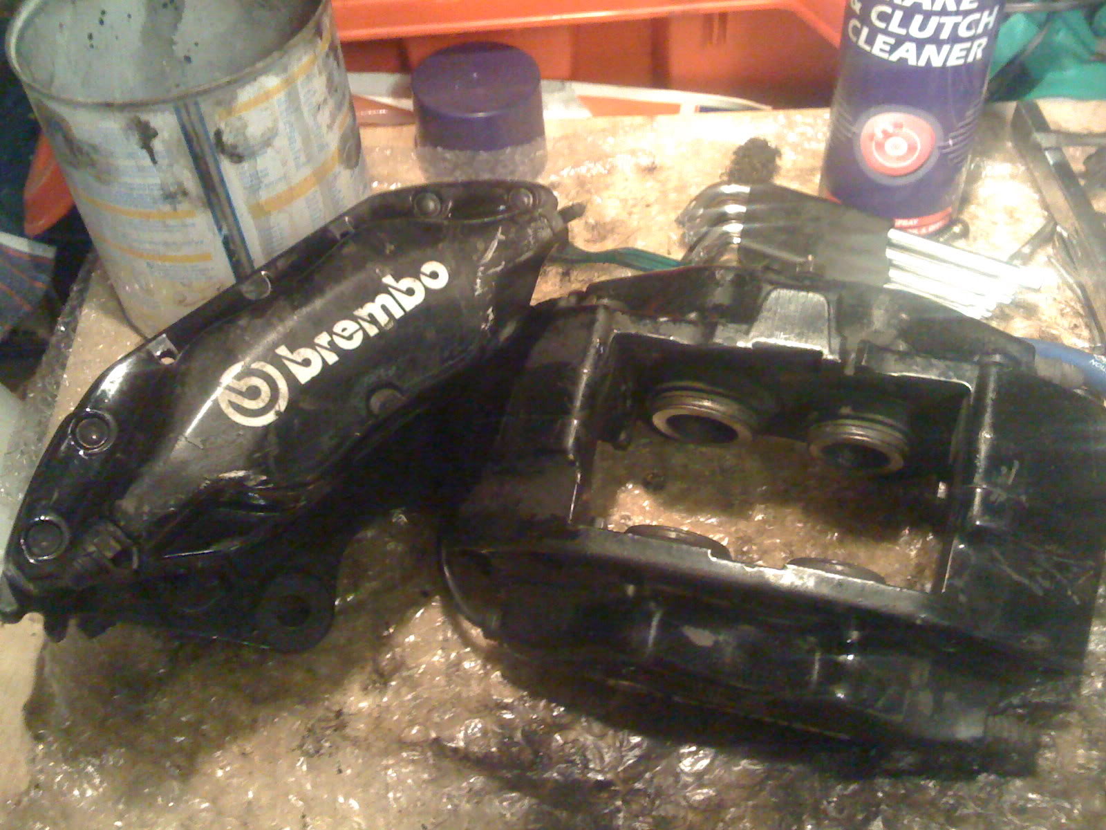

Hi there, im fitting brembos to my car but they are in a bit of a sorry state at the moment, lacquer peeling etc, i want to paint them red but how do i need to prep them? Do i need to use primer?
My plan is to plaint them red, refit some new stickers and then lacquer them again. Can anyone advise on best paint/lacquer to use?

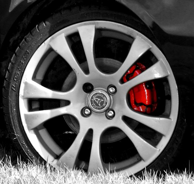

These are mine that I did a week or so ago.

sand them down? really? the brembos have a like plastic covering on them. I fi start sanding them its going ot make a dogs dinner fo the surface finish. I was thinking i could just make sure they are spotless clean and then paint straight on?
