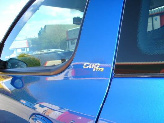

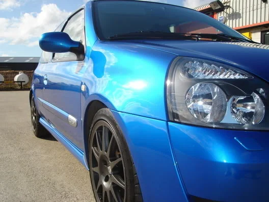

i'd just clay, super resin polish, then use some extra goss protection, thats what i do to mine from time to time, here are the results
