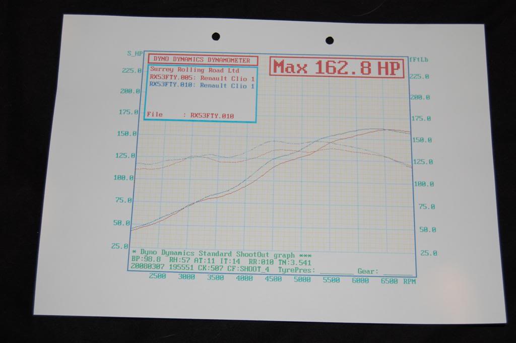

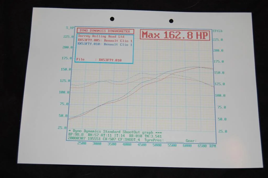

my car made 175ps (173bhp) on the rollers, at a RR day where the results were VERY accurate and consistent.
obviously different cars /engines are different, and make different power but when most 182's and 172s were making just under book power, mine making over seemed to be good!
