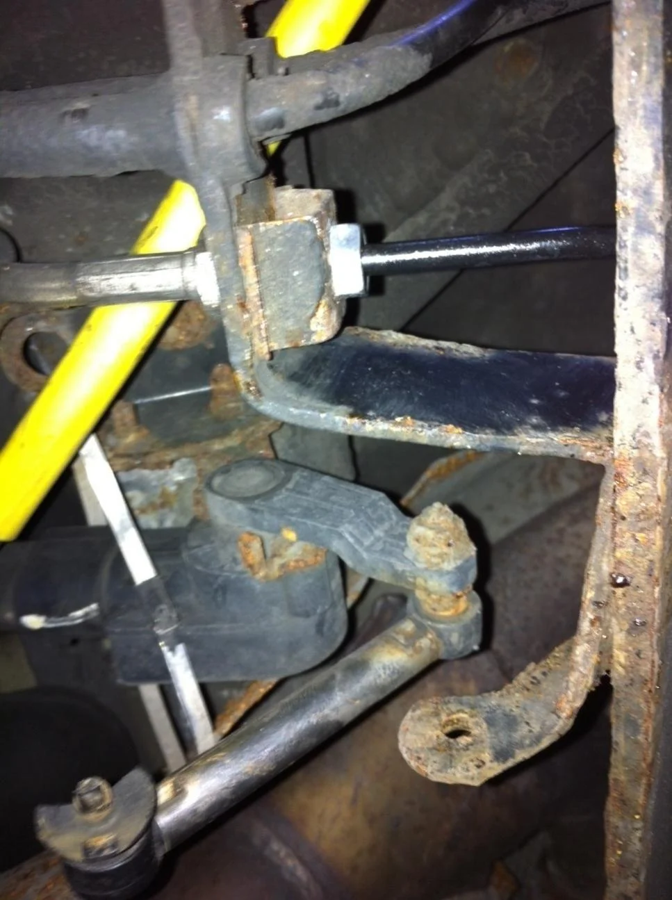

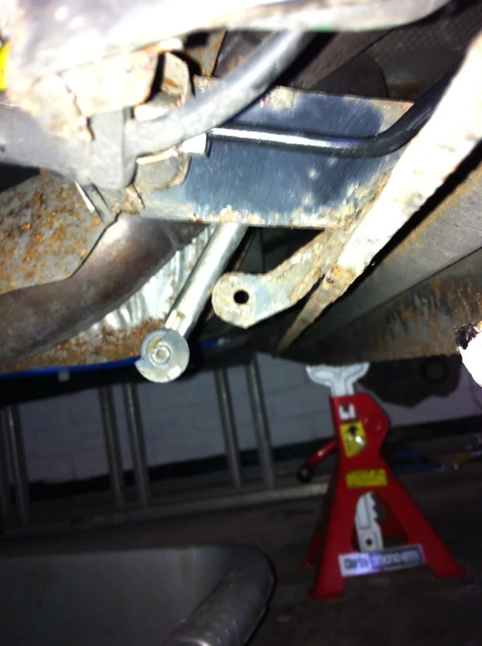

I have found that the brake bias adjuster clip has broken off due to the arm seizing. Can someone help me out please by telling me the part number for the clip. The renault guys can't seem to understand the picture.
See attachments.
The hole seen on the bracket from the rear axel is where it should be connected to
I require the complete arm back to the pivot point and the clip bit.

That's definitely not a bias valve - there's no brake pipes going into it for starters :)
It's the xenon height sensor - it moves the xenons up/down depending on the weight in the boot
