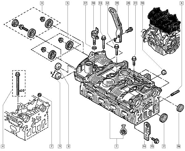

Part numbers
2 - 7700106271
16 - 8200058022
As for the belt kit any will do really.
Thanks Matt, but those are the blanking caps on the other end of the head, its the actual cam shaft seals i need? not sure if thats item 5 or 8 on that diagram?
Cheers Ashy
Fit the INA kit. INA kit will come with the core plugs (gearbox side - part numers 2 & 16 in the diagram) in the kit, cam seals I'm pretty sure they come in the head set, but to buy seperatly you have to get them from Renault.
Just checked that today, the seals are not avaliable alone. You will have to buy the kit No.8 on the image. No big deal really since all other parts in the kit must be changed if removed.
Its: 7701471629 for my 182.
Right, sorted the camshaft oil seals, like you say they come in a kit and 7701471629 is universal for all engines so that on order :)
