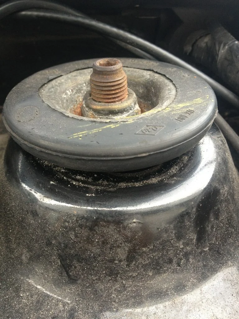

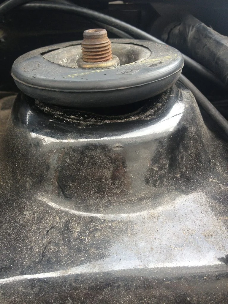

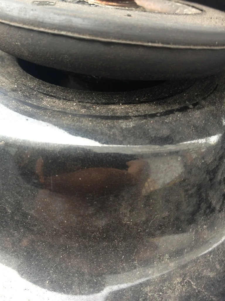

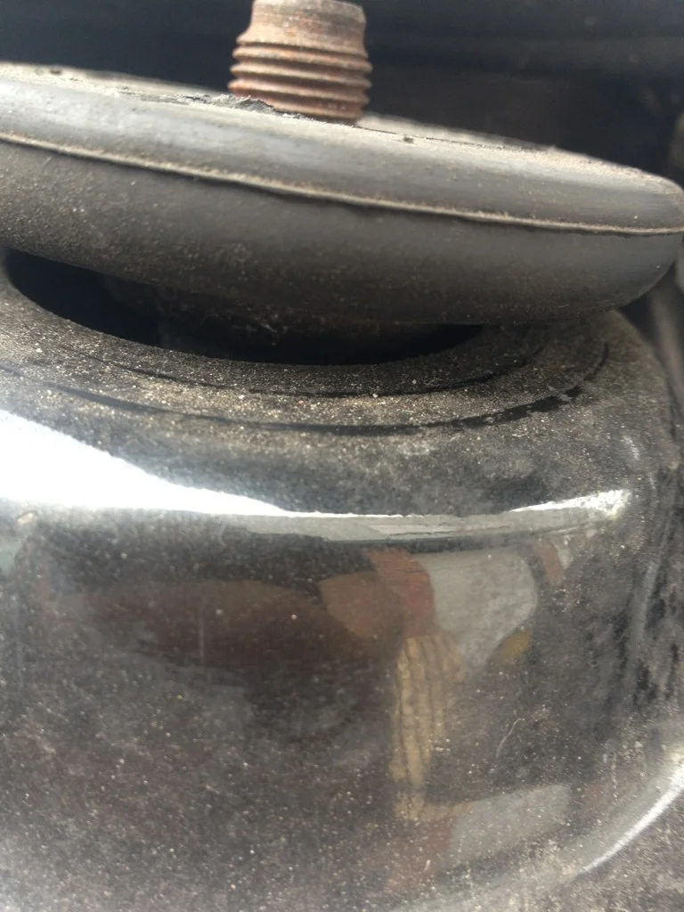

Anyway, wheels on lock to the left, passenger turret looks like this:
The turret top looks bent in places.
Pass is fine, looks like this
Could that have anything to do with it?

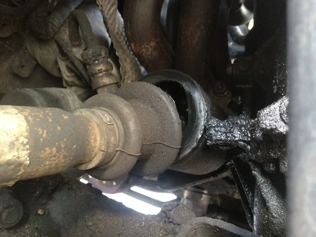

Jacked up drivers side, and the CV/drive shaft looks like:
Rob
Well. There's the problem.

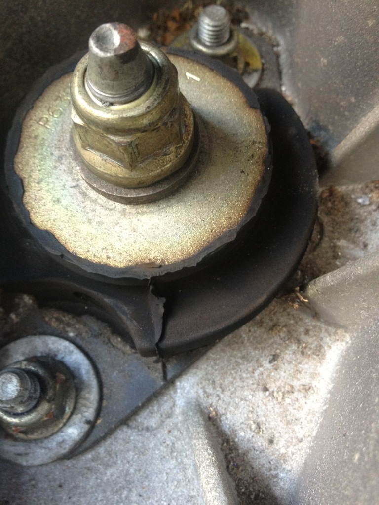

Clicking seems to be coming from this, it looks pretty knackered?
This was the culprit on my mates 172 Clio , was a right pain it the a*s to get to , but then I do try to do things without taking off as least as possible lol
