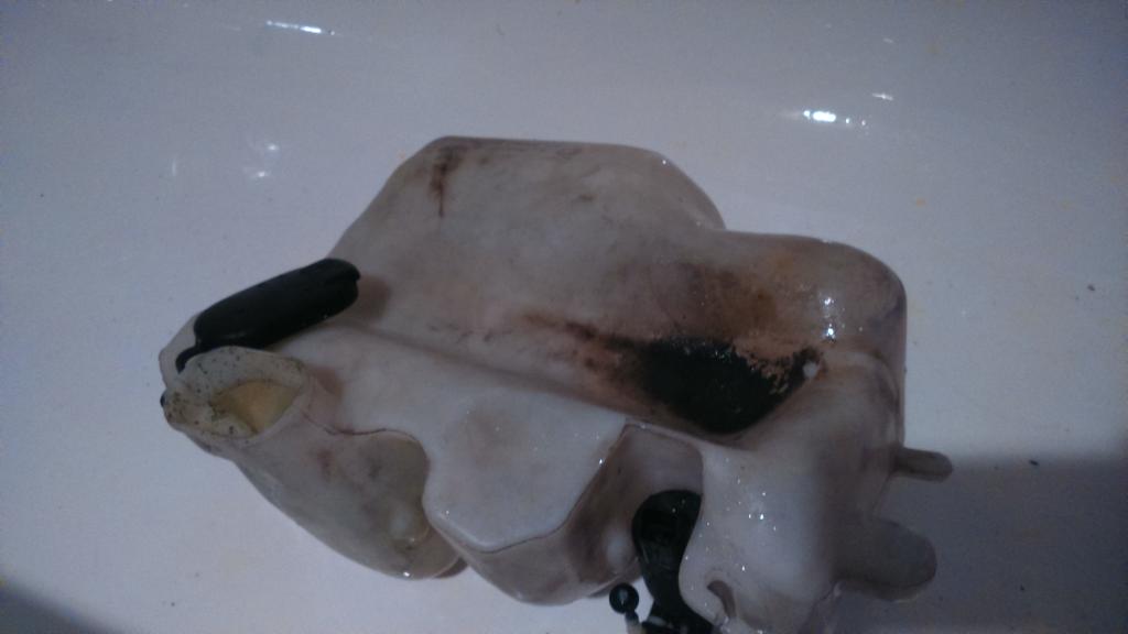

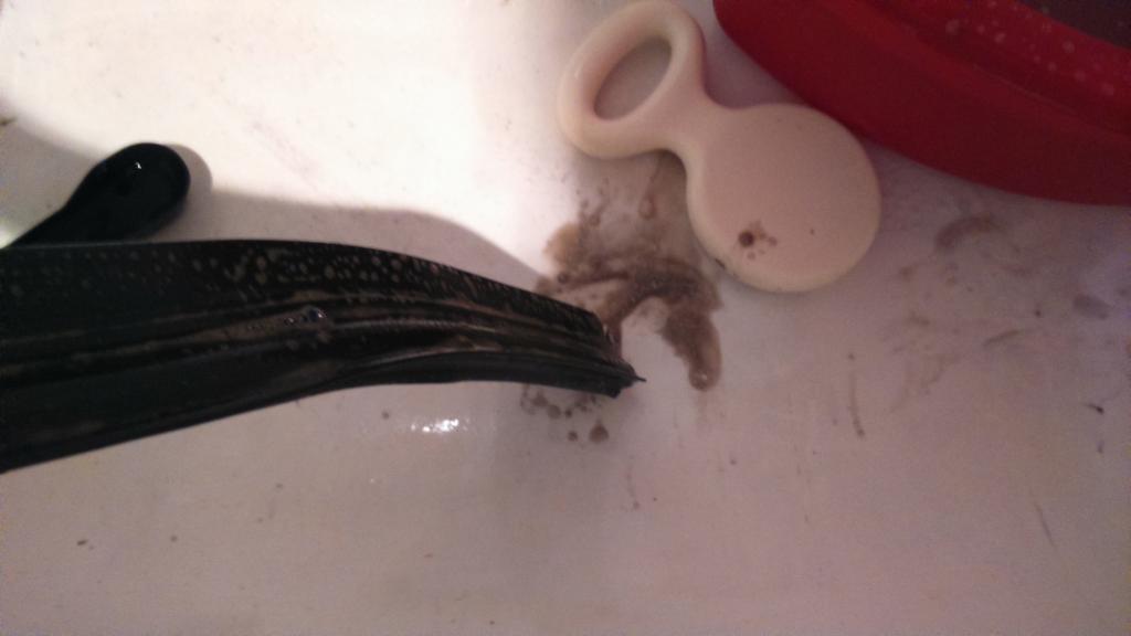

Couple small updates. First as it was MOT time I decided to fit the new washer pump as the old one was knackered
It clearly hadn't been used in a while as the water instead smelled disgusting! So gave it a clean and rinsed the inside with boiling water and surfex HD

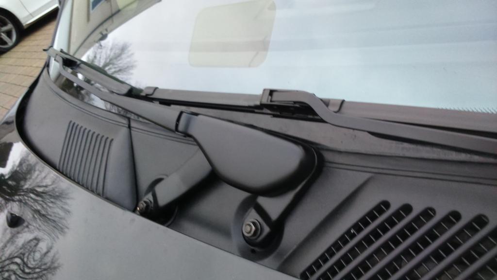

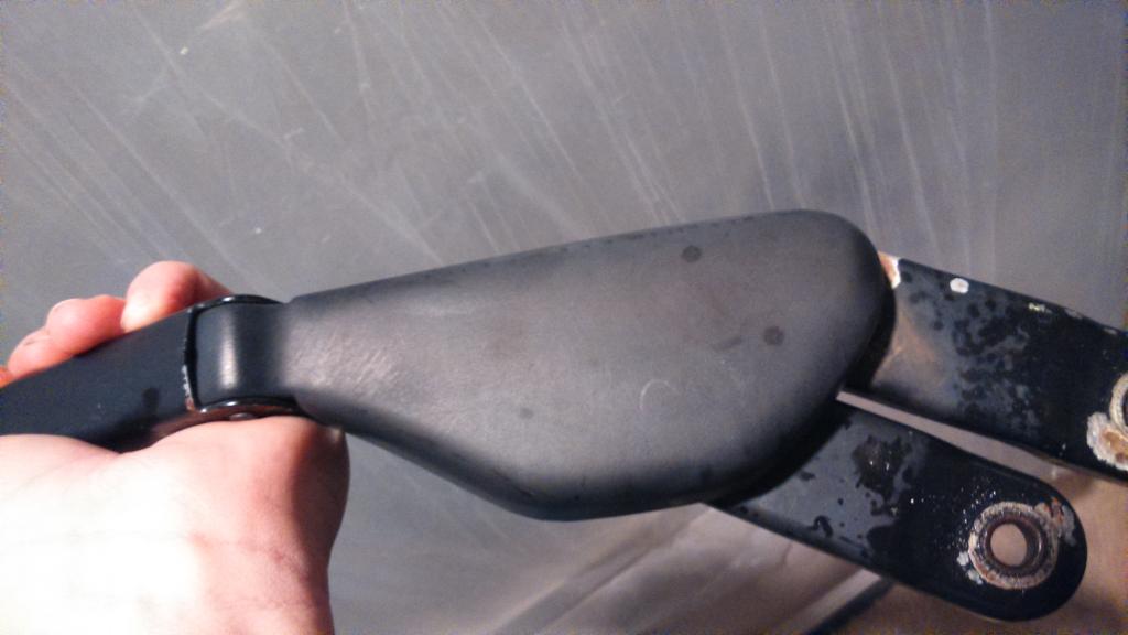

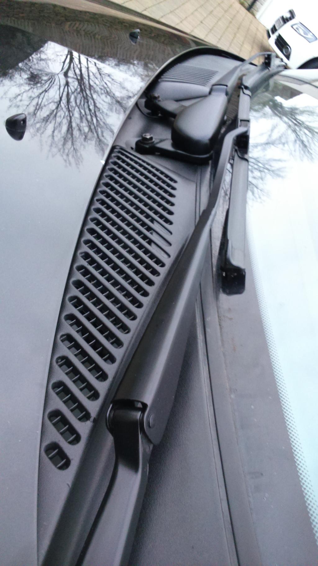

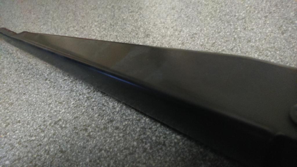

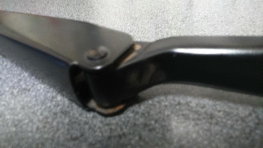

Whilst the scuttle and the wipers were off, I opted to spray the wiper arms as they had started to grey:

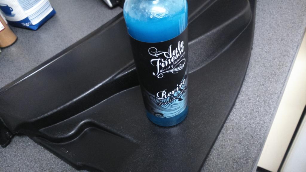

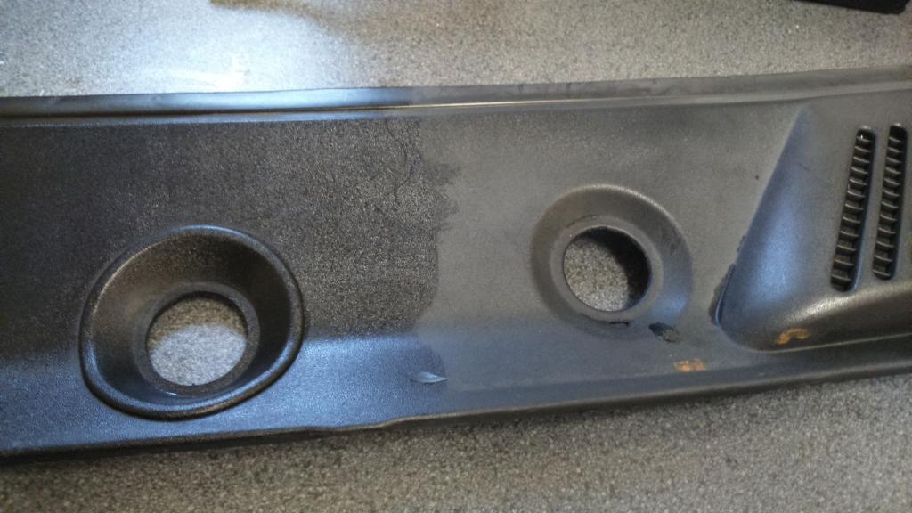

And also used some Revive on the scuttle panel to bring it back up to standard:
It looks fairly glossy in these pics but once Revive dries it goes a nice dark matt colour.
All bolted back on:

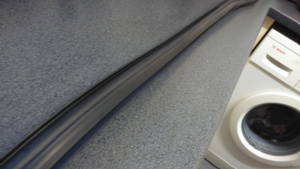

This had to be cleaned too as it was bugging me:
Surfex doing it's job. Yuck!
Nice and clean :)

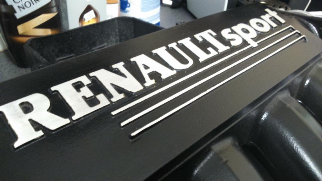

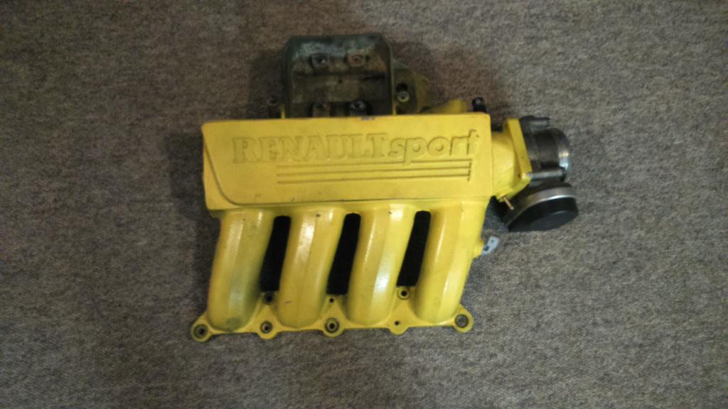

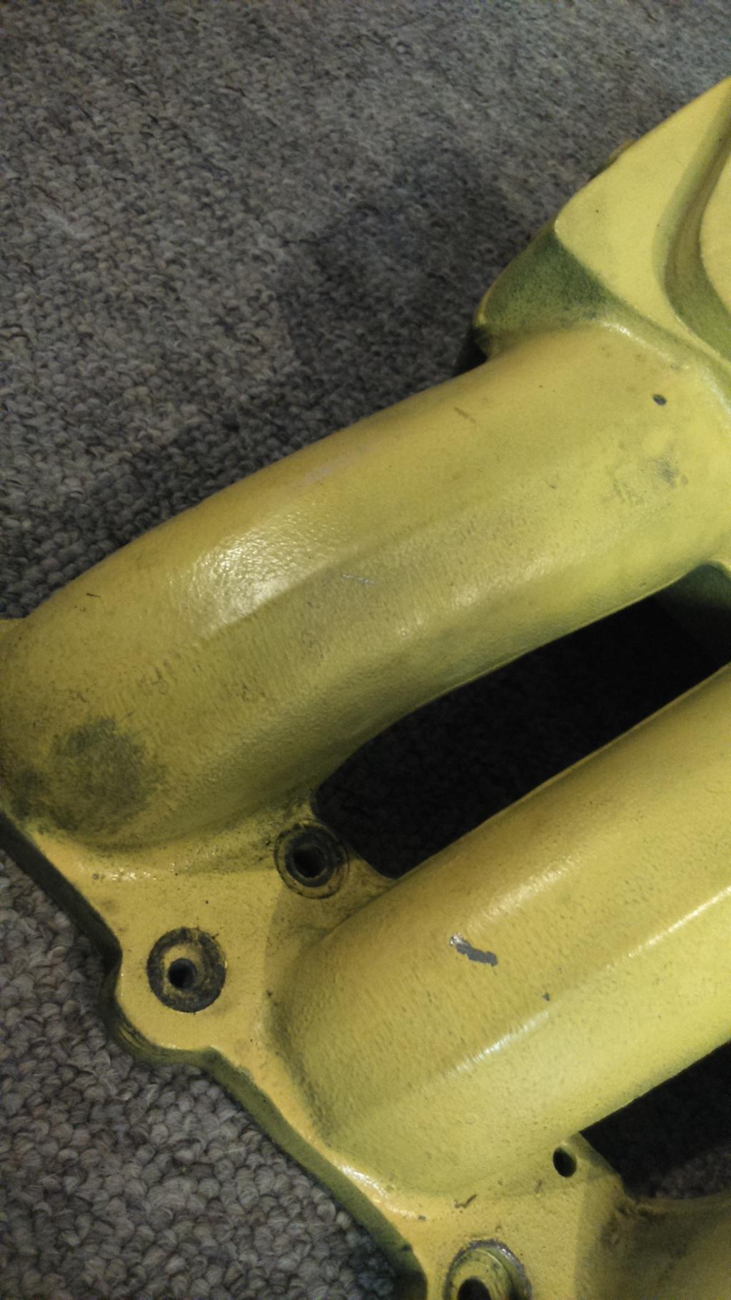

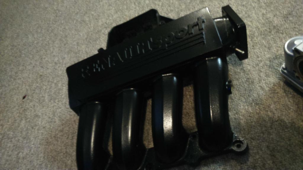

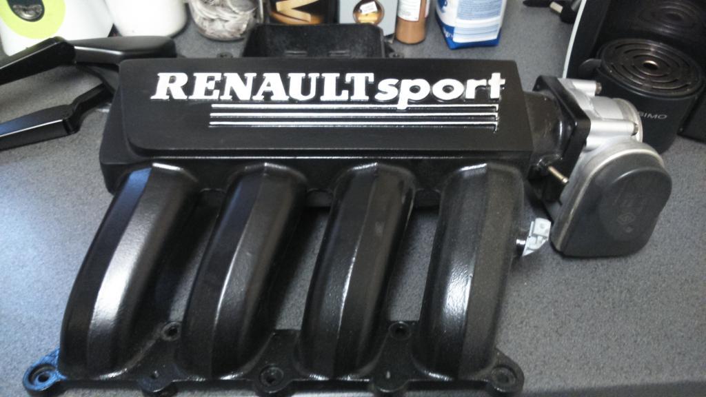

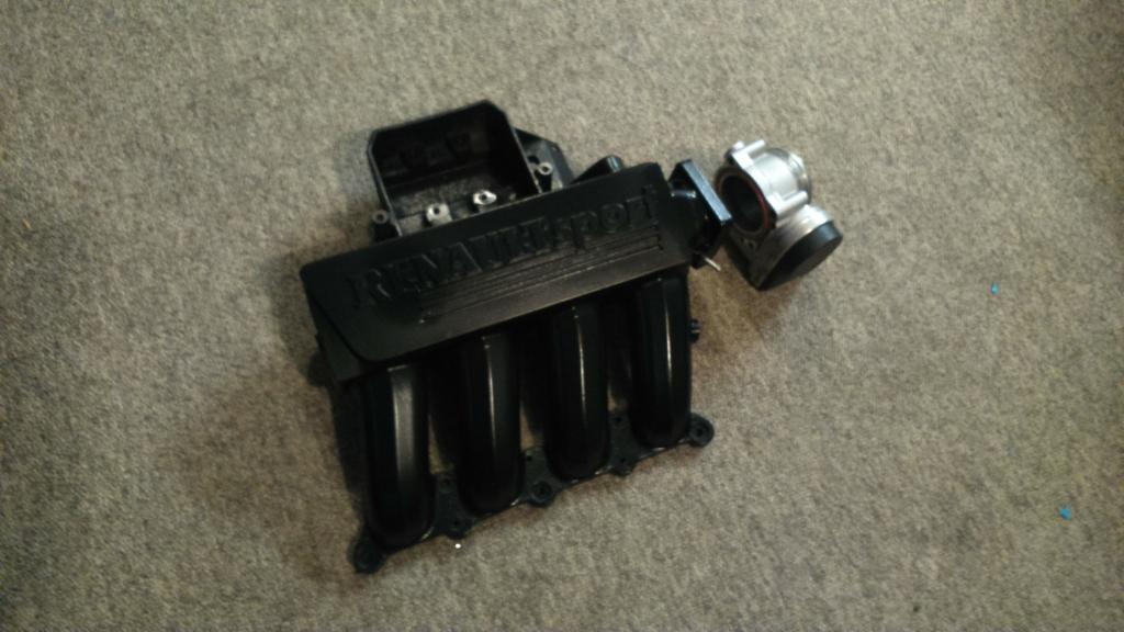

Next up was this hideous abomination:

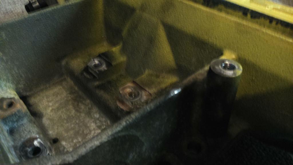

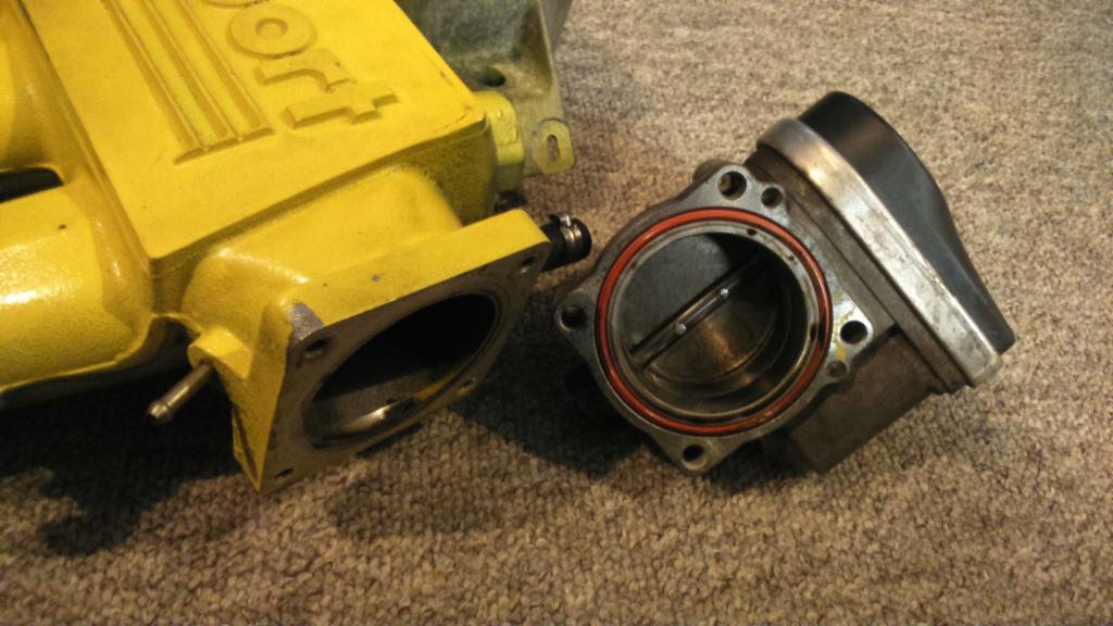

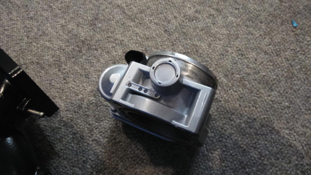

Also thought I'd may aswell do the TB whilst I was at it, so took that off:
And also gave it a good clean.
Nothing exciting, I think we all know the drill. Sand, clean, primer, colour etc. I ended up with this:
I didn't really like the black lettering so I sanded it off with various grades to get a smooth metal finish (pics make it look white though)

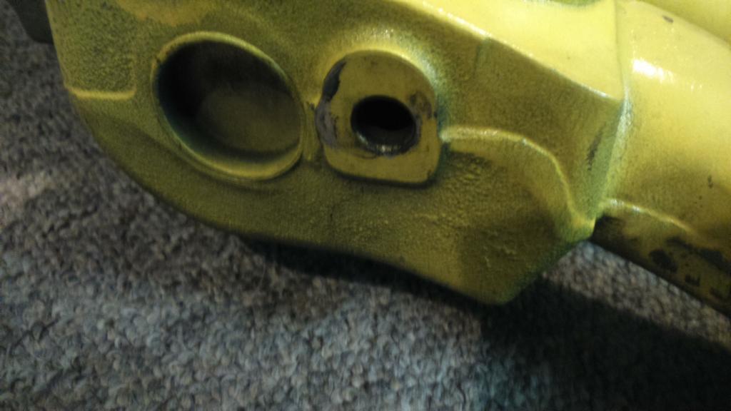

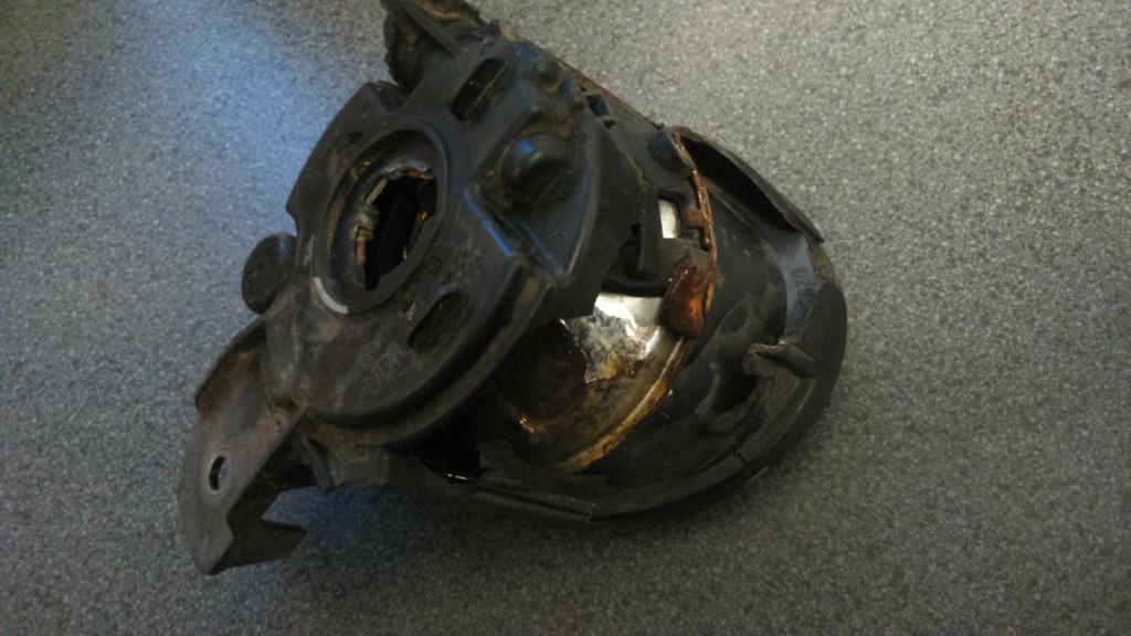

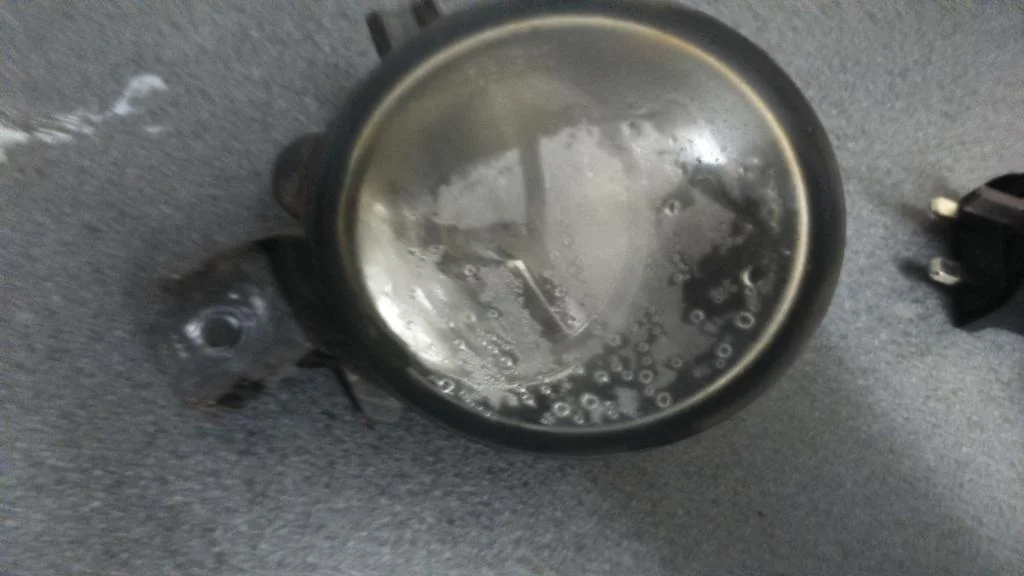

I also discovered why one fog was flooded:
But as I wanted new ones, but can't afford them just yet I took them out pre MOT (they were both shot anyway)

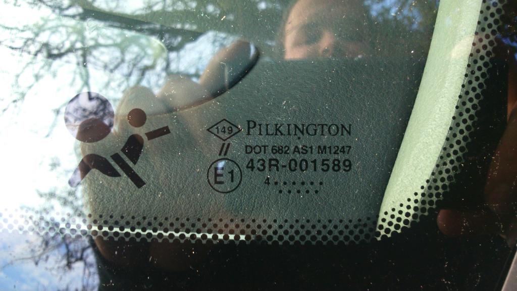

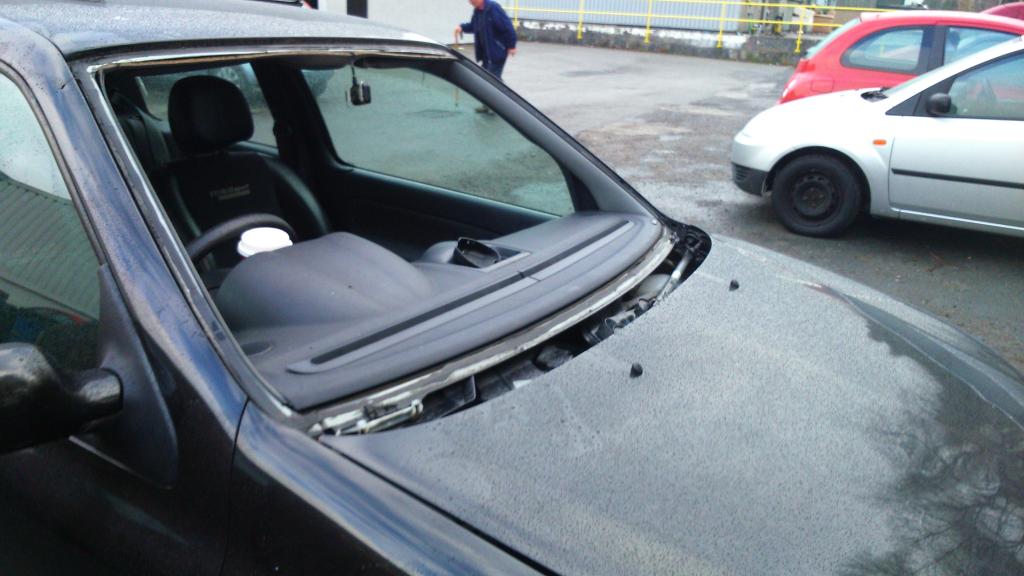

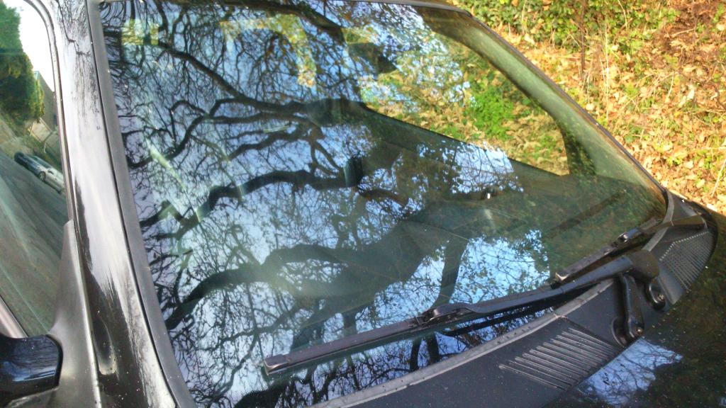

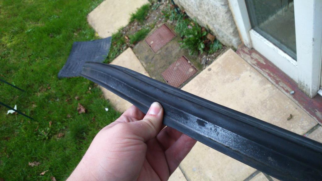

It was also time for that windscreen to come out, a nice huge crack and 2 stone chips certainly weren't getting through MOT so out with the old:
And in with the new!
One gripe I had is that being close to christmas with two young boys to pay for, and a mrs, I couldn't afford the £220 for the 'special' sensor type screen so opted for a standard screen (£130 difference between the two!) and was told I'd more than likely loose my intermittent/auto wiper and auto lights but the fitter re-fitted the sensor to the side of the mirror to see if it would work and hey presto, the auto wipers and lights work perfect. So for future reference if anyone needs a new screen but can't afford the sensor type one, the sensor will still work (well at least in my case) you'll just have to have the sensor to the side, not above the mirror.

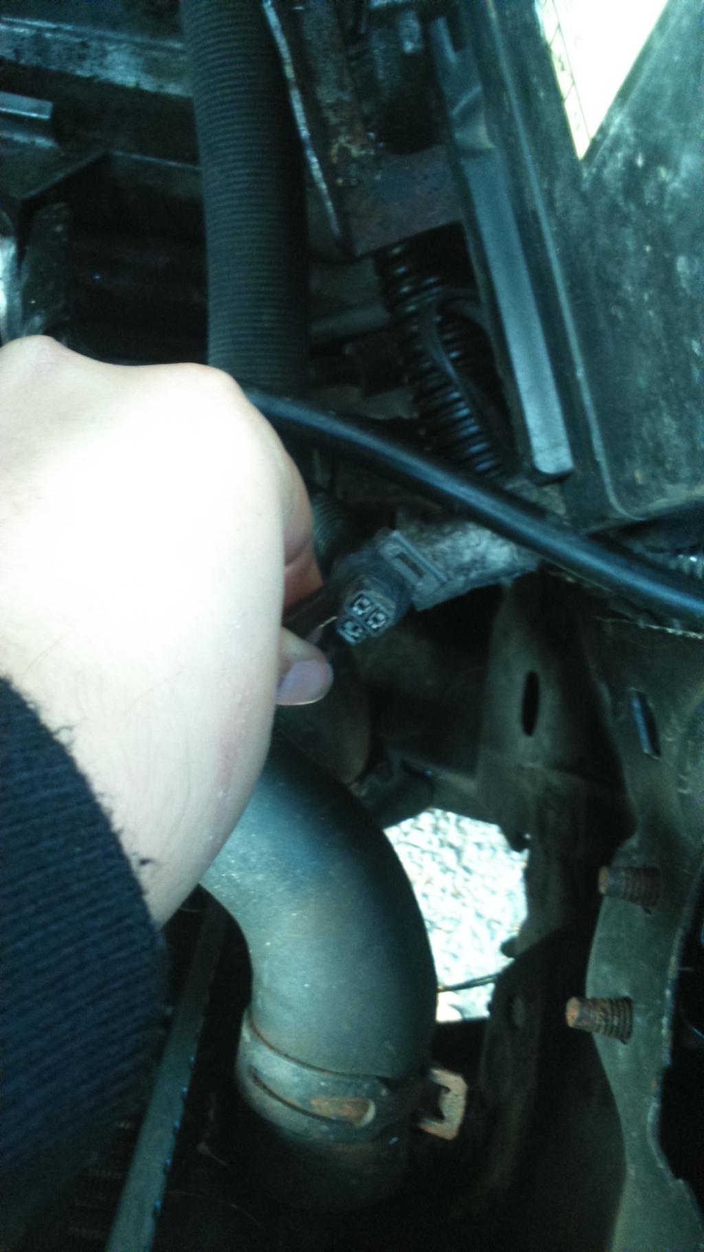

Now, the ONE concerning thing is it started to overheat during the test due to the fan not kicking in. The tester said he found this grey plug next to the fan:
and said there was a blank where he thought a fan switch should be and said maybe a new switch and it being connected up would be the solution, so I ordered a switch but found a post on here that says PH2's rad fans are controlled by the ECU? In any case what is that plug? If it's for a rad switch why is it there if mine doesn't use a switch? So all I've got to do is find out why the fan isn't coming on before it goes back in. Just as info, the temp stays at a constant level whilst driving and doesn't fluctuate if I turn the heaters or anything on, or use the windows or anything. Also the heaters/ A/C stay at the temp I set the whole time. Any suggestions would be handy :)

Getting there :) wish i had to the get up and go to sort everything out on mine, slowly doing the wheels (2left) and i was looking at the engine bay to day and wanted to know how to do the inlet manifold bit, but seeing how easy it is i might give it ago soon :) do i need special temperature paint for it as it gets hot, also my engine and exhaust manifold seem to get hot so quickly any ideas ? temperature gauge stays the same tho and doesnt boil the coolant at all
  2003 Clio 172 Sport
Getting there :smile: wish i had to the get up and go to sort everything out on mine, slowly doing the wheels (2left) and i was looking at the engine bay to day and wanted to know how to do the inlet manifold bit, but seeing how easy it is i might give it ago soon :smile: do i need special temperature paint for it as it gets hot, also my engine and exhaust manifold seem to get hot so quickly any ideas ? temperature gauge stays the same tho and doesnt boil the coolant at all
Haha I've only got the motivation as I've been off work due to a hernia repair so had spare time, trying to get lots done before going back to work. I used standard hycote satin and so far it's been fine. Alot swear by VHT only but I've done a few rocker covers, inlets etc with standard paint and they've all been fine, but it's up to you bud. If you have a local home store they normally sell aerosols for the same price regardless of VHT or normal so if they're a good price, get high-temp. The inlet is easy, just unplug the sensors, air inlet, and vacuum hoses, remove coil pack and unbolt. I saw your wheels on FB, not bad :)
