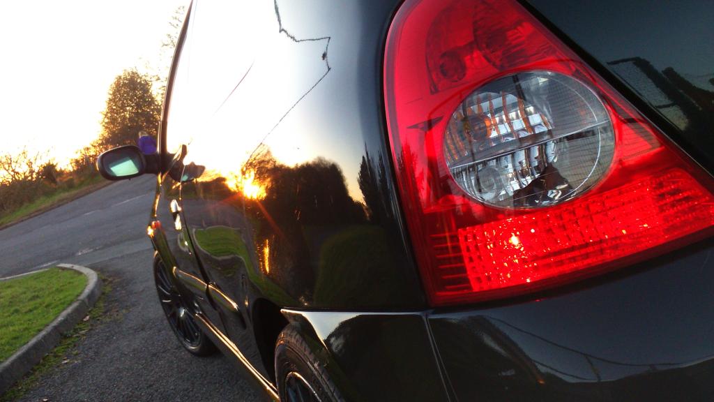

Hi Chris I spotted the Megane. I had just spent 5 hours washing, decon, polishing and tidying up the paint on her. There's a fair amount of tidying up to do but nothing too drastic.
  2003 Clio 172 Sport

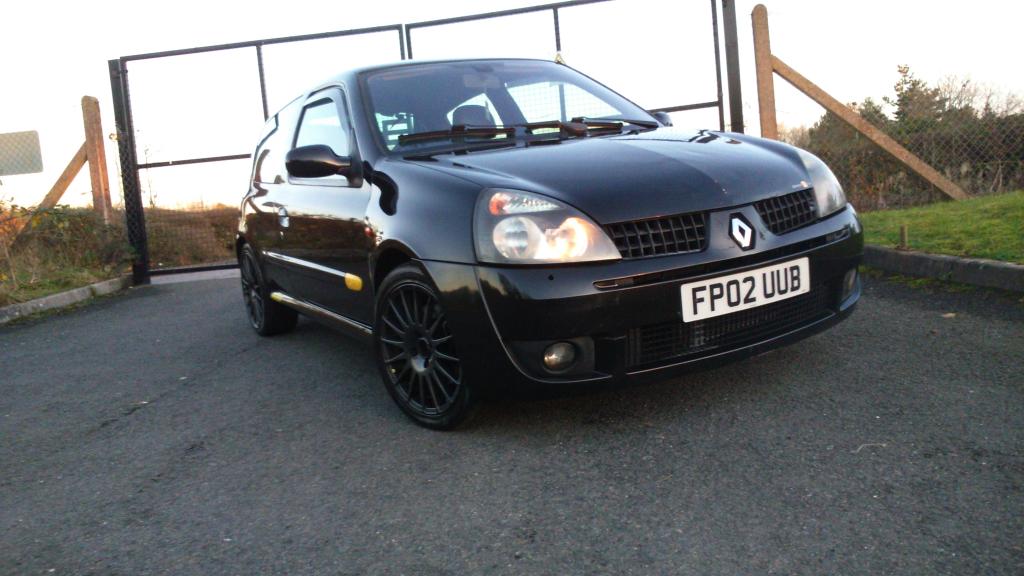

I won't bore you all with the full write up (It's on my thread on Detailing World) but for anyone interested, here's how she's standing after todays effort:
The wheels will be re-furbed and new boots all round, but the paint that's there is actually very clean and glossy:

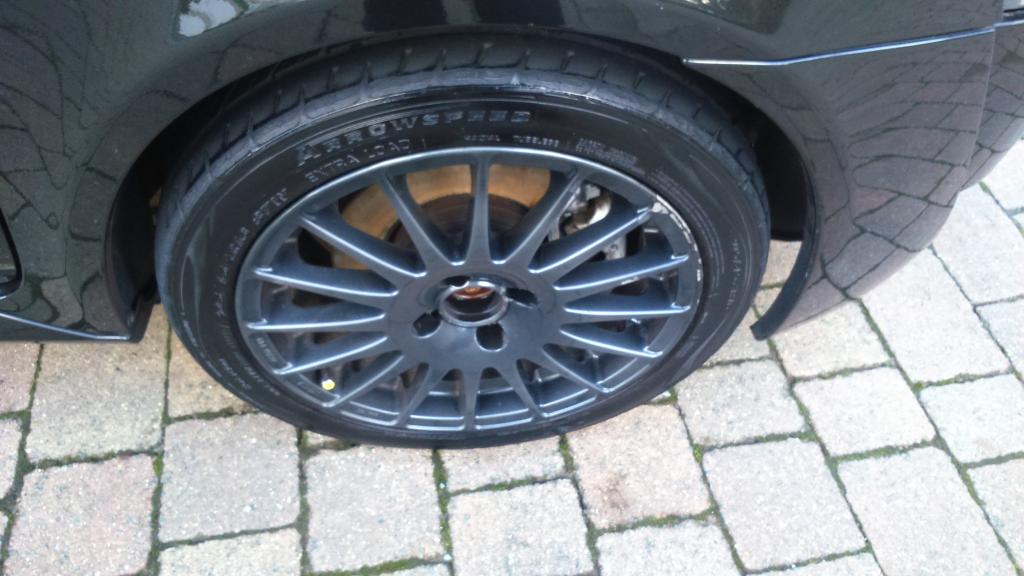

I've also sorted out some temporary 15" winter wheels with good tyres so I can get the OZ's off for some attention.

To be honest I do like the OEM look on clios but I do like the OZ's too. I'd like some bright silver Turini's but they're simply out of budget at the mo. Maybe some bright silver 182 alloys would look good? Not really a fan of the standard 172 wheels though.

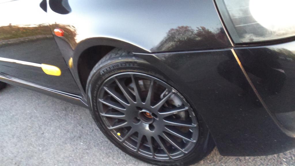

Small update. Finished my bullets and injector cover today. Also got a chance to fit my knock and air inlet temp sensors (both were repeatedly being thrown up on the diagnostics) and once cleared, haven't come back. The car now feels alot better and has got alot of its 'bite' back. My last headache is that she's still going into limp mode if I climb above 6300rpm. I'll get to around the 6000 mark and she'll sort of 'hiccup' and then limp mode will cut in shortly after. I'm now thinking maybe either the coilpack, lead(s) or plug(s) are breaking down at high RPM's? Am I completely off course thinking this way or is it a sensible idea?

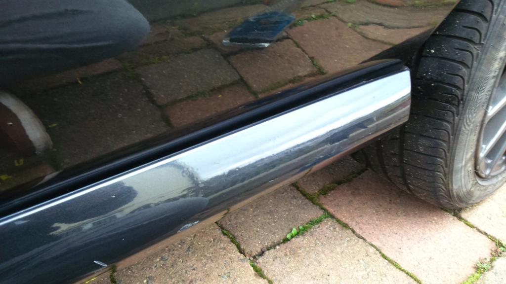

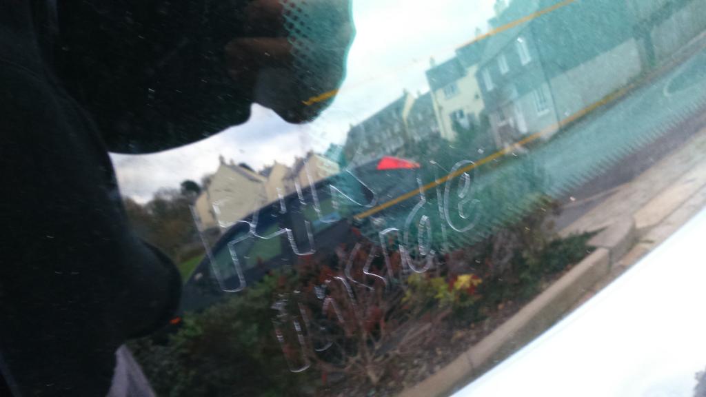

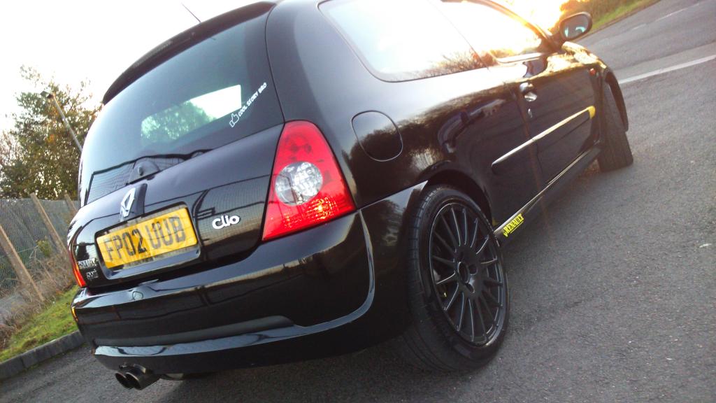

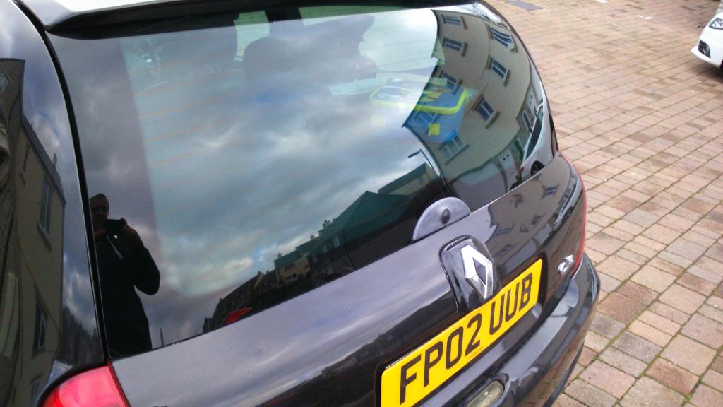

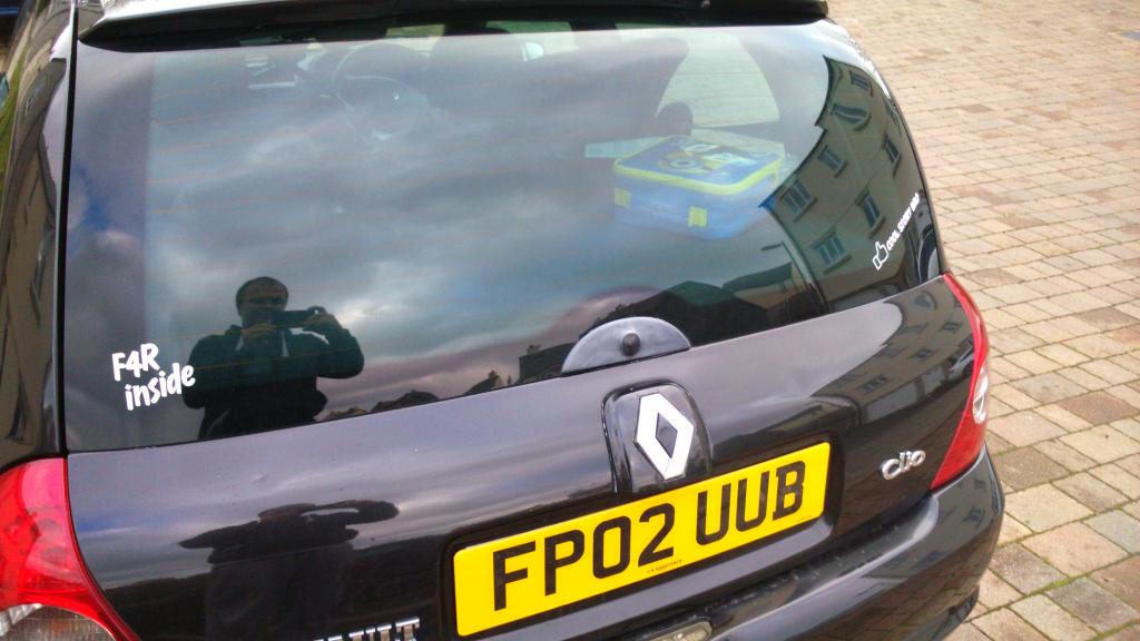

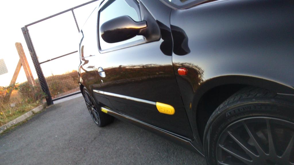

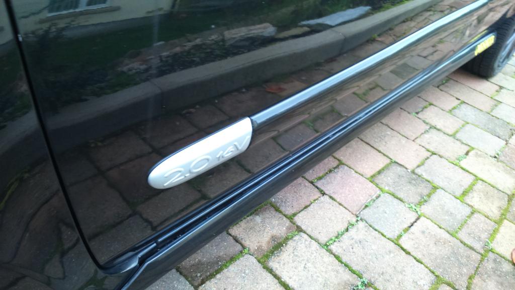

Managed to rectify a couple of the eye sores today. Got the silver bullets on, makes a huge difference and really glad I did:
Also removed the crappy stickers off the rear window:

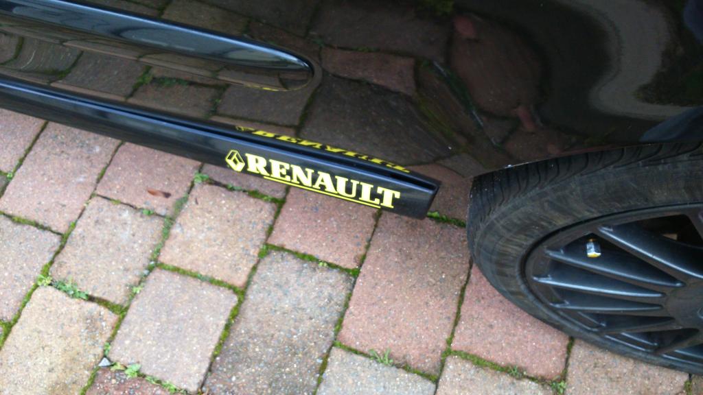

And removed those yellow 'renault' skirt stickers.
Now obviously big lairy stickers are the only way to recognize what make a car is so there's a chance people may mistake it for a skyline or a focus now. But it's for the greater good.

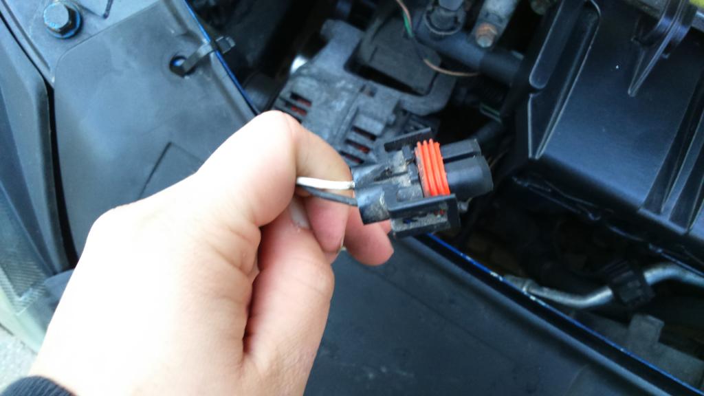

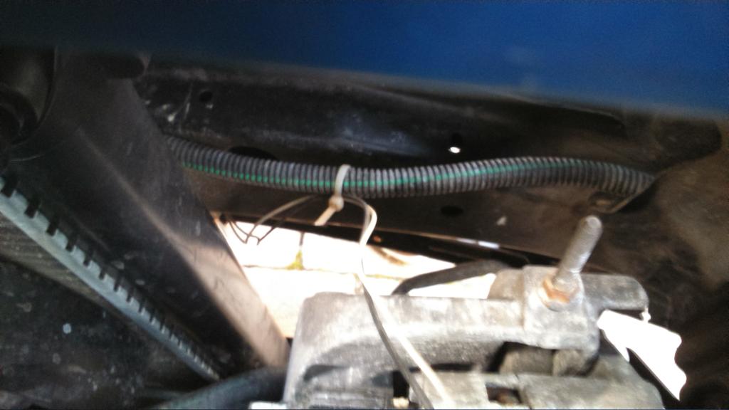

Also discovered the rad was flapping around down there as it hadn't been pushed into the bottom retaining recesses, put it all back in place and discovered this hanging down:
Which branches off here:
I was thinking fog lights? If anyone knows let me know :)

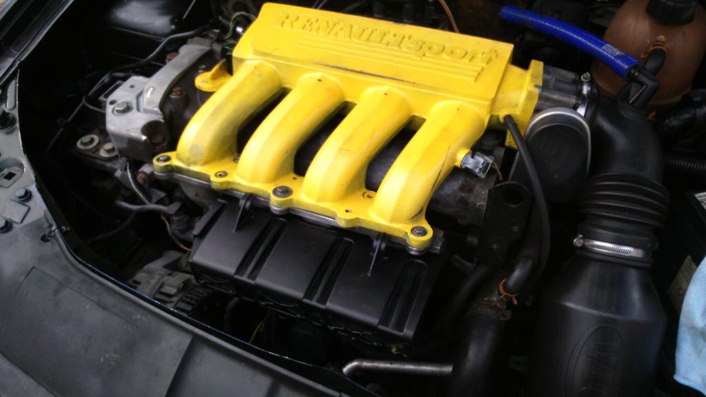

Also a 50/50 of the comical engine
The satin black injector cover looks alot tidier. The yellow inlet is ermm.....different I suppose.
