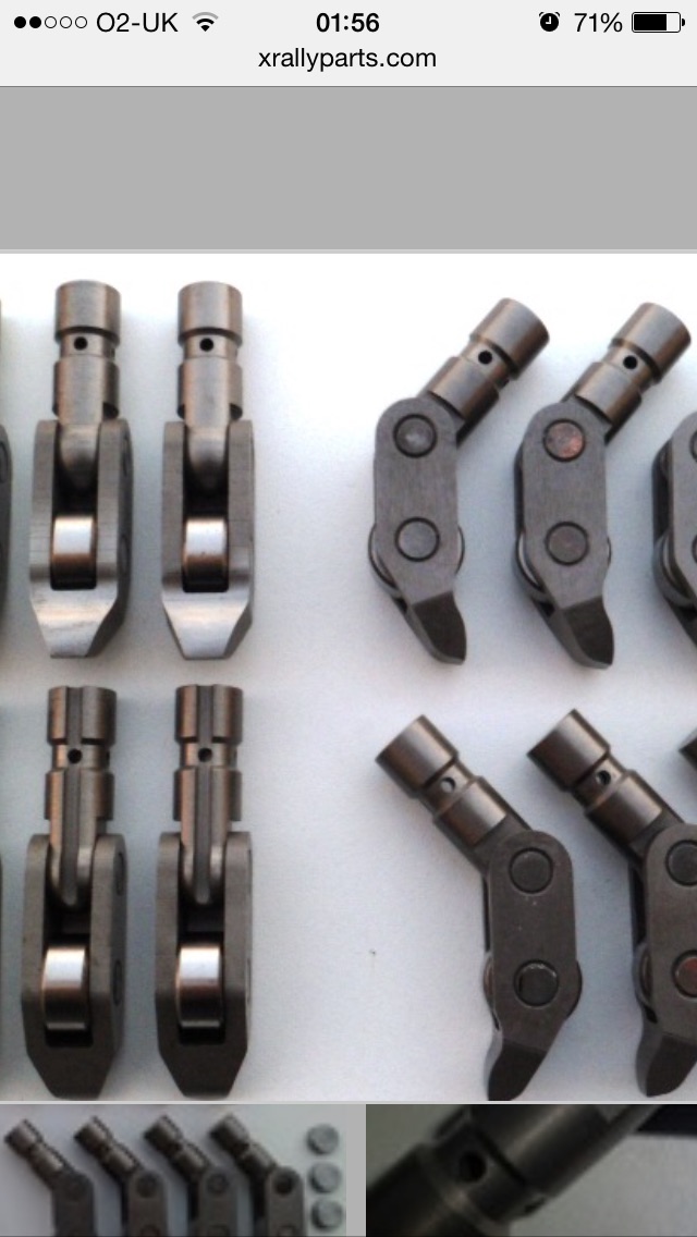

Ah right I see what your saying now! If you were building it to be reliable revving to 8k+ you'll definitely need solid lifters as a minimum mate and a set of 16 of these would resolve any issues you may come up against
The setup your going to run will be safe to 8k and occasional 8k+ (It's the same as mine pretty much), but it wouldn't stand repeated hammer that 8k+ will give it. The crank will also cry no more so steel is the only way.
