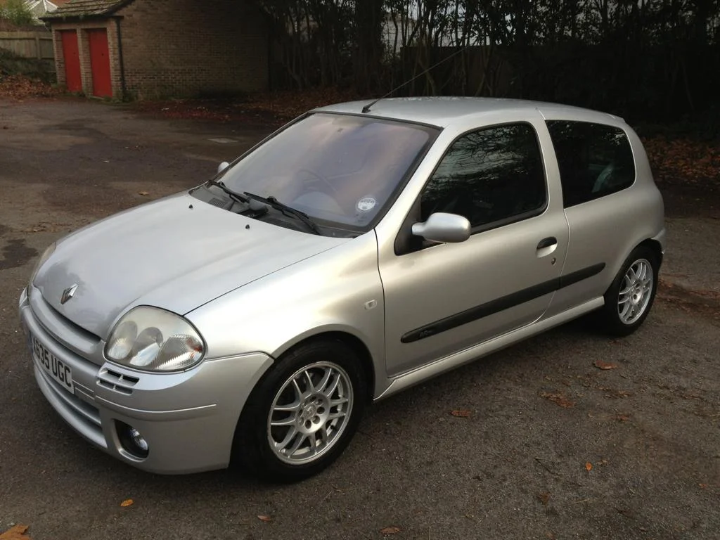

Been on CS for a few years now and started with a titanium 182 which was slightly modded but remained my everyday runner. Then I was seduced by a Liquid Yellow R27 and the 182 went before it was completely finished. Last year my circumstances changed and the 197 had to go to suit my work situation, enter the Panda. Having modded the Panda and took it to Llandow for a damn good track thrashing, realised that I wanted a track car. So the search began for something suitable. After a lucky escape from a right shed on ebay I found the current car on here. Went along to Chichester to look at it and bought it on the spot.

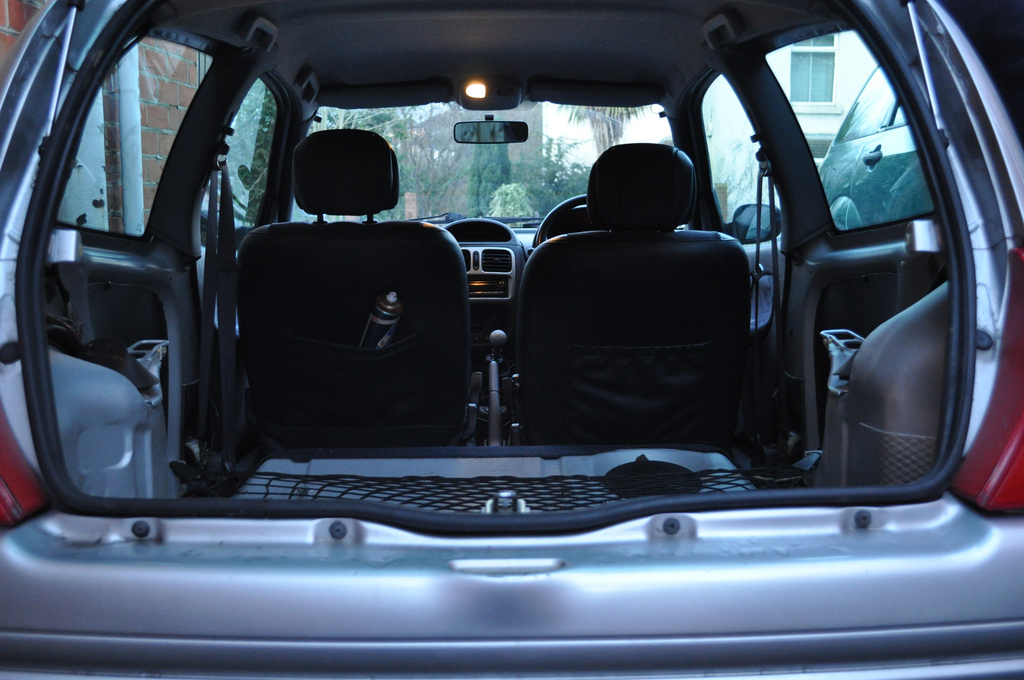

As in first post strippage started on wednesday night and finished off today and cleaned up the mess under the seats and in the boot.

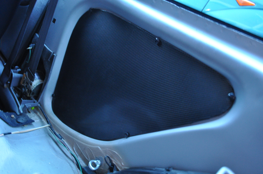

Rear doorcards inserted

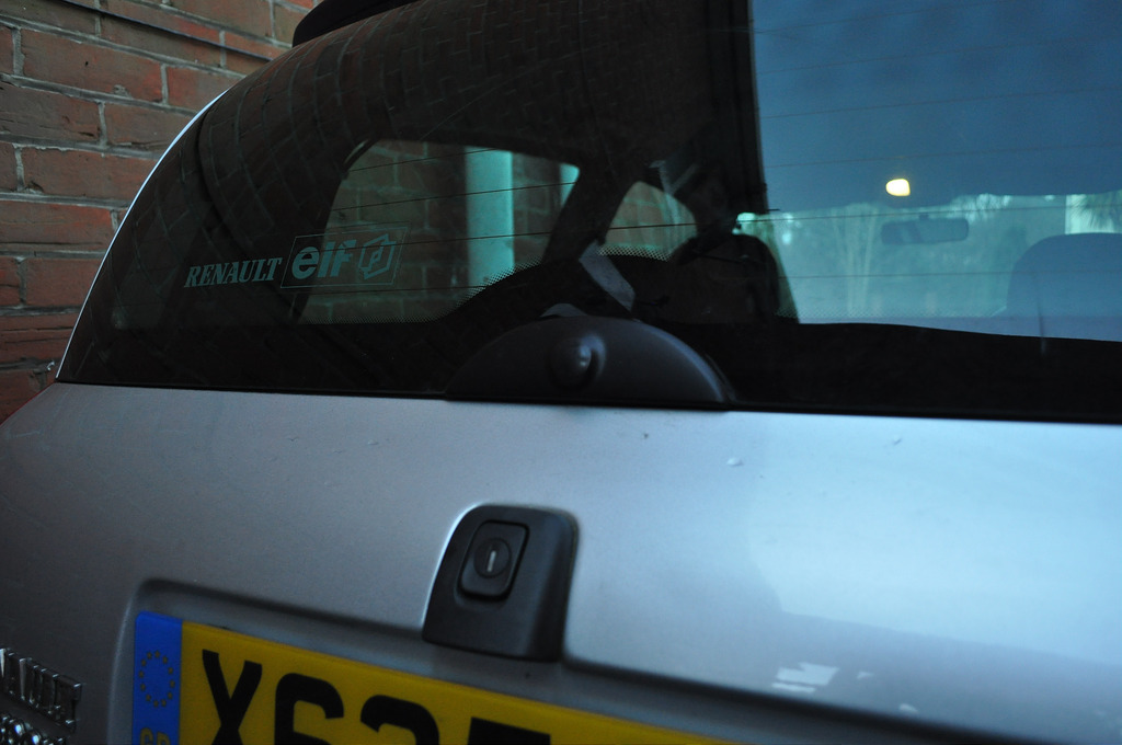

Rear windscreen wiper and motor deleted and covered.

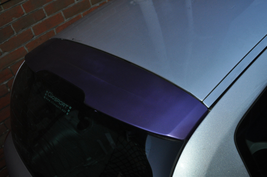

Rear spoiler had been assaulted by sandpaper and had been badly sprayed years ago. So came up with this as a theme idea to make it stand out a little bit on track. I know it's a marmite mod but meh who said you acquire taste with age.

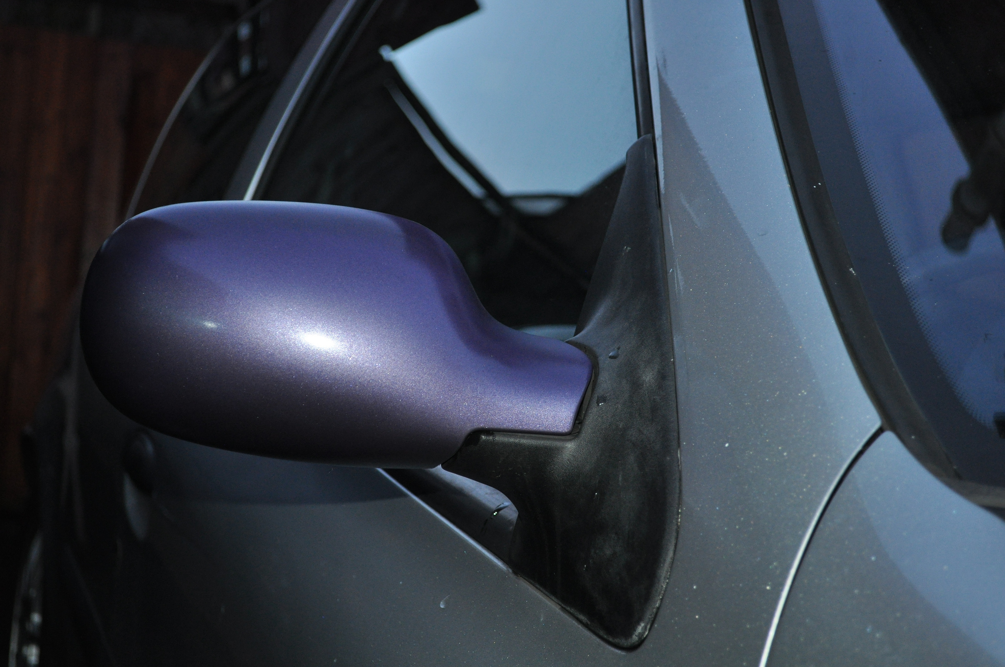

Whilst we were spraying some bits we thought we might as well do the mirrors as well.

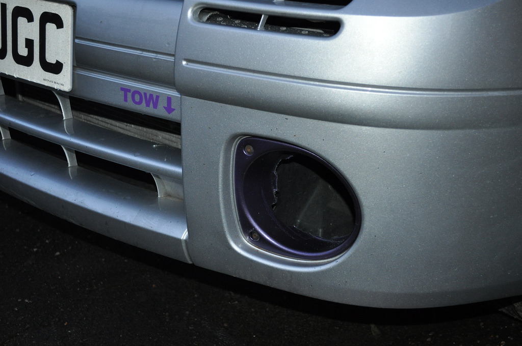

Fog lights removed and surrounds colour co-ordinated. Tow sticker added.

Where did you get the rear wiper bung? Got to love the phase 1s :D
Thanks Eddy, the bung is home made by my son. The whole theme of this project is to do as much of the work as possible on it ourselves.

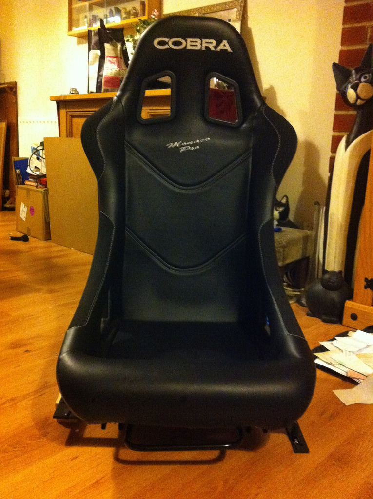

Finally the subframes arrived today and I did a dry fit tonight to make sure that it all went together well.
Not half as high as I thought it would be. Won't be able to fit it all until next weekend after surrey rolling road. Can't wait to complete the interior.

Seats look nice mate. Good and supportive.
When you fit aftermarket ones can you make them more line with the wheel rather than the off set Renault position?
