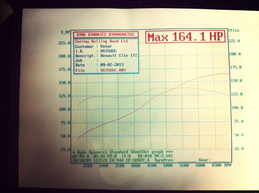

Well I got the car to Surrey Rolling Road this morning. Those who were there enjoyed the excitement of the non-starting Clio. After a couple of hours the car decided to give in and do what was expected of it. Got it on the Rollers and the result was:=
Pleased with that result considering the problems I've had and definitely encouragement to persevere with sorting this problem out.

For an X plate Pete that looks like a good engine, I'd be suprised if mine hit 150bhp lol. Whats the miles on yours? Mine is about to hit 130,000.

Good result.. My 182 ran 164.7 last time i had it on a RR.. Still need to sort my apparant timing issue though...

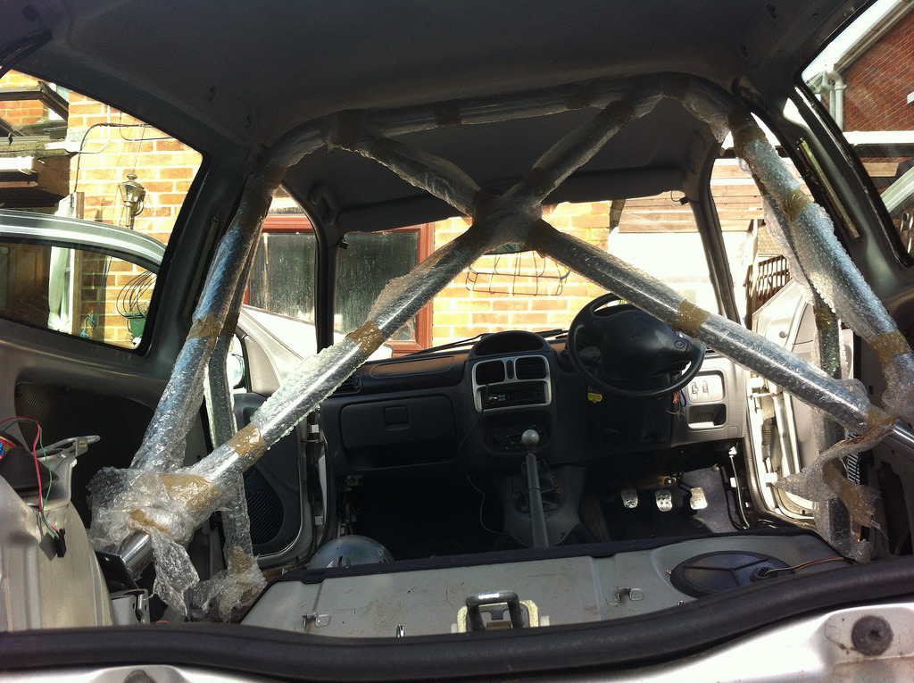

Been a day of hard work on the Clio today. Started off at 10.30 am with it looking like this. I had the help of my son for the day and we were determined to do as much as we could. Wanting to finish the interior was a prime goal.

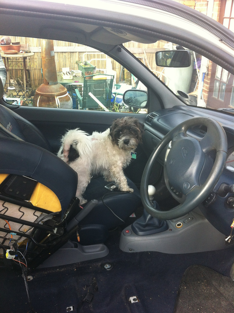

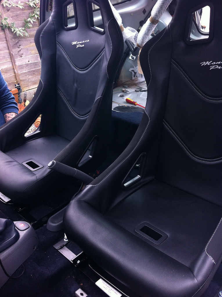

First job of the day was to remove the front seats.
Jakey was loving it and at one point was stood on my son's chest while he was under the car.

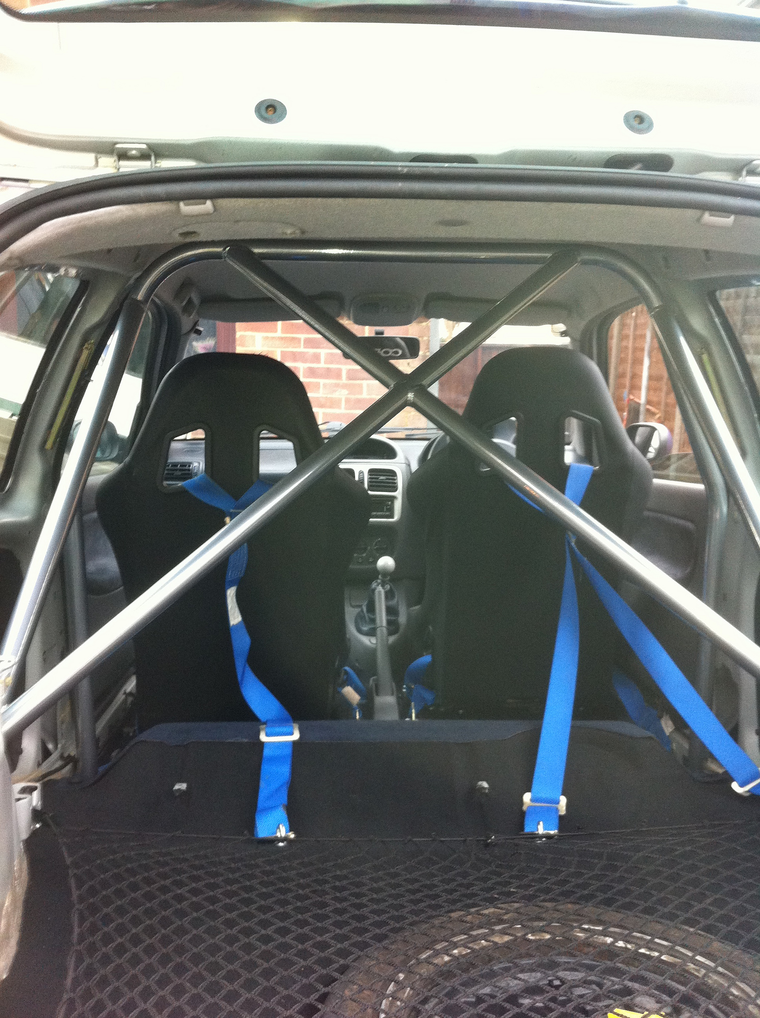

Seats out and it was time to put the cage in. This is one of those Alan Dent cages and I have to admit that it went in so easily that we both went in and had a cup of tea in shock that we didn't have to manhandle it in at all. Plates all matched up and before we knew it it was all bolted in without even having to remove the wheels for the rear arches. We left the bubble wrap on it to protect the powdercoating.
As we were making such good progress we decided to press on and fit the bucket seats. We used the Cobra subframes which bolted directly to the underside of the seat frame.
Seats in and all securely bolted in we decided to have a break for lunch. Three hours of work and we had achieved what we set out to do.

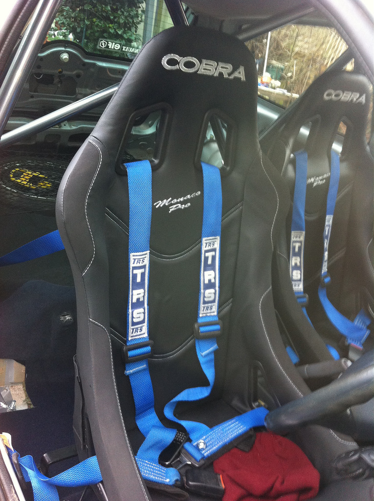

We returned and removed the car off the axle stands and spare wheels it had been precariously perched on. Next step was to fit the harnesses. Finally hit a problem with these as the harness eye bolts would not fit into the seat belt mounts on the side of the car. Got around it by bolting them in with washers and original seat belt bolts. Having done that we had already decided that we didn't want to leave the back naked so put some carpet down. As this is meant to be a budget build we decided not to buy the K-Tec boot mat but used acoustic carpet for sub boxes. Glued it to the floor and it follows the contours nicely. I am so glad that I have a son with ADHD who loves doing up cars.

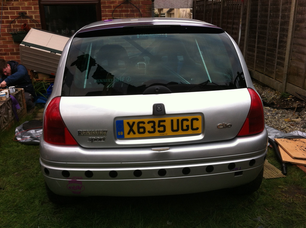

5gm out of the bumper with holes and he also removed the foam crash pad.

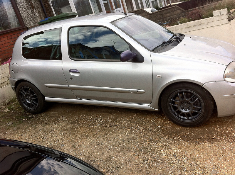

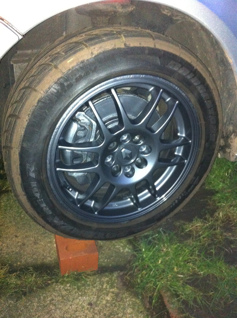

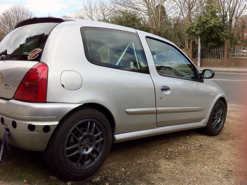

We then decided to update the wheels
They're not black but dark amphasite (lol)

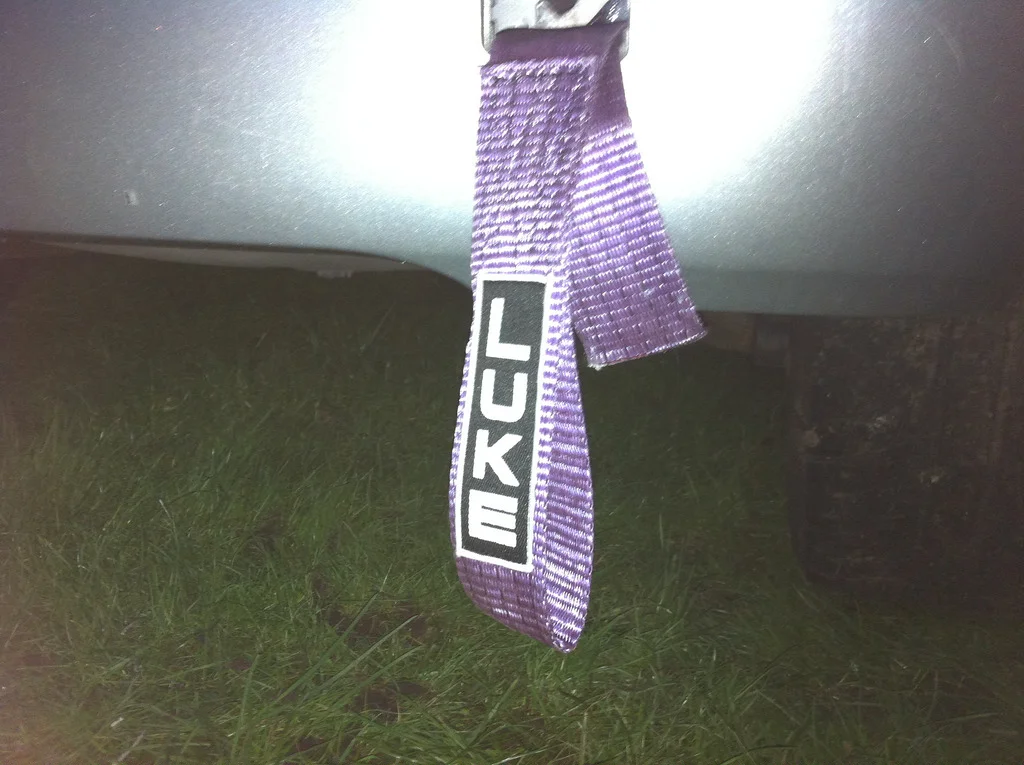

Finally we fitted this, having to file out the holes for half an hour to accomodate the bolt

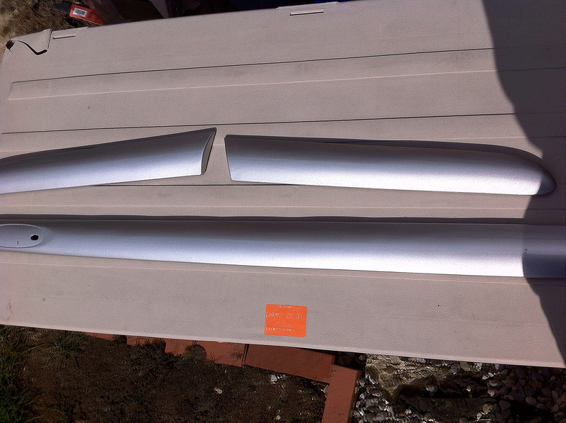

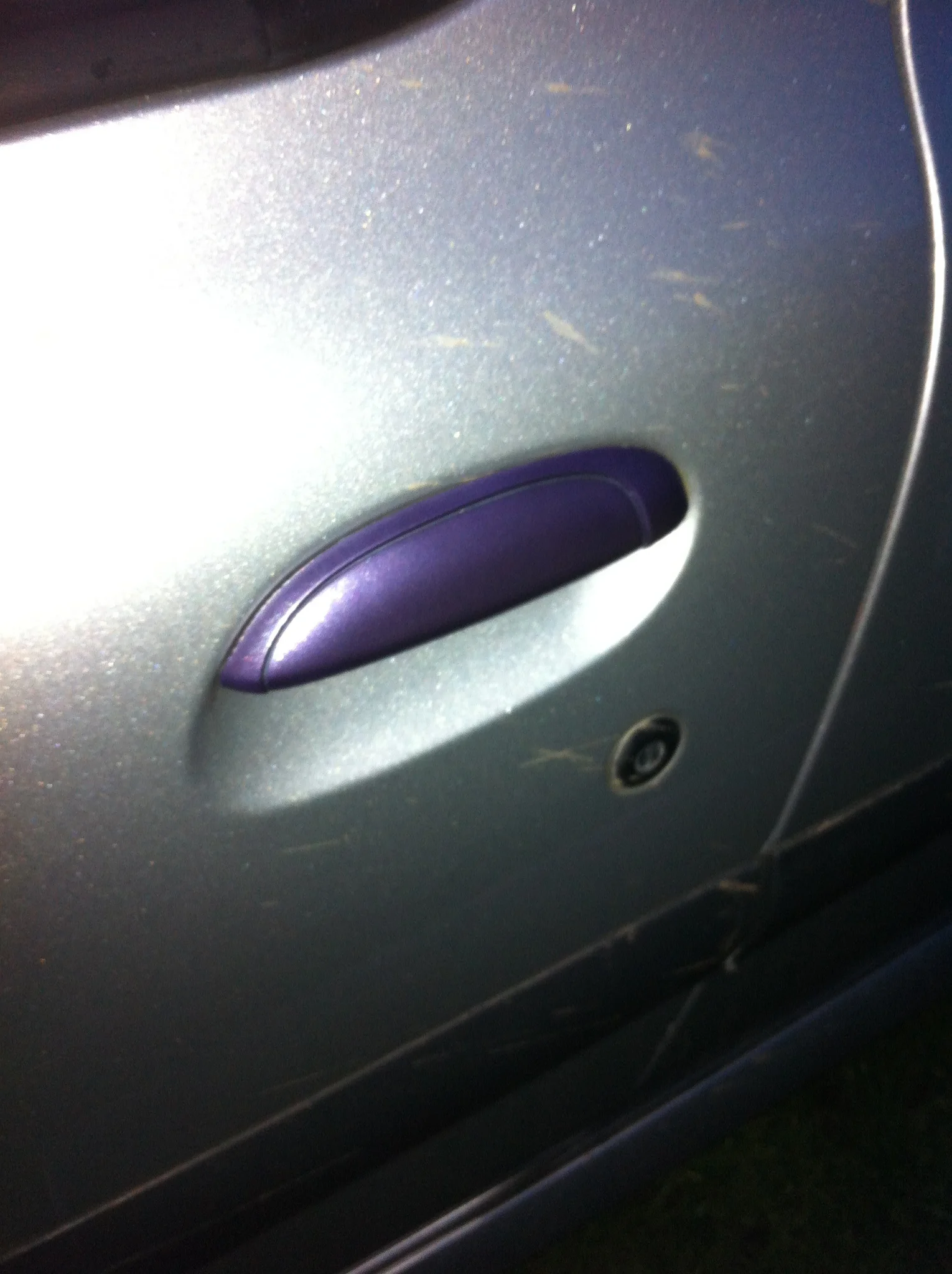

Realised that I have not updated this for some time. Car has been starting with no problems for a few weeks now. Have been putting a few miles on it and it has really benefitted from regular runs. Had put off doing anything else to the car or throwing any more money at it until I had confidence in its reliability. This weekend gave it a good clean and even thought of giving it a full detail but it was too cold. Did decide to do something about the side bump strips. So persuaded my son to have a go.
Results were:

Yea not bad for Fiat Grigio steel but apparently it's the paint code that's important. Tim had his done at Regal and they did a great job, so will be hoping to get it in once suspension is done.
