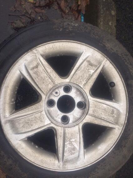

Sealed up around my aerial to see if that sorts it and then decided to go all out and give the car a clean as it was filthy.
Started with the wheel as they were awful.
Dont have any pictures of them cleaned yet as it started chucking down half way through them so didnt even get to start the actual car -_- .

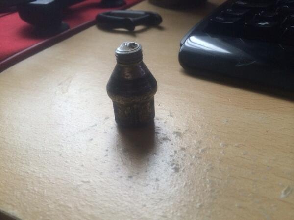

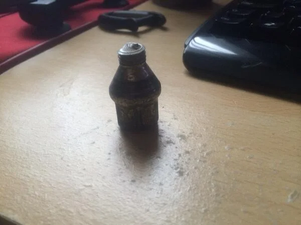

Then I sheared a f**king bolt.
Running on 3 at the moment until i get time and a dry day to drill the fucker out.

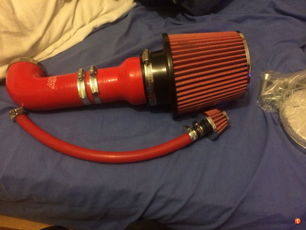

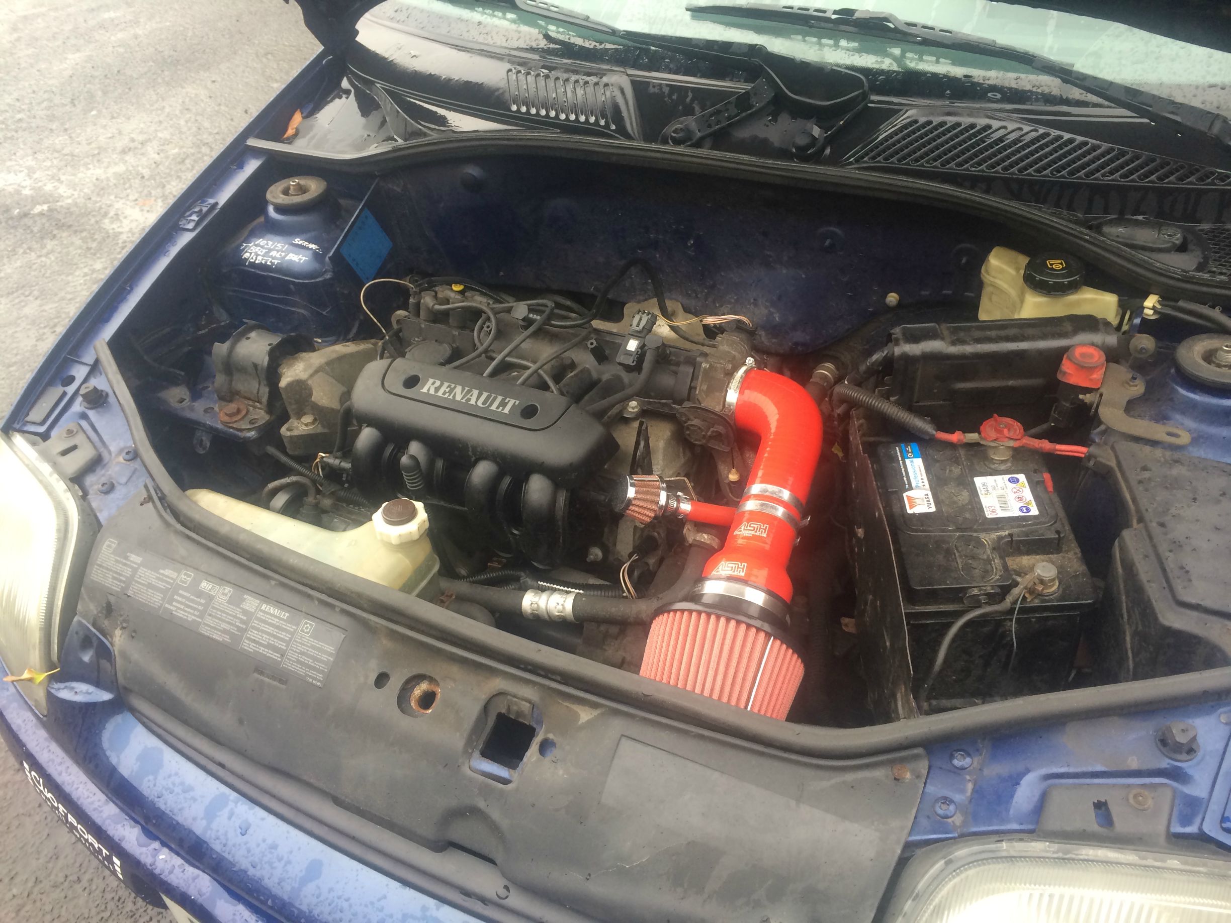

Anyone have any idea how to fit this Tigger Kitson93 ? Hoping to get it on tomorrow but don't want to be standing confused as sin by it lol.
If it its the D7F 1.2 8v engine all you have to do is take the air box straps off (push down on the pins and then push them towards the air box), push down on the black 180 degree pipe (big one) to detach from the throttle body, pull off the breather pipe and remove the whole old air box carefully navigating round sensor wires and pipes..
Attach your new air filter and do up all the jubilee clips etc., find the breather pipe (should be just under the main intake) and attach your new breaker pipe (the one with the smaller filter on it.
Also some intakes don't have a plate as its located right in front of the grille when fitted
And that should be it, i made my own little custom one.

Cheers mate worked a treat :) will hopefully get a few pictures took in the light tomorrow. The smaller breather pipe had a bit of smoke coming from it earlier after a bit of a hard drive. Is this normal with it being a breather or do I need to have a look into it ?

glad it helped, not sure about the breather but if the oils at a high temp and the breather is a direct hole to the engine internals, might just bet that, just keep an eye on it. Also I know its hard not to, but dont thrash the beans out of it in 1st gear to get the noise, these little 1.2's arnt meant for 7k revs haha

Well this is how my engine bay looks now. I think its a bit untidy and want an engine cover but have no clue where to get hands on one for a Ph1.
Other than that i dont have a clue on how i would go about making it tidier looking. Maybe coloured lines or something but don't know yet.
A good clean & degrease, then back to black all the black plastics and it'll look clean :)

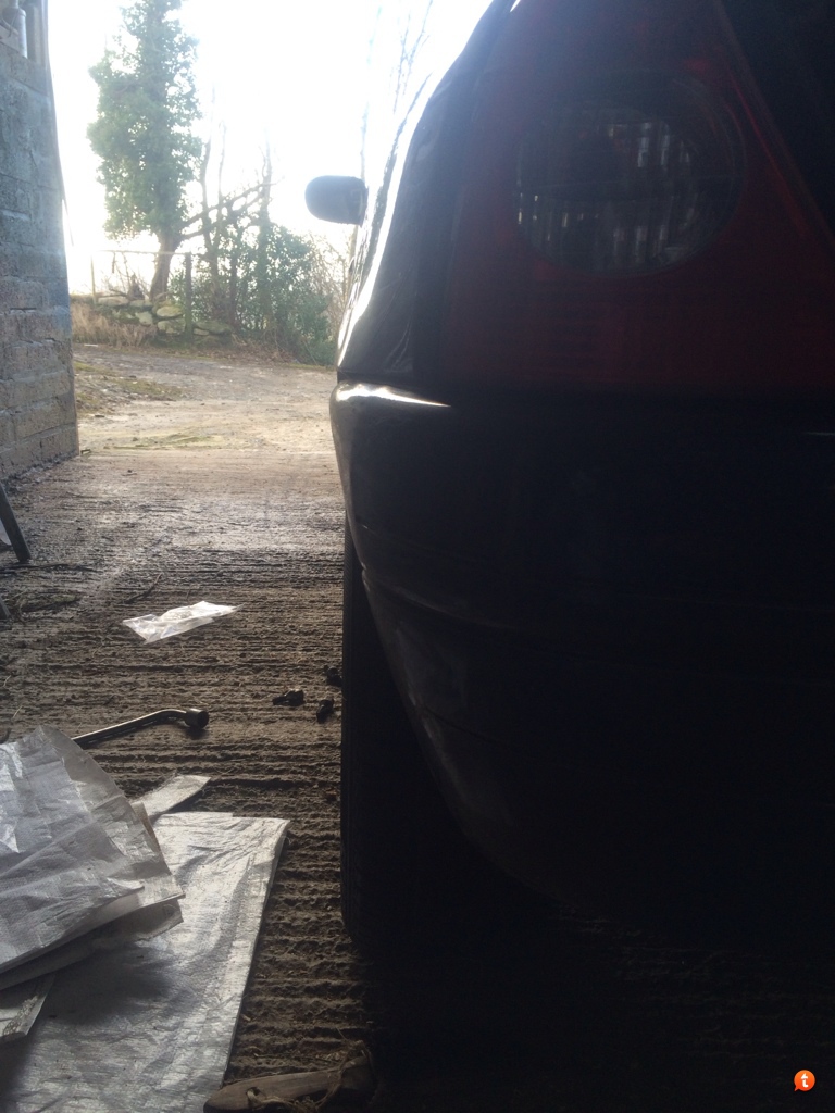

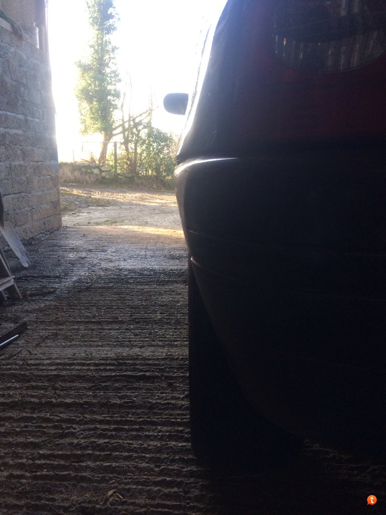

Got my spacers fitted today before work.
Went from this.
To this.
Was pretty happy with it until the drive home. Any sizeable dip in the road and I'm rubbing the arch :/. Gonna need to get them off sharpish.

How low is the car? On springs or coilovers? And how big are the spacers?

looks good what offset are the alloys? what size spacers did you get?
Not sure on the offset mate. Spacers were 16mm and the car was on 60mm springs. Got them off now anyway though so will either sell them or stick them back on again when i have the 172 bumpers sorted.

Not tried front yet but i still have half a wheel bolt stuck in one of my front thats i need to get taken out so will try them when i manage to get that done :p

Did it rub a lot with the 16mm spacers and lowered 60mm? Looking to go F60/R40 with aftermarket shocks but I still want to be able to put people in the back
  Mkll Ph1
Not really. Town driving was fine and had no problems. It was more the fact that i would be driving on country roads most days and when I hit a bump in the road at around 60 it rubbed with the car hunkering down. So if your going 40 at the rear you'll be fine even with people in the back.

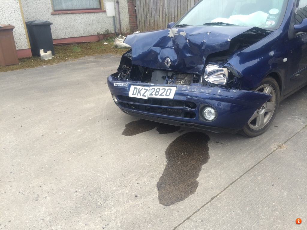

Well the car is dead. Had a crash on Wednesday morning and it's not going to be worth fixing with the damage done.
Will more than likely be breaking the whole car unless I'm getting another Clio but have no clue what's happening right now.

Holy s**t, how'd you do that?
Was on a main 60mph road when the woman in front stopped sharp to let a lorry pull out of a junction and I couldn't stop in time so went into her arse. Was pretty much not expecting her to be stopping and didn't brake as hard as she did until it was too late and I realised she had stopped.
